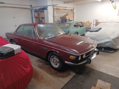

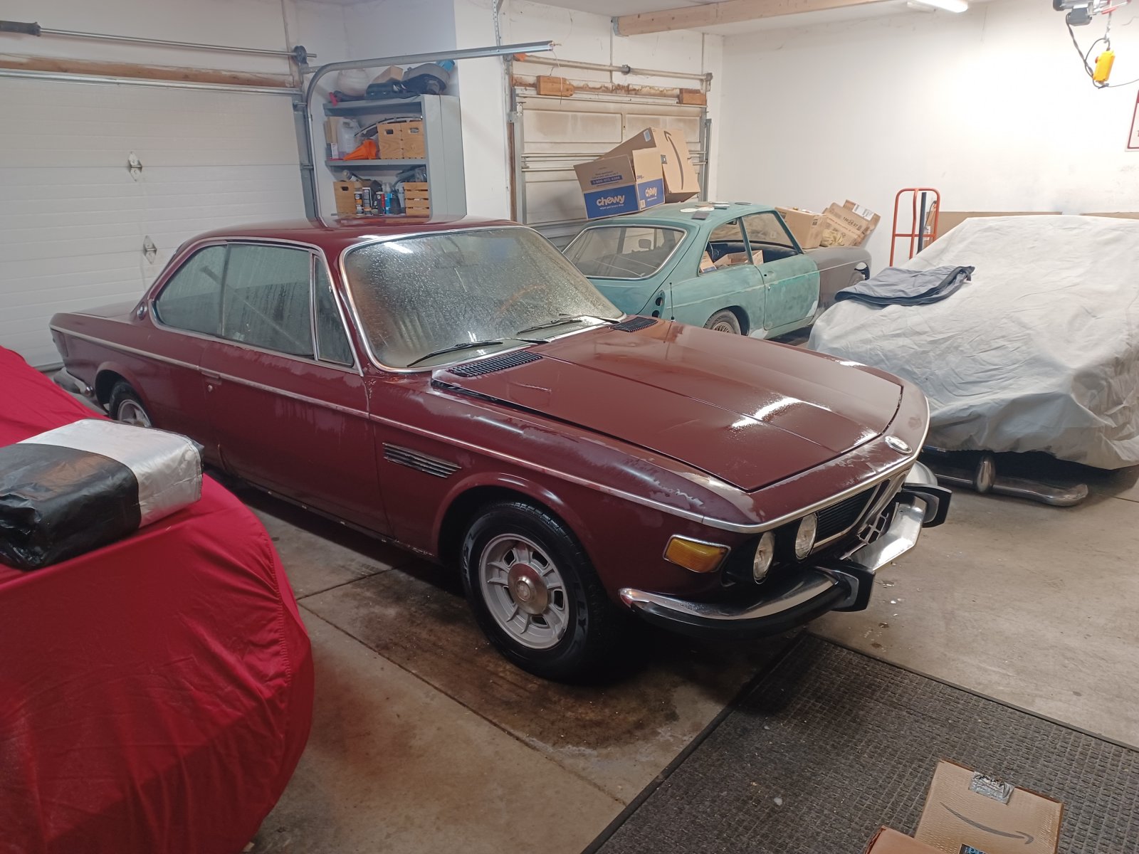

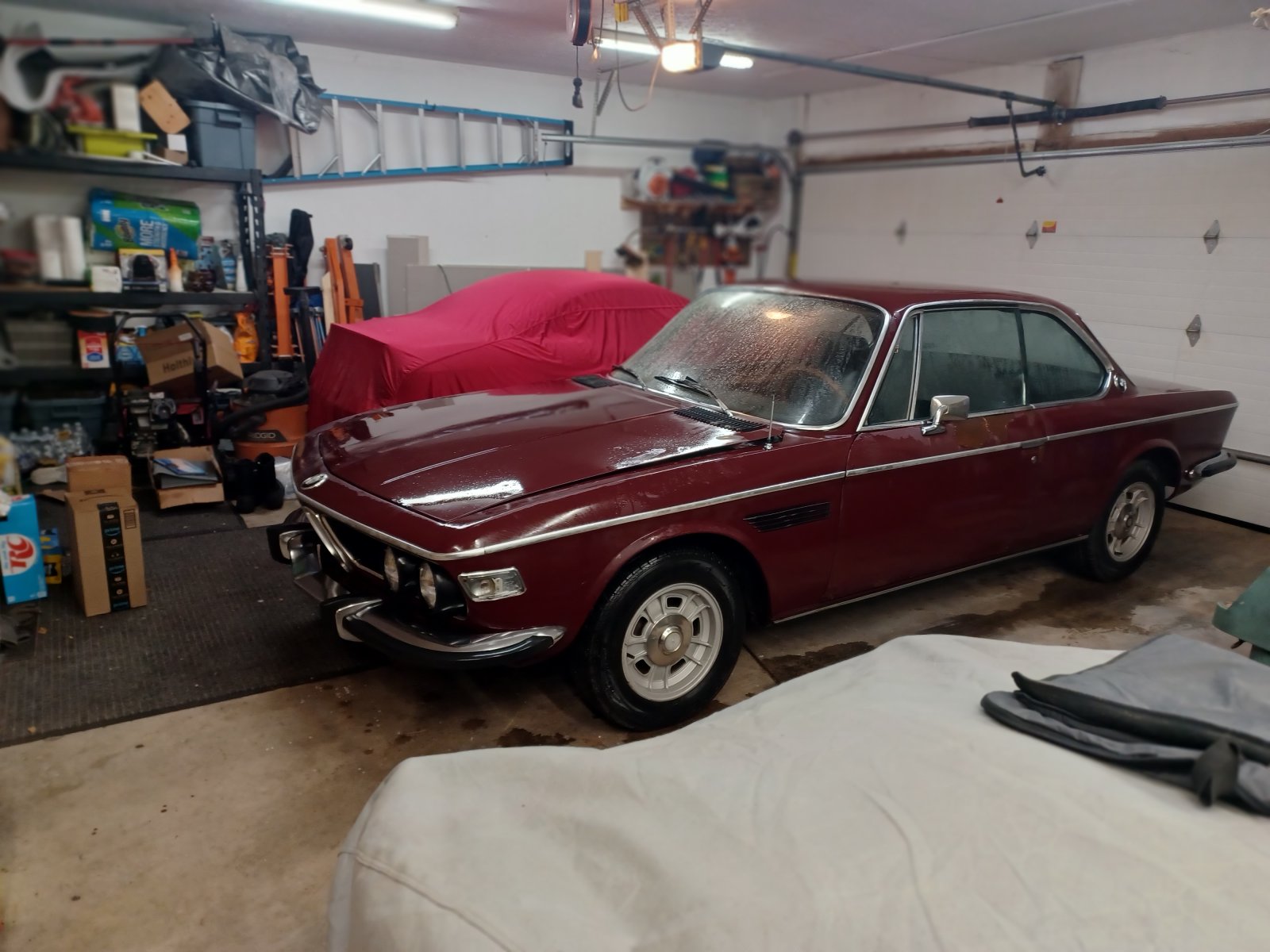

But it just arrived tonight. Lots to dig into. Lots to look at and go through.
Will take some pictures as I start sorting through it.
It has to go into storage shortly while the new garage is being built... because as you can see... I'm out of room and the car is in the wife's spot. She's a saint.

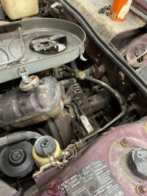

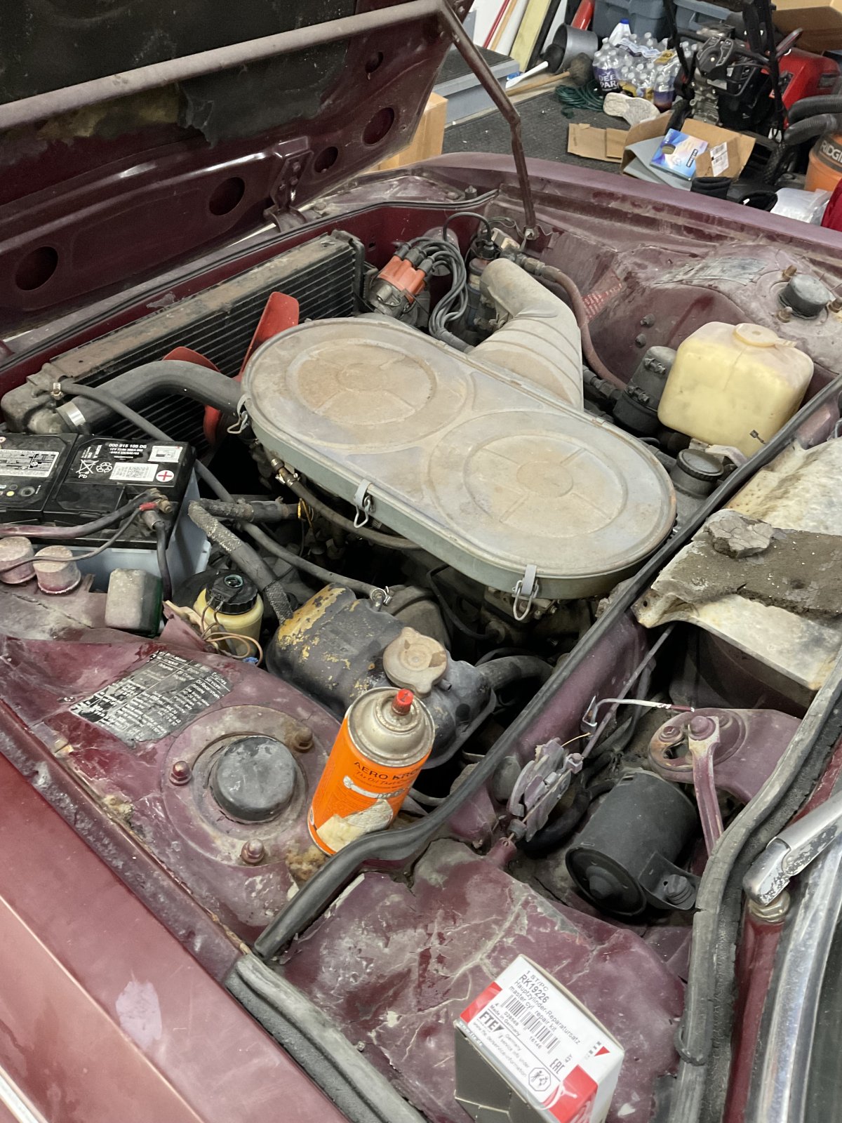

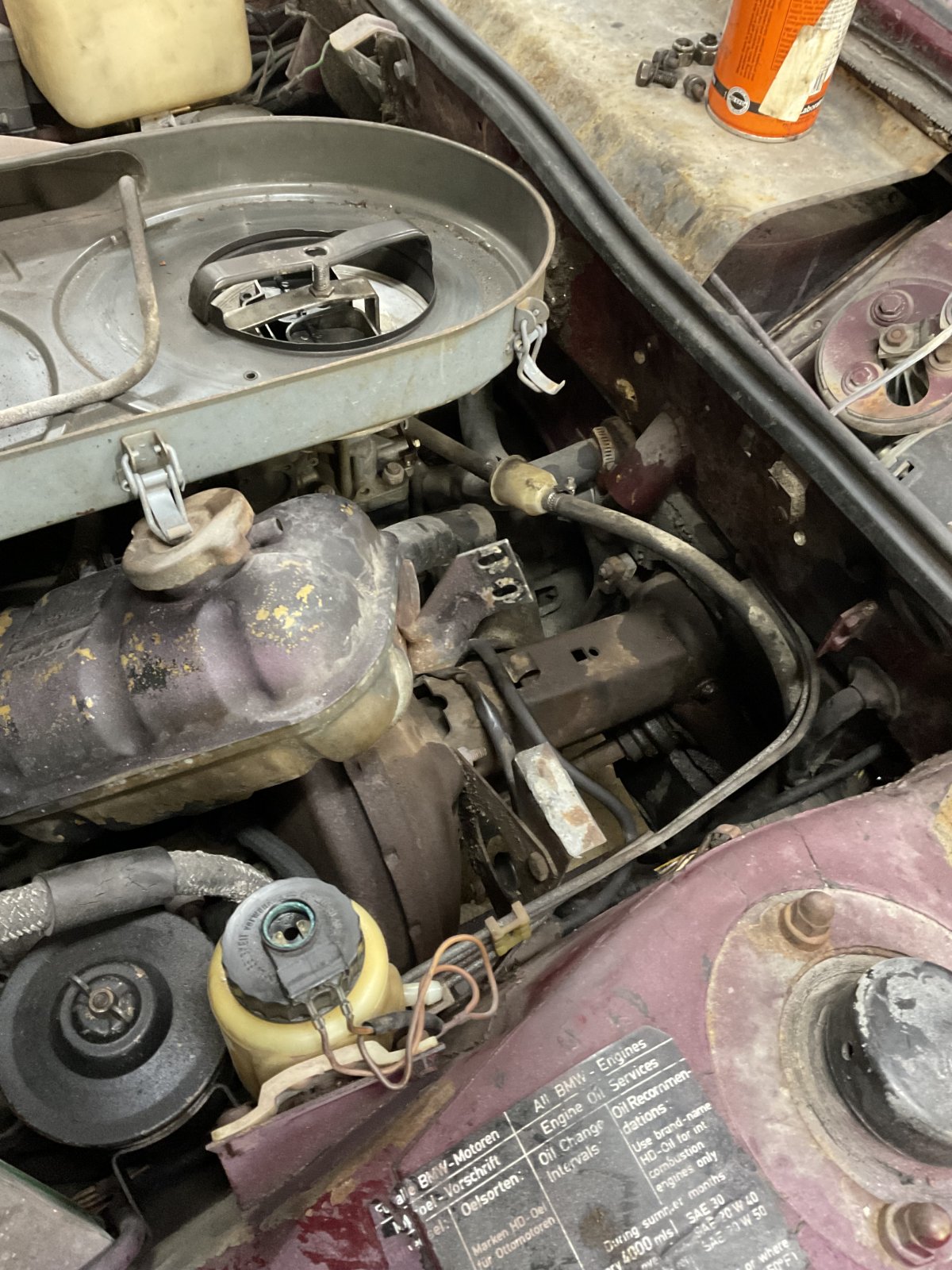

Well…. Here we go. Engine compartment… not bad. Seems like most everything is here. This is like a time warp for me. Trying to remember 30 years ago when I worked on my old one. It’s flooding back to me quickly.

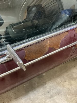

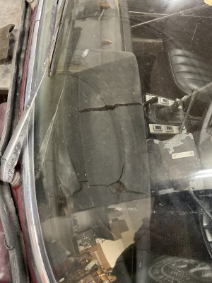

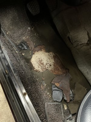

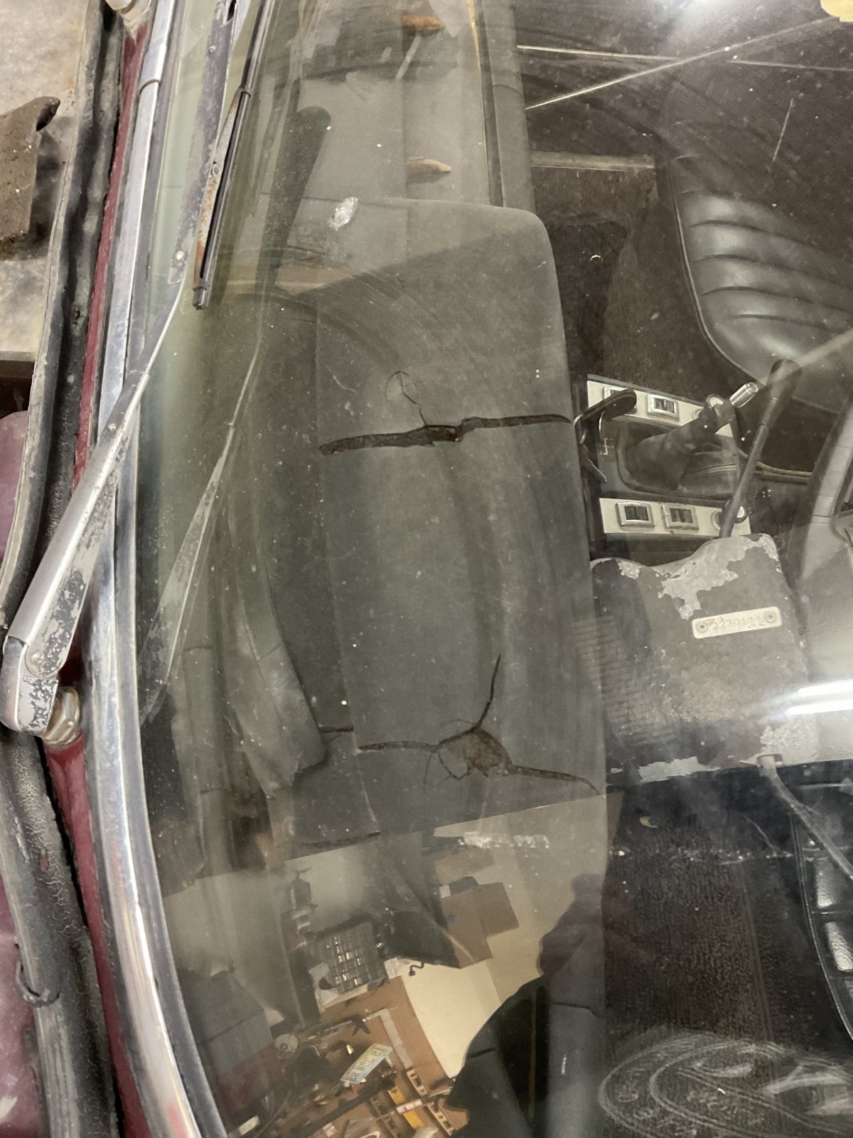

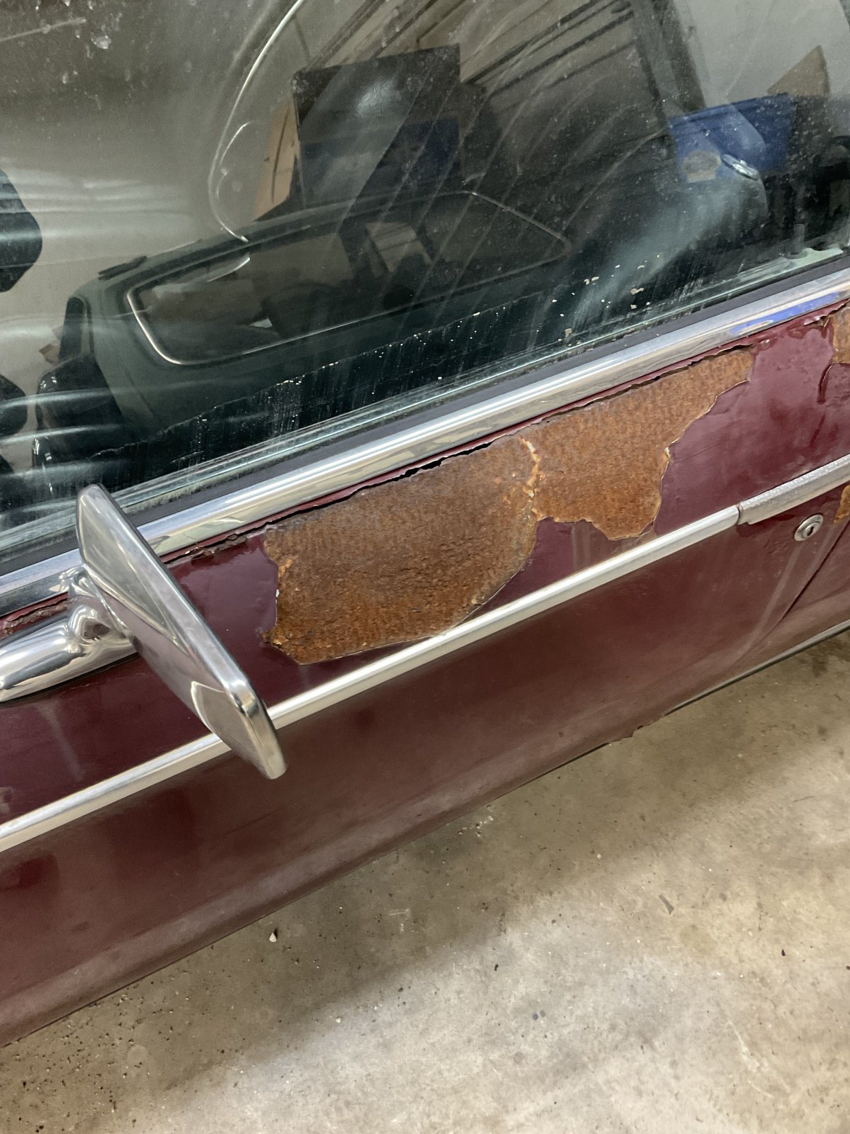

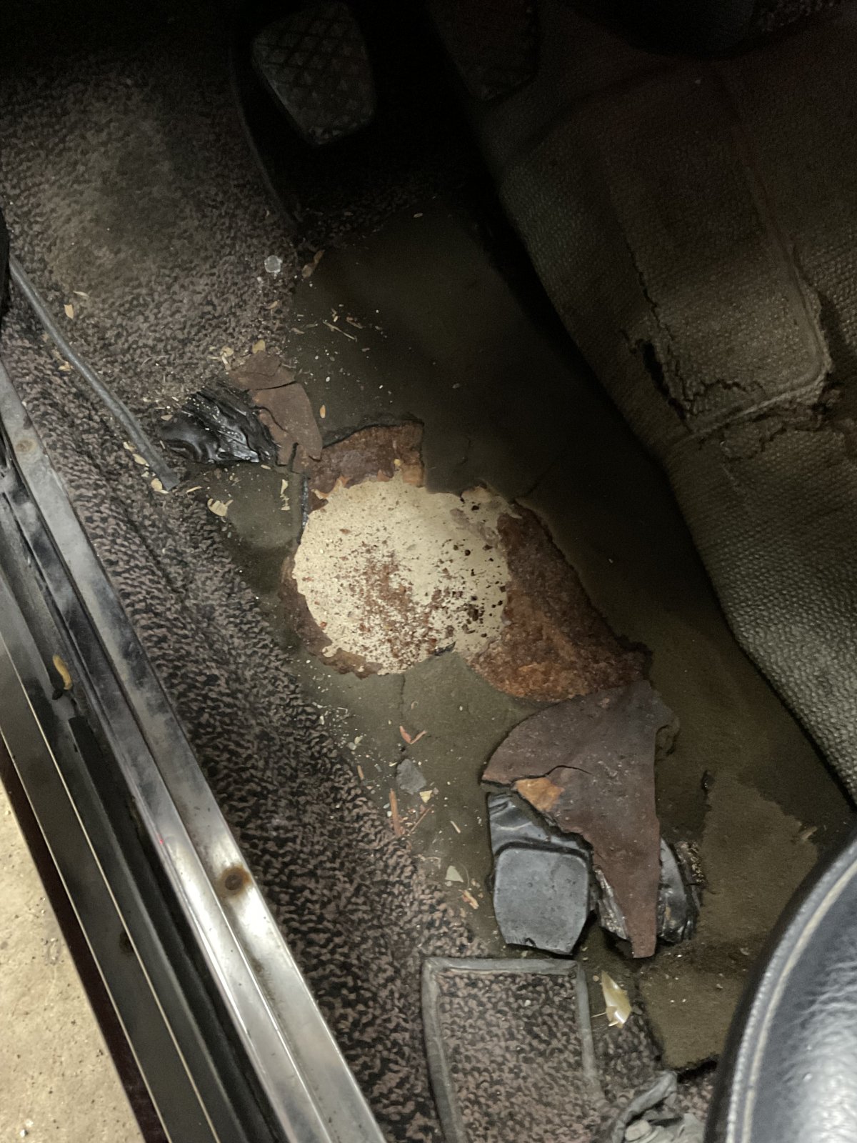

Lots of work to do. Some parts I could not see in the auction… some destroyed dash parts. Obviously covers will go off for refurb. I’ll do the wood. But all in all relatively pleased with the completeness.
i totally forget what the switches under the dash are for… it’ll come back to me.
There certainly are bad things… rust through on the door. Many crunchy places.

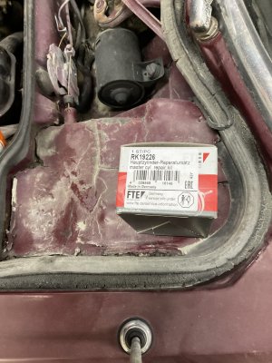

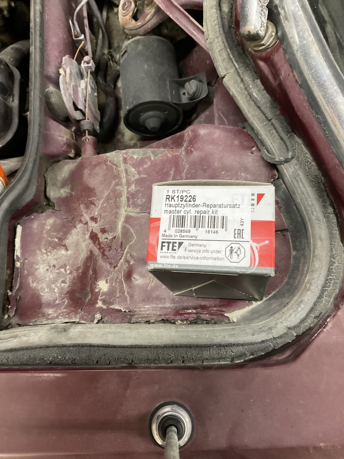

First things first… have to get her moving under her own power.
Clutch master is leaking fluid everywhere. Nicely enough… came with a rebuild kit.
who knows what the slave is like… one bite at a time.

If you have the original 4 speed it will have the pricey cylindrical slave, not the inexpensive ones that came later.

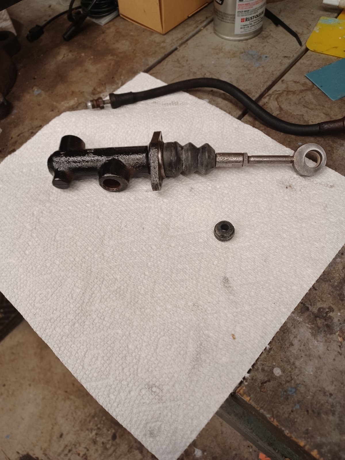

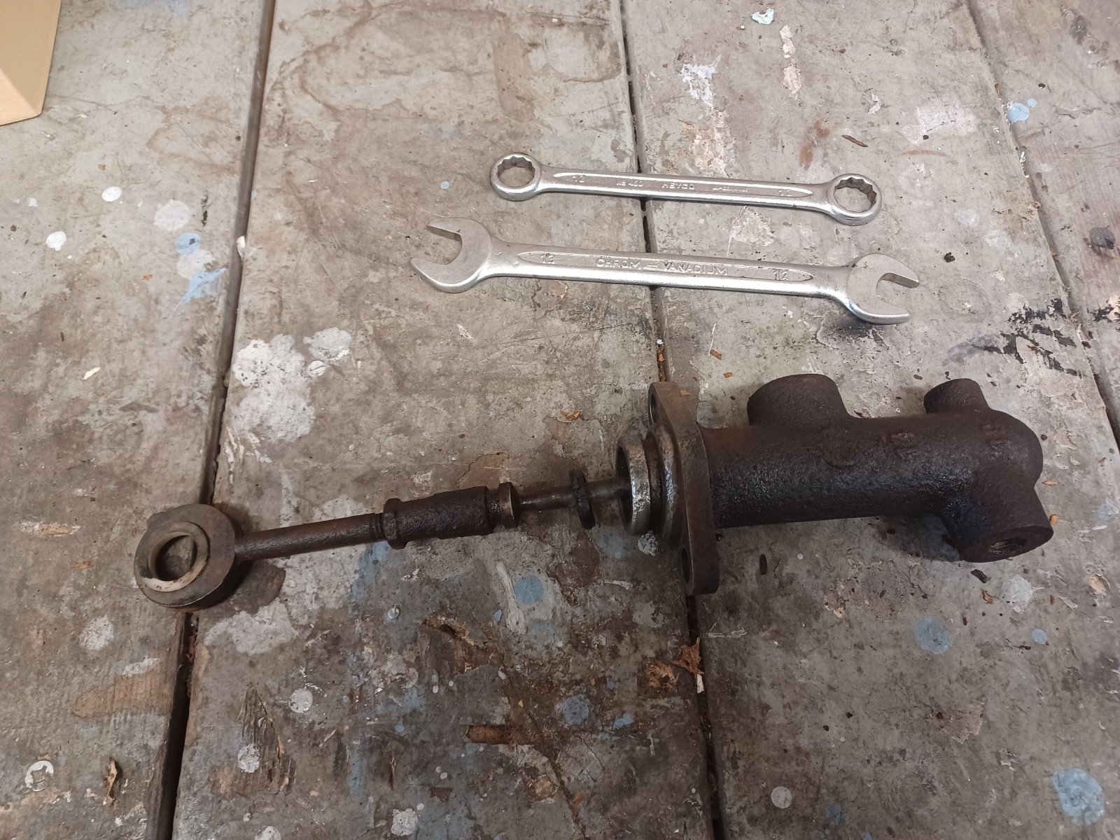

Slave is soaking. Everything came off fairly easy. Master to slave hose even came off okay. It will be replaced but that’s not where we are right this moment.
Obviously you guys know what those wrenches are... they have been in my toolbox for almost 30 years. From my old 2800.
Master rebuilt and ready to go back in. No show and tell as there is a great post here on how to… thanks for that.

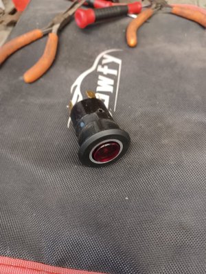

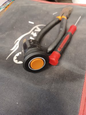

Thanks for the tip on switches guys.

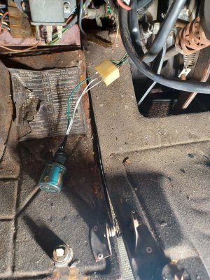

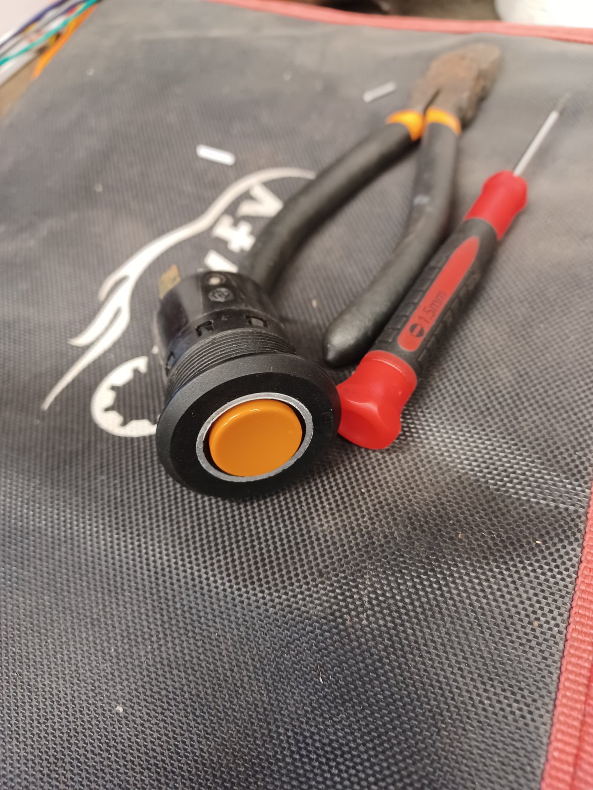

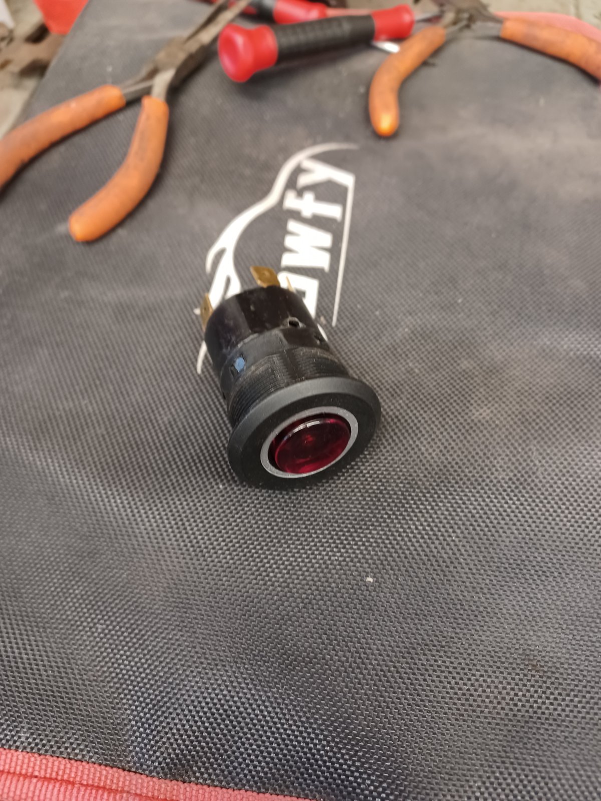

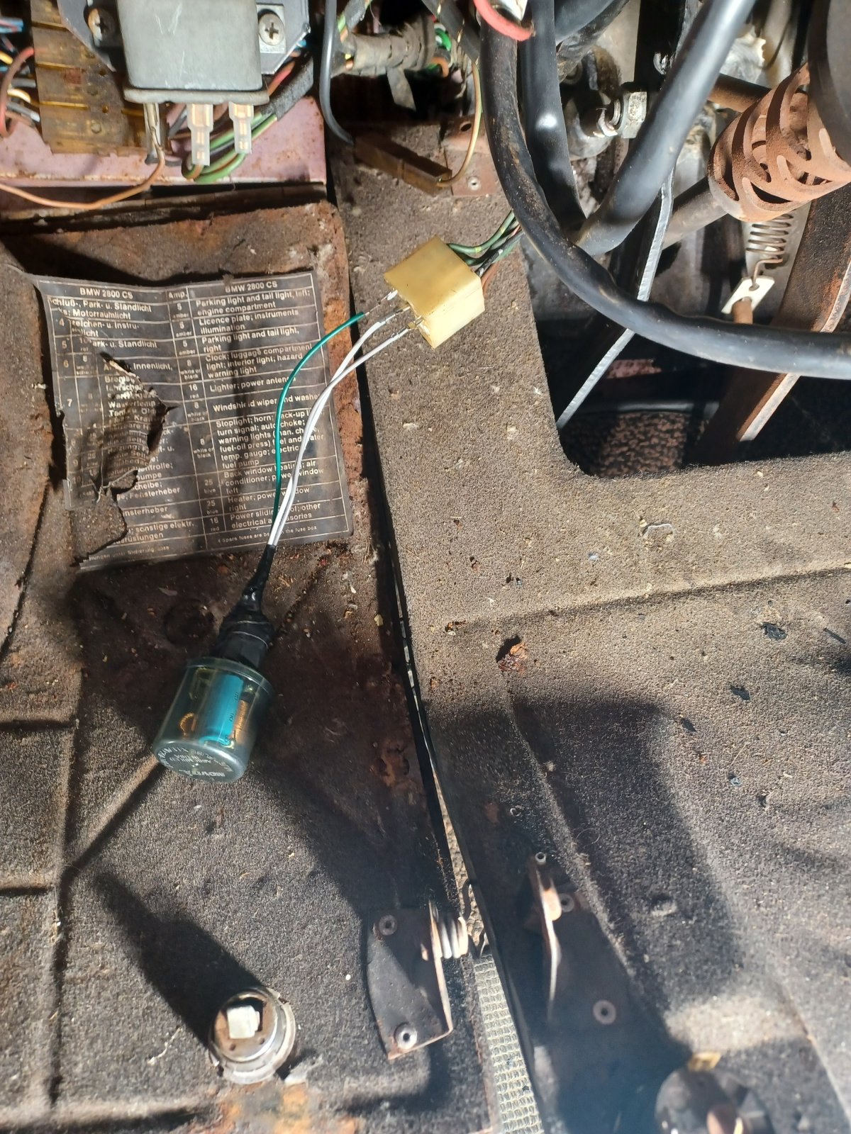

Fixed both the hazard and defrost switch today while I was fixing the turn signals.
Also. Did the fix on the hazards I found on the site as well. Picture is of in progress. I wrapped everything up nicely….Not as fancy as some of the fixes some of you did but it's what I had on hand.
