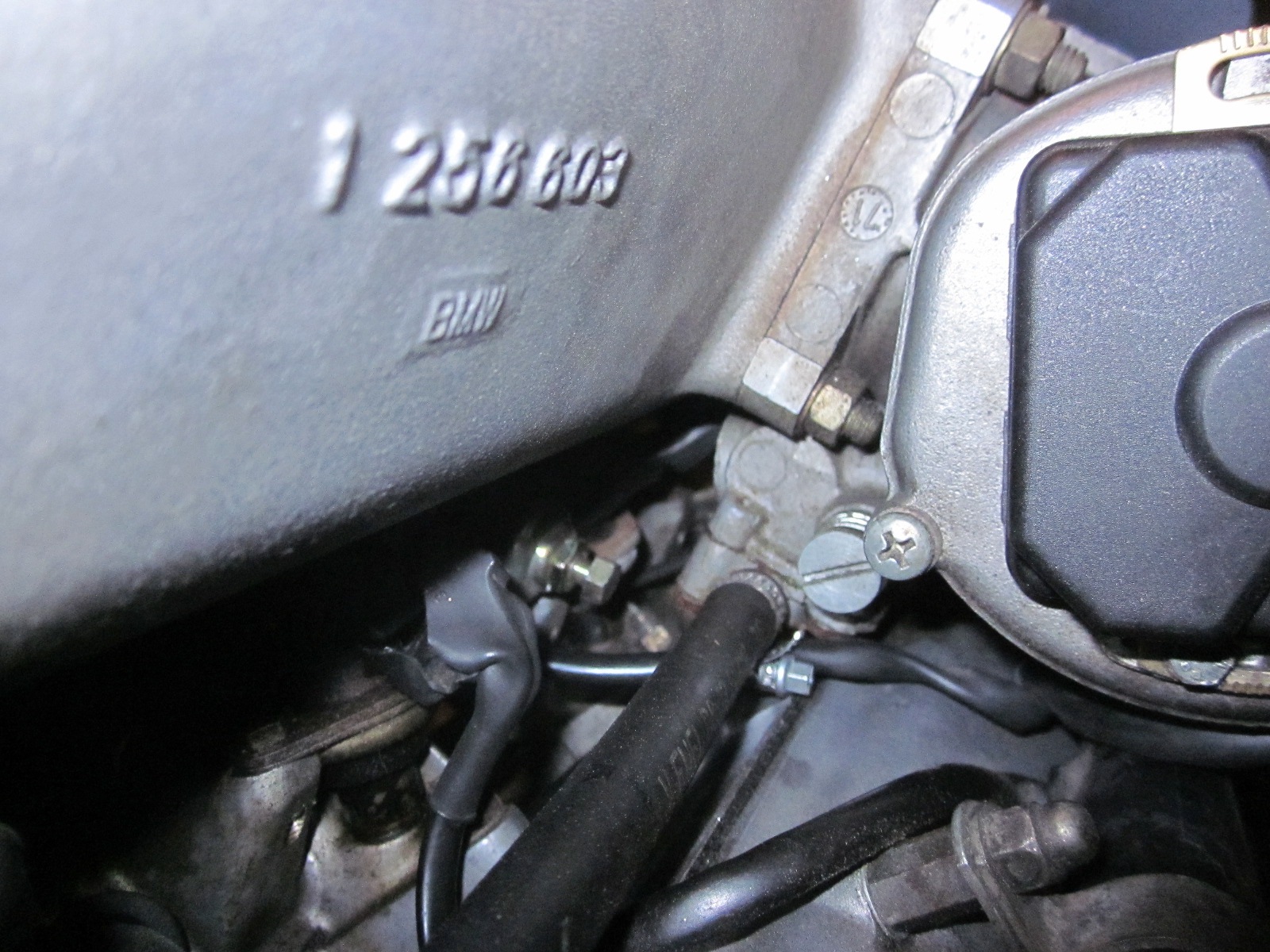

May need to simply adjust the large screw under the throttle body facing the firewall, counter-clockwise 1/4 to 1/2 turn in 1/8s test drive & repeat as necessary until the stall condition stops.

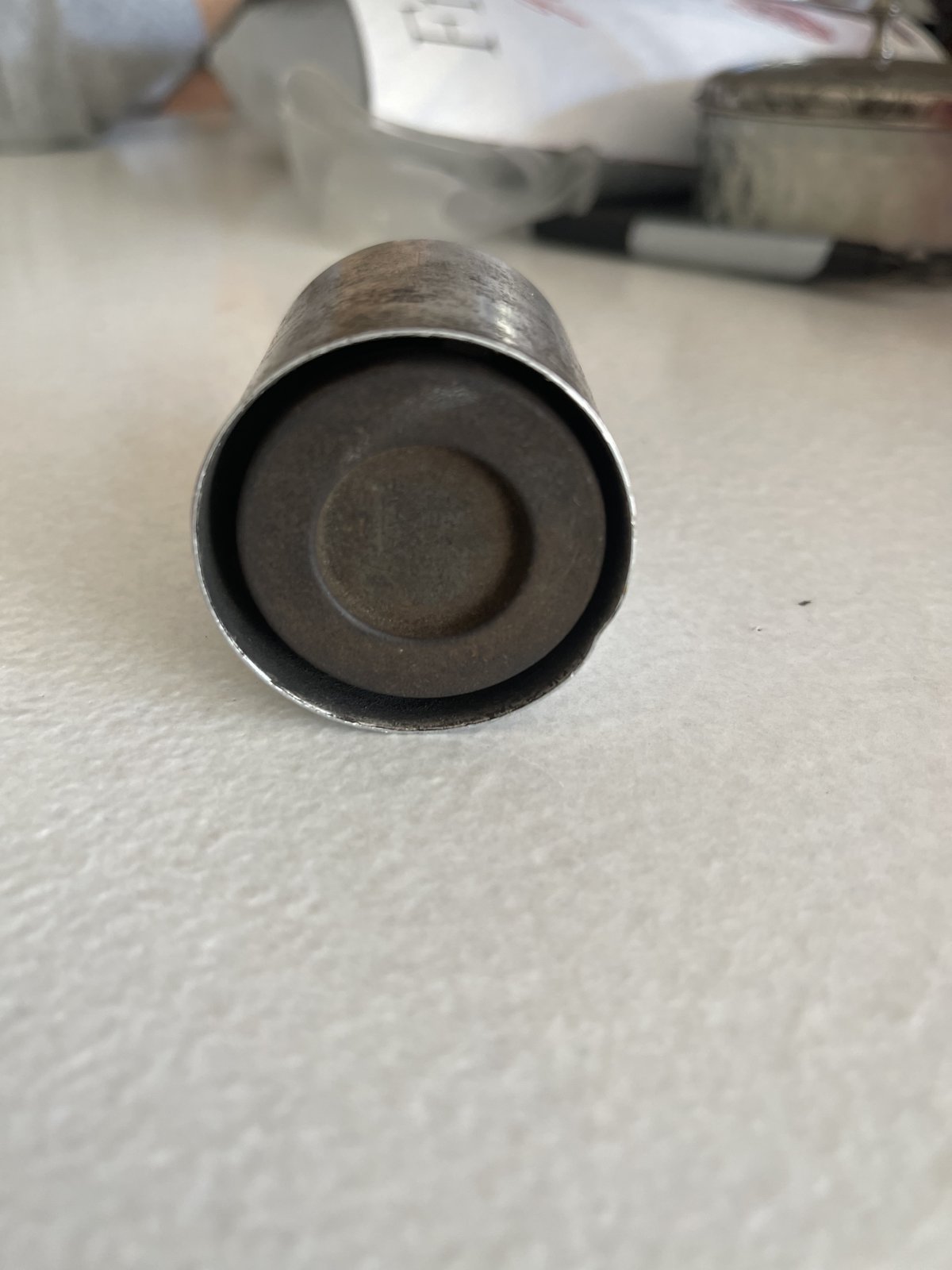

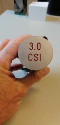

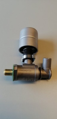

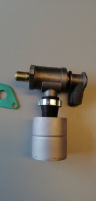

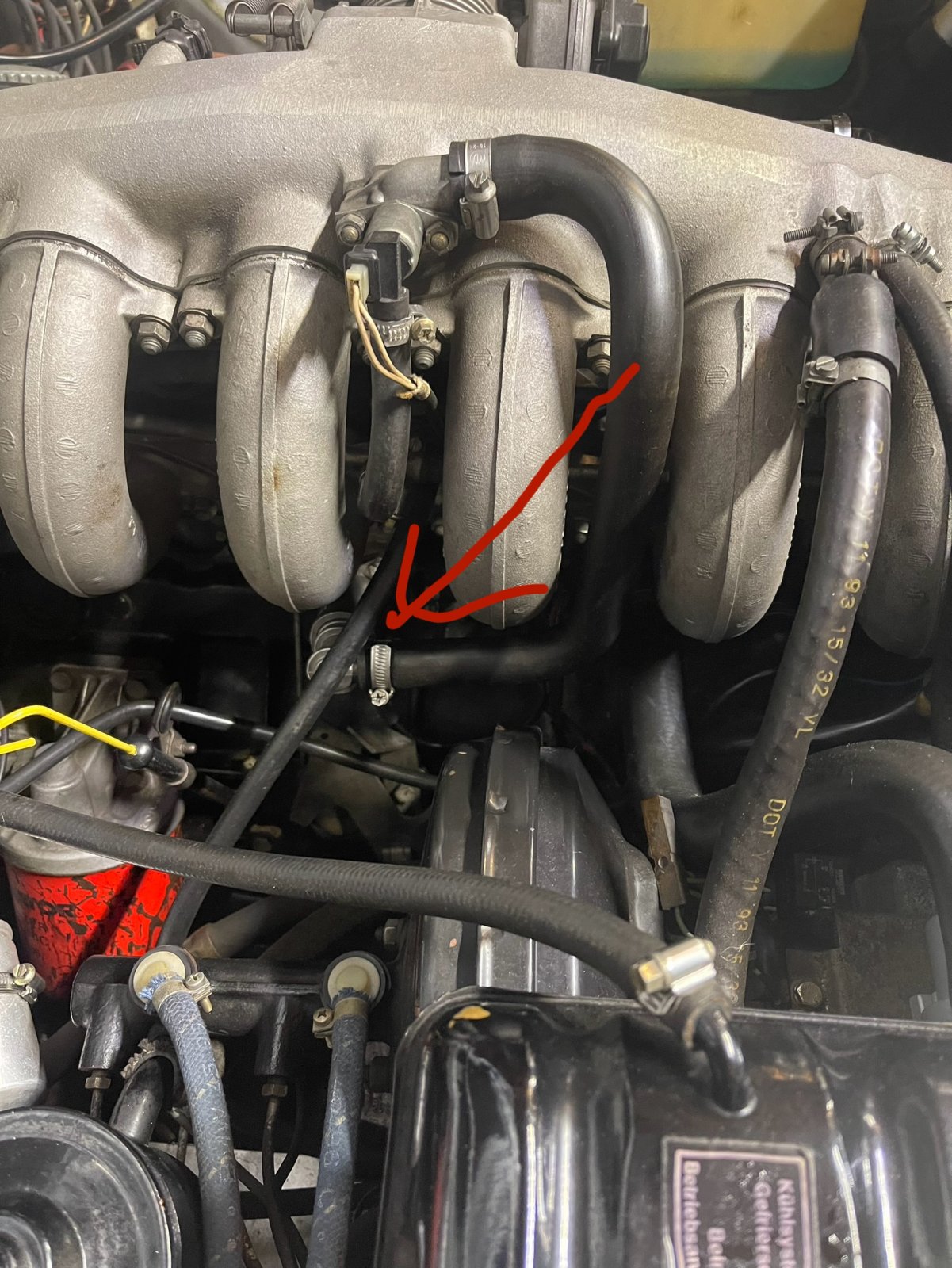

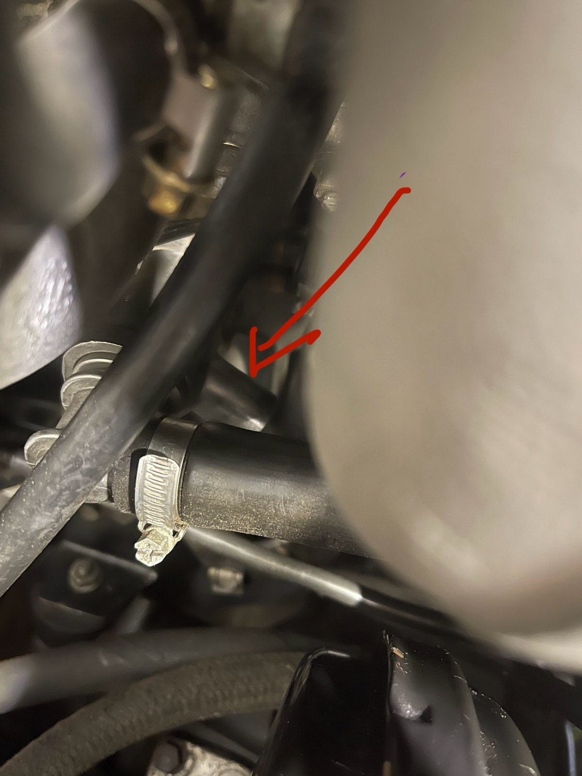

Thank you! I’ll do that. I, however, did a smoke test and found smoke pouring out of this piece in the first picture. Smoke was coming out of the bottom of it (4th picture) and well as where it connects to the pipe.. I have no idea what it is. It was attached where the red arrow is in 2nd pic. The zoomed out picture shows you where it’s located on the engine.

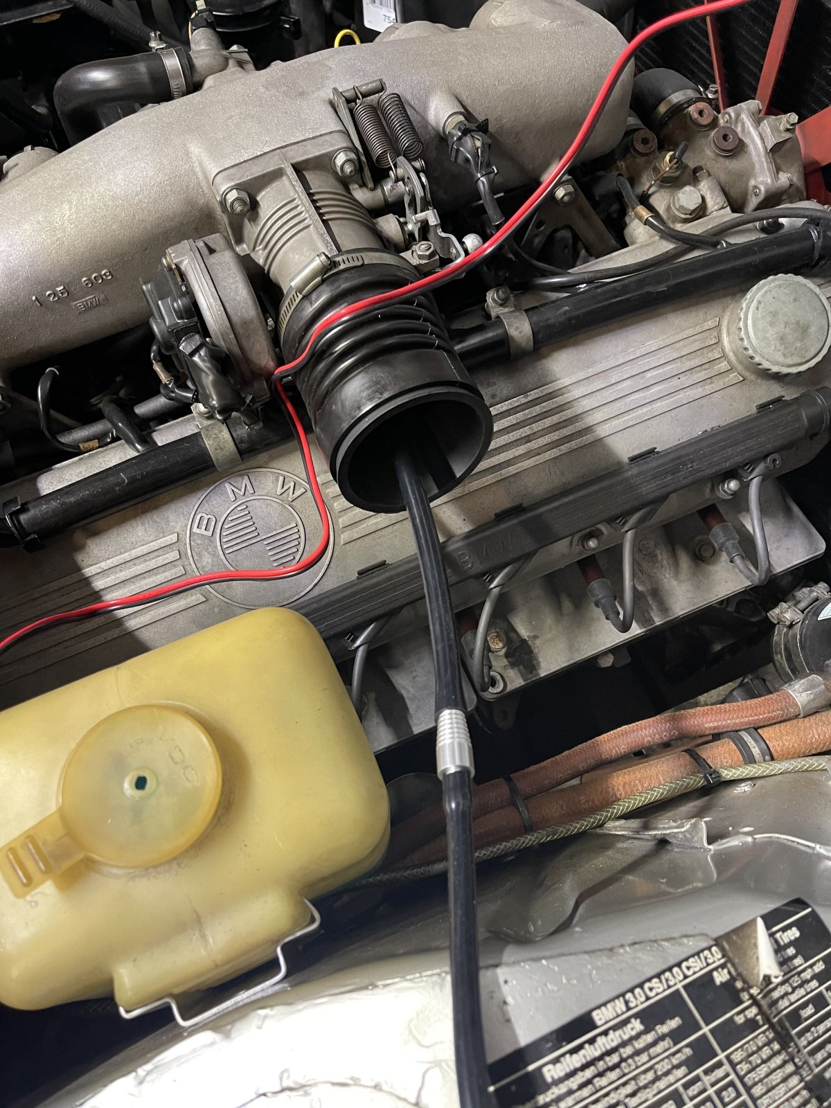

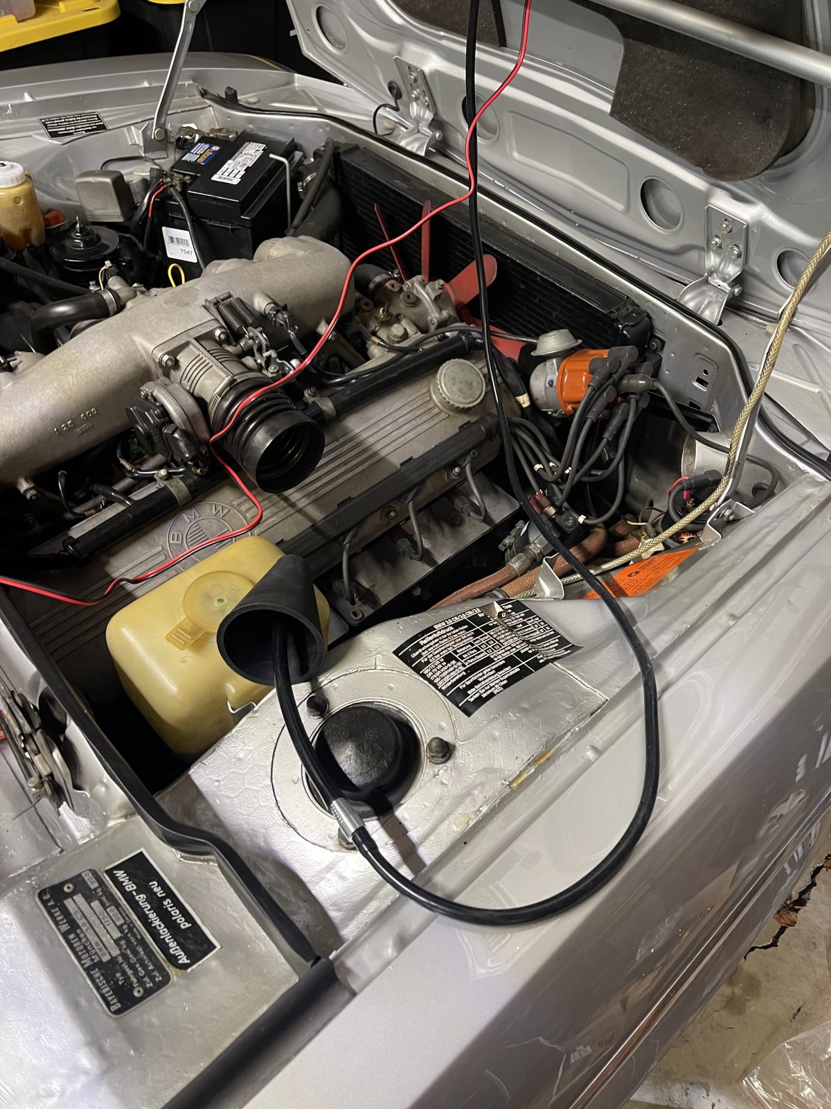

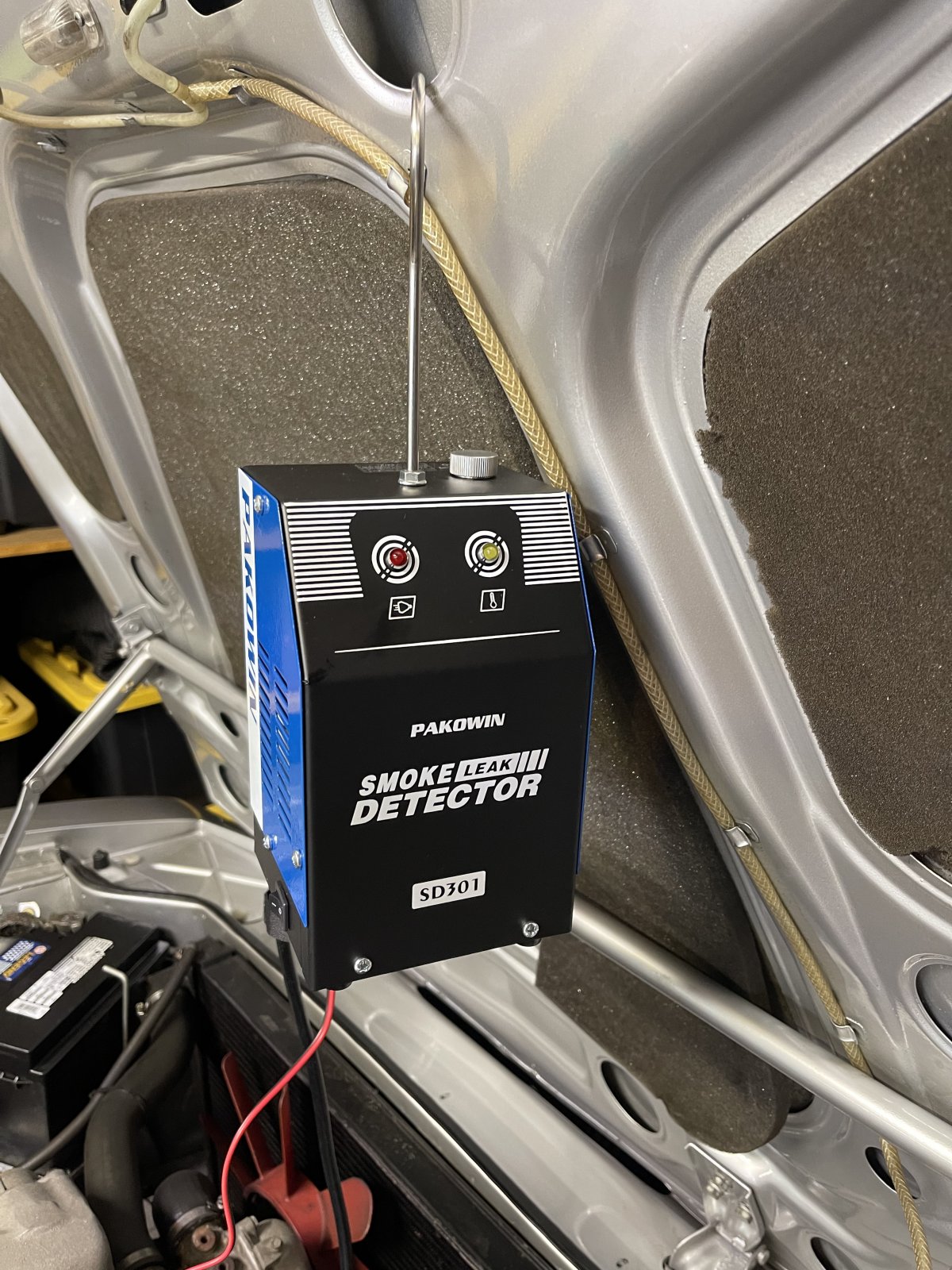

I did - used a smoke machine and it came pumping out of that part that I removed in the pictures I posted above. I have no idea what that part is. Some pics below how I hooked up the smoke machine.

Aussiecsi
1,129
338
Perth, Western Australia
I believe that's the air filter for the air slider/AAV ( this draws in air on startup and remains open unti running temperature is reached ). I doubt that's the issue and would be inclined to adjust the "large screw" per Andrew's auggestion above .

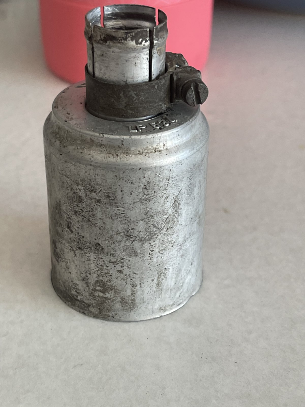

That little canister, IMG_5229 is the called the Auxiliary Air Slide Filter. IMG_52230 & 52231 is where the neck of the can attaches to The air filter IMG_5232 that black thing in the middle is the Air Filter. It is part of the D-Jet Warm Up Regulation System for the 5th injector in the middle of intake runner side & sprays fuel into the throttle body on cold start at this point the Auxiliary Air Slide is fully open. As the car warms up, the 5th injector sprays less & less yet will still drip the Aux Air Slide closes in a similar fashion yet still let a little air through. This is a similar system on the 2002Tii with the bees wax filled Warm Up Regulators
On the newer Aux Air Slide Filters, the air filter is merely 2-sided taped in place & falls out easily. I found a small generic cone filter from a parts store has the same size filter. So I put the cone side in & peened the edge of the canister in & burnished the bottom end to hold the little cone in place in 2012. May be time to revisit that project & replace the filter.

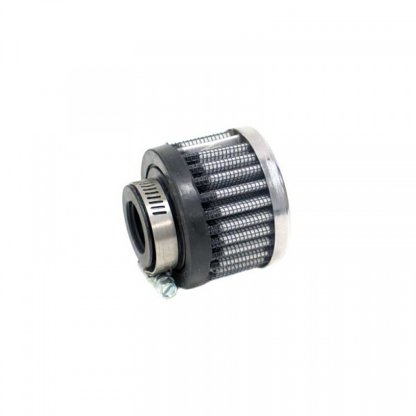

Wow - thank you for that. Is that part not available anymore? Also - it seems like the consensus is that this filter is not the cause of issue I’m having. I’ll try adjusting the idle with that screw. But I’m guessing that this filter needs to replaced anyway. Would this work in its place? It's a K&N Crankcase breather filter

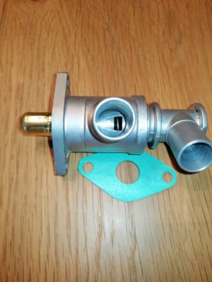

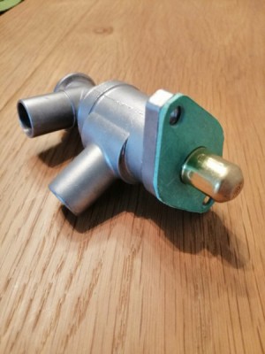

This is what the whole Aux Air Slide / Filter looks like. A German forum member was selling these till recently.
Original part# 11 61 125 6467 and 11 61 125 6507
