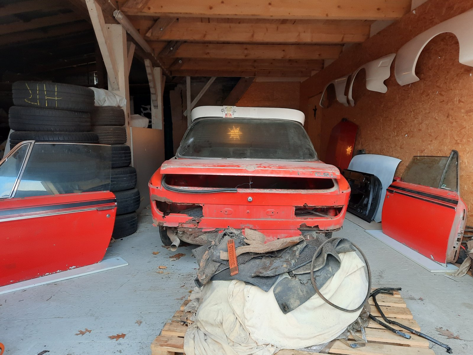

Well, I knew this question had to come up some day: "Thomas, what about your progress??"

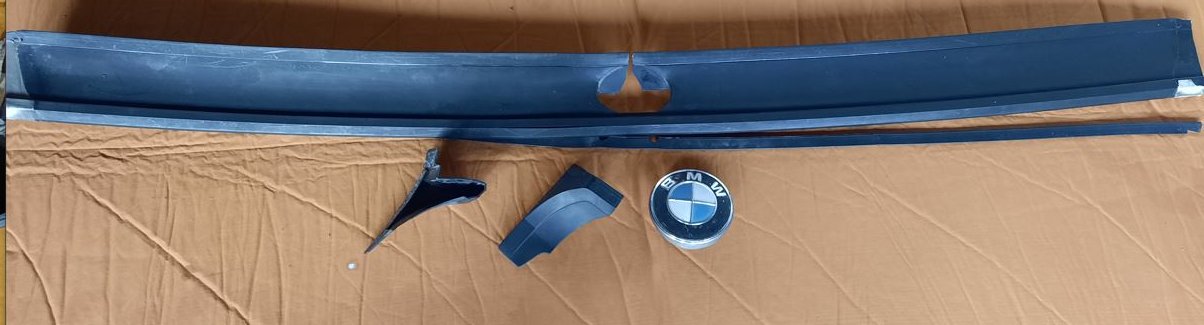

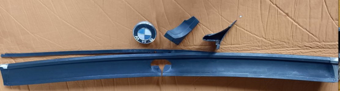

So lets start with the tail end, which is one of the most important part of BMWs (most other drivers see the front of a BMW for a glimpse in the back mirror, followed by a deep-drawn sigh looking at the tail of that car just past by!).

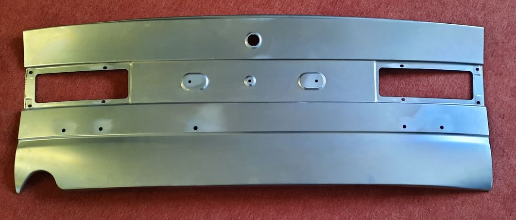

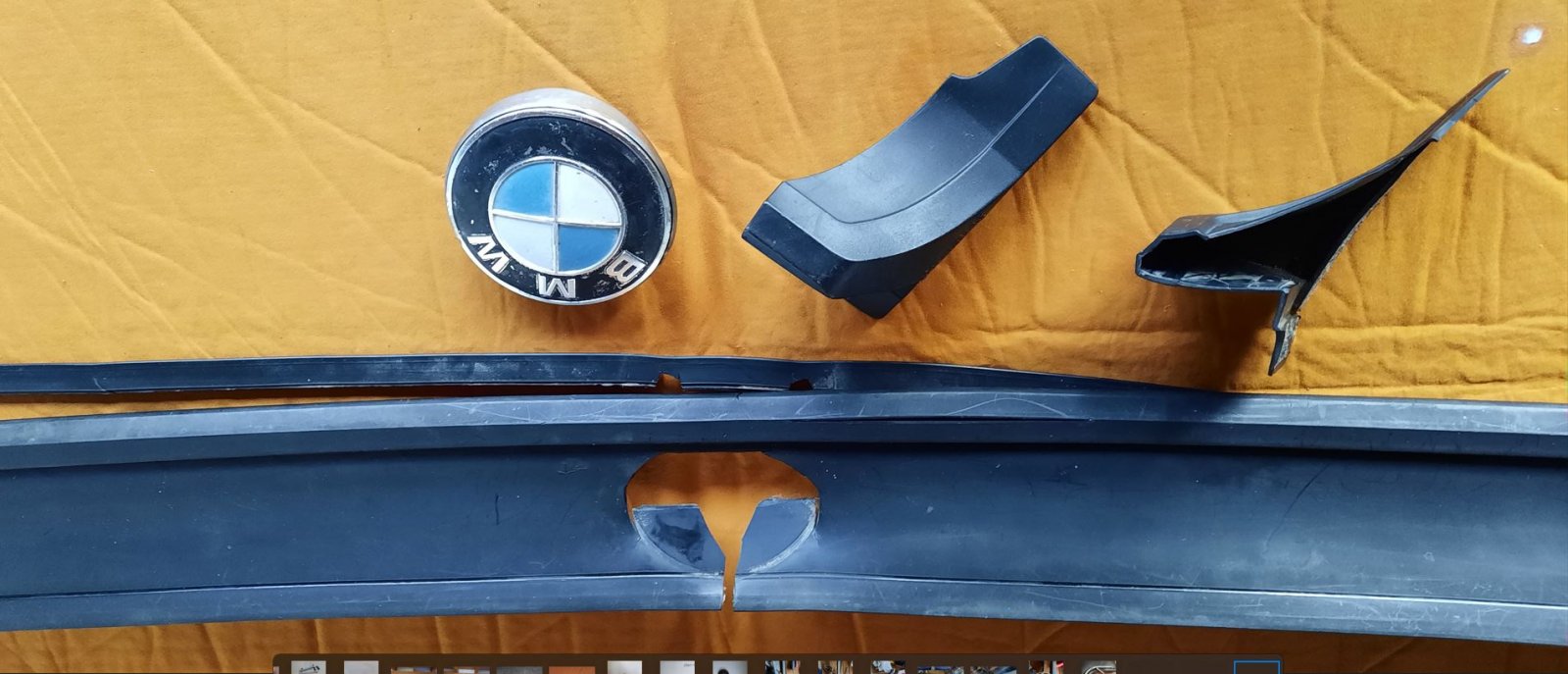

In fact the tail end was the first part I bought:
It´s a thin sheet reproduction available here, double the price you would pay for a standard W&N part.
As you may notice it´s the non-foglight version!
I found these NOS parts for the trunk:

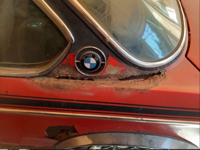

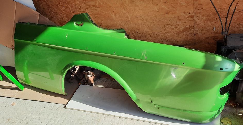

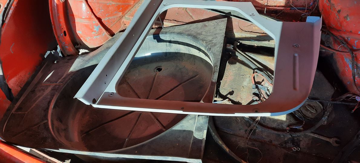

The tail fenders need some attention:
I found these;
Enough for today, to be continued!

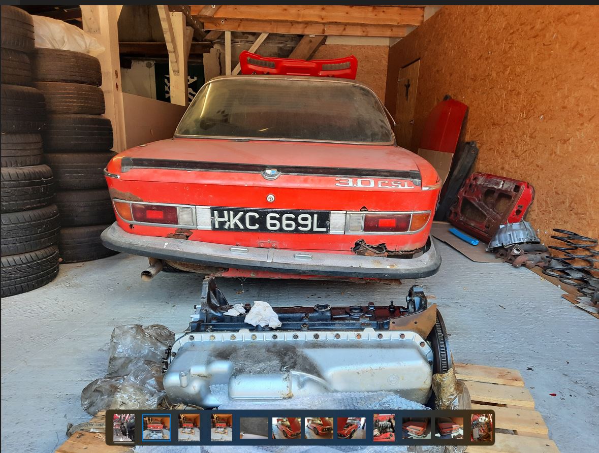

Yes, UK plates:

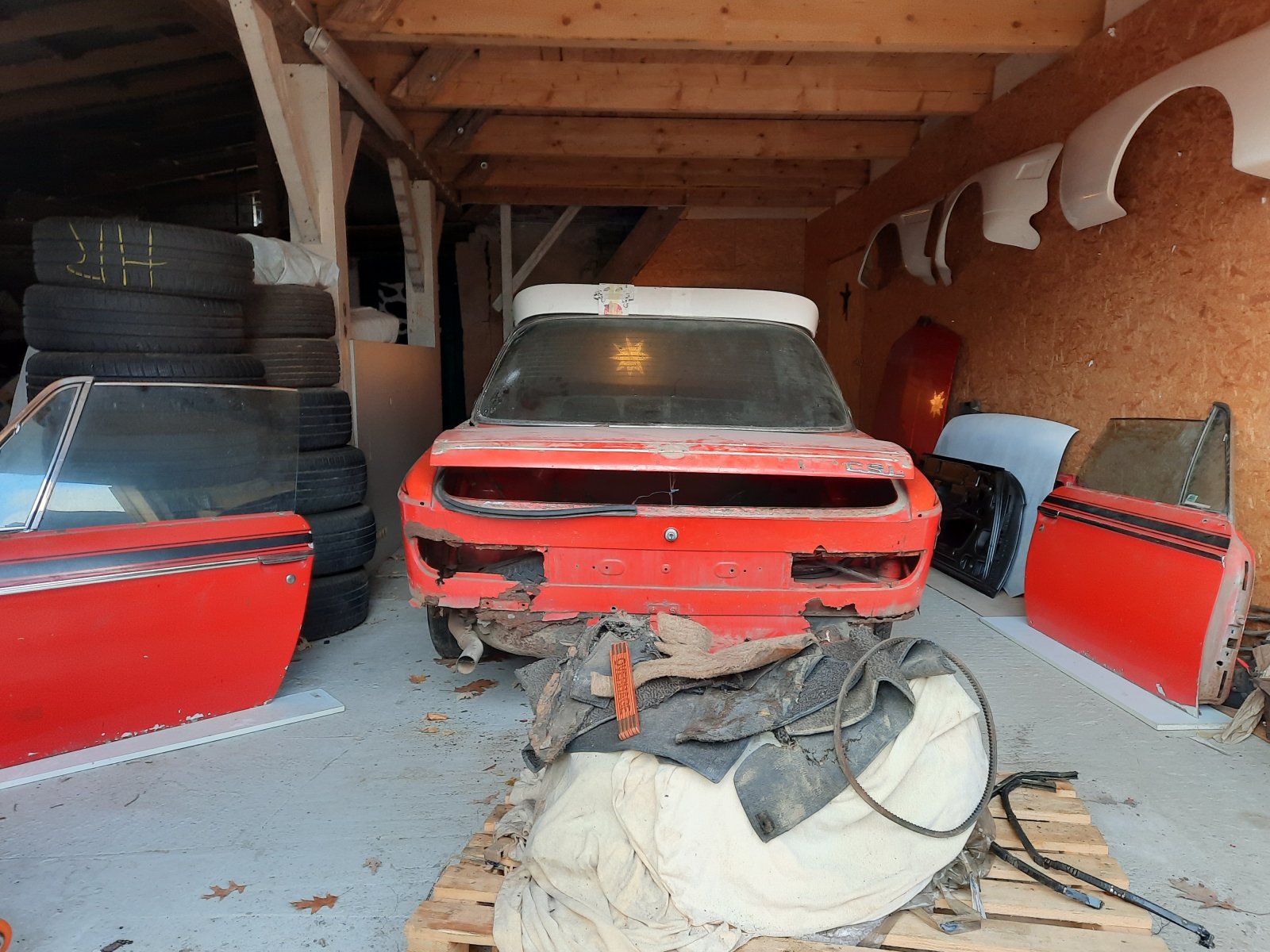

And a new engine I found!

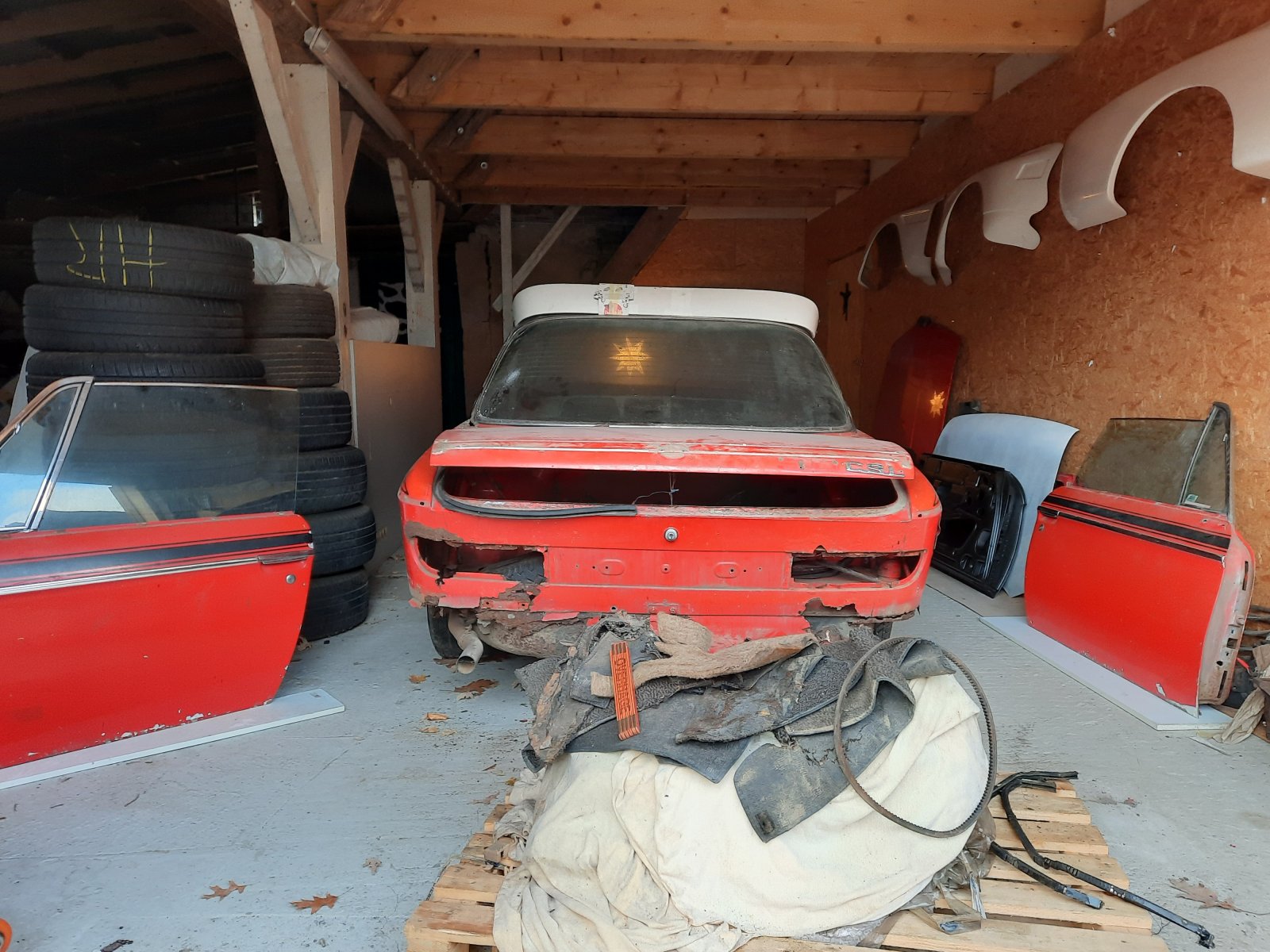

The tail bumper came off easily, just a kick and it fell off, put it straight to the scap, got some nice spare ones already!
Note that the "City-Pack bumper" did not come with the underriders!

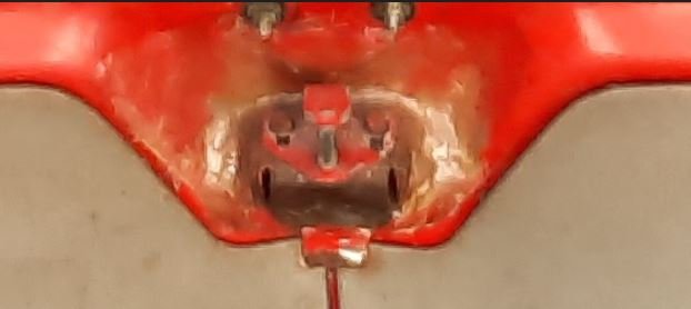

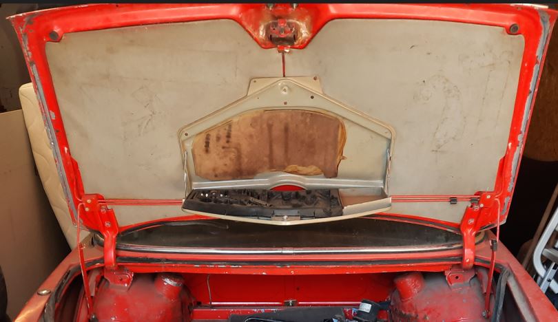

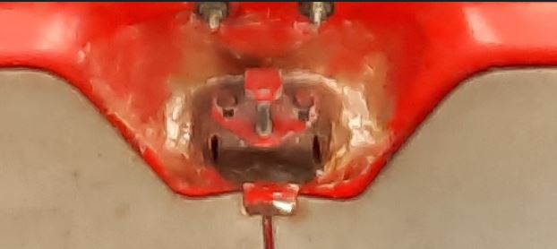

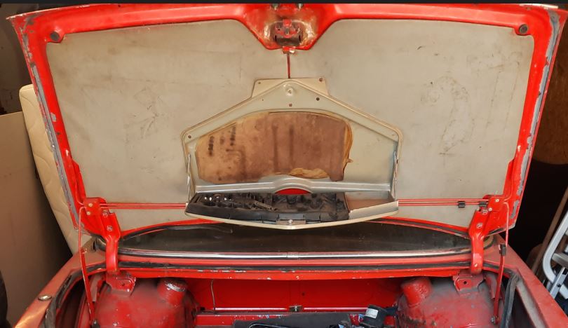

The trunk lid is the aluminum type. It`s still in a very good condition except the bootlock.
It is fixed by rivets to the aluminum lid. The area around has been repaired using glassfibre, I will have to remove the glassfibre to check!

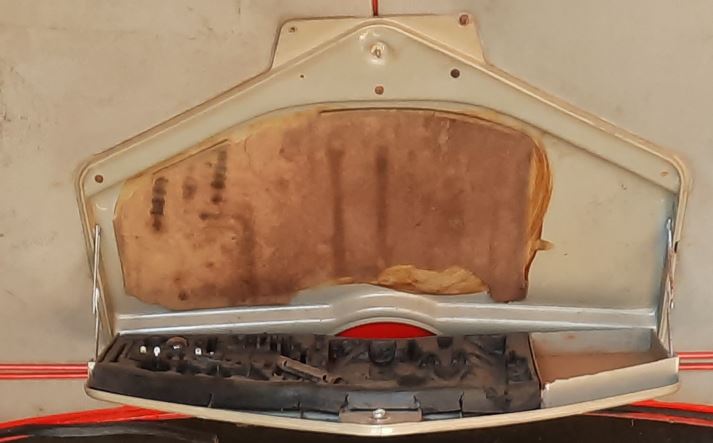

The "City-Package" trunk is equipped with
- the big tool box in a good condition but most of the tools gone
- boot lid covers in a good (but dirty) condition
- hinges
- torsion bars

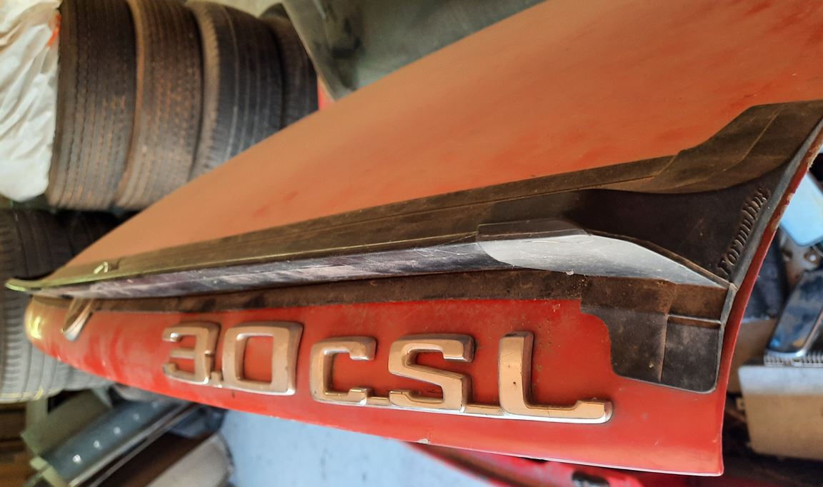

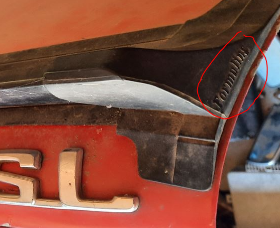

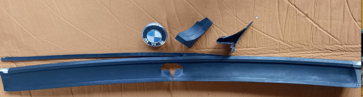

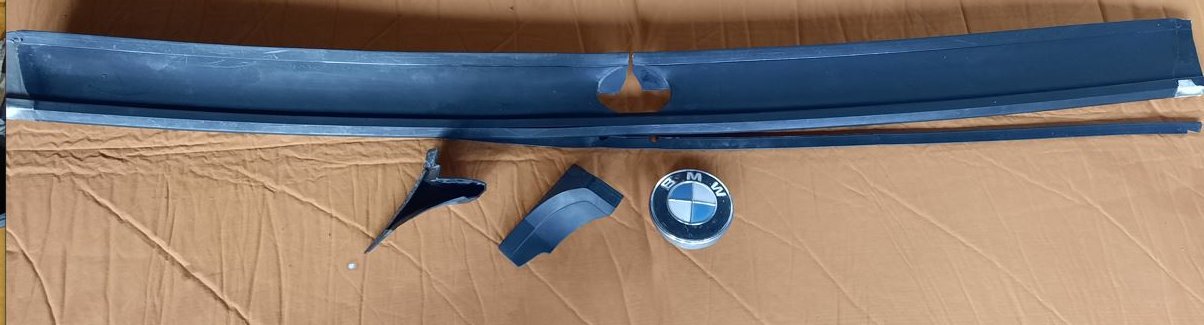

The rear spoiler looks different, never seen that before. Fixed with a kind of 3M-tape.

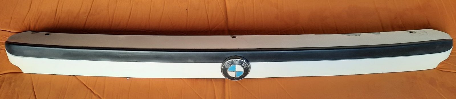

As an alternative I might install "plan b":
But where to put this then?

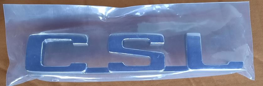

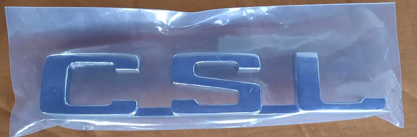

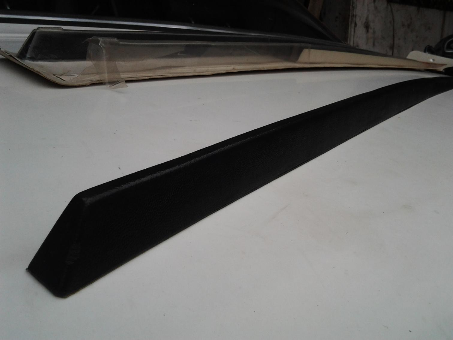

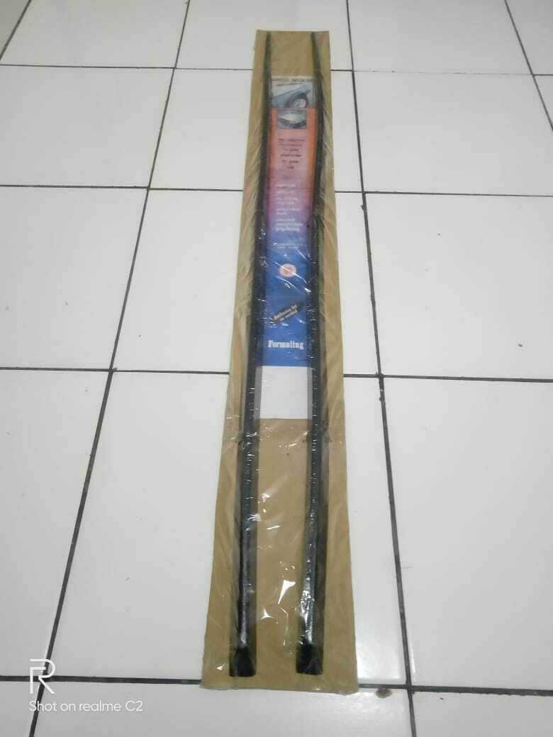

The rear spoiler is interesting. Hard to say it was only for E9 or rather universal.
Is it "Formuling" on both sides or one only?

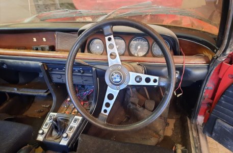

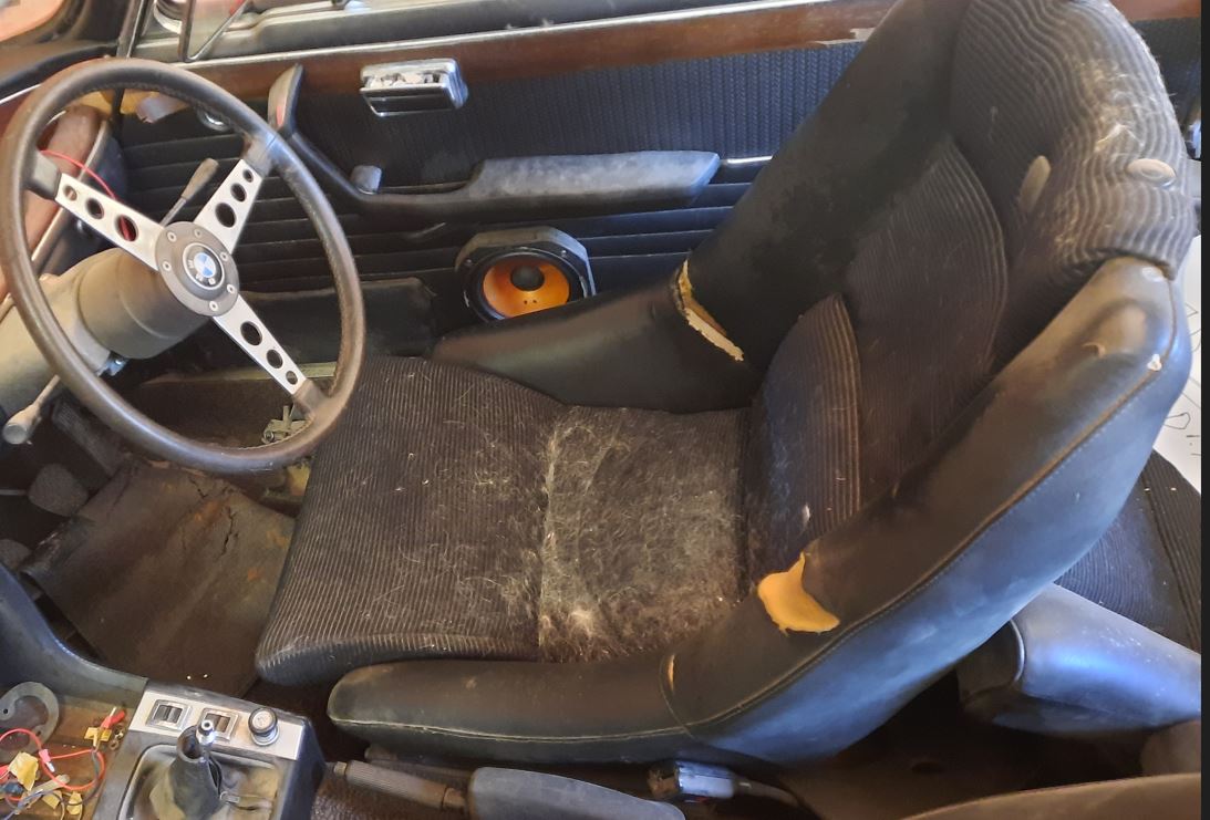

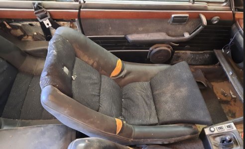

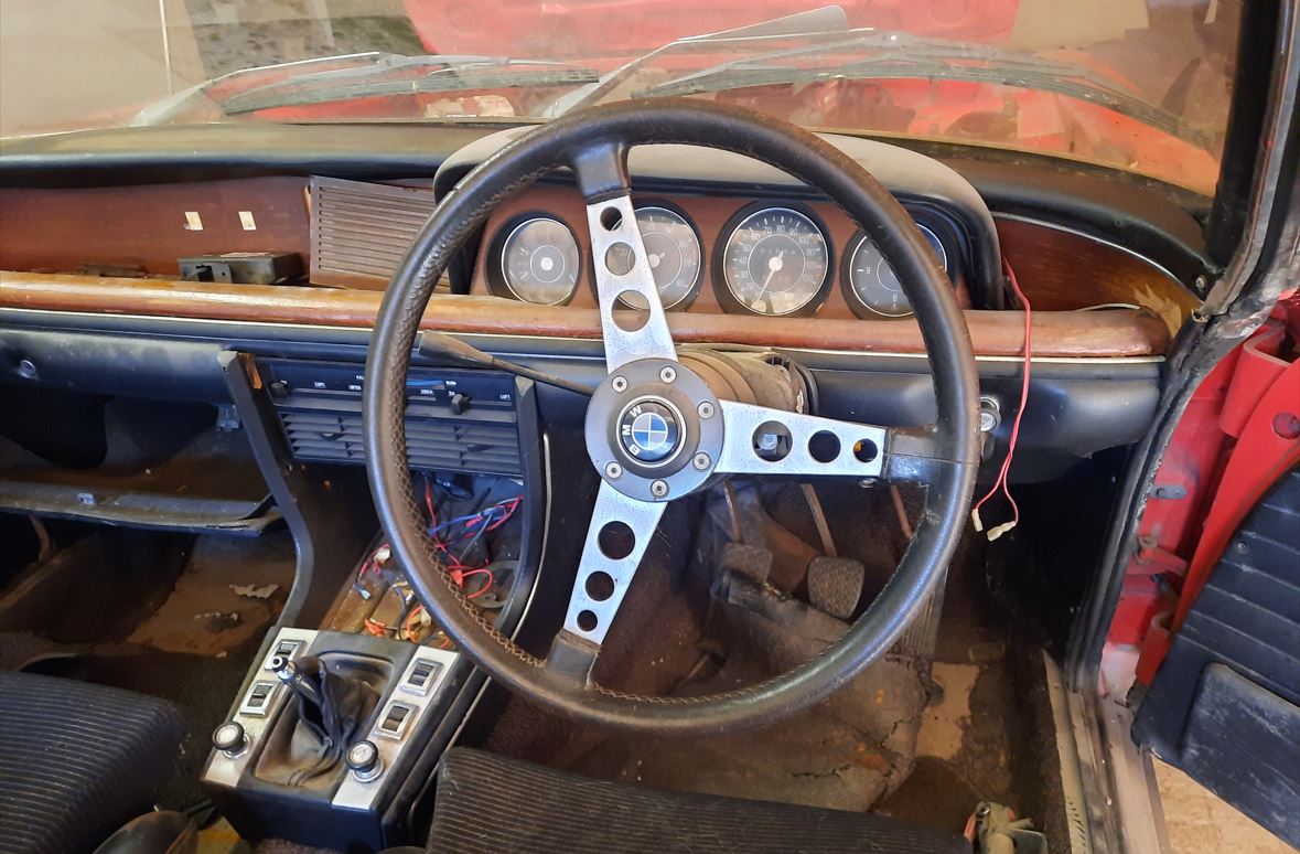

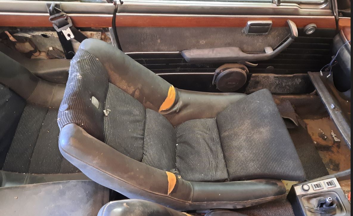

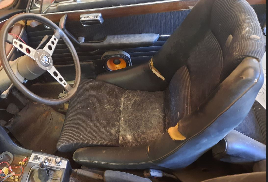

Let,s have a look inside:
"Darling, my ash-tray is full, we need a new car"
No cigarettes, only parking tickets!
The photos in the auction catalog didn´t try to hide anything, so the buyer has no reason to complain afterwards!
The Angora cat must have loved the Scheel driver seat!
No hairs on the passenger seat, guess the cat really admired the Petri and the dashboard!

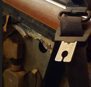

Well, the Petri received new leather already, the "Konsole" (don´t know the english word) is also with my saddler.
I started removing the varnish on the wooden dashboard piece, together with my neighbour (he is a carpenter) we will put new veneer on all other wooden parts, very special job, I will report later.
The Scheel seats are also with my saddler, I got the original fabric from Gerrit. Also found two headrests (I really care for my neck!).
You see these big "Pioneer" loadspeakers mounted in the door panels? In the back "Gelhard" was installed, my favourite at that time!
Wow!! at that time, but...
Black door panels are really hard to find, but... I found a complete set in a good condition at a resonable price.
Of course, in order to get these nice loudspeakers installed some cutouts had to be made these days, at the front doors and at the "Schinkenblech" (ham sheet??)

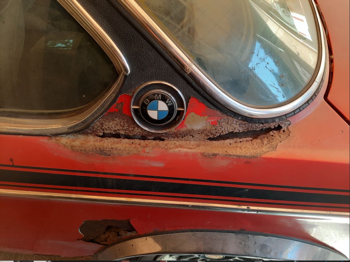

Really strange why this happen than
body repair in the past? It could be looking below on the crack with a lot of body filler (If I'm not mistaken).
