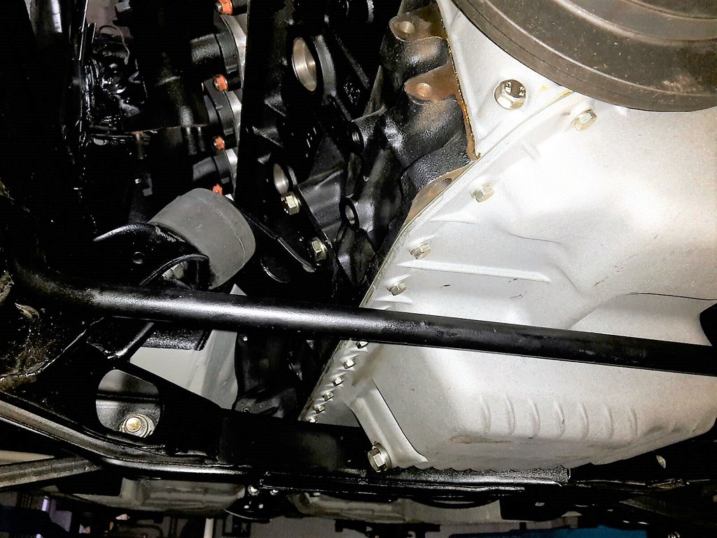

Hi Francesco.
Wow what a speed .... im not jealous....
[emoji53]
Tip is to flip the bolt of the torsionbar (sway bar ), the end is now pointing towards the road. Put the head of the bolt on the bottom. High risk to bend it now as it sticks out.
Erik.

Thank you for the tip! That is just for a "test", it is not tightened.

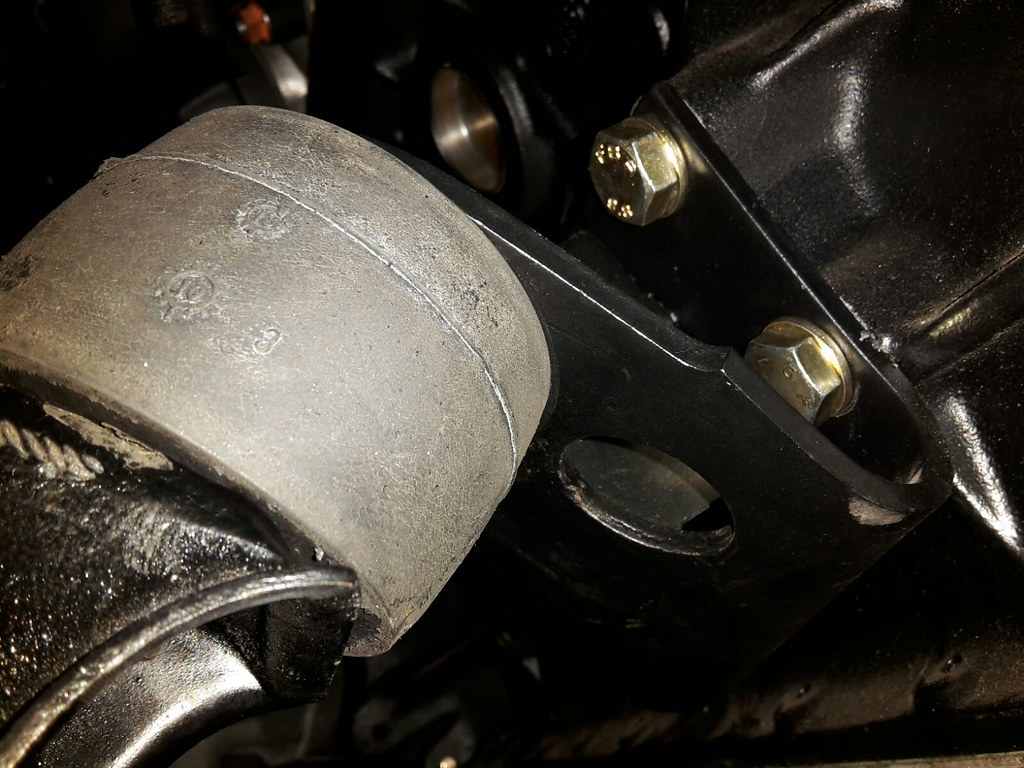

Curious... other than for originality, why continue to use the bottom bolt canister for the oil filter? This was one of the first things I changed my my coupe. The top bolt version is so much more convenient.
Honolulu
1,918
226
Honolulu Hawaii

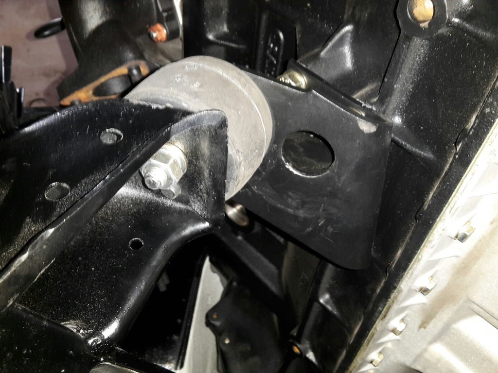

Hard to tell from the picture, but how much room is there between the oil pan and the top of the crossmember? That's all you could lower the engine, would it be enough?
Honolulu
1,918
226
Honolulu Hawaii
the W&N part number comes up for E21, E30 and E12, which doesn't at all mean it might not "fit", but a different part number may be different for a reason. What is that reason? Maybe you just found out.
As you are retaining the bottom bolt oil filter canister for originality, why use a motor mount not originally fitted to the car?
11811132322 is the original p/n
FGS
156
28
Milano - Italy
Thank you, I'll try to answer to everyone:
I bought part A11811132323 as I searched for the specific part for e9 and WN says that code is the right one, now I've realized that part is sold for many models, and that's not good.
I'm not near the car now so I don't know about the transmission, I'll ask about it.
The fan is the original one so the issue can't be related to it. I'll contact Authohaus AZ for part 11811132322 to understand their tickness.
FGS
156
28
Milano - Italy
Turns out that there isn't any problem! The engine fits under the hood and so the fan, although it looks like too high.
I have a questions for the gurus: where could I find longer wheel bolts? I would install E34 rims with 5 mm spacers so the original bolts aren't long enough anymore.
Any suggestions? Thanks.
