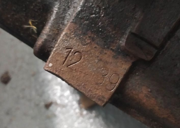

One mechanic concluded that using the stamping on my housing, my VIN and production date, and his BMW shop manual I have a 25% 3.45:1 limited slip differential that is not functioning. Using that information and all of your responses, we decided to send the differential out for a rebuild. I will let you know how it turns out.
Dales
18
16
Golden CO
One mechanic concluded that using the stampings on my housing, my VIN and date of manufacture, the results of the spin test and his factory BMW shop manual I have a 25% 3.45:1 limited slip differential that does not function properly. Because of that information and all of your responses,we decided to send the differential out to be rebuilt. I will let you know how it turns out. Thanks again for your help. Dale
