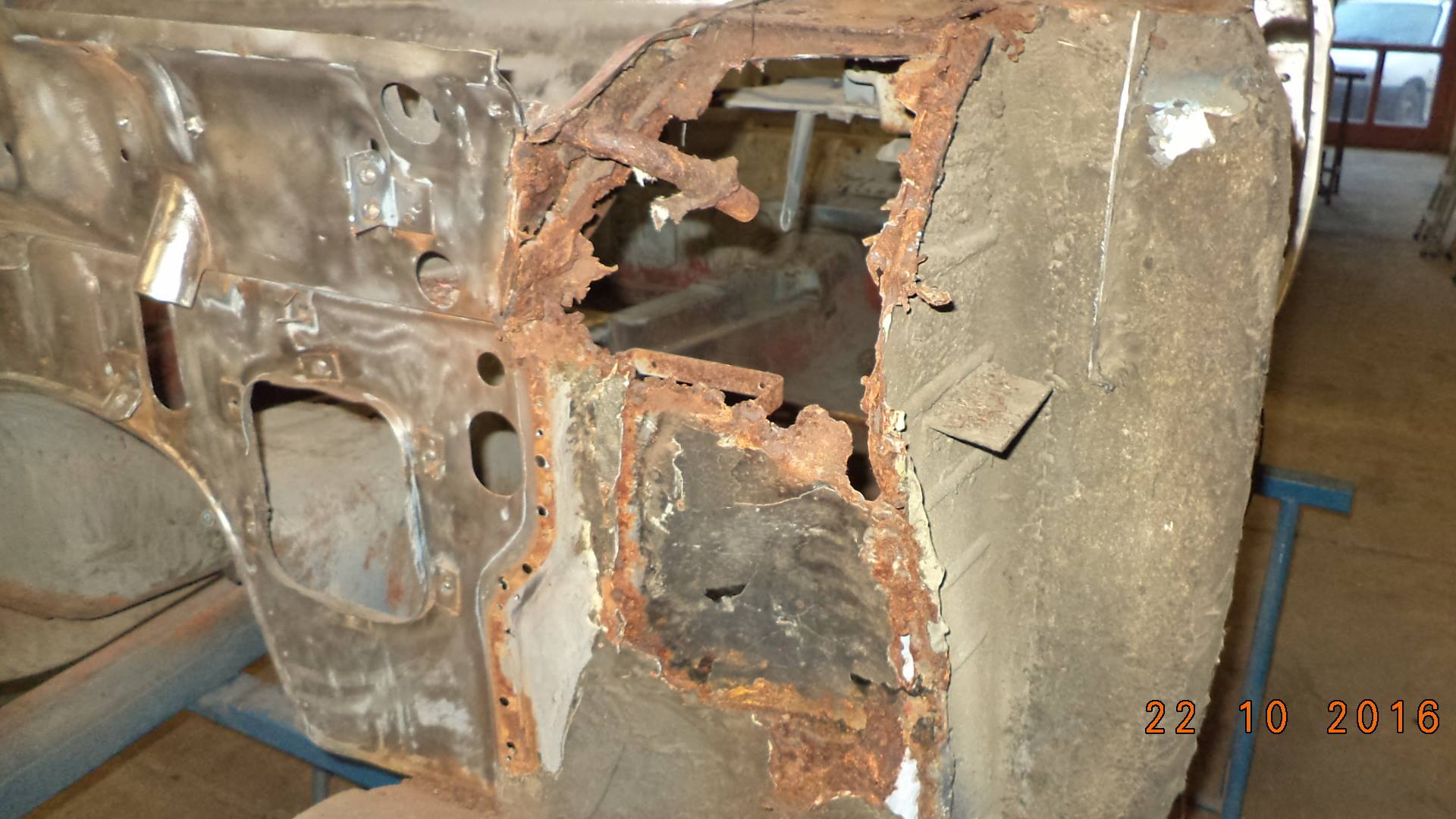

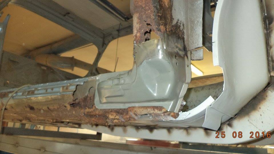

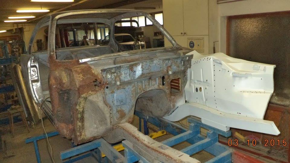

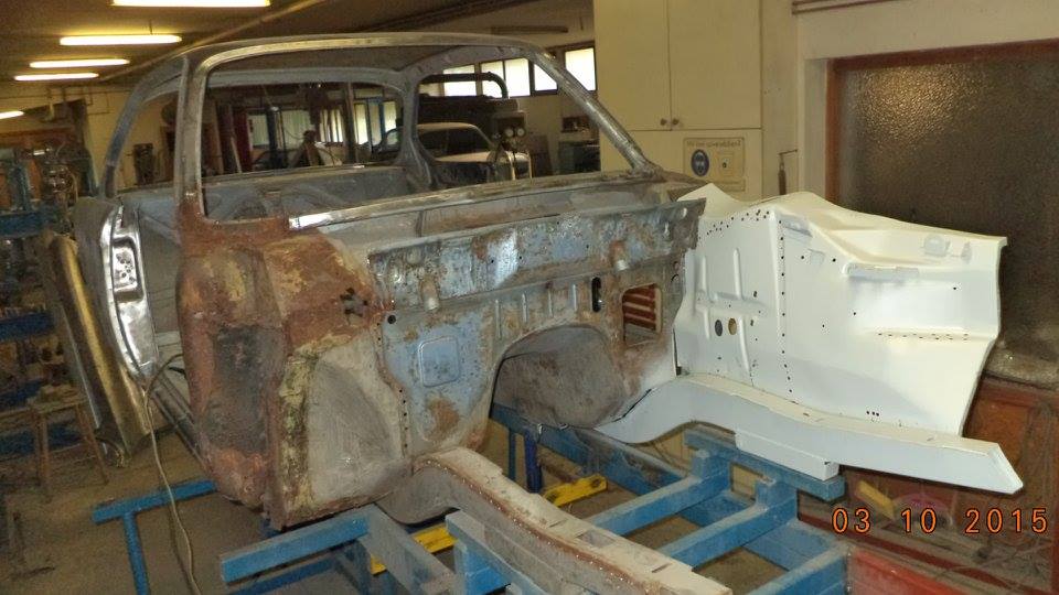

Check out the Facebook page for Miklós Mészáros. He has done some amazing work on cars this bad and worse.

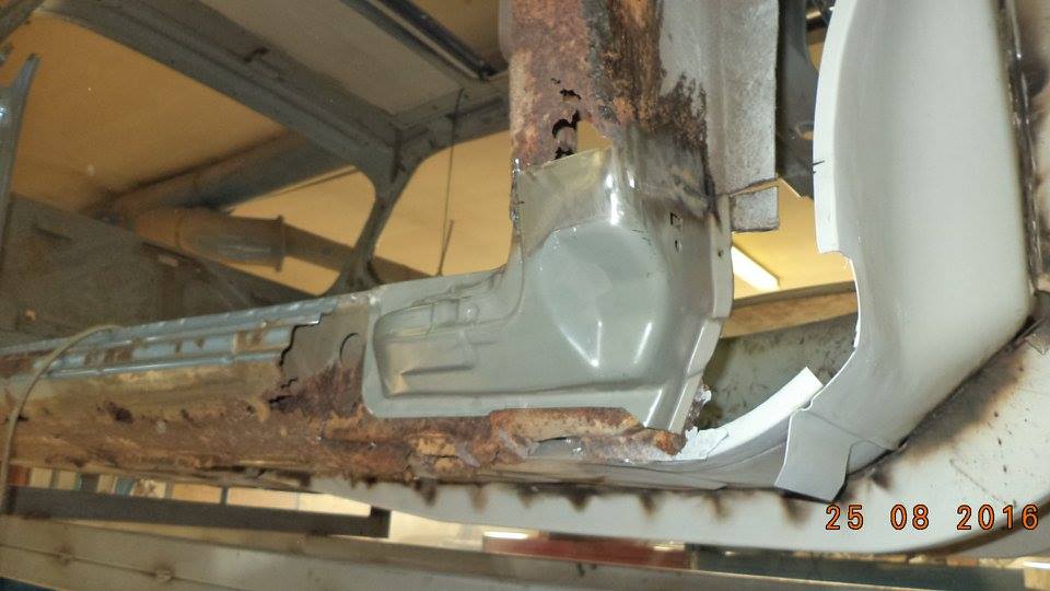

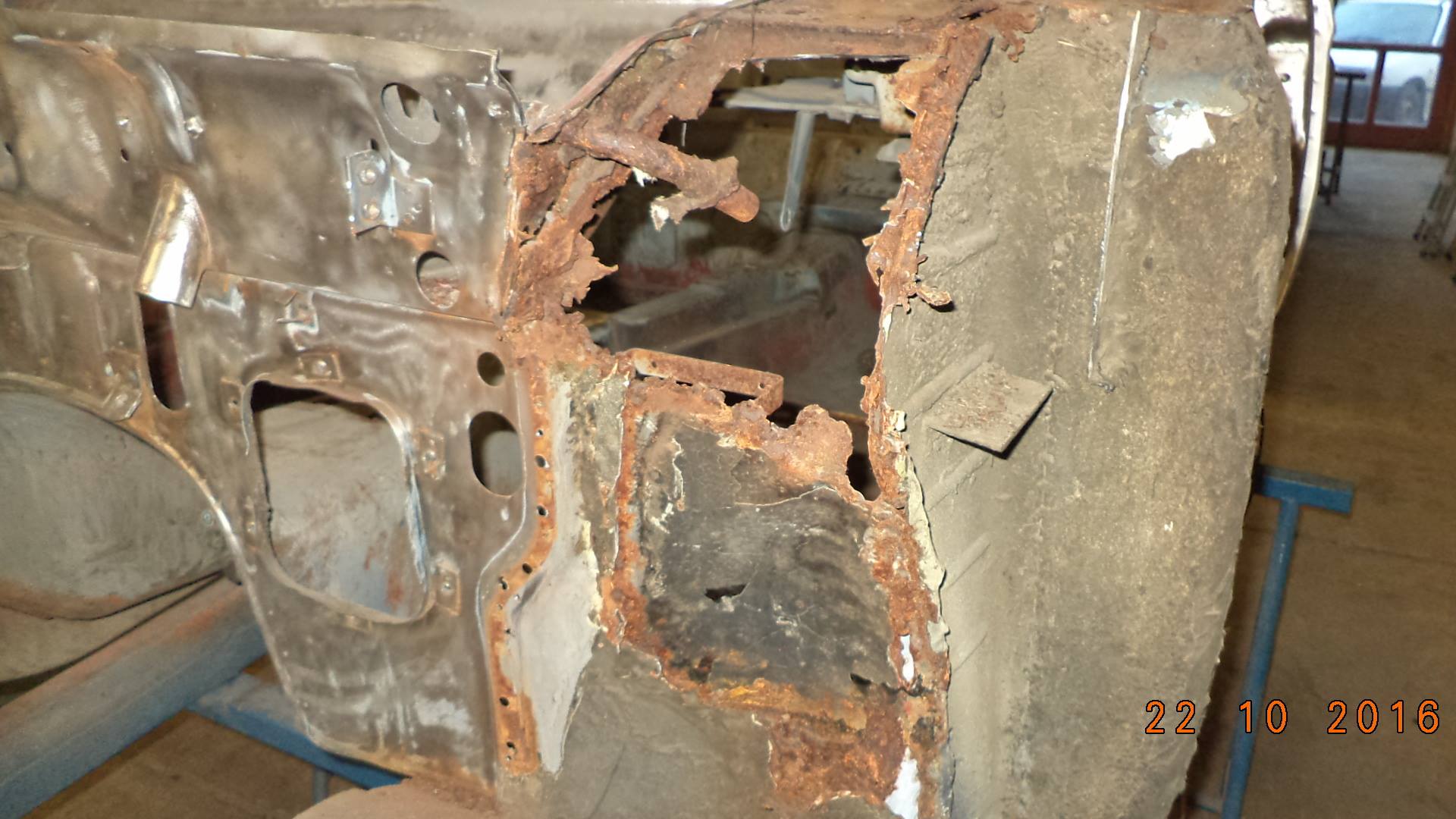

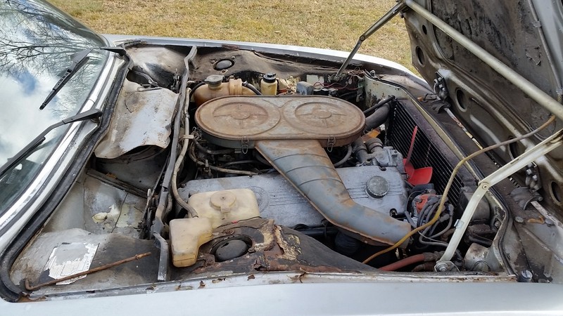

New poster here. Im a 2002 owner but wanted thoughts on this vehicle...
http://www.ebay.com/itm/222364551113
Rust in all the usual places, not running but good interior?
Agreed that the interior looks great. You could clean and dye the seats and roll with it.
Ignoring the rust on the lower fenders, the passenger inner fender top looks pretty alarming. If you look near the passenger strut the metal is pulling away. Any water that gets in that hole runs into the fender box. That whole structure in there will be compromised. The inner fender keeps the strut in place, so I would say that this isn't a car that you should drive around and ignore the rust. Someone did that with my parts car and sent the struts through the hood. Also, since it is a sunroof car the rockers will have quite a bit of rust in them.
You can buy all the parts to fix these issues, but it is several thousand in parts alone. Perhaps a viable option if you plan to do the work yourself.
Love that interior though! This summer I looked at bumper swapped polaris '74 in much better shape than this with an equally nice interior and a running engine. It sold for ~$5K.
The parts on this car are worth $3K alone, but it will take a lot of work to make it safe to drive.

Buy it, chop the fenders off and go from there. Order some metal from W&N. Id rather see this car saved then call it a parts car just because it has rust. That thing is complete, in a decade were all gonna wish we bought this car now for whatever it sells for.
EDIT: Nevermind, this car is being shill bidded. I wouldnt touch it with a 10 ft pole for anything $5000+

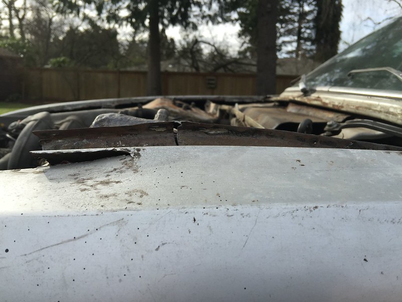

This car has very bad structure in the front. The right side is sagging so badly the hood won't close because it doesn't match the heaved line of the fender.
Undoubtedly the A pillar and the rockers are bad as well.
You know I wasn't paying attention to the hood but you are right. The scenario that I was warning about has already begun. The struts are pushing through, and the hood won't close.

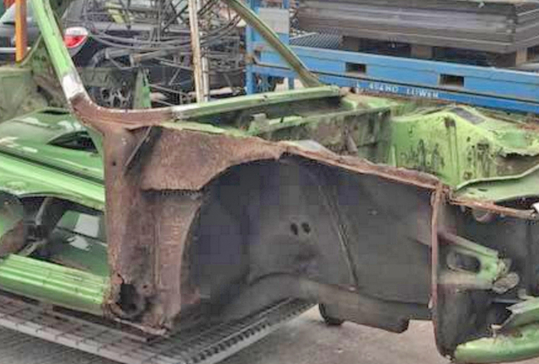

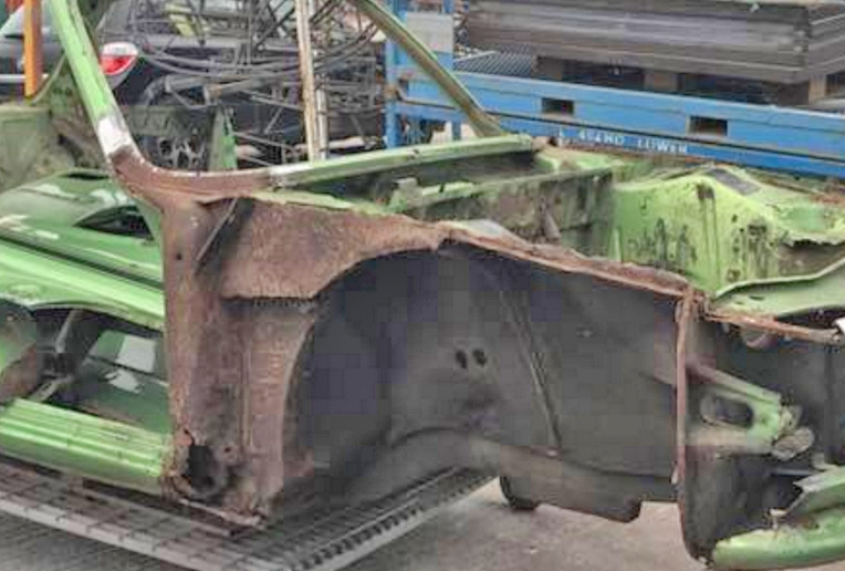

Here is what the next phase looks like (different car):
Personally, I find a DIY inner fender replacement intimidating. You can remove the outer fenders without screwing with the alignment of the car, but the inners hold the strut.
Both struts have distorted the front fenders, the left just isn't quite as bad as the right. The whole nose of the car has to be redone. Best done with a big jig to keep things lined up.
