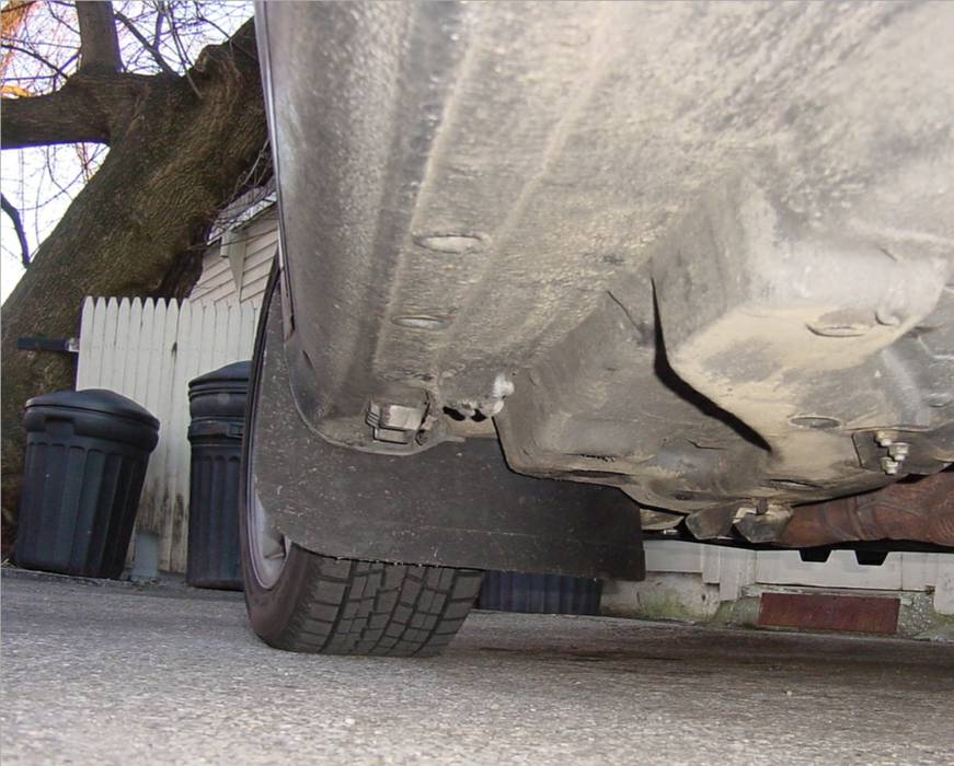

If a car is stored in a heated space (particularly with forced hot air heating) it will last longer because a lot of the moisture is burned out of the air and that obviously slows down the corrosive action. However if a car is actually driven in the winter a heated garage only speeds up the corrosion & the ultimate demise of that vehicle. In the winter the tires throw snow slush mixed with salt all over the under carriage of the car and when you pull the car into a heated garage the slush becomes a liquid salt brine solution and electrolysis starts. It is my understanding that if the car were kept outside and that slush remains frozen there is very little if any electrolysis going on. My observations of customer’s driver type cars thru the years pretty much backs this, the heated garage cars were all bleeding rust from the seams in 6 to 10 years. Jap cars stood out as being especially bad. It looks a bit ugly but I have big trucker mud flaps cut down to fit my Audi, they wrap half way around the front wheels and almost touch the drive axles to minimize the slush problems. The underside of the car stays relatively clean considering it’s a winter driver. Anyway the bottom line to all this is “the heated garage” story carries no weight with me and in fact warning bells go off :roll::roll::roll: when I hear it. ~ John Buchtenkirch

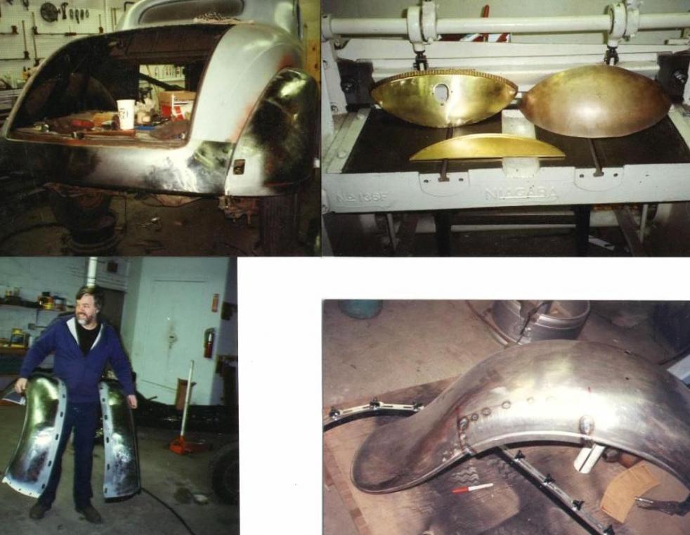

Thanks for the compliments but I have been doing collision & metal shaping for 39 or 40 years so it’s just second nature to me now. A “Hall of Shame Gallery” might not be a bad idea, I’m sure anyone who has seriously been looking for a coupe has photos or at least an interesting or funny story :smile: to tell. ~ John Buchtenkirch
