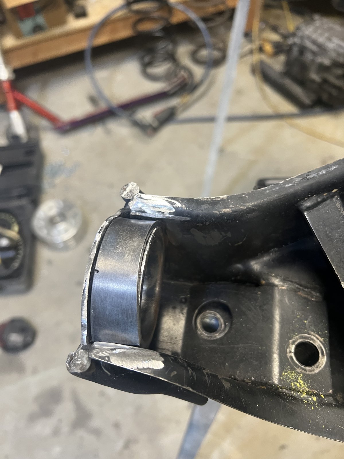

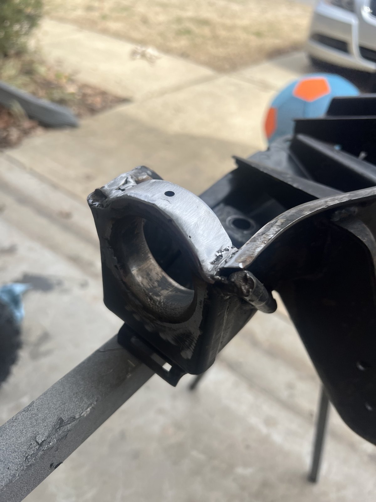

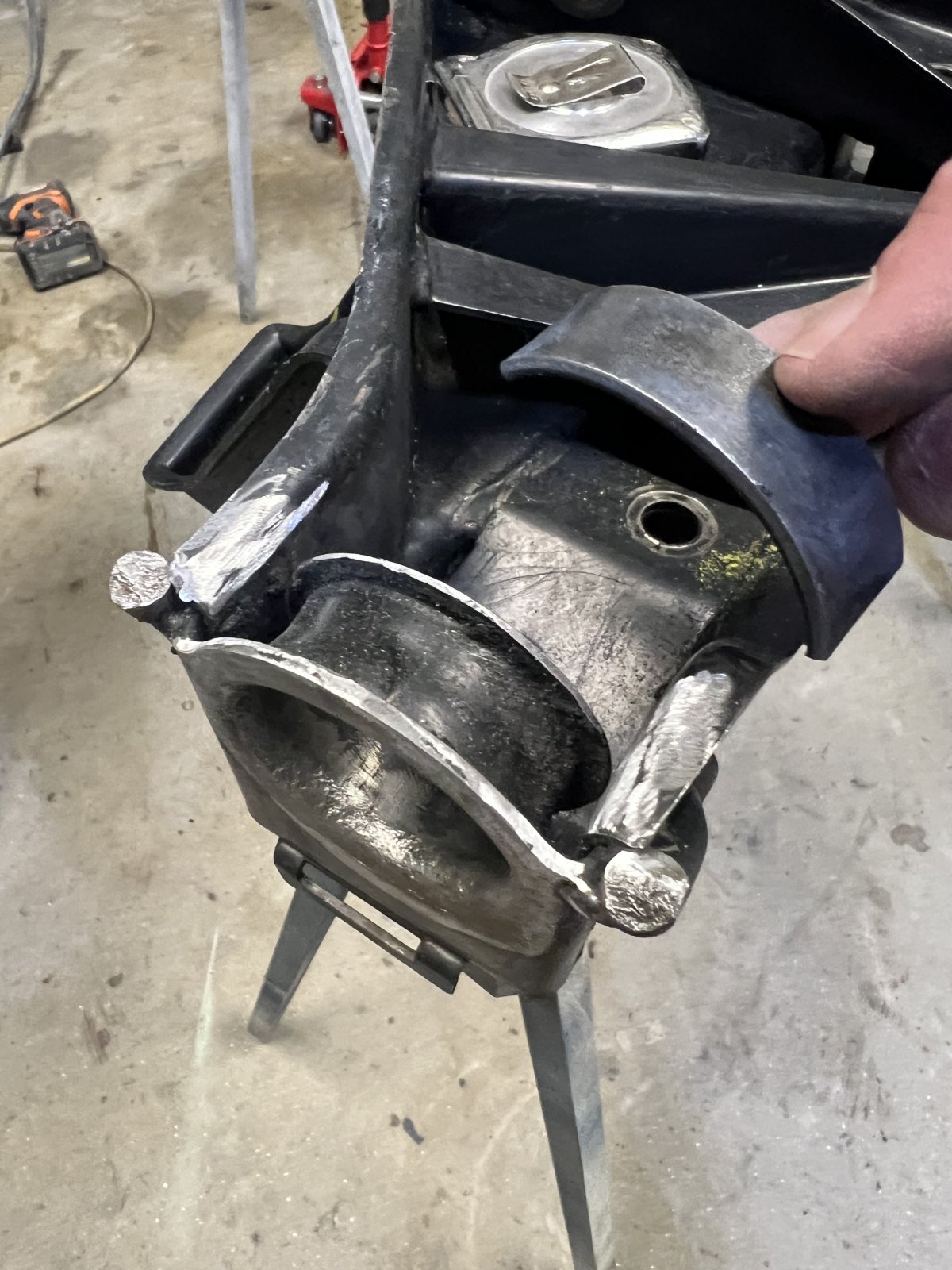

So, if any of the group has experience with the strengthening needs of the front subframe, here's what I'm thinking. I pulled my front bushings out to get ready for clean up and paint, when I noticed it was bent from what I assume was a curb or something..I got it back in shape with some hardened punches, but I saw the loop was cracked. I drilled, ground out, and welded it but thought that the area looks pretty weak, considering where it is located..I'm thinking of welding in a strap type support out of 1/8" steel to strengthen that spot. Anyone else ever see issues in this area on their rebuilds? Seems like such thin metal that could use a bit of shoring up..
The sub is upside down in the pics:

Mine was bashed up from a pothole. I had it straightened and welded but your idea looks great, wish I could have reinforced it like that.

Ok, cool...It feels like the right thing to do, while it's apart...I'd sure hate to have it come apart on me...

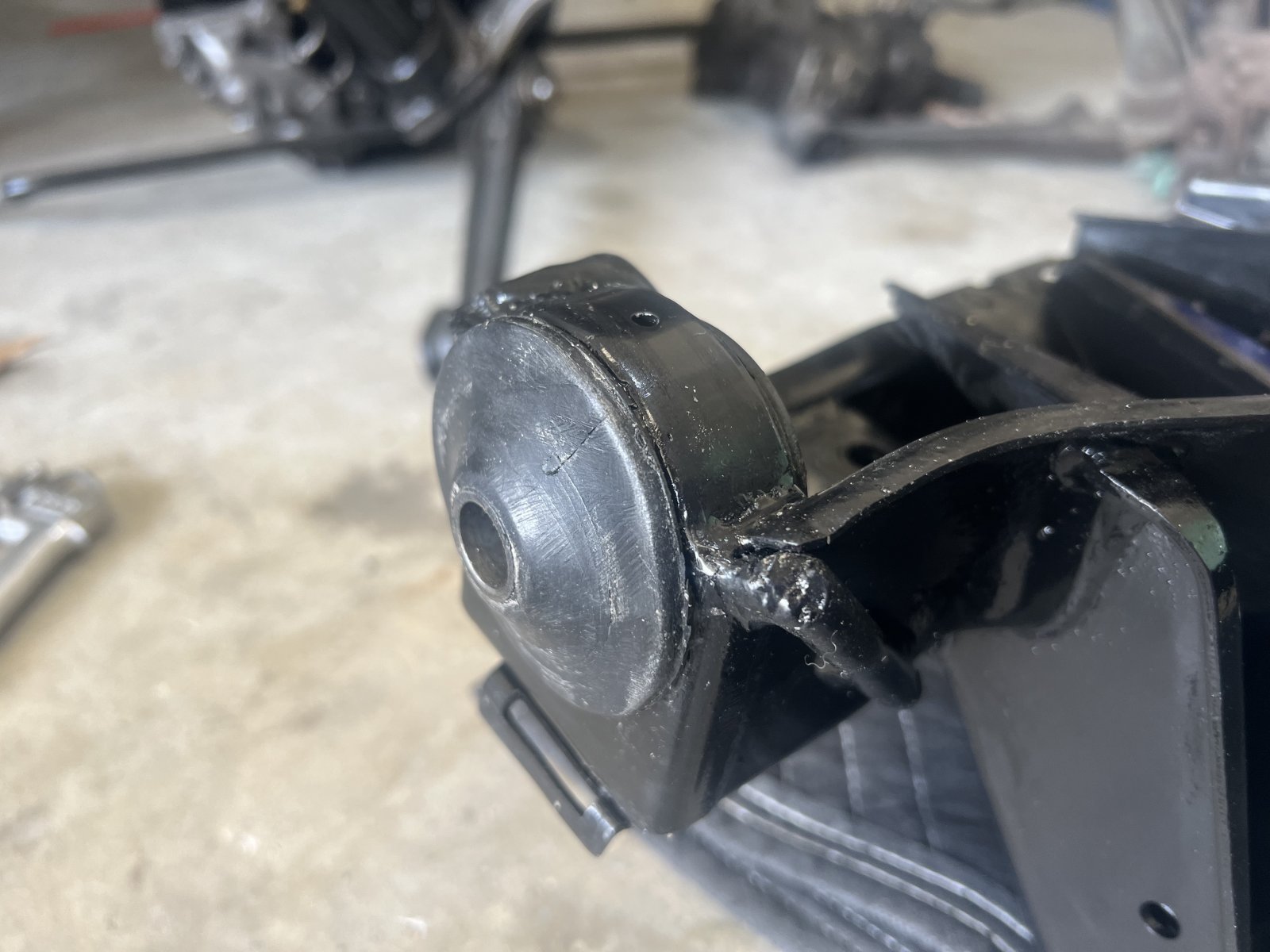

Got a little more done today. I finished the front sub frame bushing loop reenforcement, painted, and pressed in the bushings...good lord, those are a PIA to get in.

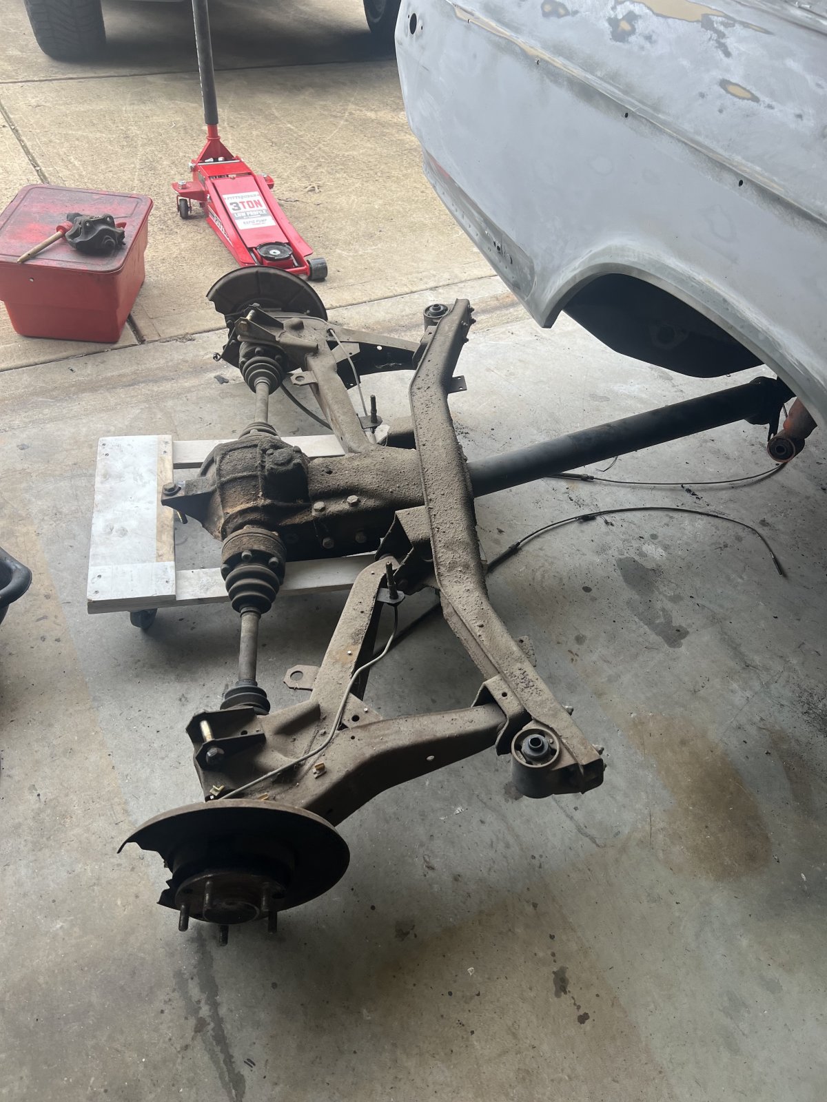

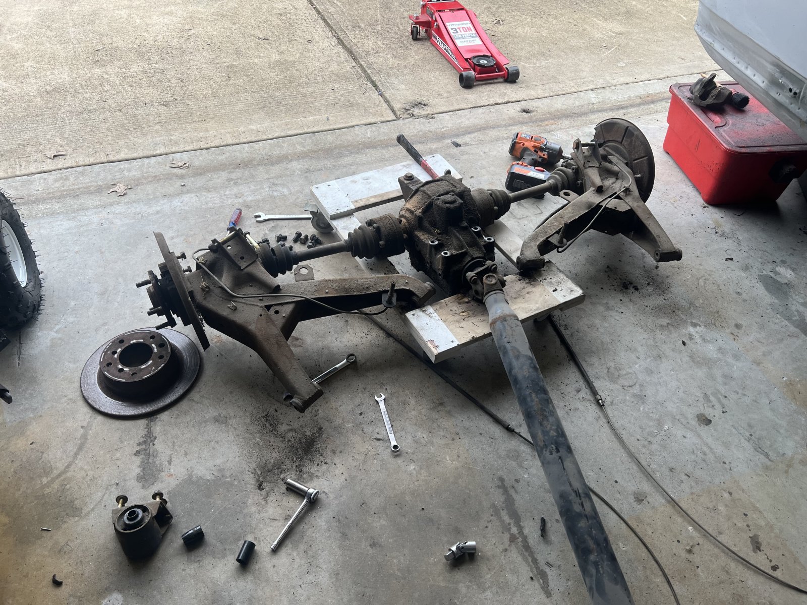

Also finally pulled the rear subframe out to get ready to clean/rebuild.

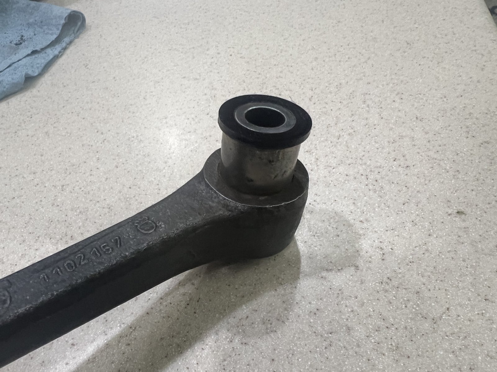

Thought: I pulled the Idler arm off and of course the bushing is toast, but the bmw one is $80 and isn't anything special. I'm thinking I might make a two piece Delrin sleeve to replace the rubber portion on mine. Should last forever and give tighter steering response..

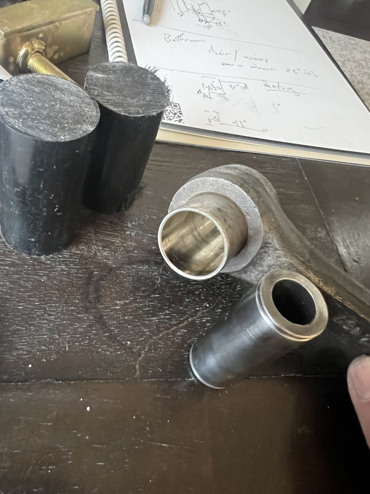

Here's the idler arm. I think I'll make a two piece Delrin bushing to fit the existing unit. I pressed out the center of the old one and cleaned off the center steel sleeve to reuse. Could be fun to make those pieces quick..

Now I'm looking at the rear subframe supports. I only see oem at over $100/ea, and still rubber, or Ireland urethane (out of stock) for $200/pair. Would it be crazy to just make delrin bushings for those or would that make the rear end too rough riding/noise transmitting? Thoughts? I can make them for the cost of the delrin bar stock..
