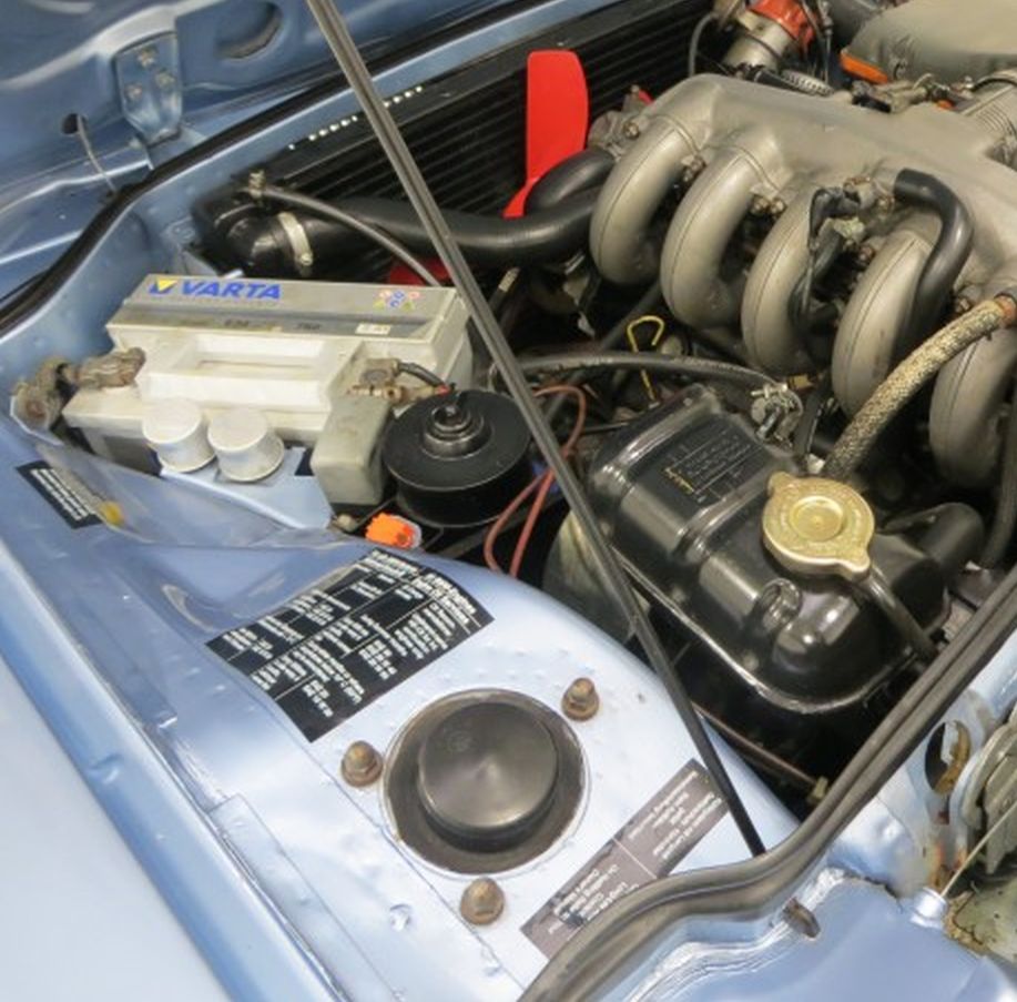

Looks fabulous, but what's going on w/the inner fender seam? Just bad lighting?

Hard to tell due to lighting on driver side but passenger side looks perfect, nice tight seam with factory crimp/indentations. A six figure coupe but may not hit reserve, too many buyers see $32K coupes and think all can be bought at that price.

That first pic also shows what looks like a big crack in the paint running parallel to the left of the sticker.
If it is the only reason for it would be if the metal (or filler) was moving - right?

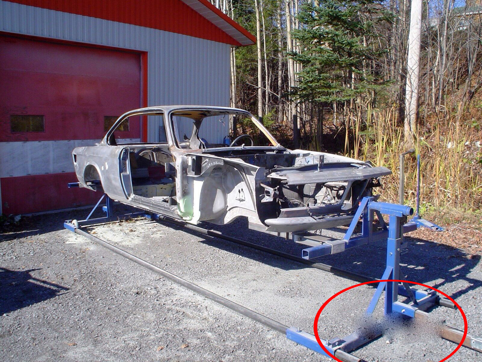

When I look at the restoration images (which I appreciate that they are plentiful), I see a number of details I'd do differently - primarily contaminated welds, poor weld penetration, and concealed areas that do not appear to have been addressed. But I am curious what you see in that image that doesn't look right. I'd like to learn what others' eyes see, especially the knowledgeable eyes of this group. Thanks!

Is it me, or is this image Photoshopped? And if so, why Photoshop the gravel around the base of the rotisserie? That just makes me want to scrutinize the rest of the images that much more...
Think they have just scrubbed the date/time stamp from the image.
Another option is it's a professional photographer's logo and they don't have permission to use it.
The rest of the image of the car looks fine.
Bit hard to comment on the actual subject matter from that distance.

In closer inspection (of the photos), I see that the series of three photos outside on rotisserie all have that same smudge. I don't think this is Photoshop - rather perhaps a drop of water or gook on the lens. I stand corrected.
I still am a critic of the welds and some metalwork. But many nicely done details, too.
teahead said:
THis is how I like to see restored inner fender seams:
For some reason I am only seeing one of your photos, but YES, that looks very nice and clean.
I know that some/many are proponents of putting the tar pads back on. But I prefer a restoration of this level to skip them. Seems like a risky detail. But I understand that it does not look as original.

I think he kept the tar pads but so much paint on them hides the texture, the seam looks good to me.
Yeah I agree. The lighting is playing negative tricks on this coupe, with shadows and the elusive Baikal color. Everything looks better in natural light if you have the weather to do it.

In looking at those fender seams, I agree that the lighting and photography seem not to be representing the work as well as it should. And it seems that the tar pads are likely not original material and/or correct, as they are curling up and delaminating?. This is resulting in some photo views that conceal what is likely a better looking seam that we think (without seeing it in person). There's a lot to like here - I'm hoping to learn about the not so good stuff and learn from the good stuff! Thanks!
