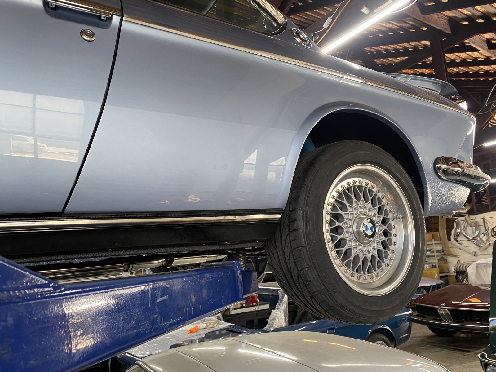

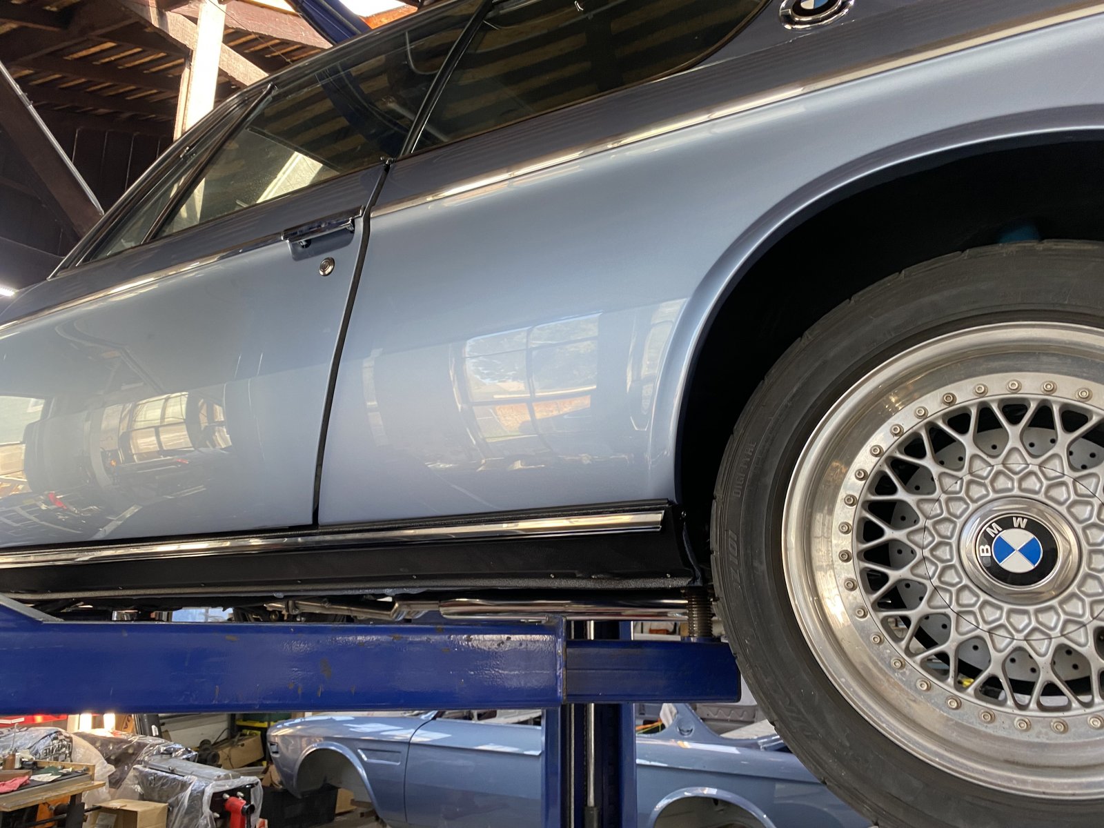

“I hate knocking cars but aren't we missing the glaringly obvious in this picture?”
Cmon- share!
Perhaps it's me but can't you see the 'mirage effect' on the panel? How looks kind of mottled and not offering a true reflection coming off the body work? Suggests to me that the car hasn't been properly blocked when the body work was done as the surface only does that when it's not flat. I'd say a bit of filler hiding around the top of the wheel arch. Just my observations from a few thousand miles away..

I don’t see it as knocking the car, but rather pointing out the difference in puffery vs actual, and the feigning ignorance of the seller.

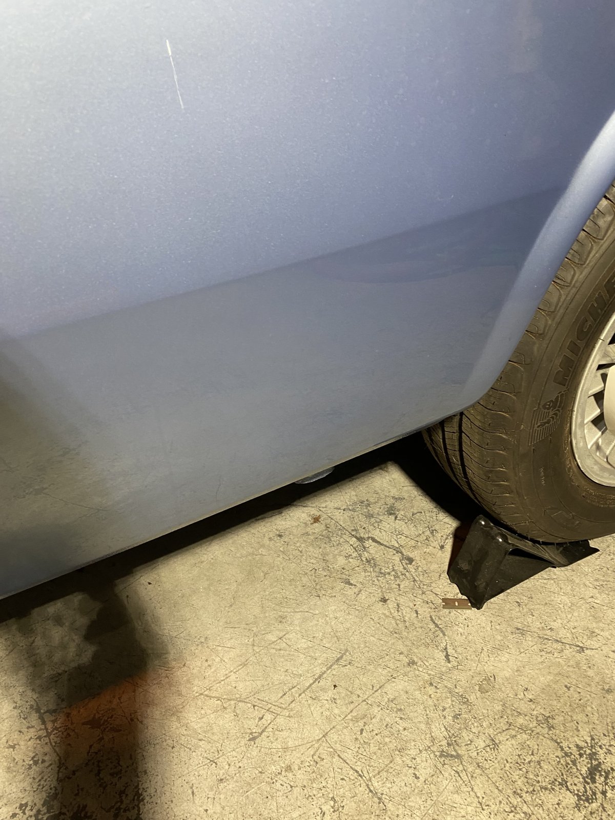

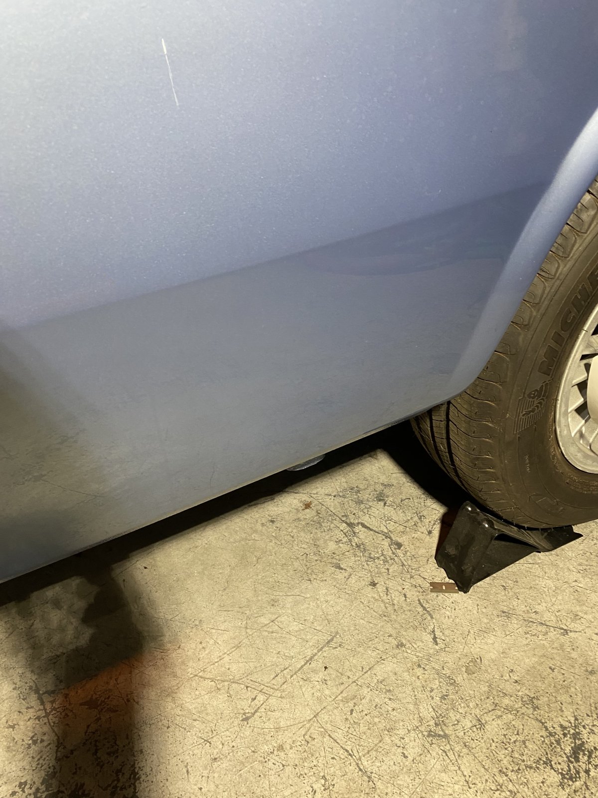

The passenger side of the car
Sure -

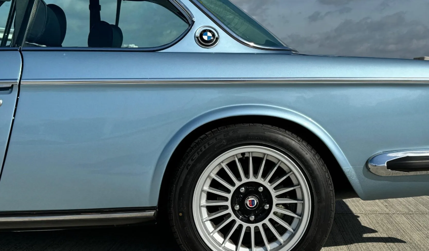

I'll use a pic of my car that shows it fairly well.
There is a crease (for lack of a better word) right at shin level (or almost knee level if you are short like me - LOL) on the side of the body. It is subtle - but there. Many body shops don't keep that feature when they do work. The 'crease' - it needs to be there, but should not be too 'sharp' - so to speak.. Depending on the light, it disappears or can be seen easily. Again - subtle but very visible.
20231001_175855-jpg.172676
This is a beautiful car.
