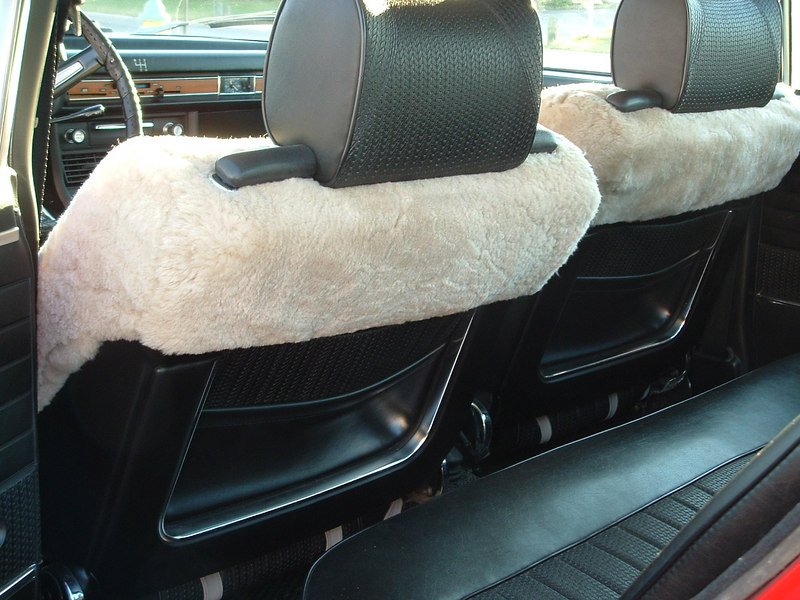

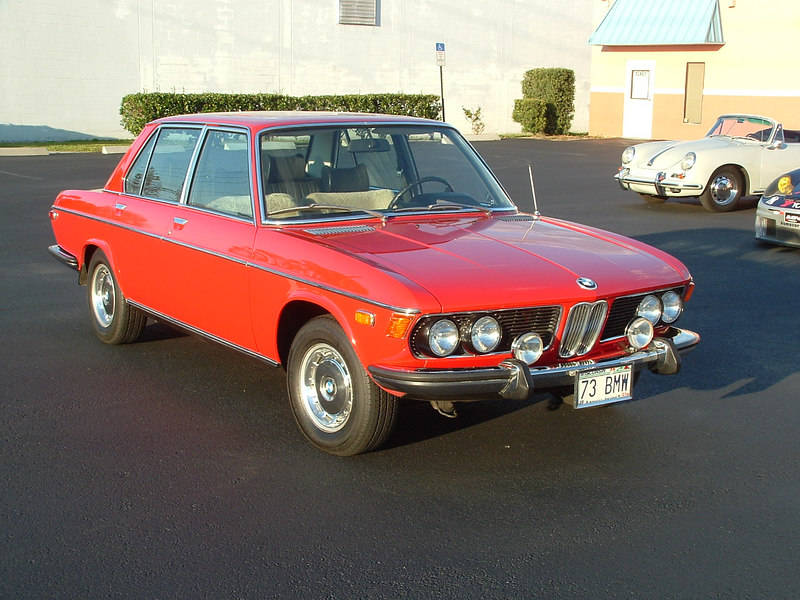

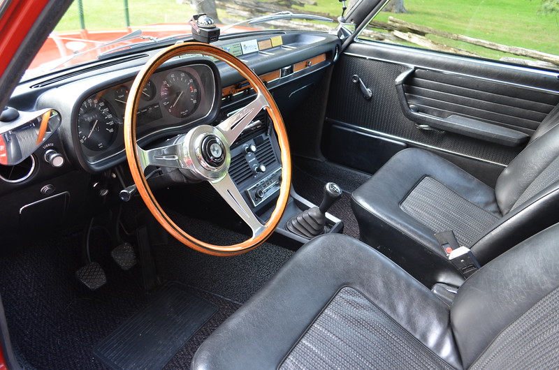

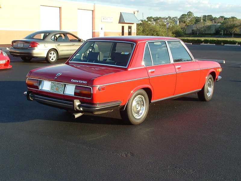

These are photos taken by the Florida seller:
Note: It still has its Wisconsin plate on the front.
As is evidenced in the first and last images, the Bavaria is surrounded by a sea of P-cars and soon to be displaced by more; a fact which pleases me.
Within eighteen months of the car's arrival back in Wisconsin a fairly significant, though not cosmetic, transformation will begin, so there's more to come...

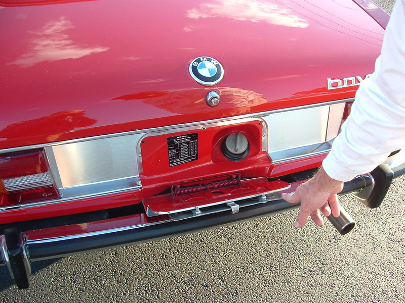

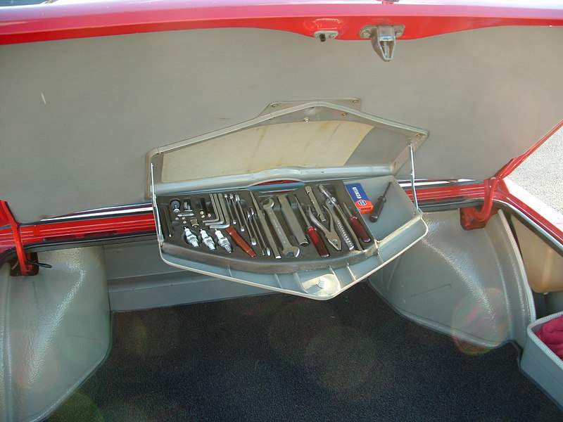

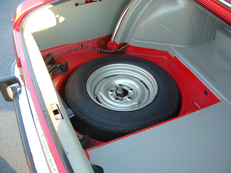

Beautious. Love the color.I also now know how the jack is supposed to be stored.

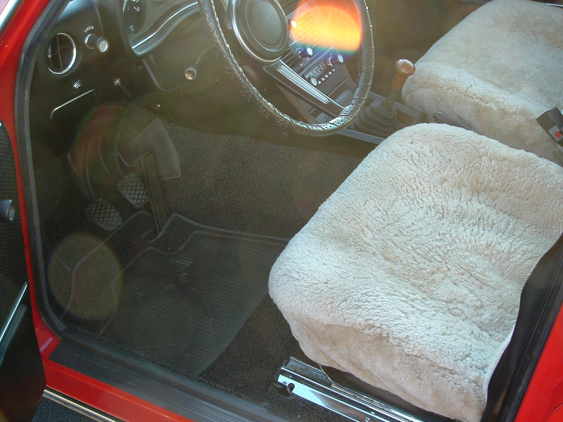

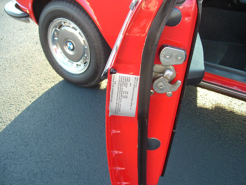

A few more "as bought" images, complete with lens flare:

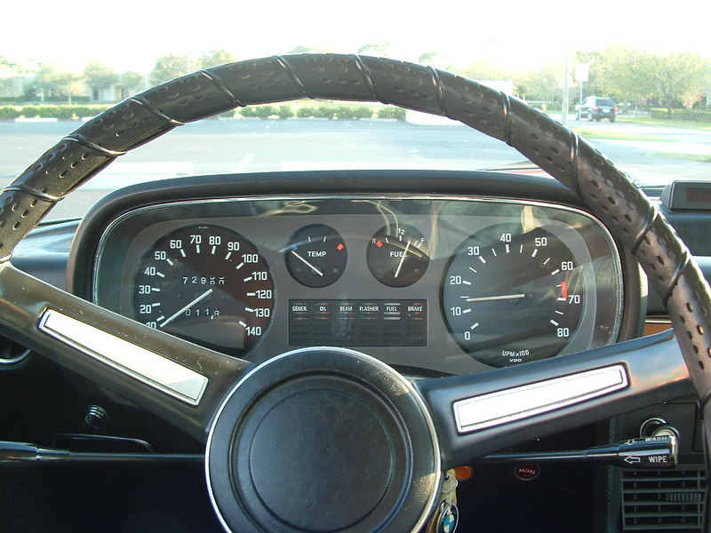

When I was presented with the car in person and had a chance to carefully view the details I was both relieved and delighted. With the exception of modest speakers added to the package shelf, the car was exactly as built in Dec. of '72 and obviously well cared for. In the glove box was the original owner's manual (not even smudged fingerprints), the window sticker, dealer invoice for floor mats and the extra valet key. So far I'm smiling, but eager to hit the road for the real test and confirmation of my long distance purchase.

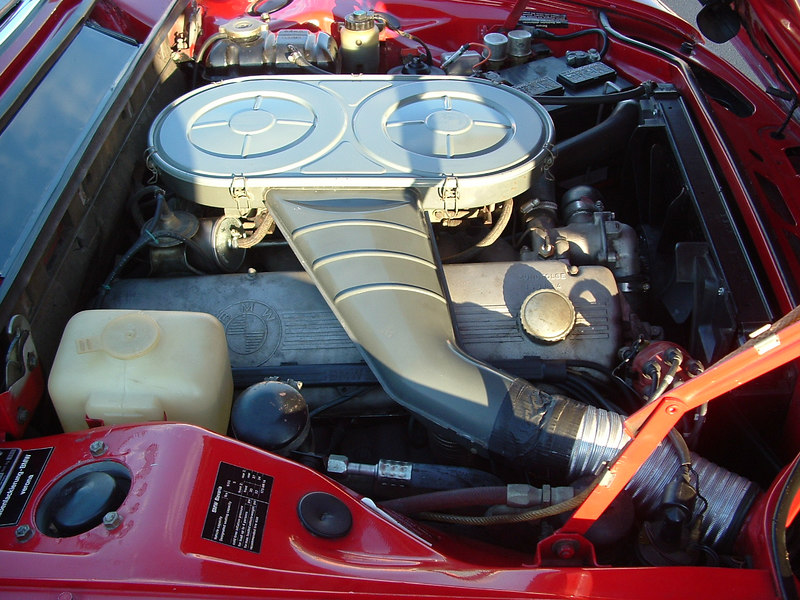

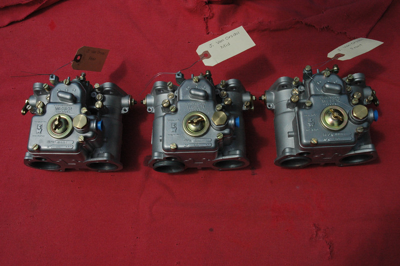

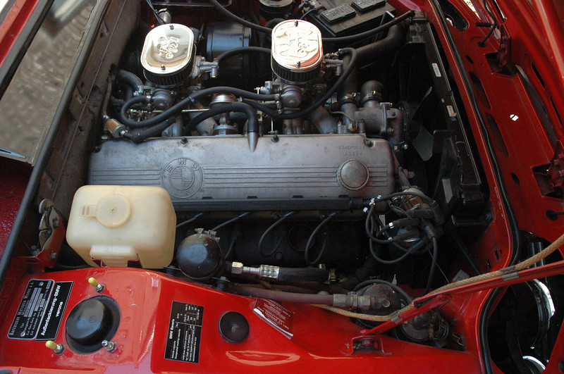

The Solexes, however, are proving problematic and since I'm carburetor challenged the car goes to my friend, Jim K., who owns and independent BMW shop and was, in his early years, a factory trained BMW technician. Jim's frank opinion is that the carbs were an issue even the cars were new: they did rebuilds of them under warranty! He said he'd rebuild them for me but his strong recommendation was that I opt for Weber 32/36 DGV and so that's what we did. Big improvement right away. While access to the starter is better with the carbs off we decide to install a new one - since the original is 35 years old I justify the replacement as preventative maintenance.
Here's the engine compartment before and after Webers:
I'm not fond of the chrome K&N filter tops so later paint them hammered silver, ala Solex 356 air cleaners.

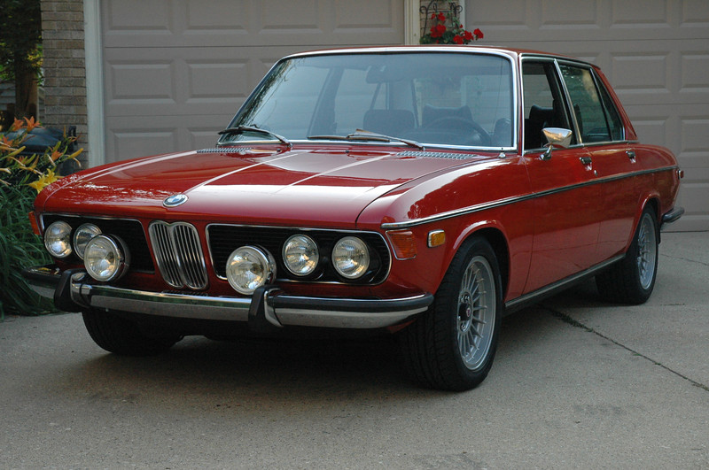

I found a set of original 16" staggered Alpina alloys on German Ebay, The springs are replaced with Ireland units along with their 22mm front sway bar and an adjustable rear and the shocks are swapped for Bilstein HDs.

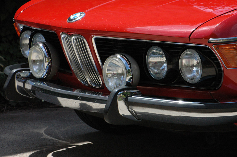

The original no-name driving lights get replaced with Cibie Oscars that I had in my stash of future-use parts and the crappy tungsten headlights with H4's and H1's.

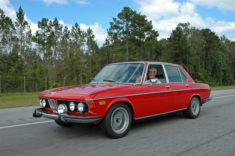

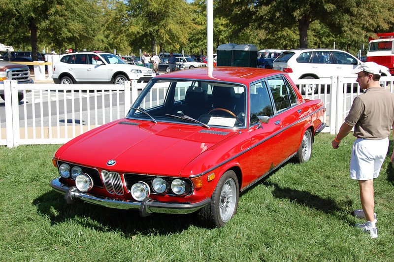

Between Savannah and Daytona we hooked up pre-planned with some friends on I-95 and one of the passengers snapped this:
In an earlier attempt to help cooling I removed both Oscars and only half finished the reinstall.
While at Rennsport we were but one vintage Munich car in a sea of those from Stuttgart:

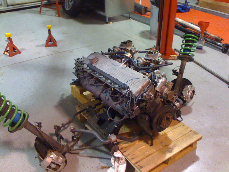

On the way back home I decided that I wanted to fix the valve guide issue and that, at now 80K miles, it doesn't make sense not to rebuild the full engine. Besides that, I've always wanted to build an "improved output" M30 engine with three sidedrafts (I've been a fan of Alpina for decades) and improved cylinder head flow. The second task I wish to accomplish is to replace all of the tired out bushings in the suspension. I road tested (pre and post installation) a friend's 2002 many years ago which had received all new bushings and the improvement road feel and input response was remarkable. I'm figuring that it's going to take about a year to get this done but predictably, Murphy is going to intervene in numerous and devious ways.
About six weeks after getting home this occurred:
And shortly thereafter these arrived:
So I'm on my way.

Did I notice that the photo of the car on the highway only has one aux light and the other photos have the set. What am I missing :?:
