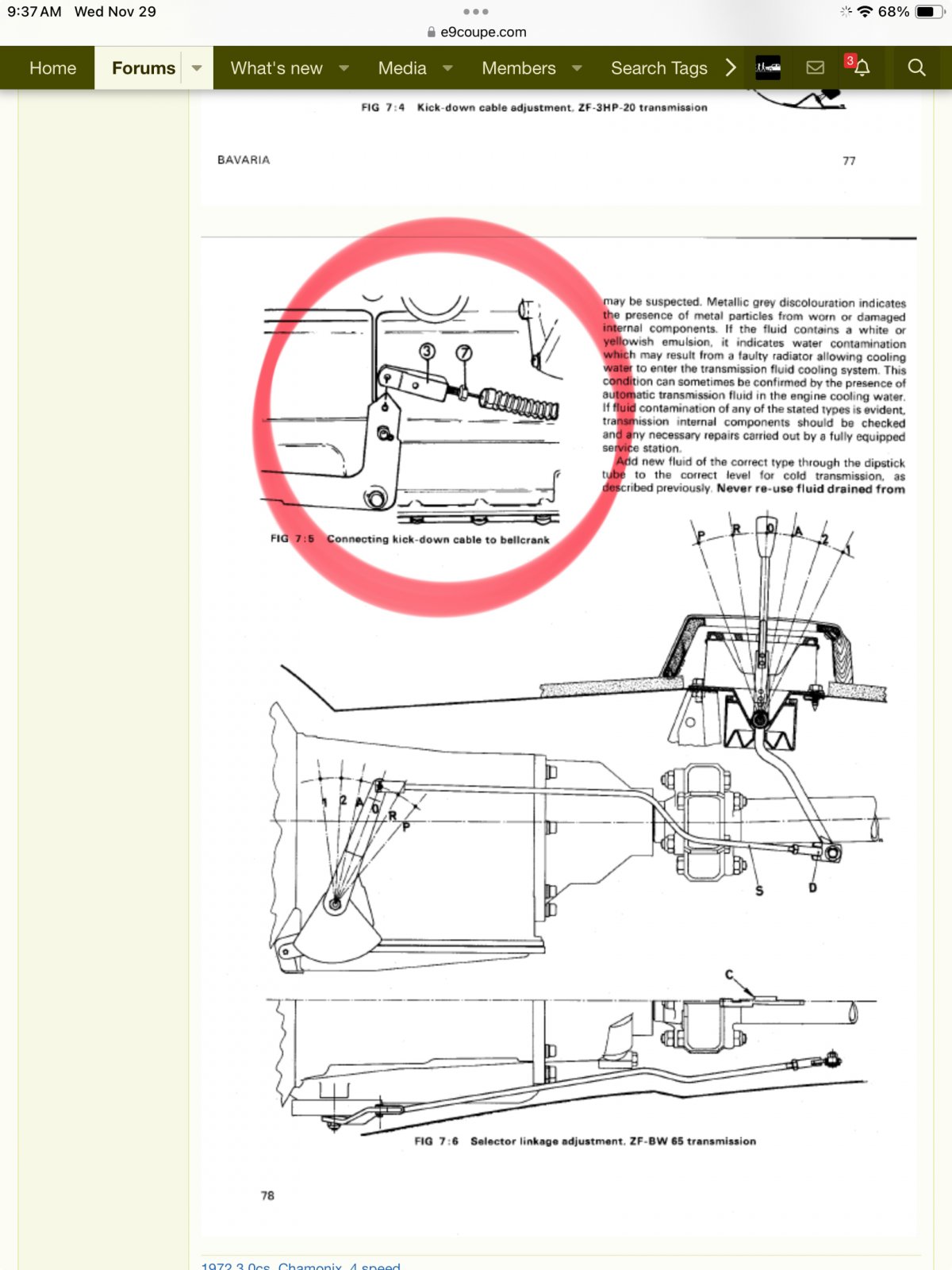

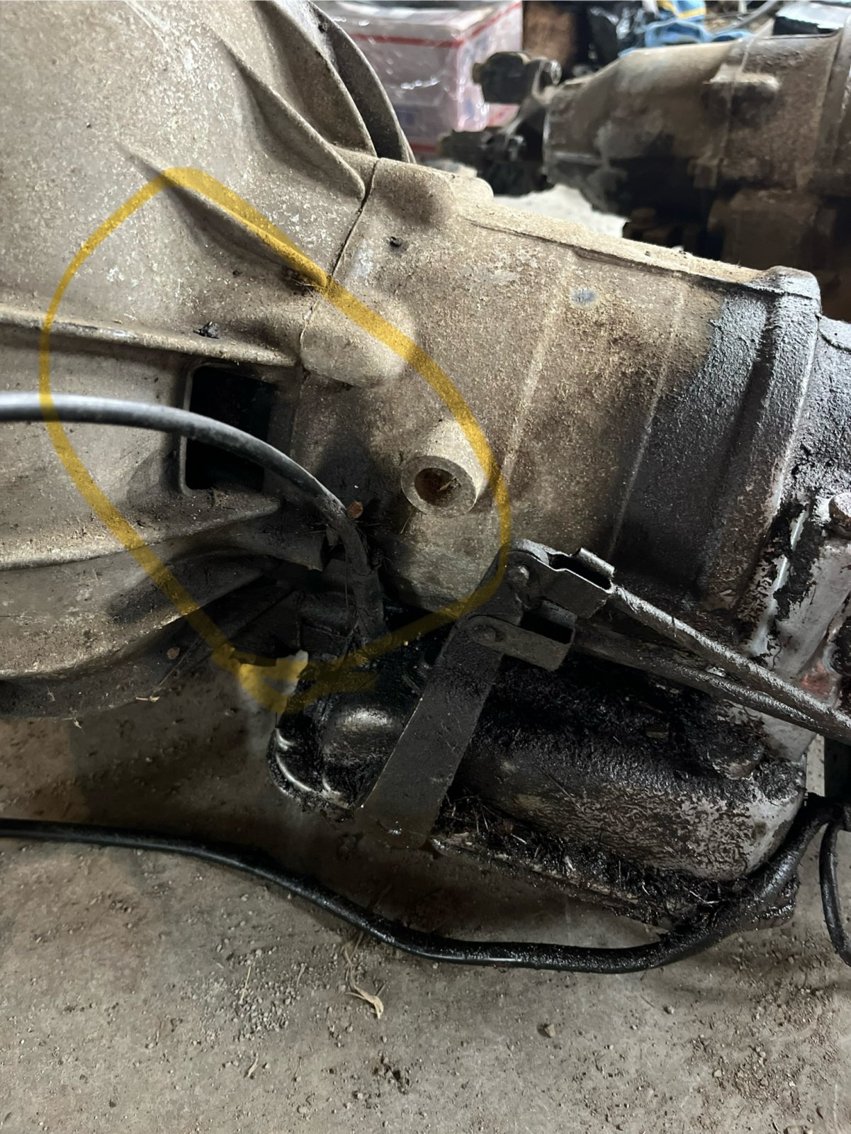

hello all, I need your help to identify what this cable does… I’m trying to replace the transmission as my previous failed to reverse. So I have another set I’m trying to put in, when my friend helped me to take it down we didn’t see where the cable goes. Could you tell me how the cable and the linkage next to it connect?
Thank you

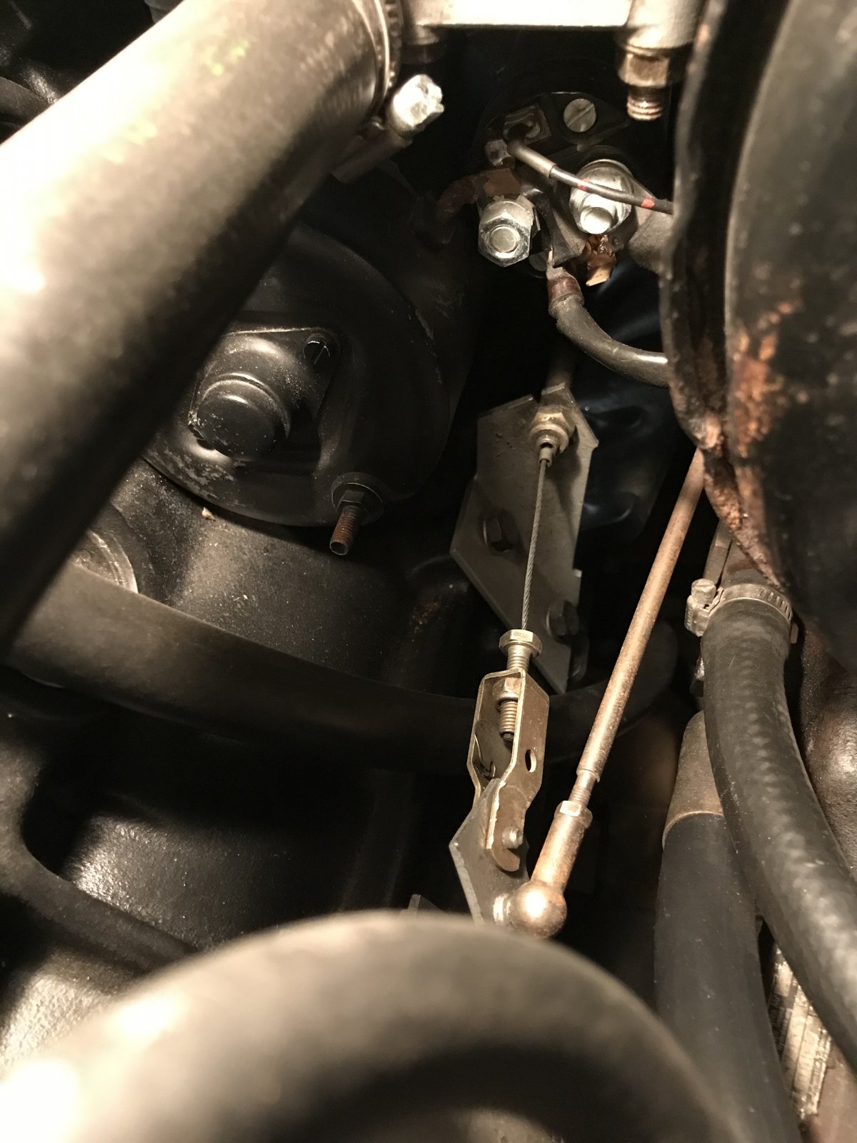

Kick down cable gets connected to bell crank on drivers side of engine.
