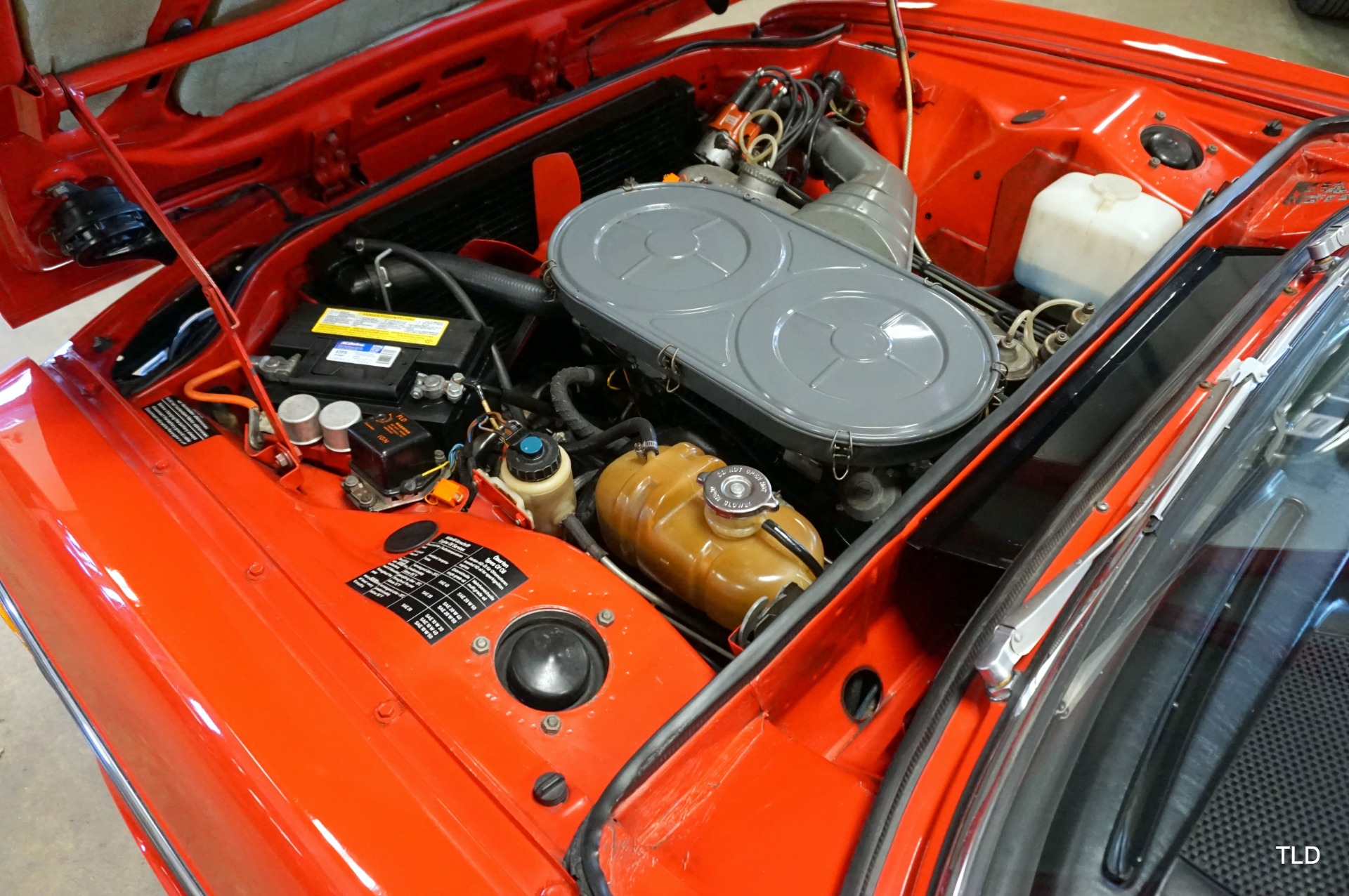

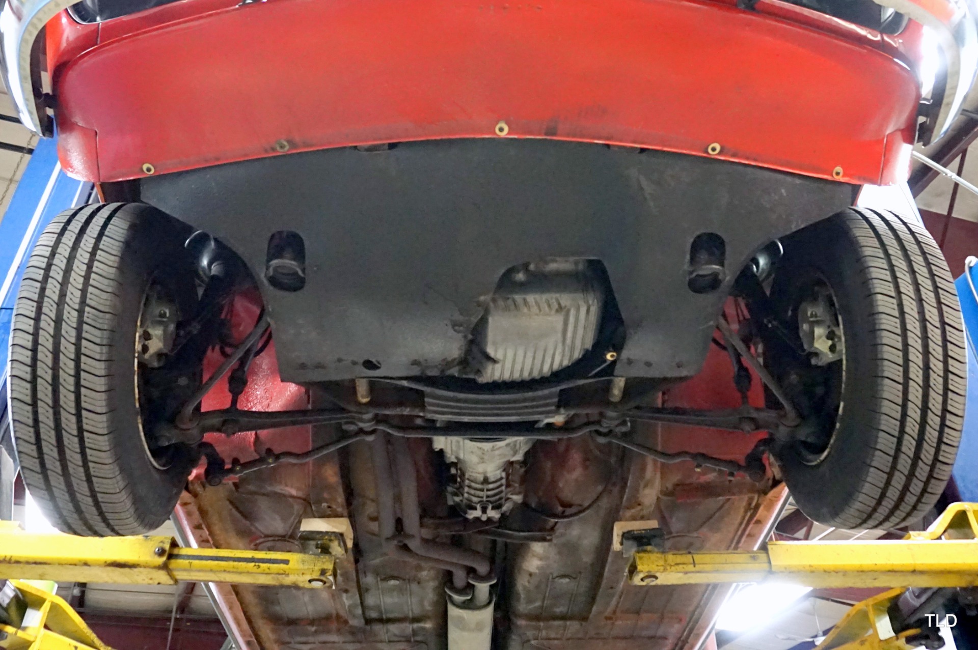

Guessing that isn't original paint everywhere given some overspray areas (I know some of that can be common from factory). It's definitely not "thought of as the most original example" as I can already deduct points in a number of places such as the overflow tank, radio unit, and those nasty aftermarket gauges. I was expecting a miracle undercarriage after their teaser about it, and it doesn't come close to their billing. The front frame rails are of course damaged from decades of improper jacking and appear to have some rust areas. In addition there are issues elsewhere that need much closer inspection. This is anything but a Hagerty condition 1 car which it is priced as...not even close (i.e. it's nowhere near the "best in the world" condition). Granted, it's a *very* nice Bavaria, no doubt, but it's being over-billed imo and way over priced.

I can already deduct points in a number of places such as the overflow tank, radio unit, and those nasty aftermarket gauges. /QUOTE]
How about that voltage regulator:
Gets some bonus points though for the under-engine tray:

Just noticed that the drain hose from the cowl area on the driver's side is missing....just a hole there. Given these few things we've already picked on with a cursory glance, there's probably a lot more to be found.
Agree on the underbody panel. Very rare to see that still with the car.
Tools missing, tool box has the usual cracks. The underbody panel, I assume you mean the "cardboard" panel screwed to the nose, is readily available from BMW for about $225. I bought one for my coupe a while back and treated it with something or other as an oil leak will degrade the piece. Most were tossed after the first or second oil change and never missed.
