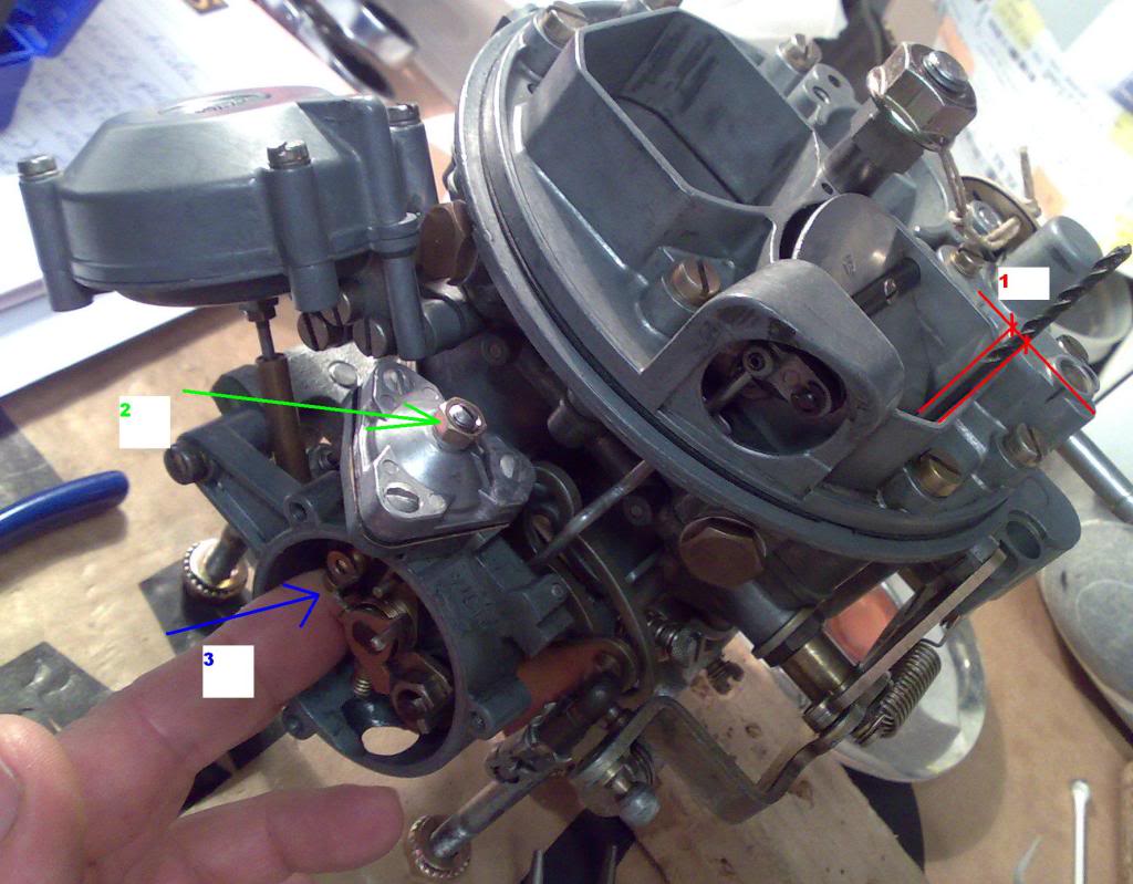

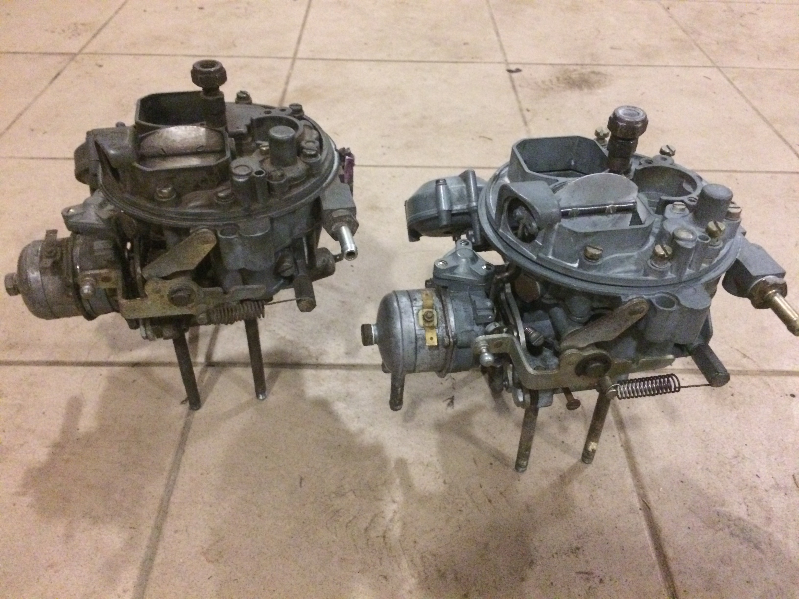

I noticed that your carbs had those diaphragm adjustment screws on top (see 2 in the picture of yours attached), so this is the only headache I have left for adjustments. Will still try to dig on the web or look for another cap for diaphragm that would have this adjustment possible. Attached also the pic of the carb I have.View attachment 22326 View attachment 22327
@Zibsnis
i do have replacements with adjustment screws, send me a pm
