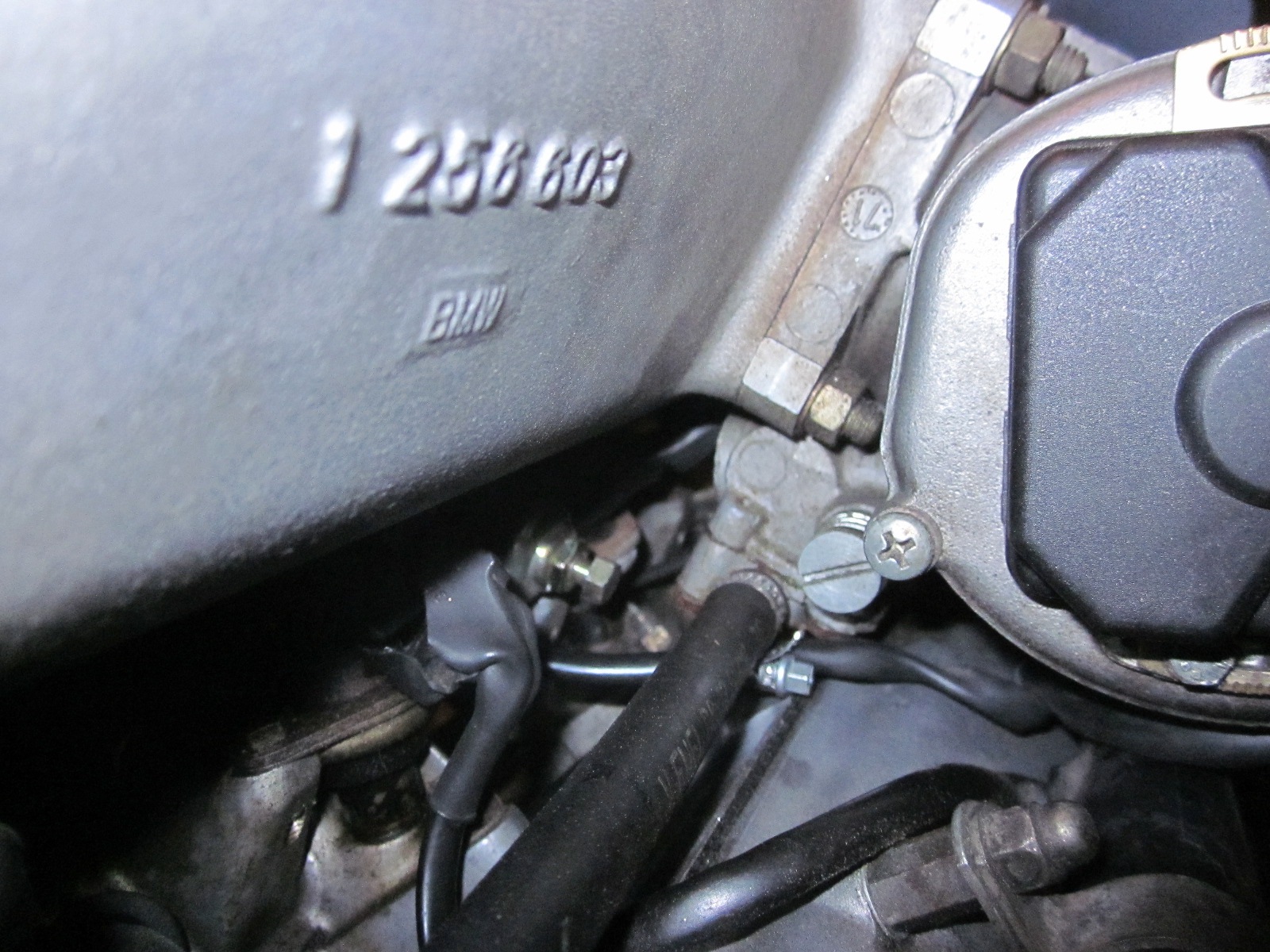

I had that exact same problem.
Under the throttle body is a large slot head screw with a spring behind it, which adjusts the idle air mixture. Unscrew it, 1/8 of a turn, drive around for a few days & unscrew 1/16. That should fix the stalling condition at operating temperature.
