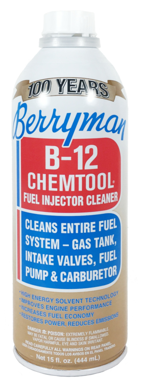

Question: assuming I'm now running much closer to stoichiometric mix, will the carbon build up on pistons and head start to go away itself, or do I need to take action to clean it up? Seafoam or similar?

Based solely on your description, it is hard to measure "carbon buildup." It is therefore difficult to respond with any degree of certainty. That said, some light fluffy deposits will typically be removed from the combustion chamber with some hard driving. Consider that so-called "top tier" fuel retailers sell fuel that contains additives that reputedly remove carbon via normal engine operation, e.g., Chevron's "Techron" nee "Techroline." This may be a safer approach than dumping seafoam or similar down the intake manifold. But if excess carbon is keeping you from getting a good night's rest, there are plenty of options, including water/steam.

That sounds like the fun bit, will see how we get on then, re-check plugs in a few hundred miles
I've heard of water decarb, sounds easy enough
