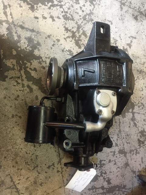

Is this the oil level for the diff?

Yep- for the 2nd gen diff with catch canView attachment 98794View attachment 98795

The Alpina version has a cooler and a pulley and needs extra oil.
The e12/24 version has a catch can and I have never put extra oil in it.

Does this catch can merely capture oil that might otherwise be discharged through the cap and onto the road? Said another way, does it primarily serve an environmental function? For some reason, I had thought that it increased the oil capacity, thereby adding a cooling effect, but I'm not sure where I got that idea.

Just a way to capture the vented oil.
Note the Automatic tranny catch can... otherwise it would vent from top of tranny down to exhaust
