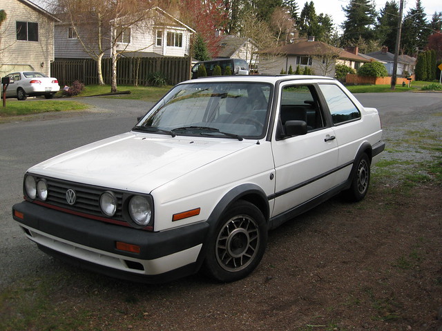

Upgrade euro-spec H4 lenses. It is the euro lens pattern that makes the difference, and the abundance of high wattage replacement H4 bulbs. These reflectors also have the provision for a city light, and will have a nice spread and increased lighting on the road. Crisp cutoffs, etc. An H4 bulb is a dual filament hi/low. I always ran 55/100's in my H4 lenses. That's 55 low so people don't flash you, and 100 high instead of the standard 60w. You can also run 80/100's but I always thought that was a bit much for traffic. The biggest issue I see with these (as Chris pointed out) is that they stick out quite a bit past the housing ring. I honestly don't think they will work properly with my headlight wipers since the stops are attached to the rings. :(
http://www.rallylights.com/hella-5-3-4-round-h4-e-code-headlamp-with-city-light-hl66021.html
That leaves you with the inners. Since the H4's have high beams, run some Hella Comet 500 spotlights in the inners.
http://www.ebay.com/itm/HELLA-Unive...Fog-Driving-light-1N4135224-011-/151623321040
These are the same 5 3/4" pencil beams that were on my VW. I ran switched power to them so they would come on with the 7" H4's when desired. 130w H3's. I drove a lot at night and they were like aircraft landing lights. Far too ridiculous near houses and honestly a little intense with reflective road signs.
