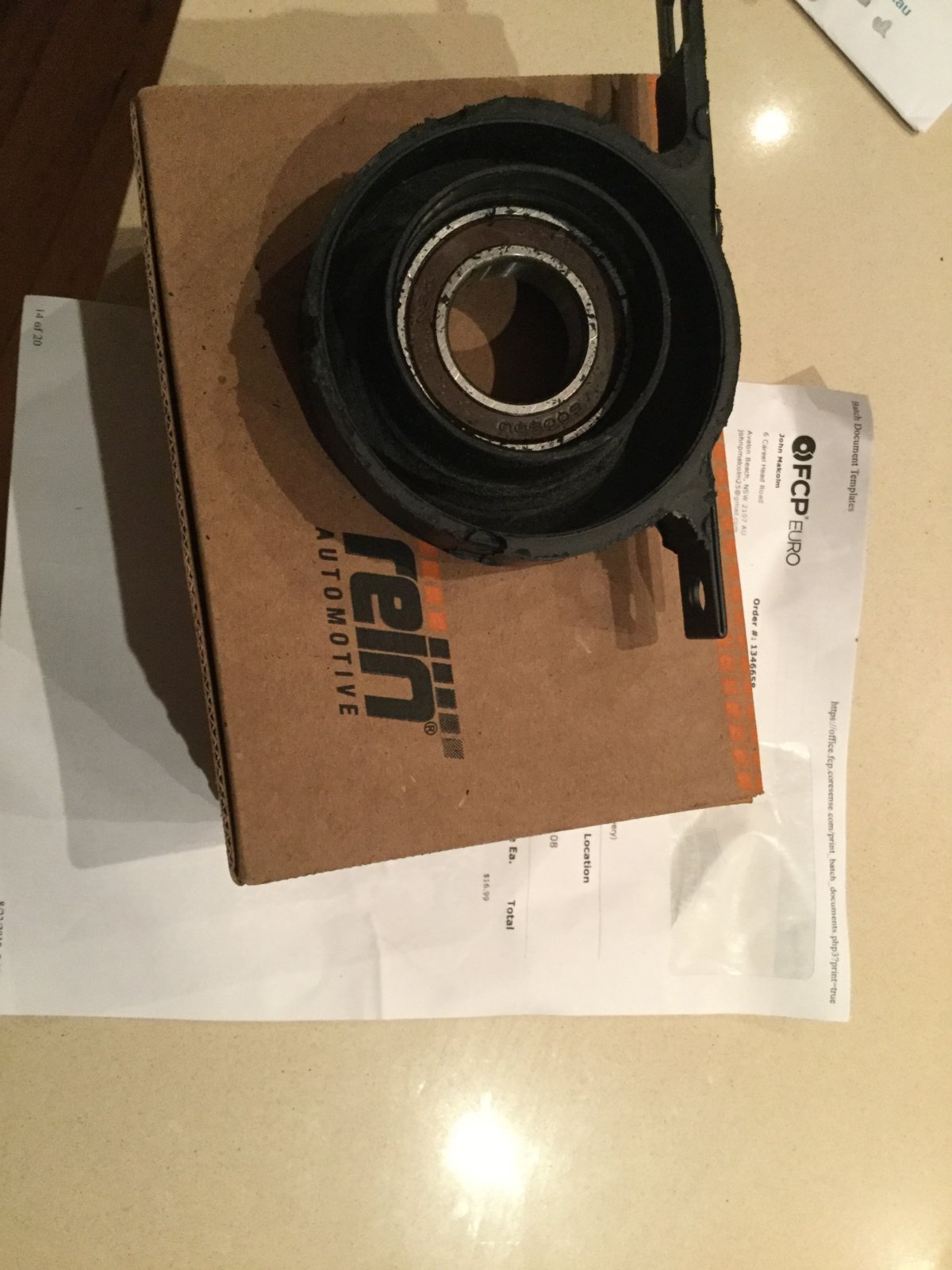

I thought about the central bearing too, so I replaced it, even if it was already new, I took the opportunity to check the alignment, but the problem persists
it even happens that when I'm in a bend, without accelerating, the vibration occurs, even in neutral

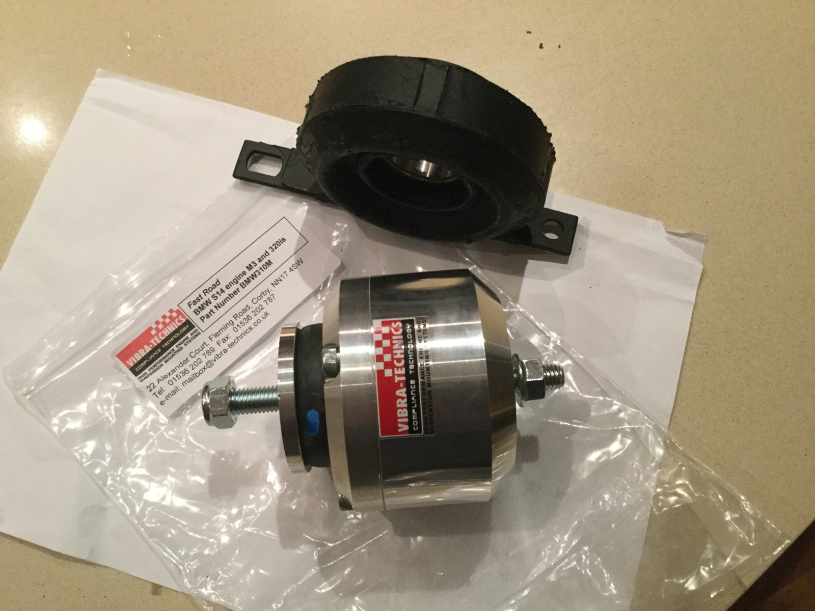

View attachment 51158 View attachment 51159 So new bits arrived..
Just to be clear, I assume that we are looking at the rear of the center mount and to preload it you push it towards the engine by a mill or two then final tighten?
The engine mounts look more than up to the job and I will report back when fitted
I would like feedback on the assembly of these m3 e30 engine mounts on the coupe
