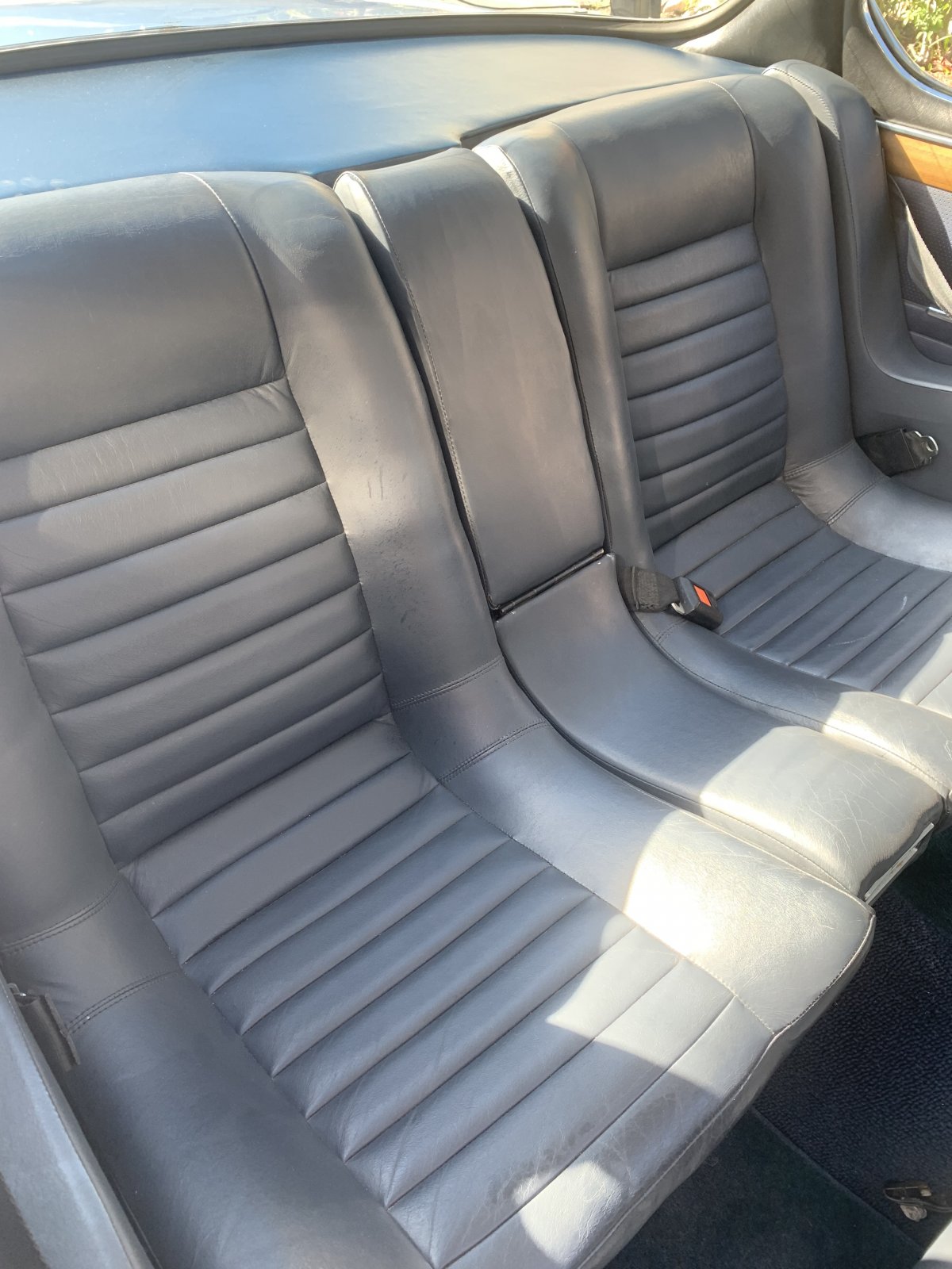

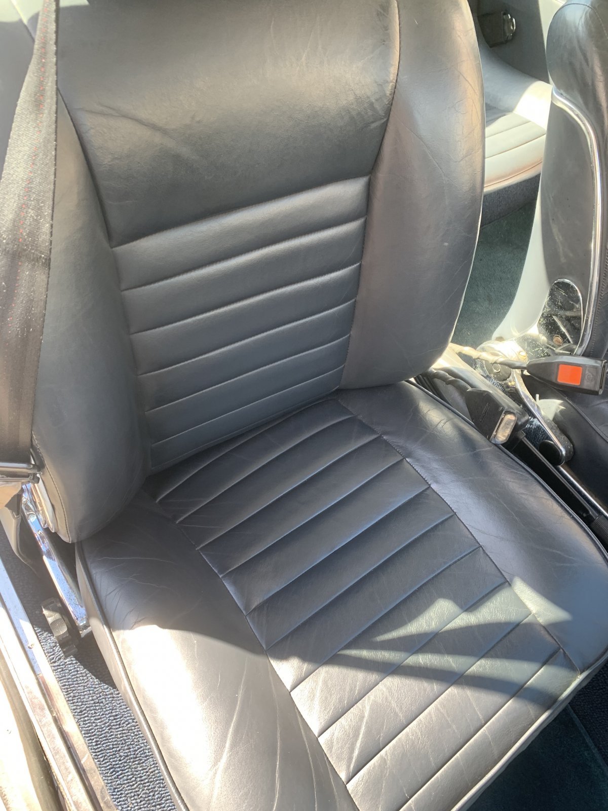

  • Seat pleats changed from vertical to horizontal, shoulder is now sewn and not tucked, headrest post caps are now black?
  • Lower seat is longer
  • Horseshoe shaped chrome trim on bottom of seat is now metal instead of chromed plastic and much thicker
  • Autoflug seatbelts have a new male tongue and receivers have revised shape with red pushbuttons
  • Front seatbelts have retractor inside rear armrest cover which is wider with a slot for the belt with a hook under the rear quarter window and a movable triangle to keep belts elevated at shoulder height

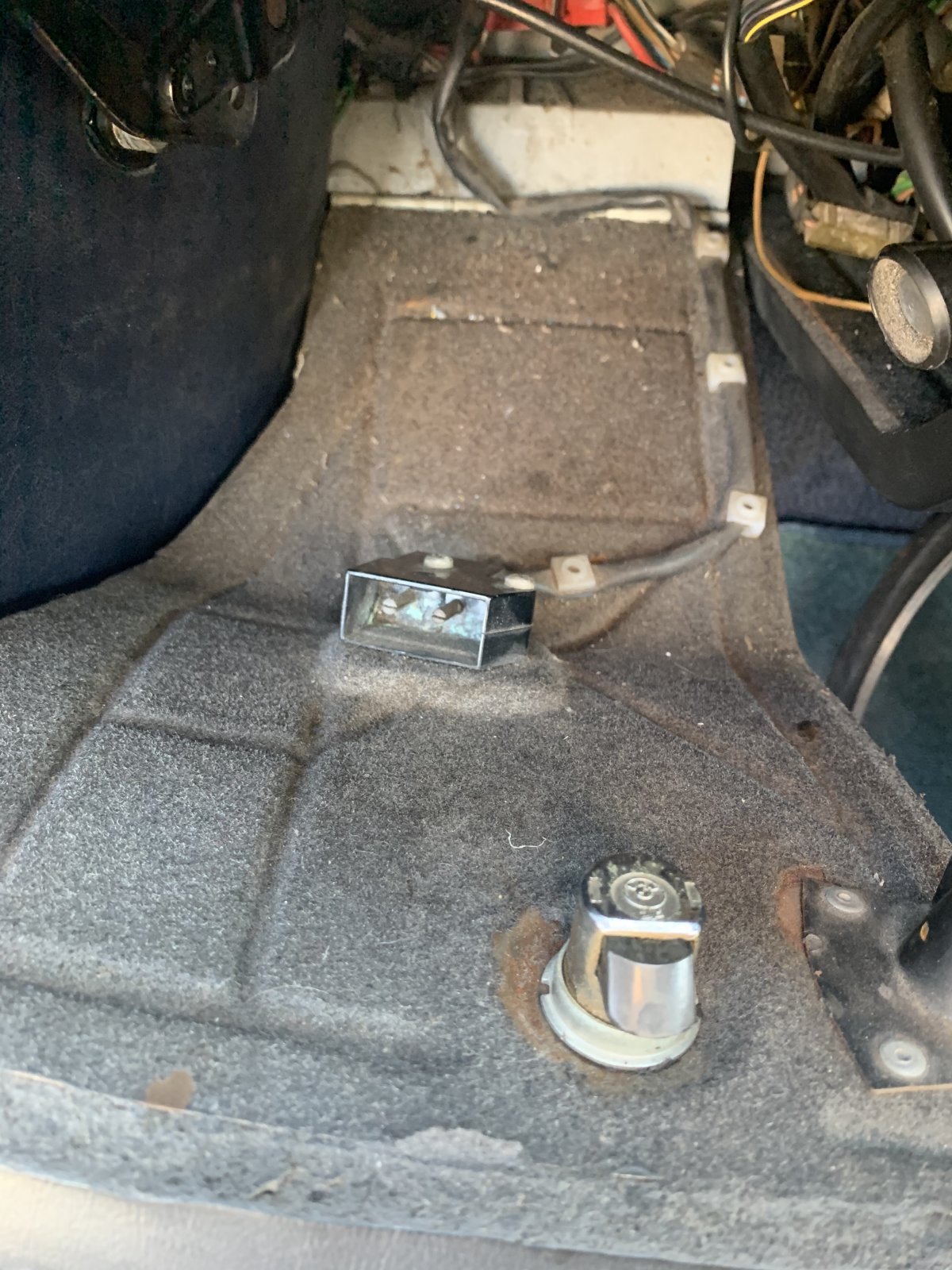

  • Changes made to wiring harness, wire thickness changes, low beam/fog relay added, A/C fan switch revised which eliminates change-over relay at fuse block, seat belt interlock system added (relay under rear passenger seat)

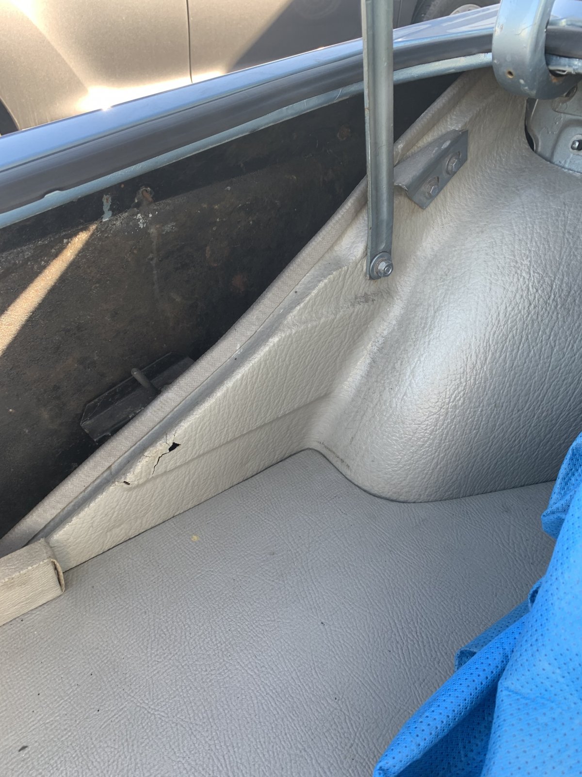

  • No trunk caddy due to bumper supports, trunk boards narrower due to frame bracing
  • Toolbox is now a stronger one piece plastic with no lid, just foam on trunk lid
Exterior Changes
  • US/NA market coupes get a 5 mph shock absorbing bumper, front frame rail wider and long supports added inside trunk with longer plastic elephant skin covers
