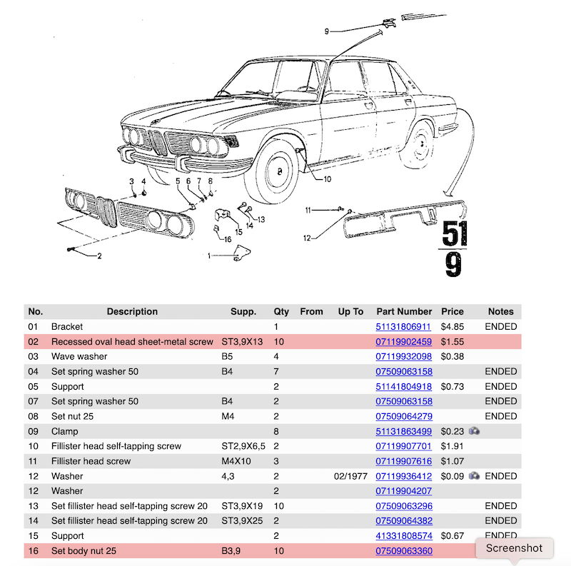

Dick Steinkamp
2,465
2,900
Bellingham, WA

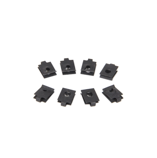

Here are the BMW PNs for the screws and clips and the generic OE screw and clip sizes. As Chris advises, be sure to get black screws.
