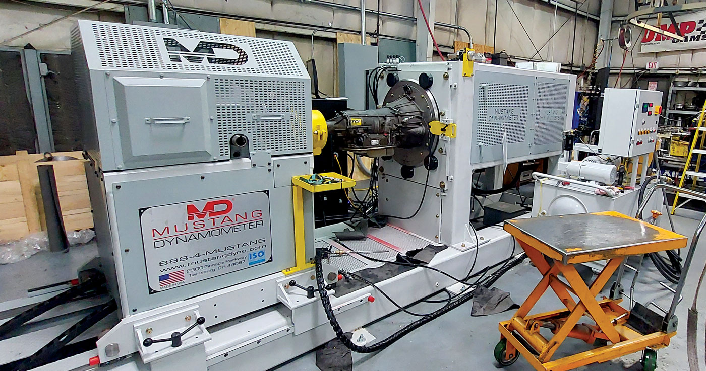

My auto transmission guru built himself a transmission dynamometer to test them outside the car...
I do not know if he can test a manual.
The off the shelf machine is probably expensive:
