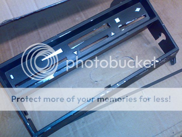

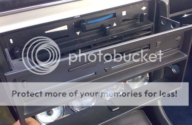

the usual aspect of this part is
it is impossible to repair partially as the paint seems to be badly glued to the aluminium, so any partial repair will be covering the defect but not solving the problem
the first problem is to dissasemble the plastic grille, be very careful to pry out the two lateral plastic clamps

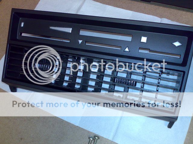

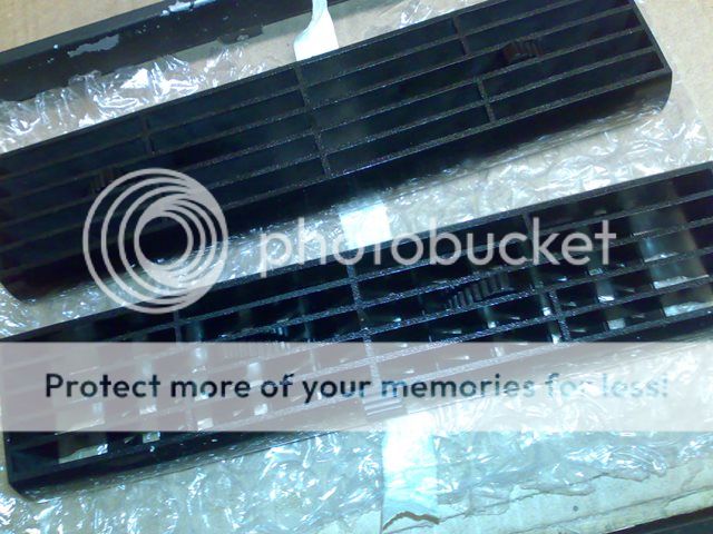

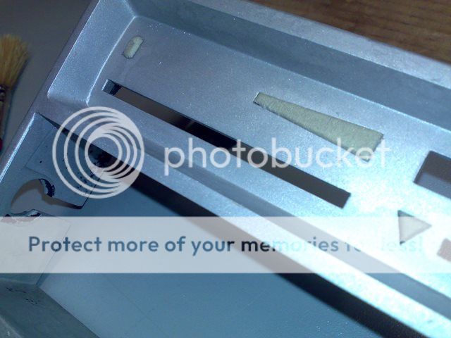

once dissasembled i tried several ideas to do this, first i realized that the signs were solid aluminium inserts, that means that you can not remove them, but they are easy to mask as there is a separate thing from the fascia
so first i removed old paint chemically, but the base surface is too flat and i intend to reproduce some rugosity, so i sand blasted it protecting the signs
i painted and checked with the actual tone, were four layers

deQ, great job as always, but how come you did not use a wrinkled/crinkled paint to match the original texture?

facia plate
Hi,
Actually the finish is not flat or wrinkle but more of a finish like smother sandpaper. I have powder coated these with a powder from Eastwood called hotrod black or rattle can painted them with a product called " stone " paint by restoleun.
Wrinkl;e is close but not close enough.
My part is trapped in a box of parts that I really don't want to dig out right now. I have experimented with all sorts of paint, powder and ways of doing this but the "stone " finish comes out really good depending on your prep work.
My 2 cents worth.
Thanks, Rick

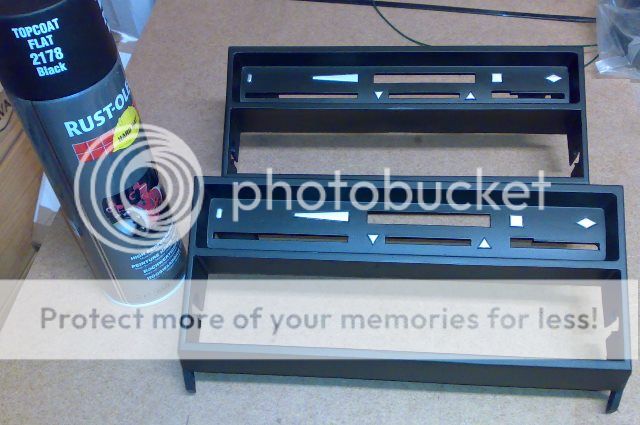

There is also rustoleum textured aged iron, most people rough up the surface then spray with a flat black to get the look...
thanks bert,
a wrinkle paint would not do the desired effect
a textured aged iron would be interesting to test
the real pattern is irregular a sort of drops not of the same size but the same height
but i feel that the result is good enough

We used to have to replicate a similar structure when we wanted to make something look like plastic (for car hifi installations).
What works with a little practice is to rattle can spray paint it with matte black and make a bad job of it. Meaning: You put a nice smooth layer on it first and then before it fully dries you put another layer on it but hold the nozzle too far away so the paint almost air dries before it hits the part and you put a much too thin layer on it so you get the dimples and the paint has no chance to run into each other to create a smooth surface. You can even vary the texture with a little practice...

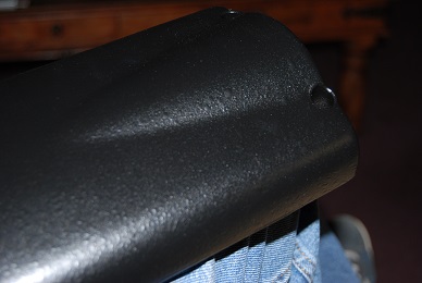

spatter finish
Hi guys
I have a sprayer here in the UK who has provided a "spatter" finish for my steering column covers and my Alpina airbox. it will also be OK for the heater fascia.
it is as near to the original as I can find, please see picture

That does look very accurate Daddywad. Do you know how this is applied and is it available in a can or quart? I have played around with using GM trunk splatter paint followed by a coat of low sheen black and it seems to have some potential. I forget which forum member suggested this.

Hi Bob, its a sprayed then baked finish by a specialist finisher company near me.
I will see if I can get more info on the make etc

I had mine powder coated then went back and painted the indicator areas with a aluminum paint that matched original.
I had painted my at first with lots of prep time and good primer.
It was not that durable and the slightest little rub or scratch and it was ruined.
