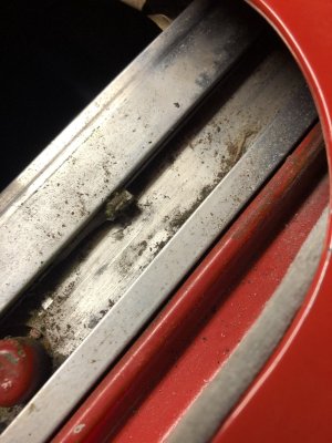

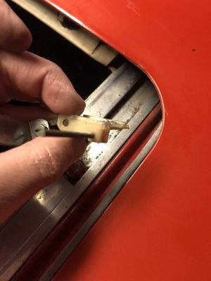

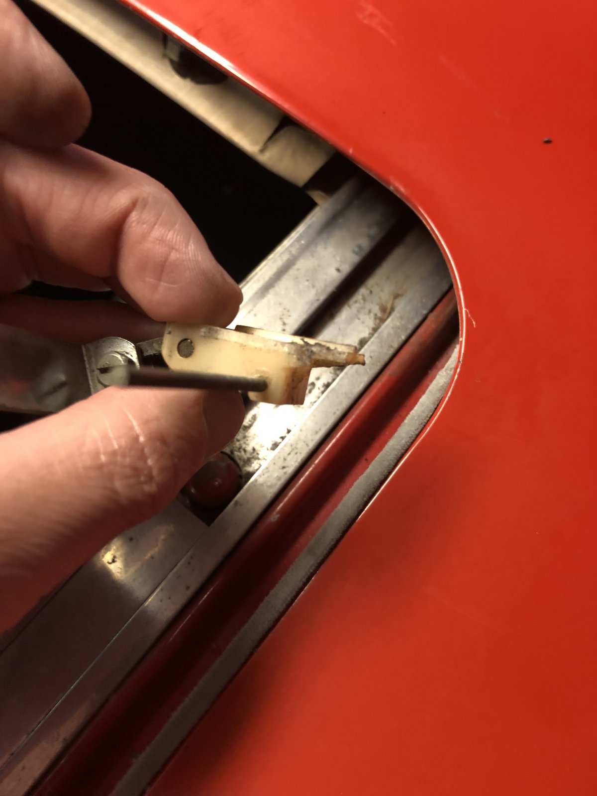

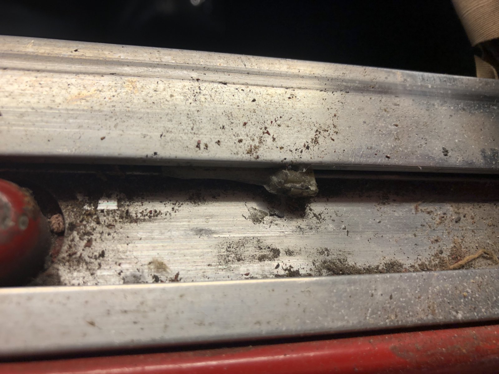

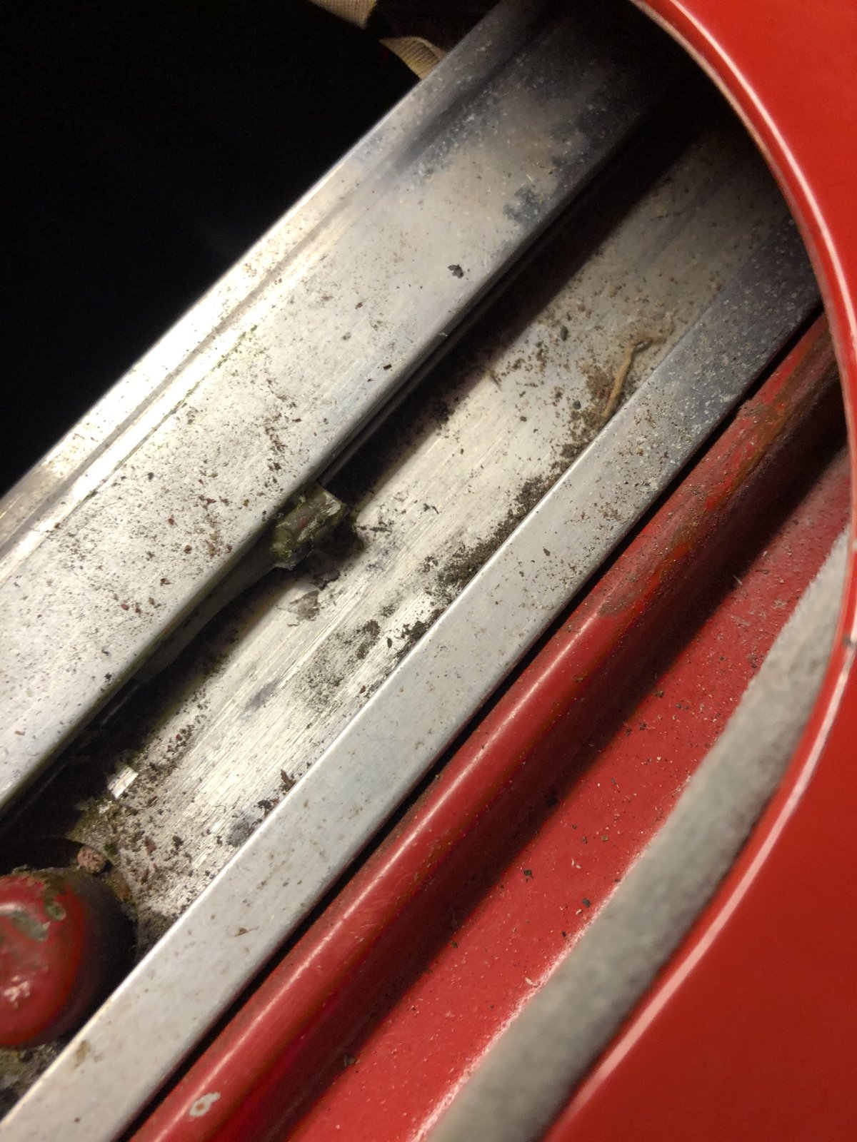

Anyone have any ideas how to repair or get a replacement part for the sliding mechanism on a manual sunroof? I was replacing the sunroof seal (that went ok), and must have twisted the assembly such that the fragile plastic in the mechanism broke when I was replacing it after installing new seal. I’m afraid I won’t e able to bind it well with any adhesive, so would like to understand better how it works and if there are parts available? Any help appreciated?

I can't tell what I'm looking at.
Piece of plastic on the cables?

Thanks! When I took the cable guide covers off, I realized it’s part of the cable assembly. I found the part on eBay. I also found a video where a VW beetle with a similar sunroof system replaced the cable. It looks straight forward, but I’m sure I’ll mess it up.

Well, I used two part loctite glue on the plastic cable piece and got it back together. The sunroof is now closed. It worked a couple of times, but now won’t open again. I didn’t hear anything come loose or break, and don’t want to force it with the handle. I assume the driver’s side cable broke again, but least it’s closed.
Any other reasons that one might think of why it won’t open. I thought I did a pretty decent job of ensuring the roof was level, but it’s hard to tell, as my job of installing the new seal is not quite even.
I have a new cable piece on the way, but I think that when it arrives I might take it to a professional. Just in case I give it another try, any idea how I might slide it open again now that it’s closed.

Forget trying to glue 50-year old plastic that is used structurally. Even if your bond holds, the plastic is just going to fracture elsewhere, or the cable on the other side will break.
The Volvo cables, with metal ends are the way to go. As I recall, they are longer, not shorter than the e9 cables. But either way, they are a superior solution.
