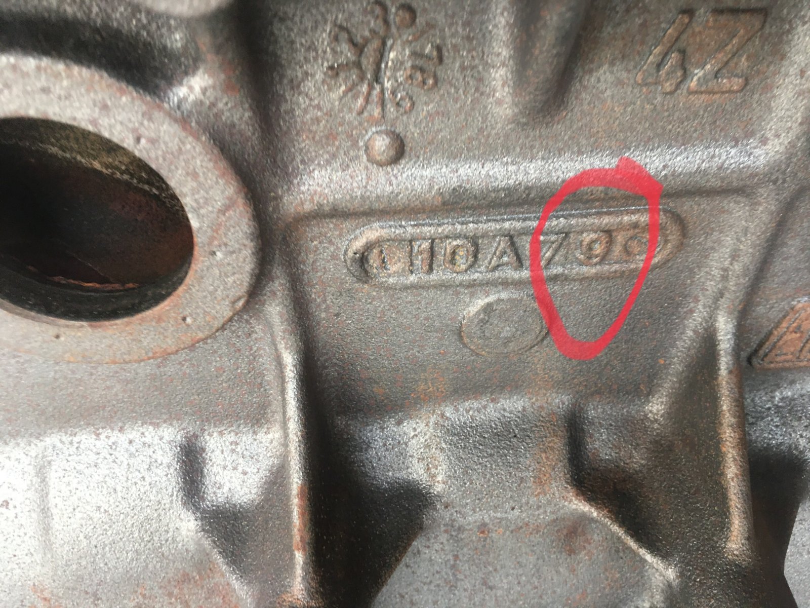

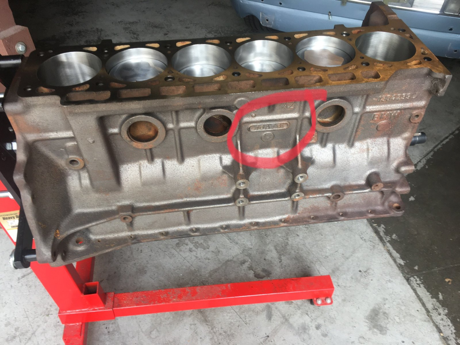

I am trying to find the engine number on a 72 E9 motor can anyone help me out. Did they stamp the vin number on the block or does the motor have it own number.
sfdon
8,296
4,650
sfbay area
All m30 engines in the same place....

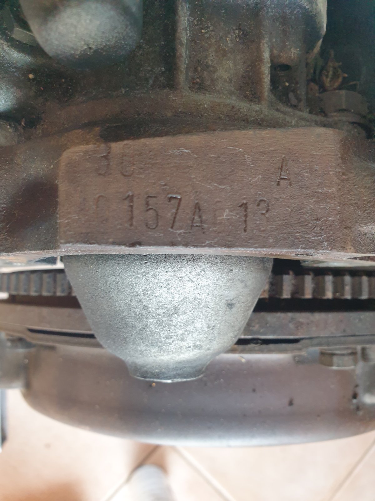

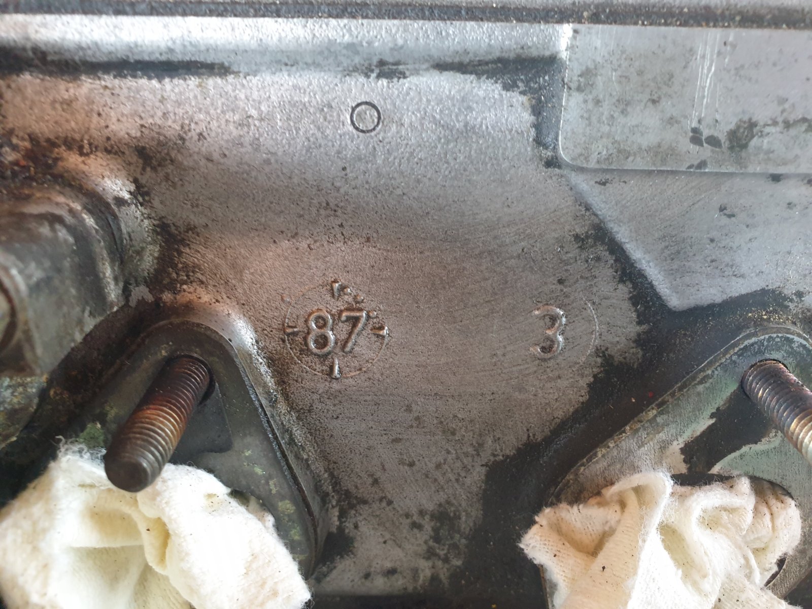

Could someone help me with my engine serial number as I would like to determine if it is original or not.
# stemped are 0157A013 which doesnt match my chassis number and does not look to be any other chassis number? Any thoughts?
My car is E9 3.0CS built in Feb. 1972.

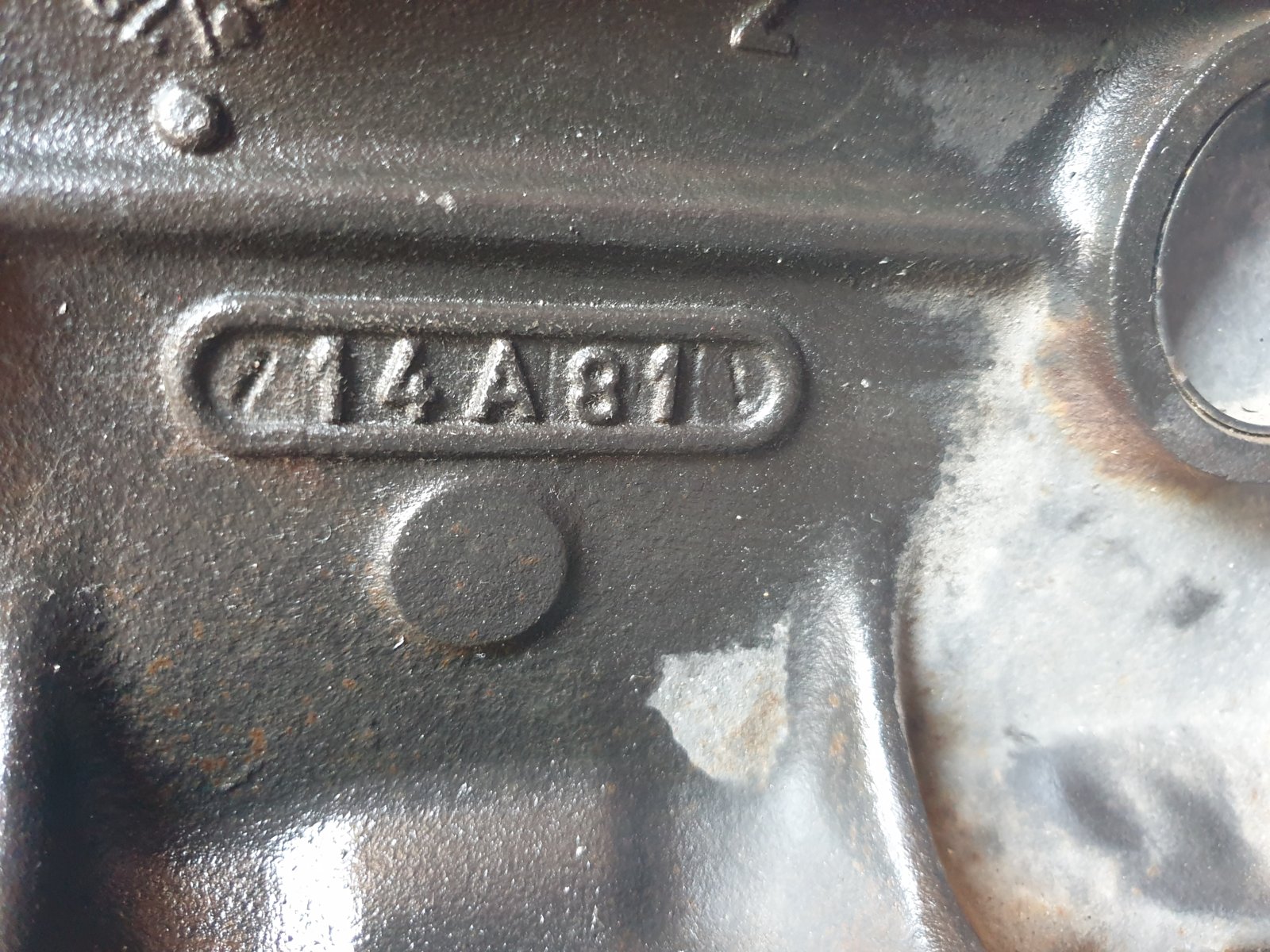

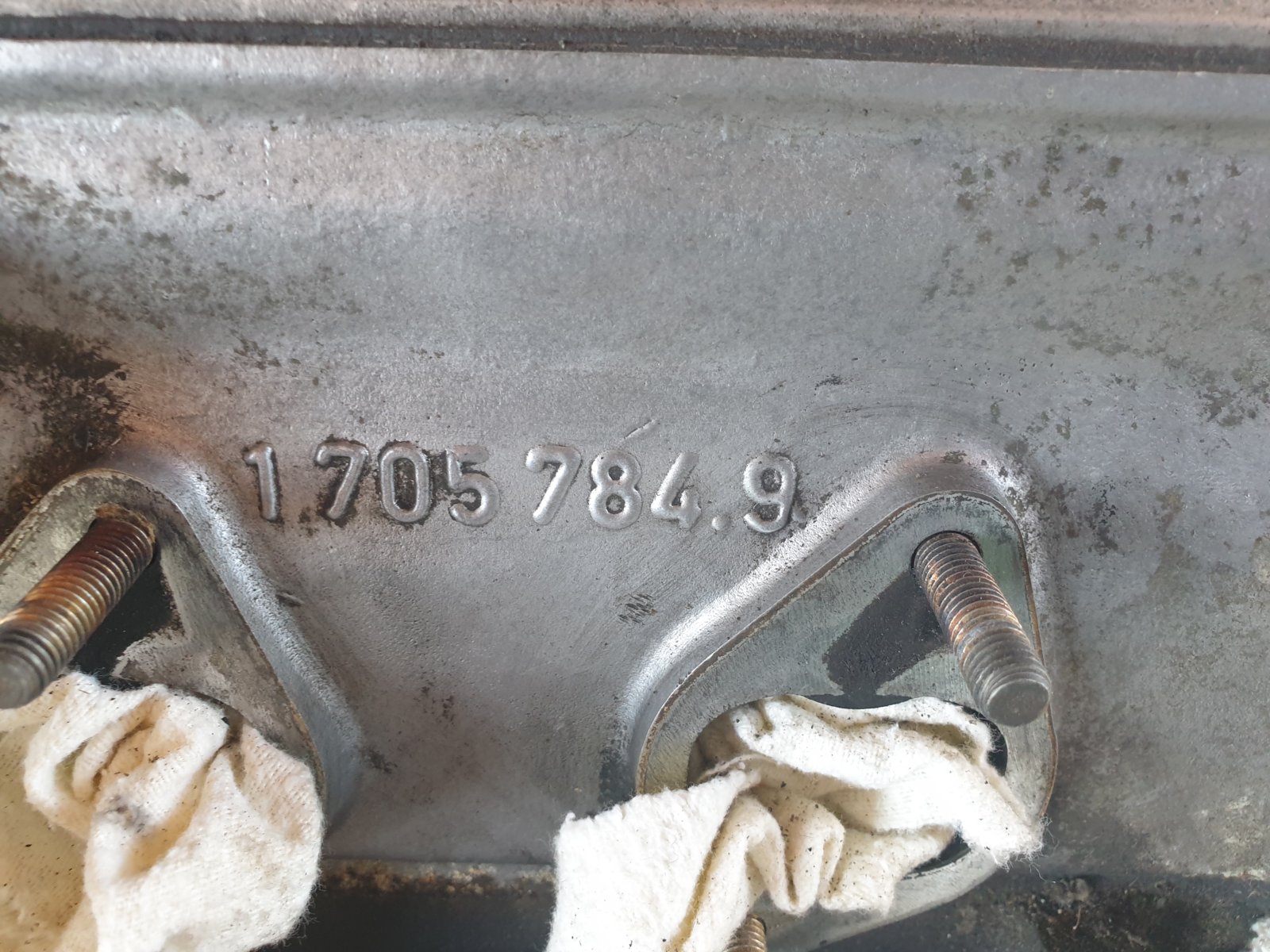

aljaz11
13
2
Thank you! Its an 81 :/ it appers engine was swapped by the previous owner however they kept the period correct oil filter, starter, gas pump, valve cover and carburetors.
