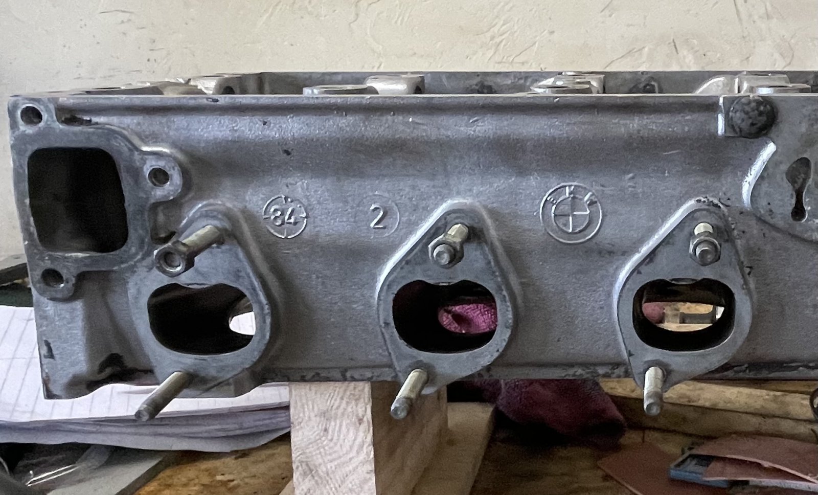

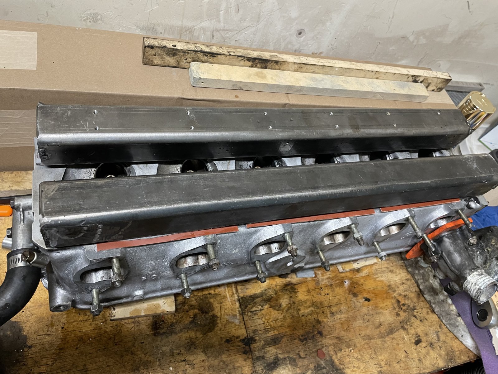

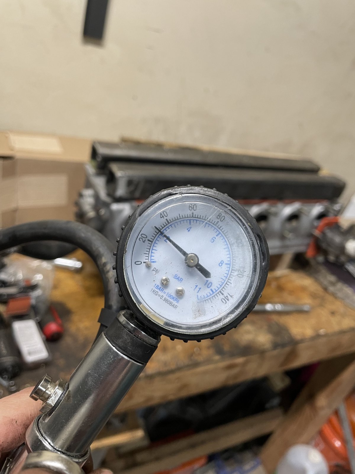

Repeated the pressure test today with better seals of coolant openings and it was holding pressure at 30 PSI. More pressure would break the seals so i left it at 30. I sprayed the head with soupy water to make sure and no bubbles at all.

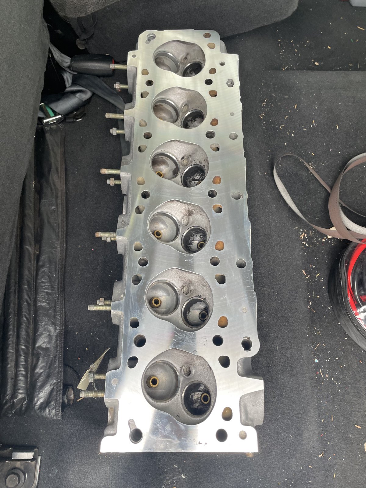

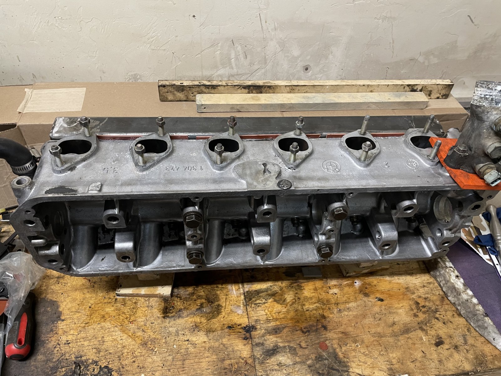

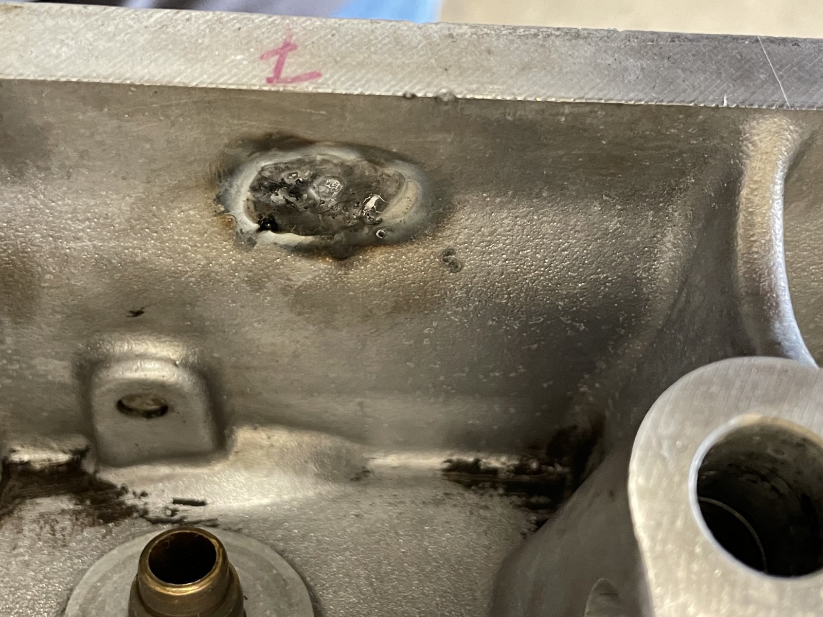

The method worked! The camshaft spins freely now.
The warpage is down to 0.005” from 0.016”
I used a tig torch to spot heat several places from the inside of the head.
Now to the machine to resurface for less than a $100.

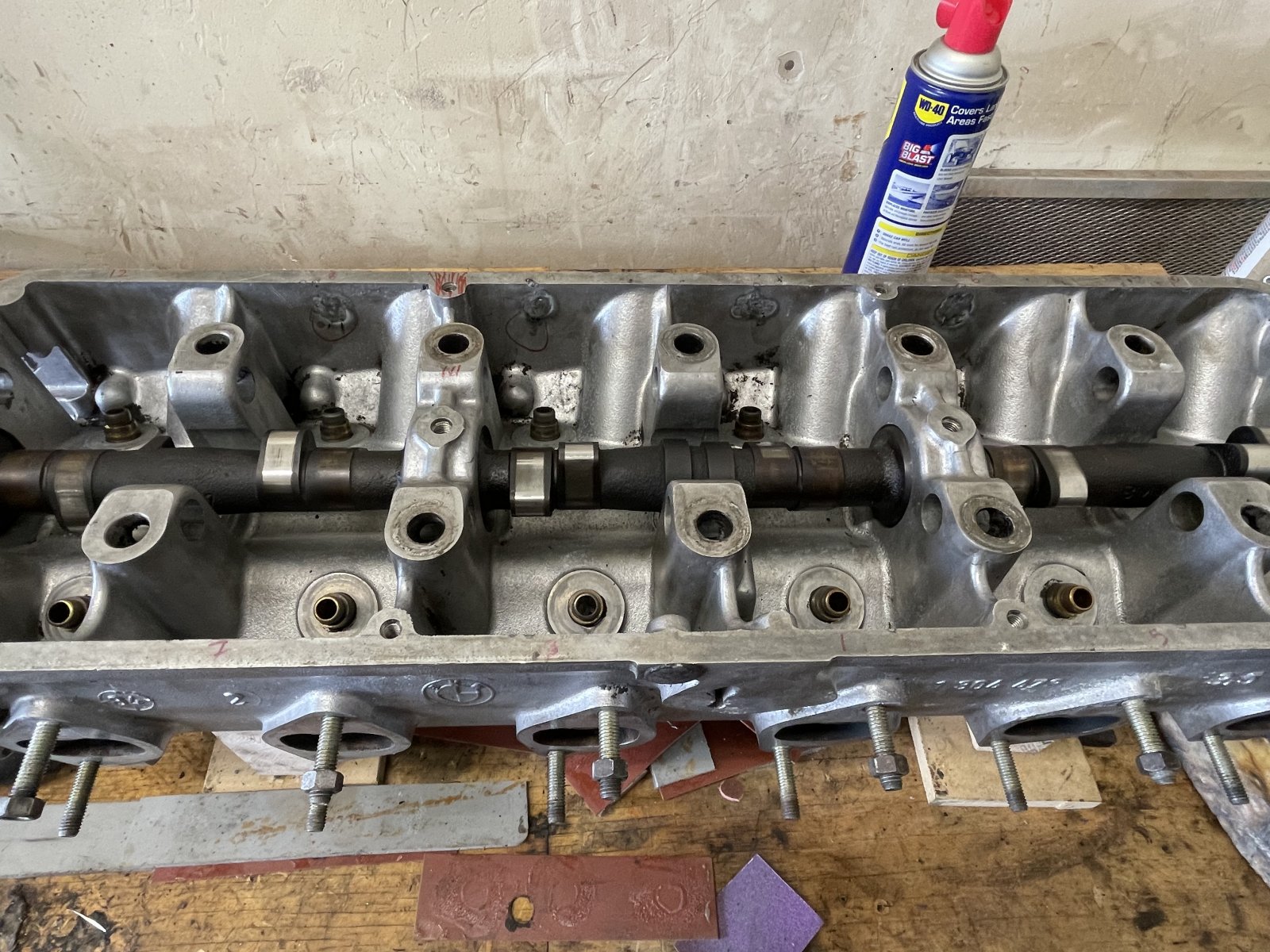

Hello guys,
It has been some time since i got the head back from the machine shop.
Ended up taking 0.008”, but the depth dimples are still visible.
I have all the valves cleaned and ready for lapping.
However, the camshaft intake lobe for cylinder #1 is worn out (i did not notice at first) so i plan to use the b35 camshaft instead. Also plan to use the rocker arms and springs from that same b35 head. The b35 springs are longer (not sure if the b32 are worn out) and they are double springs per valve…

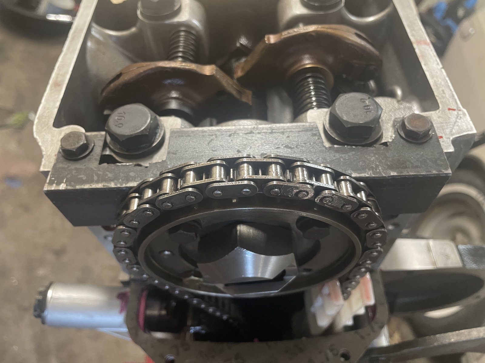

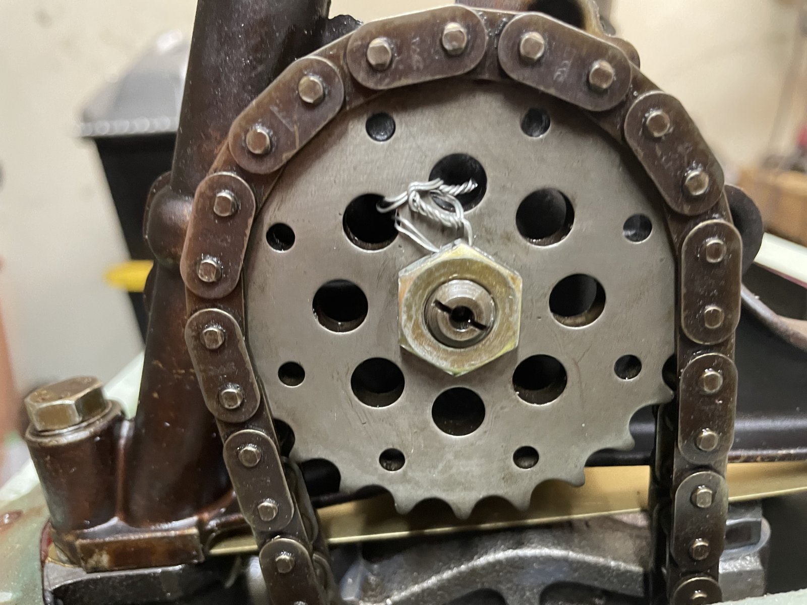

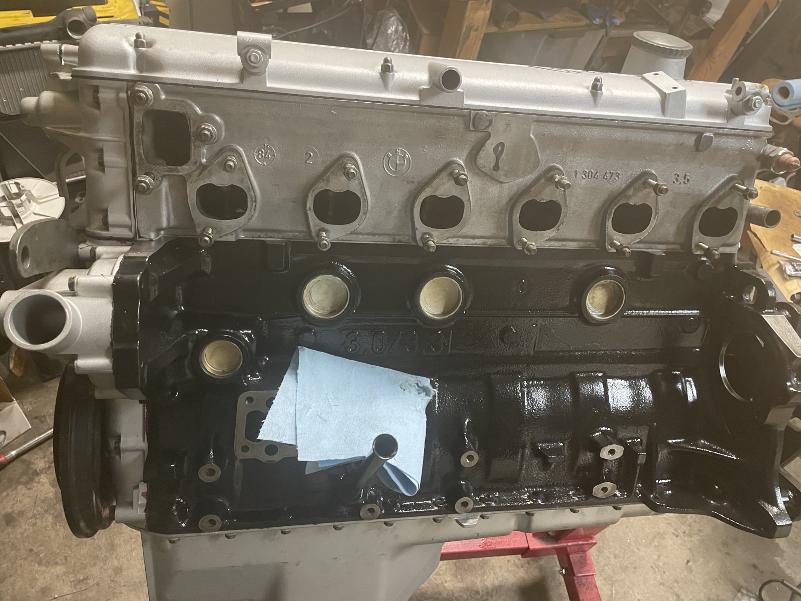

Bottom end and head are finally assembled.
Made a bracket out of an angle iron to hold the camshaft while torquing the cam nut with the head assembled to the block….
Notice something wrong though???
Well i torqued the head bolts the first two stages (60 and 80 nm) but forgot to put on the oil sprayer bar!
Will be taking them off again soon.

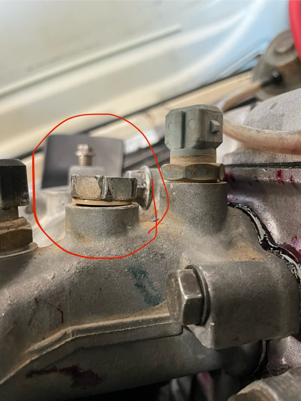

HELP NEEDED!
Hello everyone, I made the mistake of replacing the thermostat housing without an actual/pressing need to do that. The replacement housing is from an e34 with the two black and blue temperature sensors.
I tried to unscrew the brass plug between the two sensors to add the correct E3 temp. sensor, but I think I bent it. I ran the engine up to the operating temperature, but luckily there was no leaks.
Did anyone run into this problem before? any idea on how to take that stuck (really stuck) brass plug out?
The existing blue and black sensors have different internal resistance than the E3's sensor and the reading would be incorrect on the instrument panel gauge.

Repeated the pressure test today with better seals of coolant openings and it was holding pressure at 30 PSI. More pressure would break the seals so i left it at 30. I sprayed the head with soupy water to make sure and no bubbles at all. View attachment 157839View attachment 157840

Hi Barry,
I drilled and tapped those 2”x2”x 0.25” tubes and used two head bolts per tube to keep them in place. I think i tired clamping them in place, but it didn’t work for me.
I used a junk head to test fit my setup as I was careful not to damage this one.
