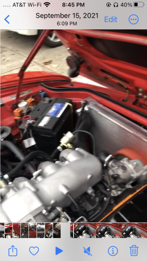

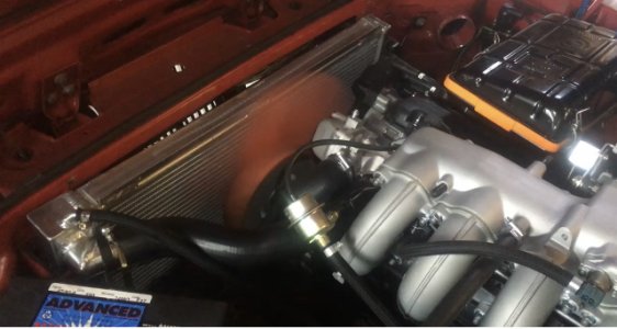

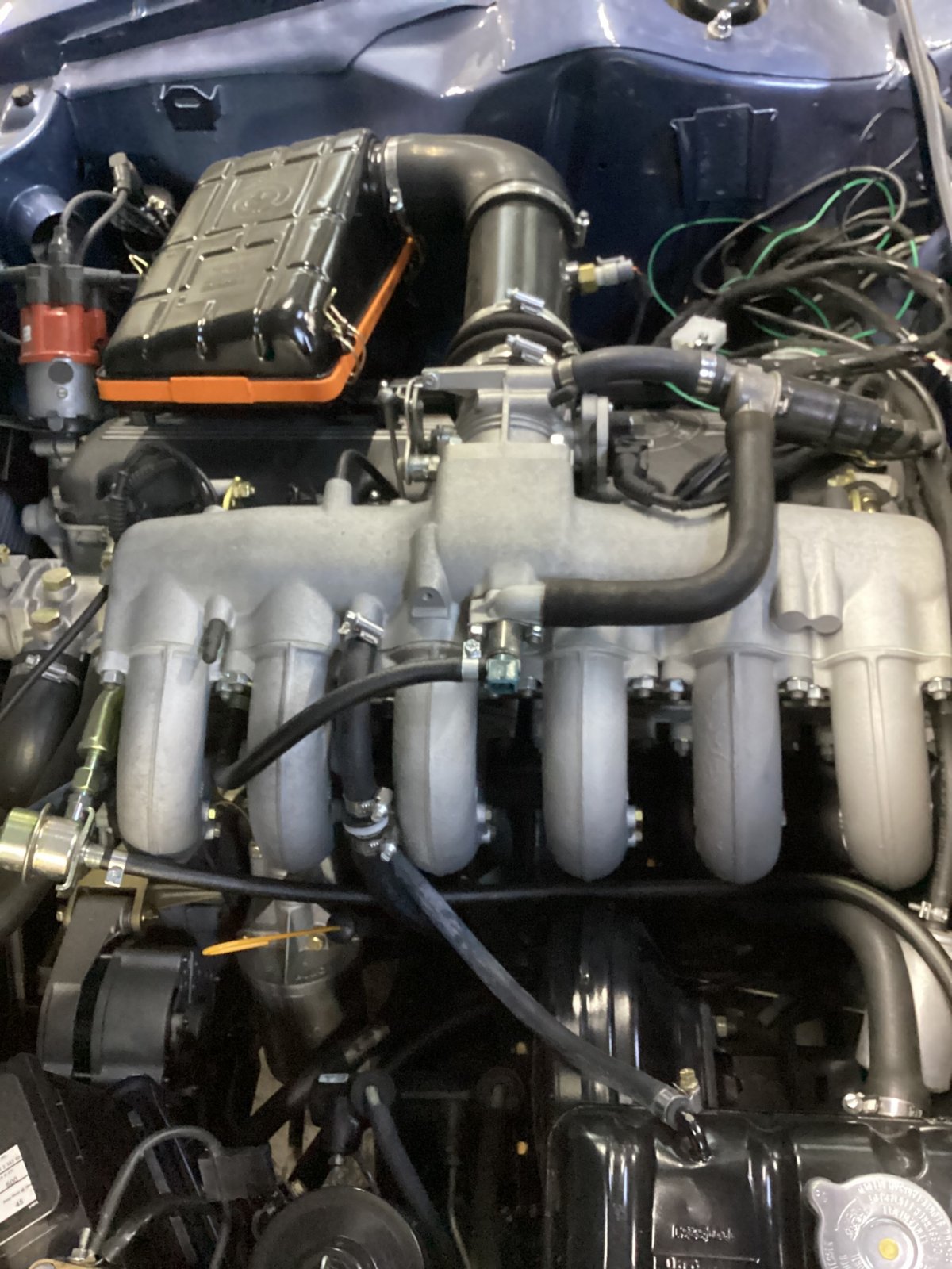

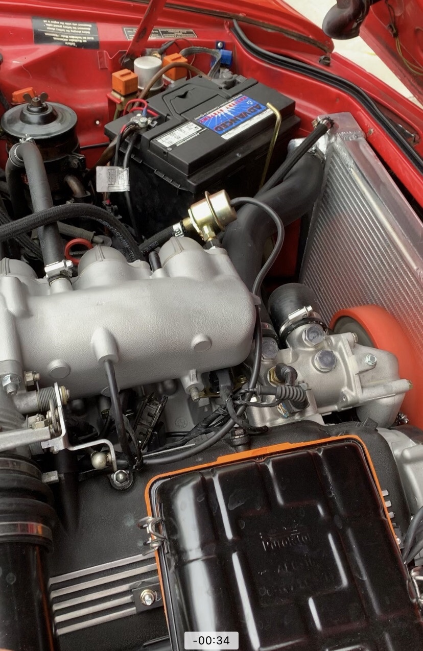

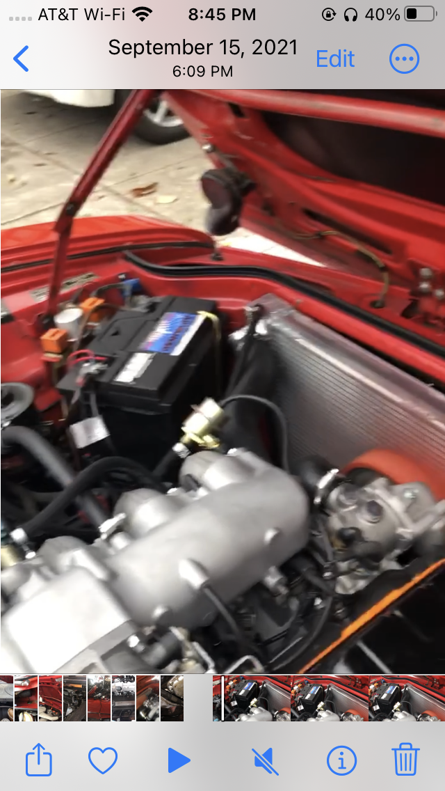

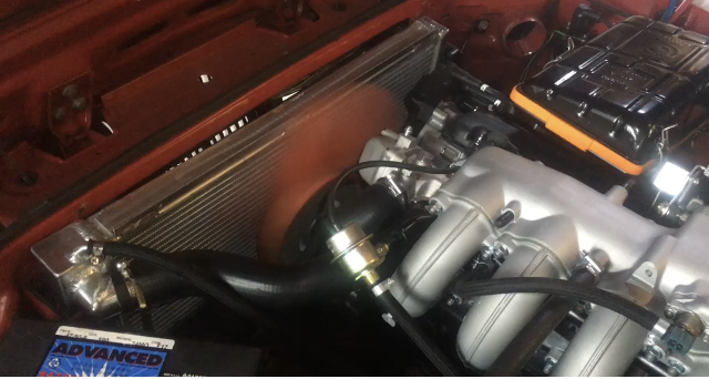

In Don (SF) we trust. Don did my FI conversion for the M30B35 in my Bav. A before, during, and some after pics. Happy to connect if you want more info @shoobie33.

Hi there
I see you have a nice new radiator also .
Do you know what brand/ type it is ?
My radiator is 50 years old and as the car has been off the road since 1988 and I haven’t had the car running yet, it probably needs a rebuild or maybe a replacement like your one.
Good luck with the conversion Kevin by the way!!

I used an aluminum Champion brand for my '69. Works great. I think they're around $250, maybe less.

Hi there
SF Don sourced that for me as well:)
