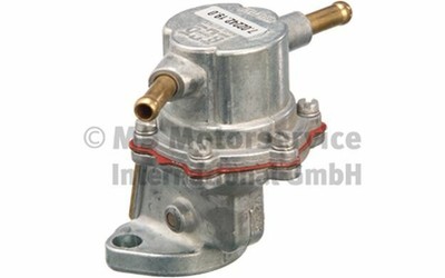

If I were you I'd get another pump as that will most likely solve your issue, I see them from time to time on ebay - Here's one I found without even trying (I would look up the part number and search for that, also translate to German and look on ebay.de etc. etc.)

The pumps are inexpensive enough that replacing it is probably a good idea. That doesn't eliminate cam lobe and push rod wear, but with only 60,000 miles on the car, that shouldn't be an issue,
