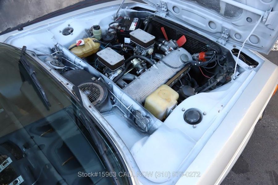

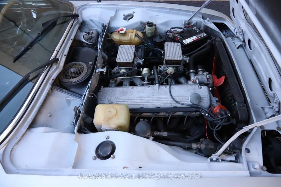

Nicer than their usual.
Not sure on the shock towers (front) if they've been smoothed out or not:
Krzysztof
1,673
799
Poland
Fresh primer on some engine bay parts is not convincing about the condition of the front fenders and strut's reinforcement to be finished properly.
bmw2800cs
1,150
499
San Jose, California
I've been looking at Beverly Hills Motoring cars lately and I'm getting the impression that they blast a coat of paint (lipstick) on a lot of cars. That kind of crappy overspray that I see on the back of the hood may not be an issue but I do lose confidence.
