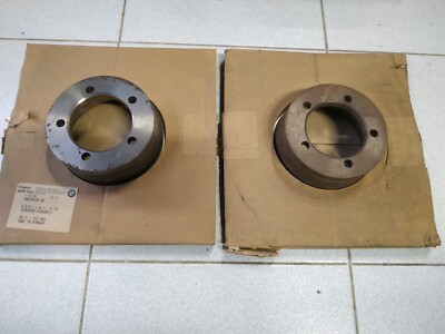

OE number for 1971 2800CS front rotors.

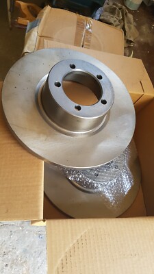

Found them at Rock Auto! thanks Dick!
I bought disks from Rock auto about 4 years ago, they were the wrong disks. They may have fixed this. I understand some of us get disk upgrades from Walloth Nesh. I don't have the details, maybe someone in this forum can help.

I've had good luck with Rock Auto. The detail to determine if you are getting the correct part is usually there if you click on the INFO box next to the part you think may work.

I already went down that road… those are the wrong discs… they will insist they are fine… nope. Did this less than two months ago
raybestos … wont fit. Tried two different times. All of them got sent back.

How did the dimensions Rock Auto quoted differ from what you received and/or the ones on your car.

The “hat” as my dad always called it is the wrong dimension. Both in diameter and depth. Also, one set I received had multiple holes for mounting which all were wrong and did not line up.
