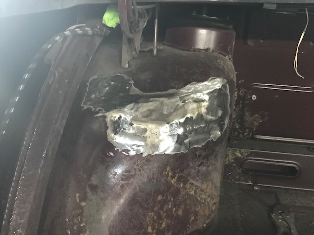

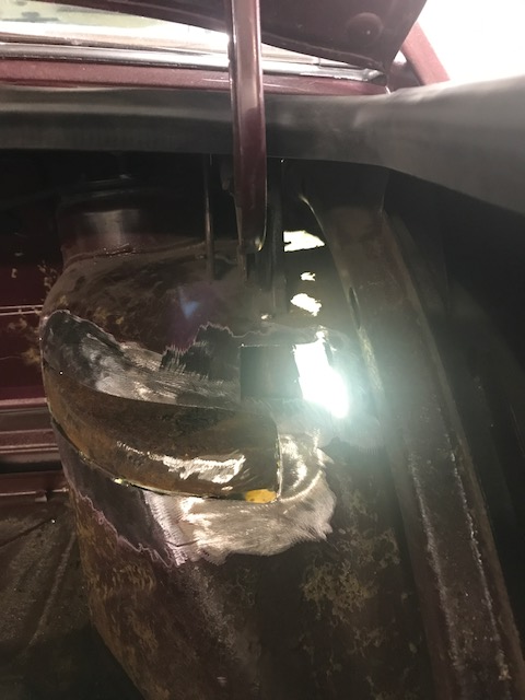

Greetings, from Florida, Going to go see this Bavaria soon, Present owner sent me this picture. Curious question to you is? Near the top of right-rear wheel tub appears to be a welded in oblong section with a brushed in bright blue paint applied by brush, Rotted out Wheel tub? Any explanation of what happened here? Thank you. Larry Louton

Rust mitigation. That area seems more problematic on 2002’s than e3’s. That would rust from driving in the rain, not sitting in the rain. I would keep a close eye on the rest of the front and rear wells, and the outer footwell area of the firewall.

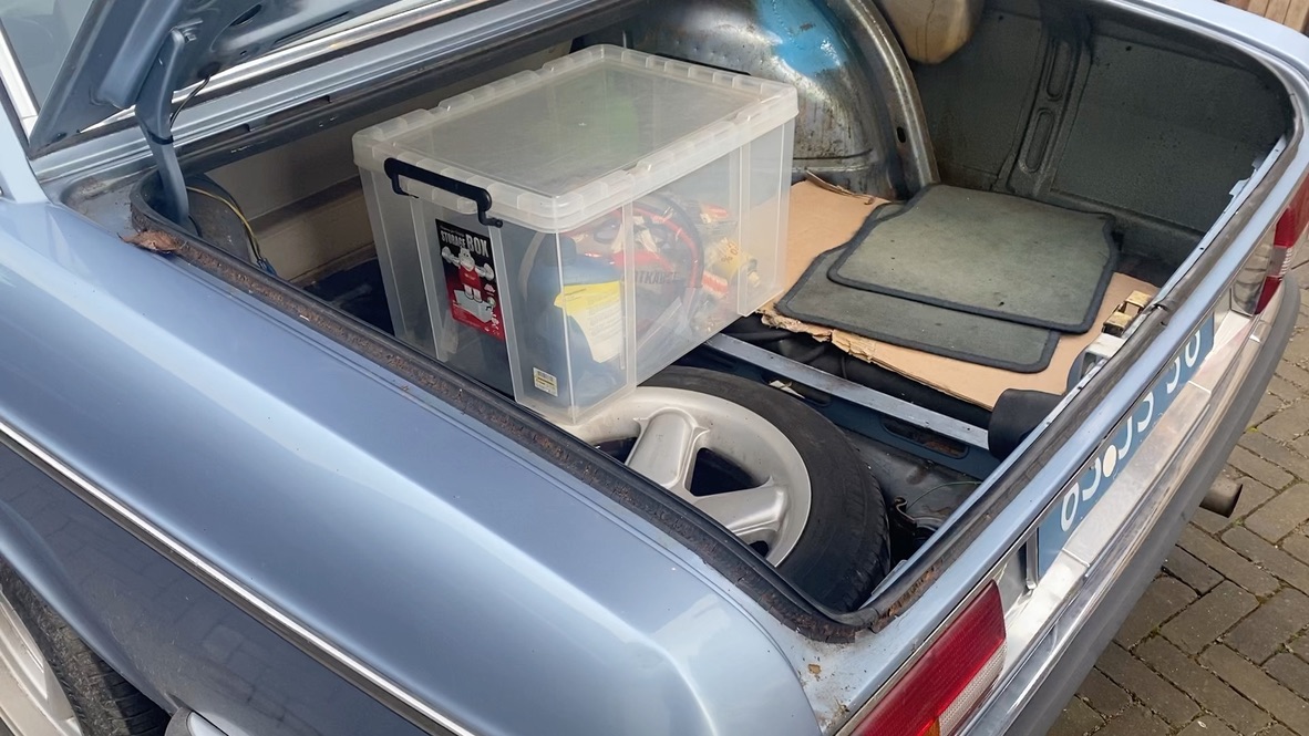

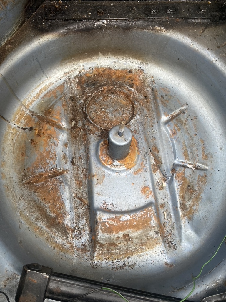

Be sure to remove the spare tire. That trunk gasket looks terrible & the easiest access for water to get in the trunk.
This is a common problem with all 1960-1970s BMWs. It takes some time to adjust the trunk lid to stop the water.

Looking into the wheel housing from the outside you will find a welded in panel near the top. Panel and housing form a box for additional stability around the strut tower. Over time dust and humidity get inside but never out. In effect, the wheel housings corrode along the welding line of the stabilising panel. This is very common on E3 and visible only with wheel housing covers removed. You may also take out the rear backrest to inspect the front side of the wheel housings. Rust there would come as no surprise, either.
Above the left rear light it looks quite rusty, too, which is less common than the spot you mentioned. All the boot lining seems to be missing, I wouldn't appreciate that.

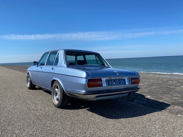

Is this a Bavaria at all? The licence plate looks a bit Dutch, it may be not a USA version E3. If you can get the full registration number and the VIN, it might be possible to find some information about the car. The BMW E3 Club, of which I am a member, runs a registry based on VINs, maybe we know it. To be fair, most of the 222000 E3 produced we don't know (yet).

Mine had corrosion on both sides in the same location (was aware when I bought it, we adjusted the over-the-phone pre-negotiated price which assumed there were no issues.) Left side was not bad, right side was significantly deteriorated and needed a lot of work, was close to being a structural problem. Repair of both sides was around $1500. Rest of car was completely rust free, this location just traps moisture over time as noted above.

Those little "dimples" in a horizontal line on the right wheel well also part of a repair? I don' t have my car available, guess they could be spot welds from the factory but I'm thinking no.

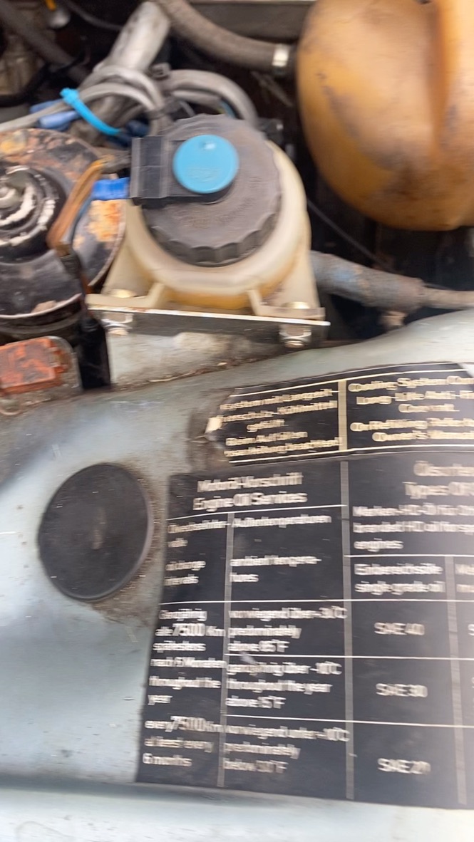

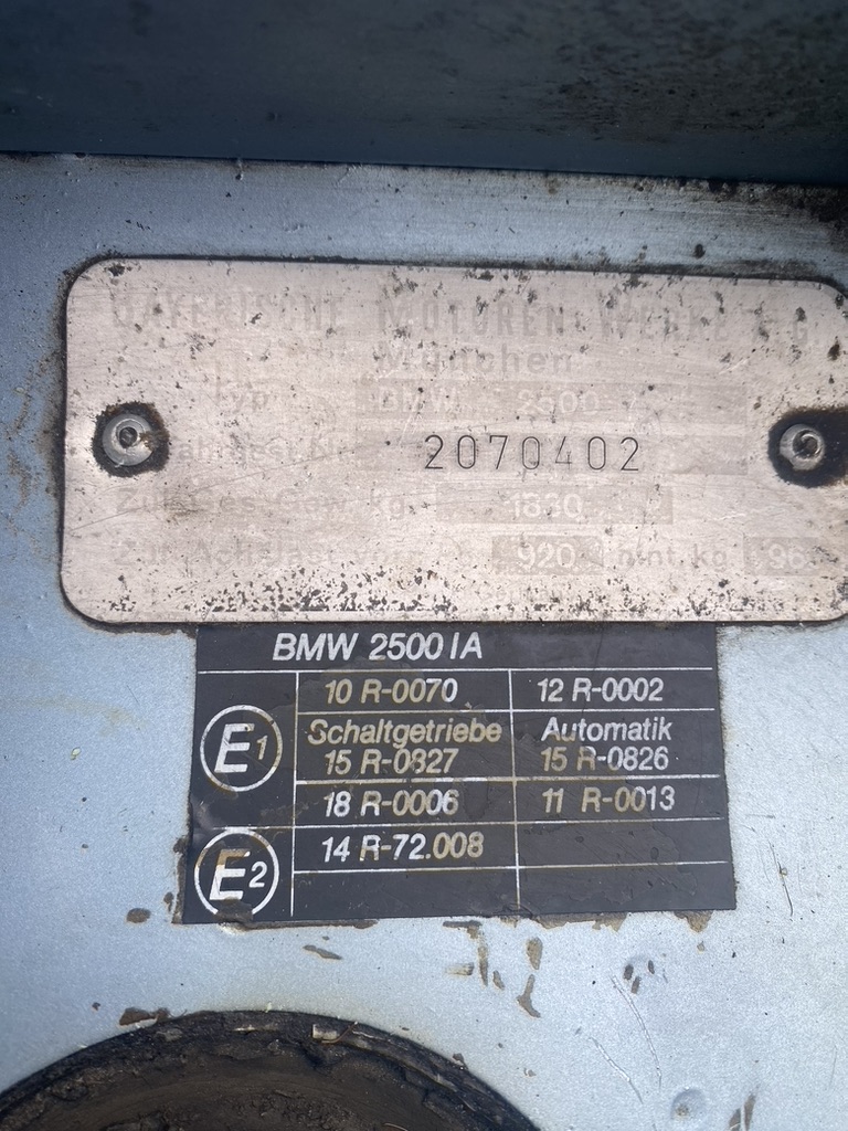

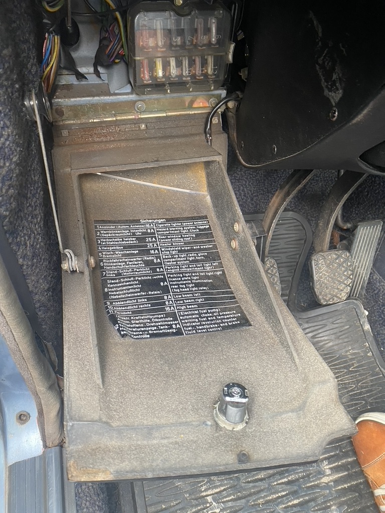

Thank you all for your valued opinions. The vehicle is a 1976 BMW 2500? No Sunroof, A/C or power steering? Listed on the Website Auto Scout 24 for 11,000 Euros. 117,00KM. Shown in the attached photo's are Vin#, Spare tire well and left glovebox. My question to Christoph is about the glove box picture, There appears to be a corrosion stain in the box itself. Is this from a slow leak from windshield water leak or the firewall that was mentioned in previous message. The spare tire well might clean up!

Thank you for the VIN. We did not have the car in our Club's registry, as expected, I must admit. All the VIN says is: 2500, manual, LHD, ECE, Series 3. I did a quick research on the half visible reg. no., it seems an original Dutch car, first registered 22nd April 1976. It has passed the annual technical check and is currently road legal. Power steering may well be, sunroof could be or not, a/c would be an immense surprise.
Your question: Diagnoses from far away tend to be inaccurate. Anyway, rust means there was water. I'd say it came past the windscreen sealing. The rubber may shrink over time and make way just a little around the bottom corners. Even if the top corners of the firewall were badly rotted they'd be very unusual spots for water to come inside.
The third picture I don't like too much. The circular hole in the spare wheel well served as drainage for the primer paint, the bodies were dipped completely in a basin. Four more are in all footwells. The holes were closed after priming by plates with bayonet locks. What we have here I don't know. Furthermore, like nearly all cars in the Netherlands, this 2500 had a trailer hitch retrofitted, the bar painted over black. Cannot think of any other explanation for the piece. The rear of the E3 (E9 as well) is quite soft. Pulling trailers was not something the Munich engineers gave a lot of thoughts to. In short: body structure does not like it.

Strange how the owner reported to not having power steering but there is a reservoir in this picture of such. Or I have read somewhere on the history of the E3 that in the beginning a ride leveling system available but dropped to make the car more saleable, Pricewise. I am going to the Netherlands on April 10 for a vacation, One of the things I am planning on doing is reviewing this car very closely with all the information provided. I am sorely tempted to purchasing windscreen ,trunk seals and A/C unit before I go,

The reservoir you show contains brake fluid. Two downward pipes for the brake circuits, non visible, one rearwards for the clutch cylinders (manual cars only), visible. The servo pump reservoir is located further front and near the engine.
You mention the notorious Boge Nivomat. Standard on the 2800 Series 1, it was dropped with the introduction of the Series 2 in spring 1971. The 2800 S 1 was a success, despite most people not liking the Nivomat. In the repair manual you'll find a section of how to remove it completely and replace by something sensible. Another attempt was made in 1973/74, different system, optional. I've never seen one. One of our members told me he has a 1974 car that shows clear traces of a once present levelling system, but all the gear is gone.

Cristoph, I am speaking of the reservoir forward and left of the brake fluid reservoir. Round with 6mm nut holding it down.
