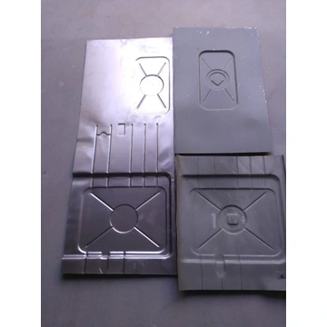

Hi,
Here is the comparison of the floor panels between W&N (two pieces) and Tlocznia Blach from Poland.
Difference in detals is significant
bavbob
3,383
1,594
Boston, Ma
I think we concluded that wrt coverage, stamping accuracy etc, that Pelly is better for the front becausse it covers more area and has bends that go up the threshold and firewall ( http://www.alfaparts.net/bmwcs.htm ) while W&N was more accurate and a better fit for the back. I used W&N all around and was happy with the rear, had a lot of manipulation to fit the front.
