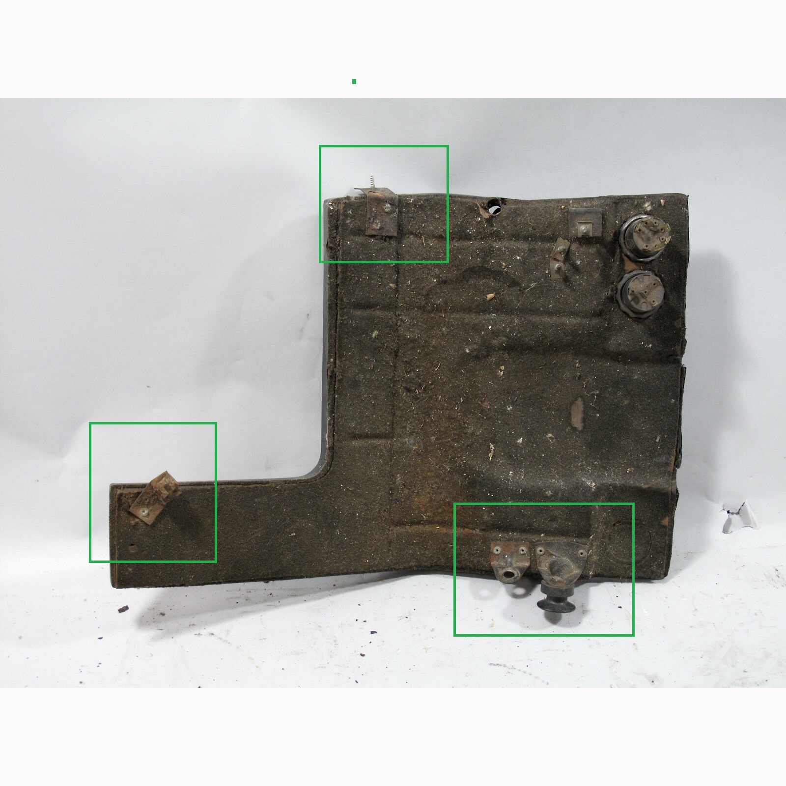

My recollection (mine is a '72) is that there:
  • is a screw at the very back that fastens to the firewall that needs to be loosened
  • The drivers side glove box support wire attachment point is a fix mount point for the part
  • there is a tab with a screw into the side console that needs to be removed (not the side of the console)
those should allow you to remove the panel, but you may find that you need to loosen the under-side of the steering column as well as under-side is captured by the steering column cover.
this picture (note mine) shows the mounting points

The repair is all done. Apparently I "hired" the right team of my son-in-law ('88 M5 owner) and his Dad. The key they thought was using a suction cup we had to remove bulbs from track lightening we have in the garage which held it in place while the nuts were secured. It didn't take any time at all, did not need to remove the seat, dash or anything else. A few sandwiches later, I was able to appreciate their efforts. Yes holding your mouth right is also a key factor. Thanks to all of you who came to the table with suggestions, it is greatly appreciated. Onward, time to drive and enjoy the beautiful music.
