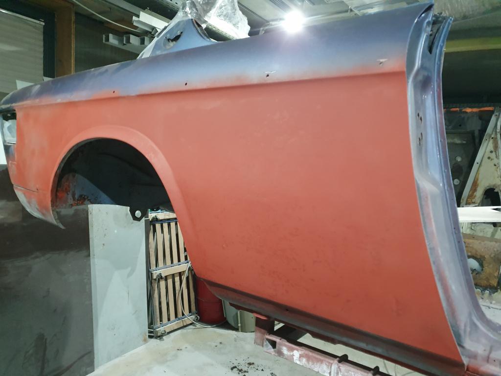

Get a nice puzzle back today....

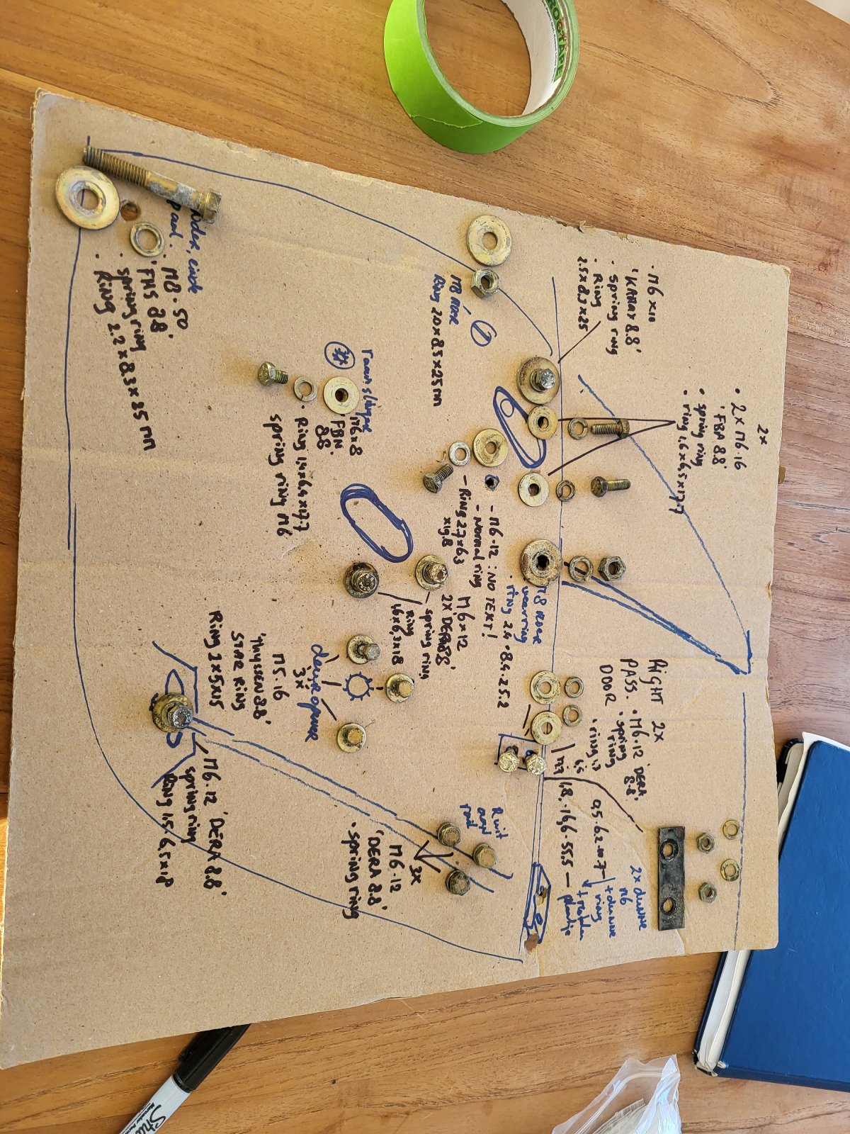

That always looks so nice, all fresh stuff to work with.

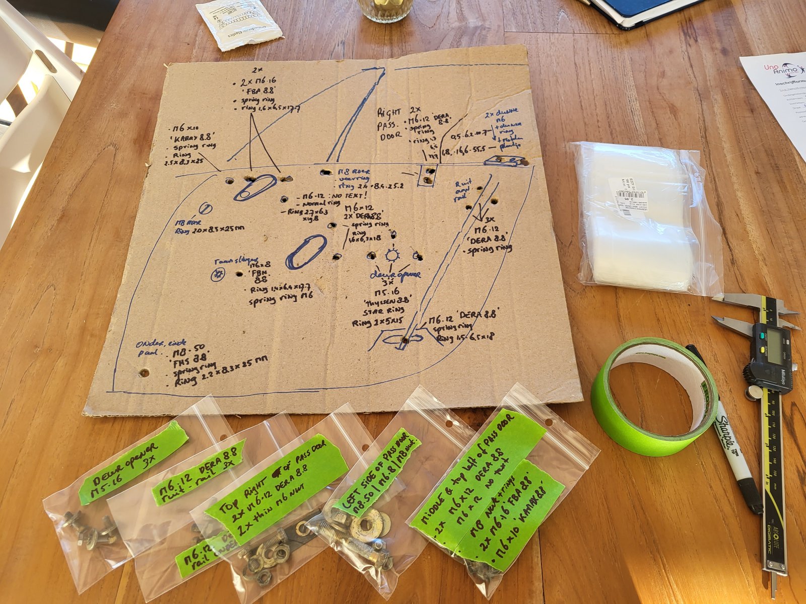

There are multiple systems that work well. I used this last week when gutting the door:
Drew the general shape on a cardboard plate, unscrewed something, measured the fastener and copied the headtext, and placed it in the cardboard at the right location.

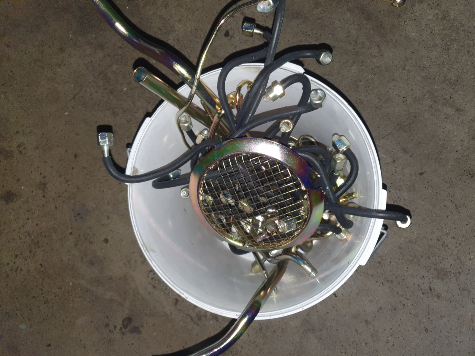

Then bag it all. Now when I send it off to the zinc company, all will go in one bucket with the rest of the car.
Then sorting is easy. Not only can I find the right size of bolt, but I will have the exact bolt going back in the exact location where it came from.
Is it not fast though...

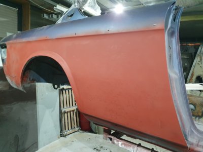

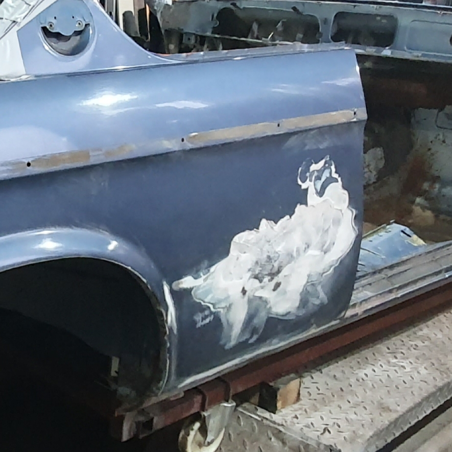

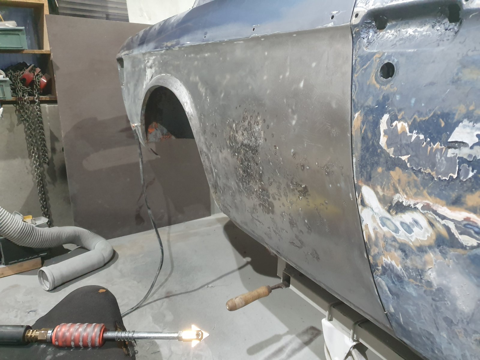

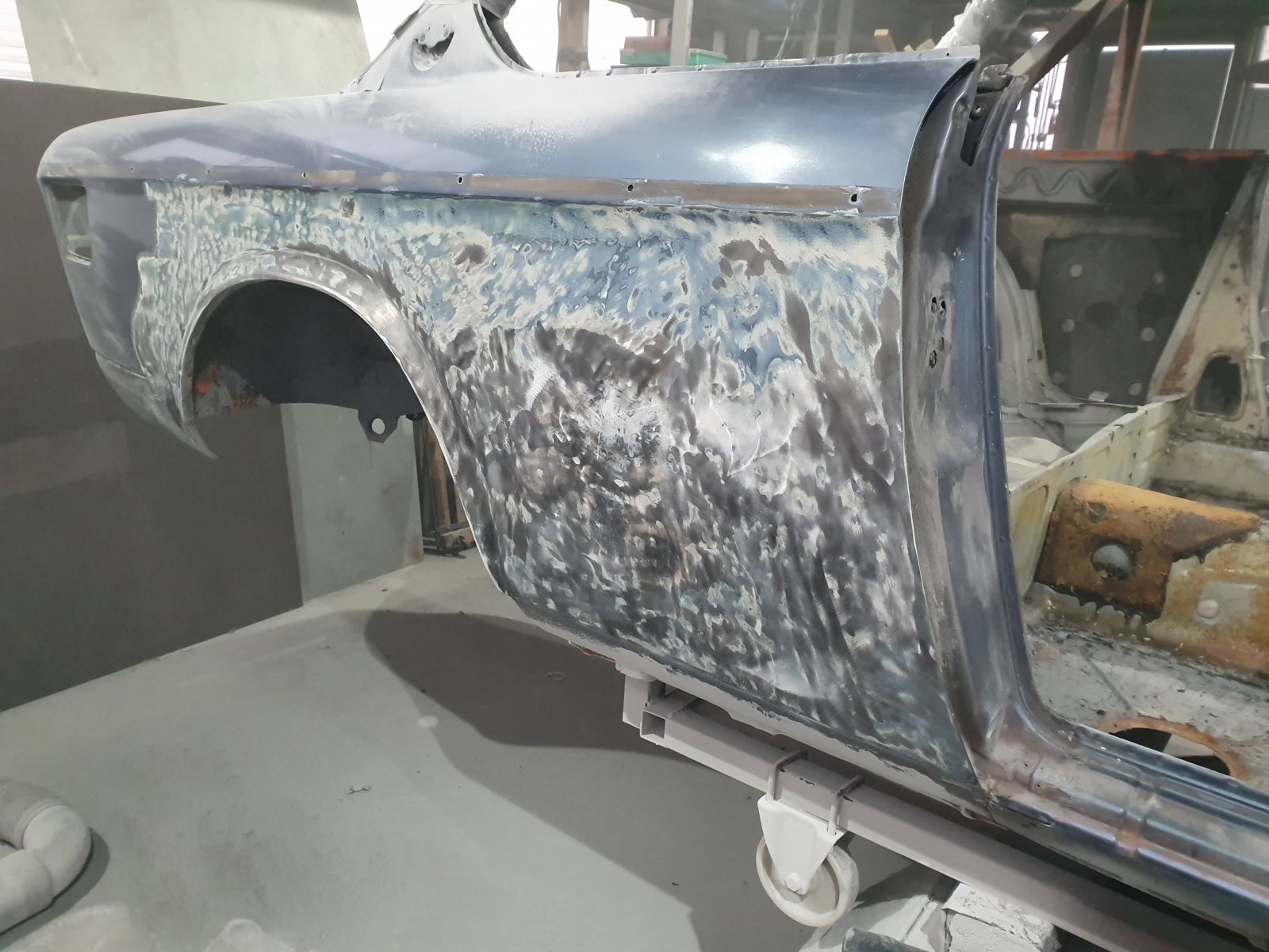

Try to clean a very bad over 40 year old putty and hammer repair on the rear quarter....
Not finished jet.

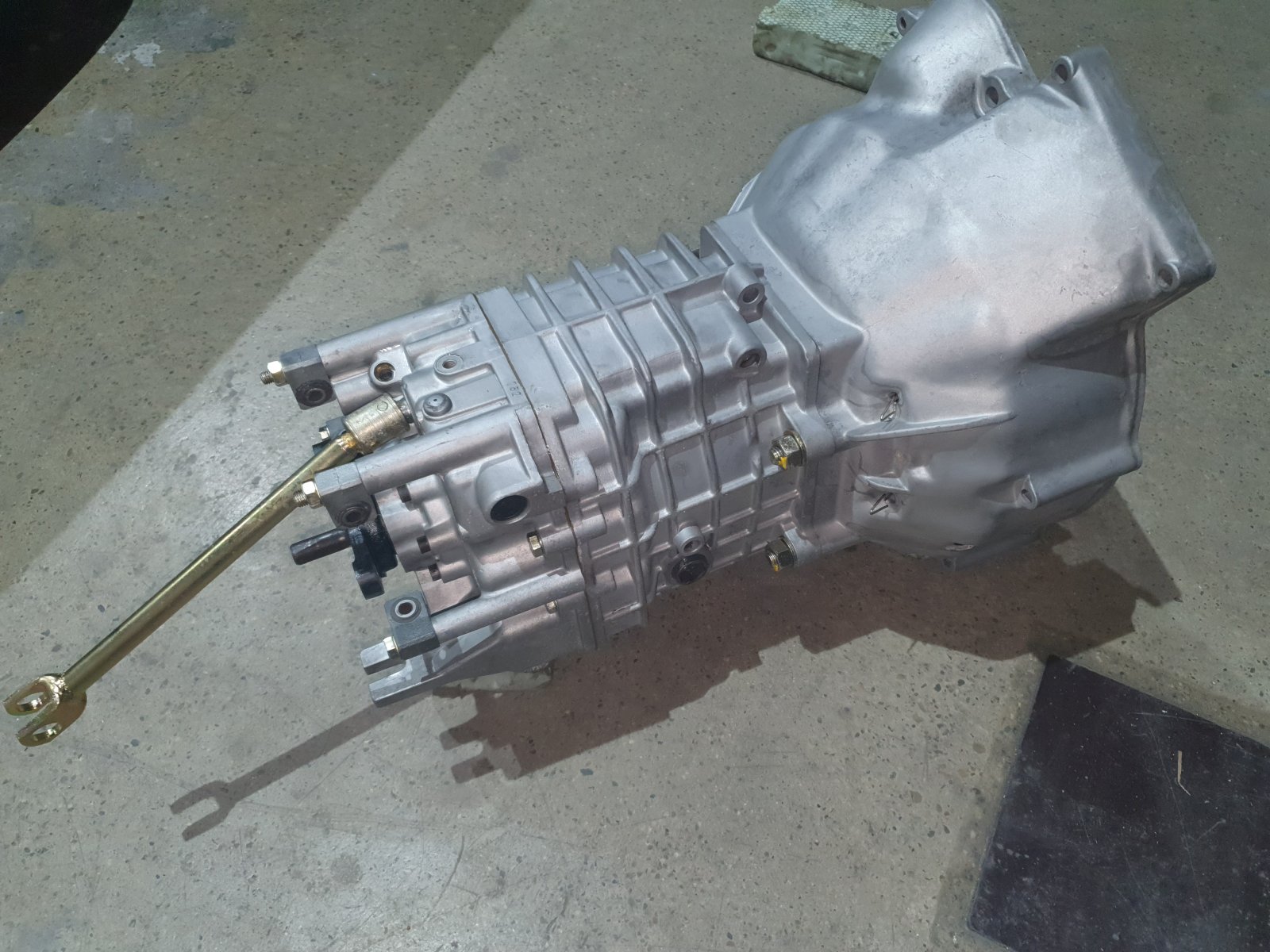

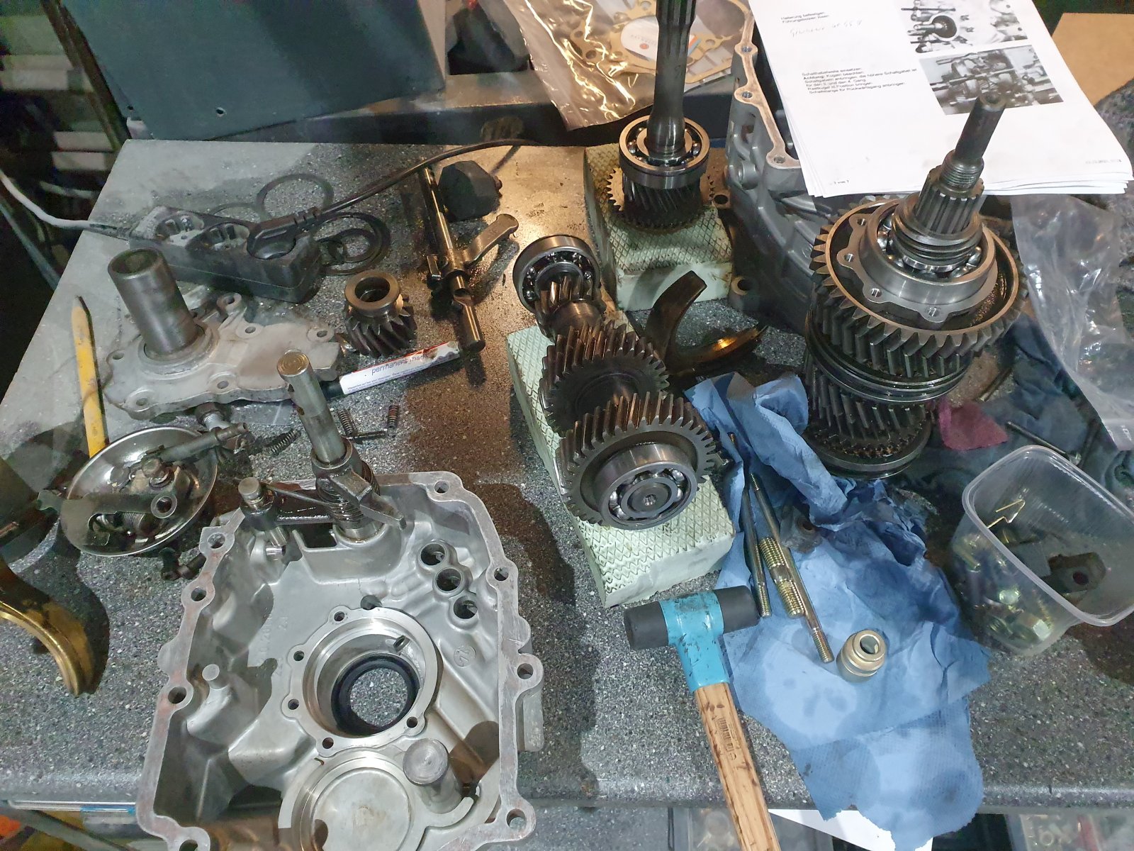

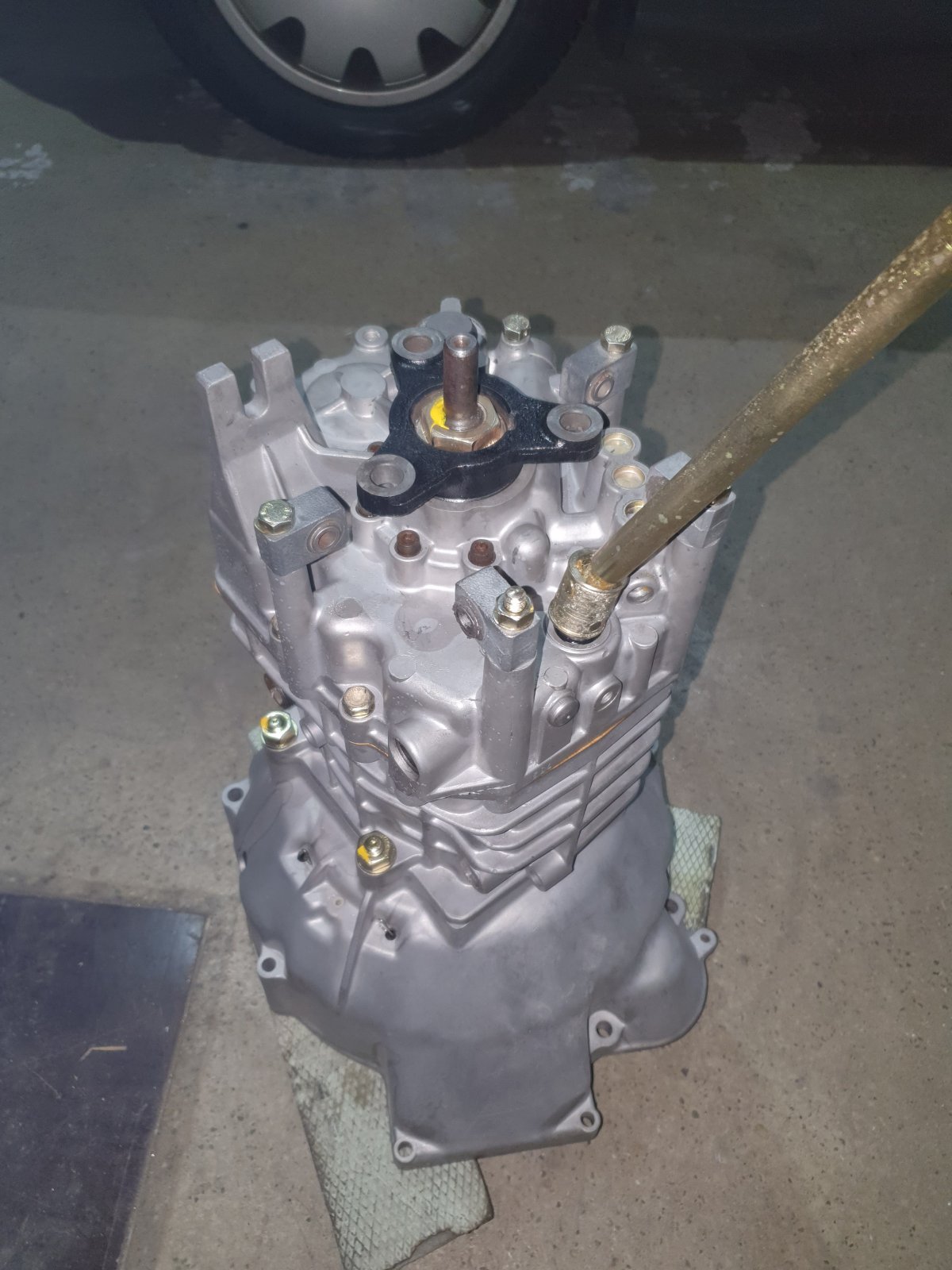

Die to waiting for thre sand blast shop I finish in there meanwhile the gear box.
New seals and bearings.

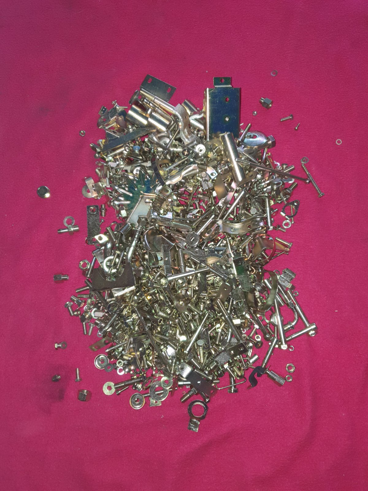

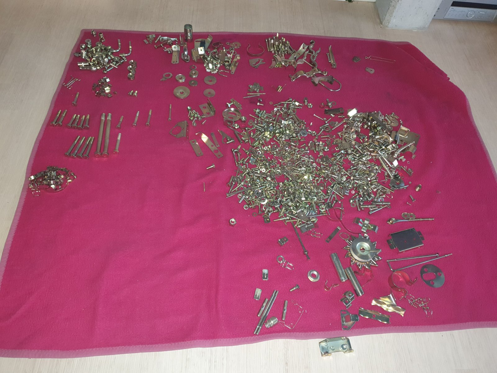

I could imagine that such of pictures would be a great part of E9 bible. I'm pretty sure with the help of the Others we would be having complete sets of parts much better thant any of available service manuals.
I know that @deQuincey and @Markos have such pictures for sure.
Would it be worth to be a part of DYI where Erik and Jesus are really leaders in? I'm for such idea as many people are asking about some pieces after long time or restoration or just because their E9 was already repaired in the past with incorrect parts or order used.

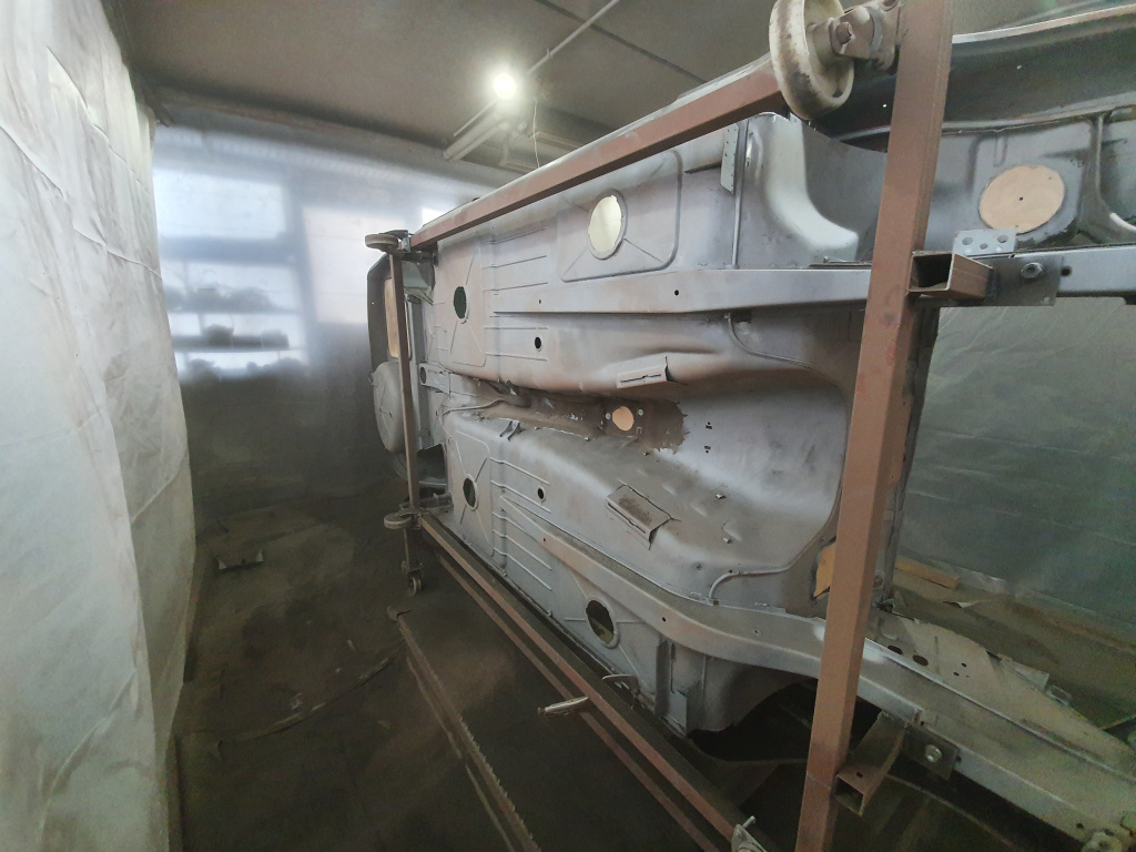

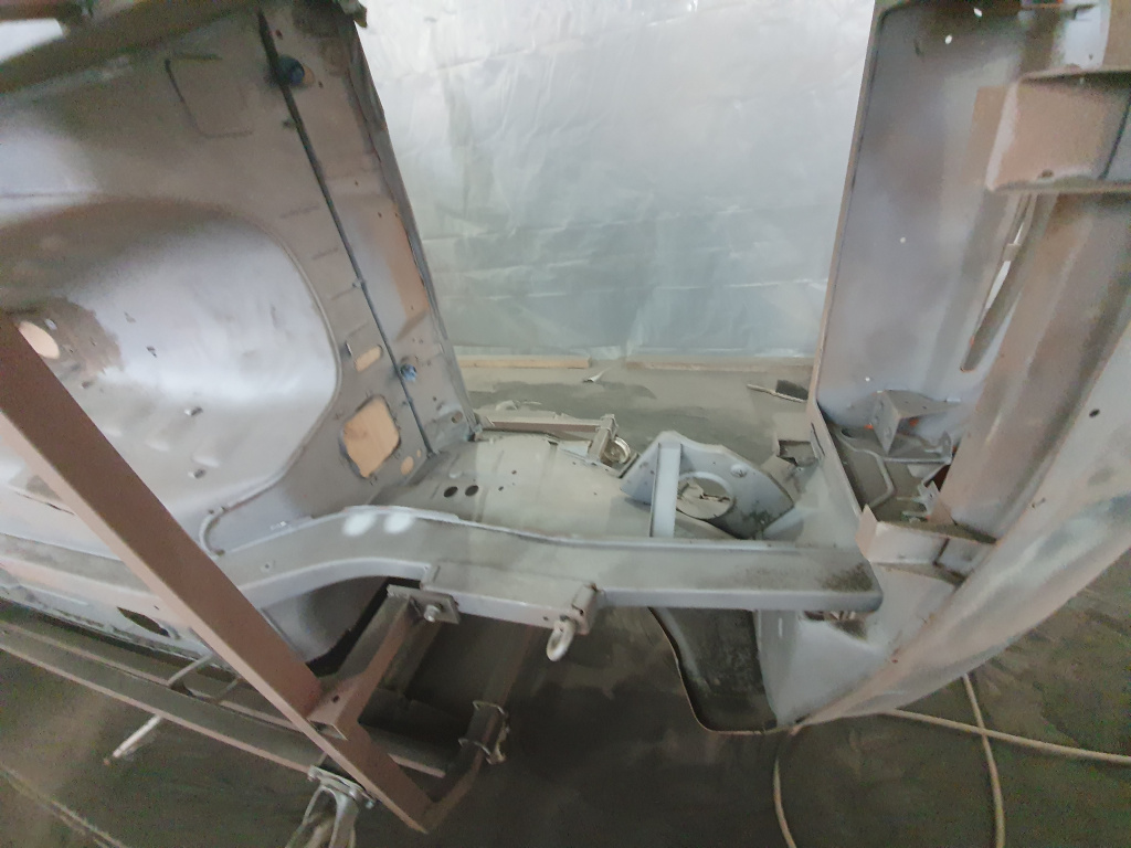

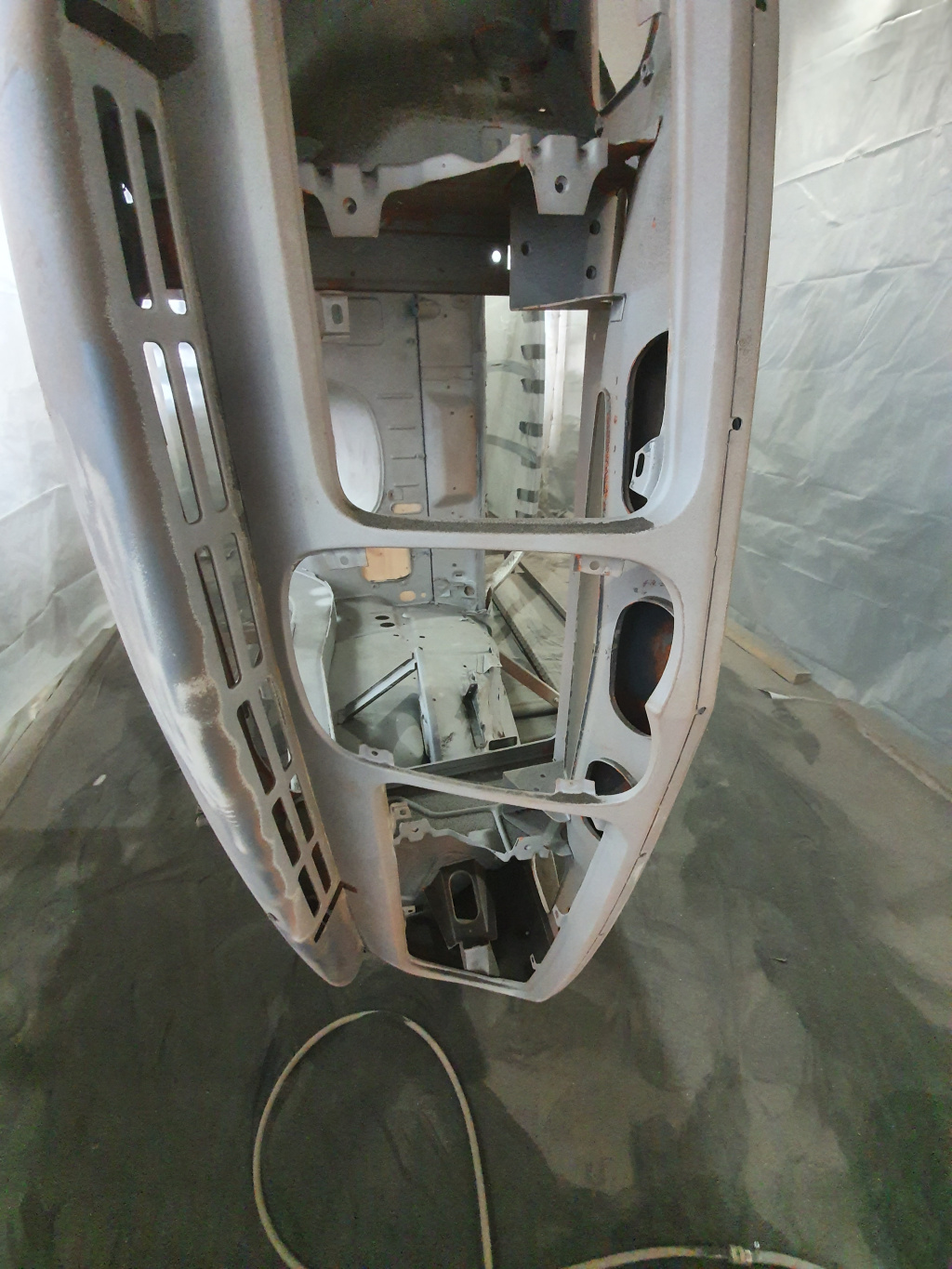

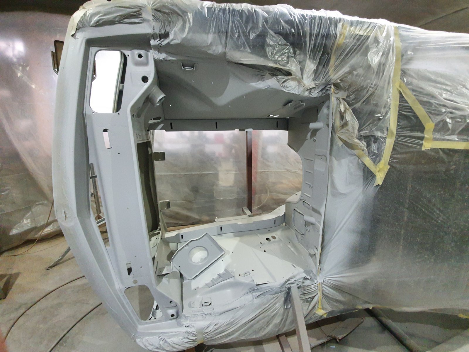

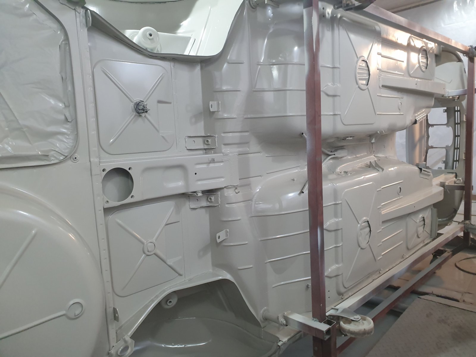

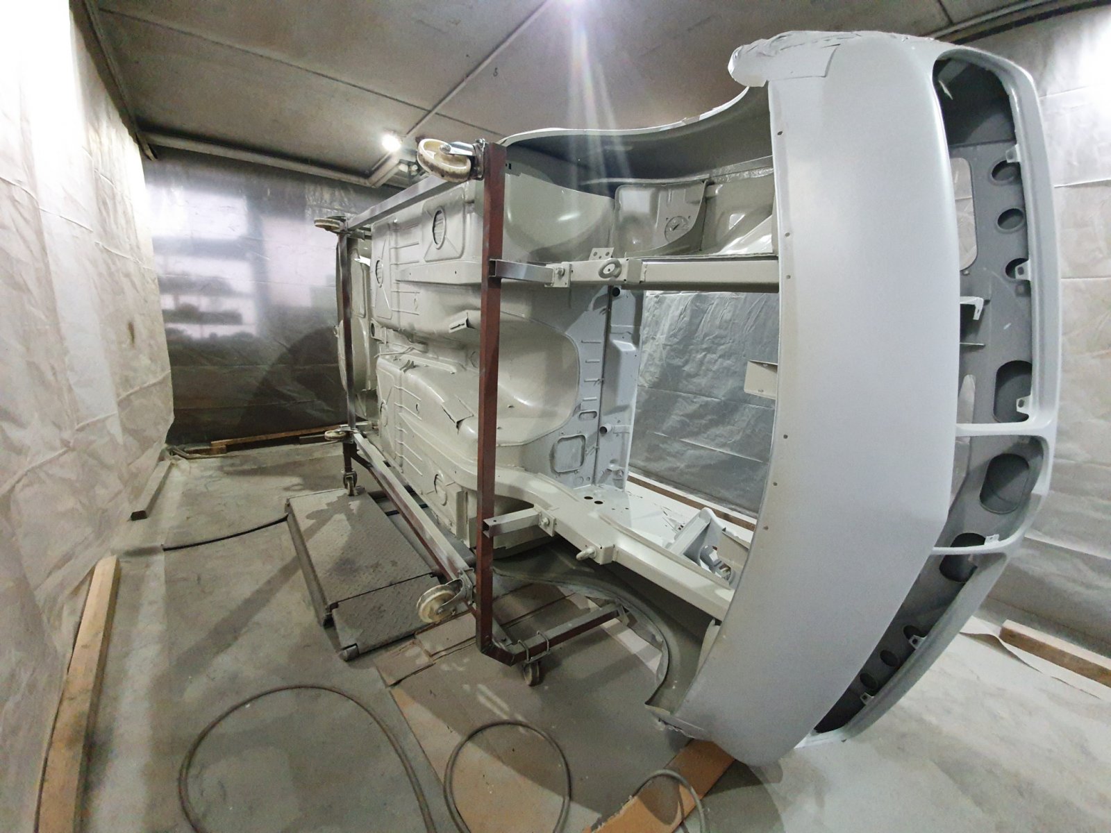

Finished the sand blasting today.
That was a ugly job....
Much more worked then last time I did it with the Mercedes.
BMW blast that stone ship protection almost everywhere. What kind of stones should that hold at the inside of the lower front valance ?
However, job is done.
Took me 700lbs of blast sand, multiple times used by sifting.
Next step, floor primer and paint.

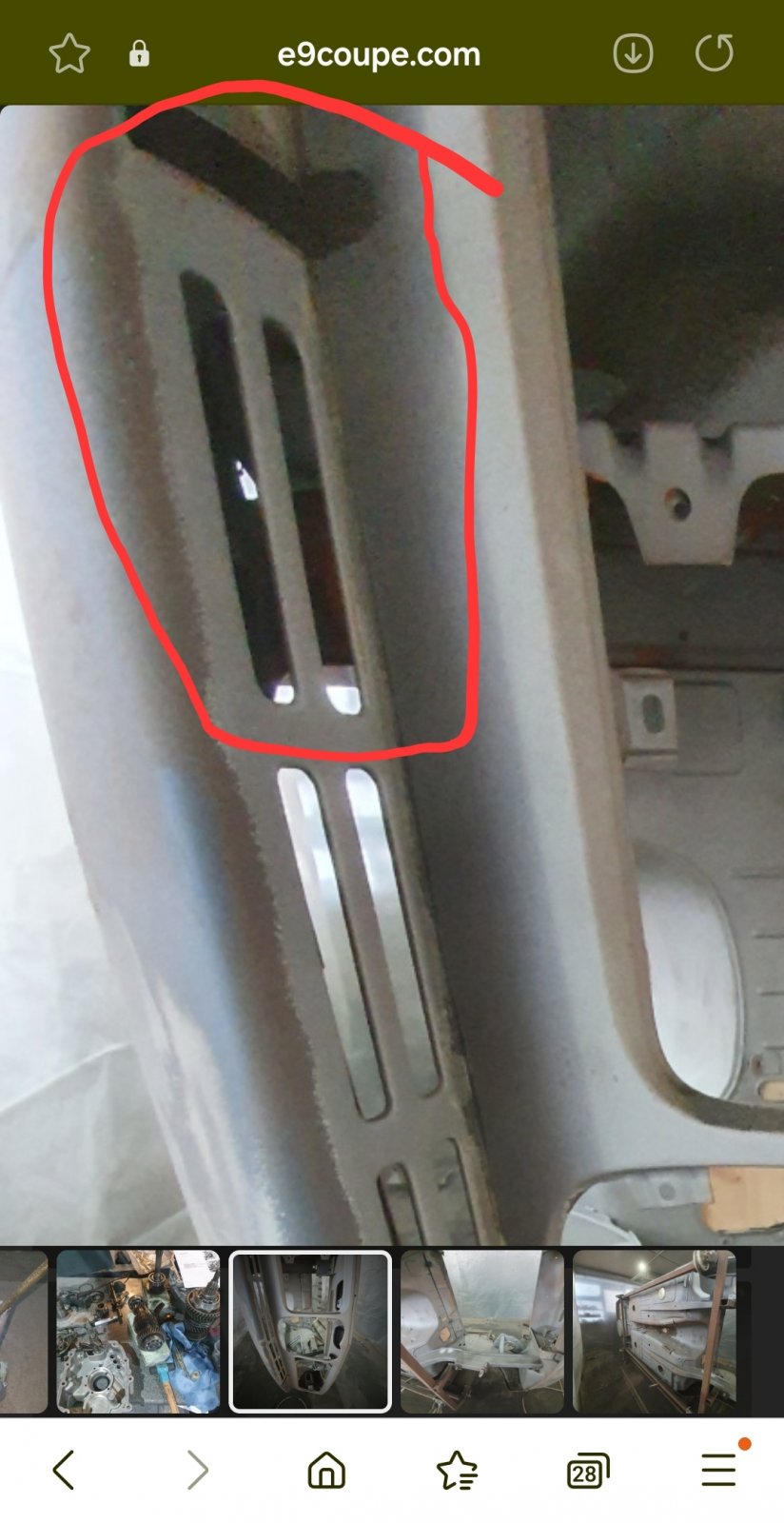

You may know already that your front chin part is a bit special; the part was redesigned around 73 to accept the larger US bumpers by shortening the 2 air vent slits close to the openings for the bumper brackets.
If a car is ever in an frontal accident, this chin parts is the first part to get banged up. And replacements parts post '73 were made in the US style. Your car thus likely still has the chin part it left the factory with.
It thus is likely you car also never had frontal collision.

Thx for analyzing @eriknetherlands The car hasn't definitely ever a front crash.
All welding spots and factory primer in that area are absolute original.
Only the left rear quarter had a deep dent which has a bad repair in the 80th.
But as you see in the pics before I fix that w/o welding.
Only replace I do was both lower fender at a-pillar.

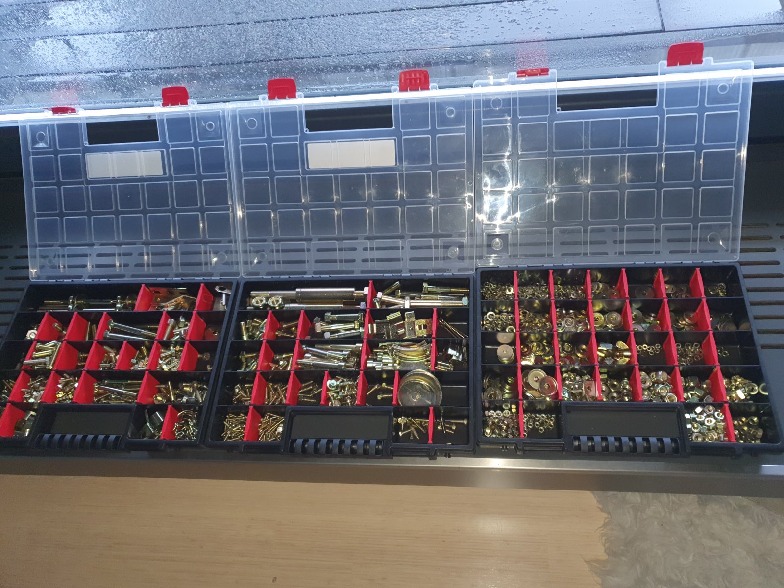

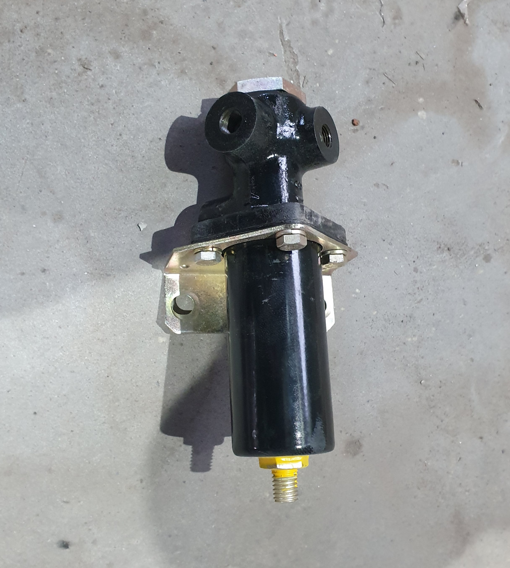

In thre meanwhile I mount my rear pressure regulator back together to see a shiny part. (A kind of self motivation)
