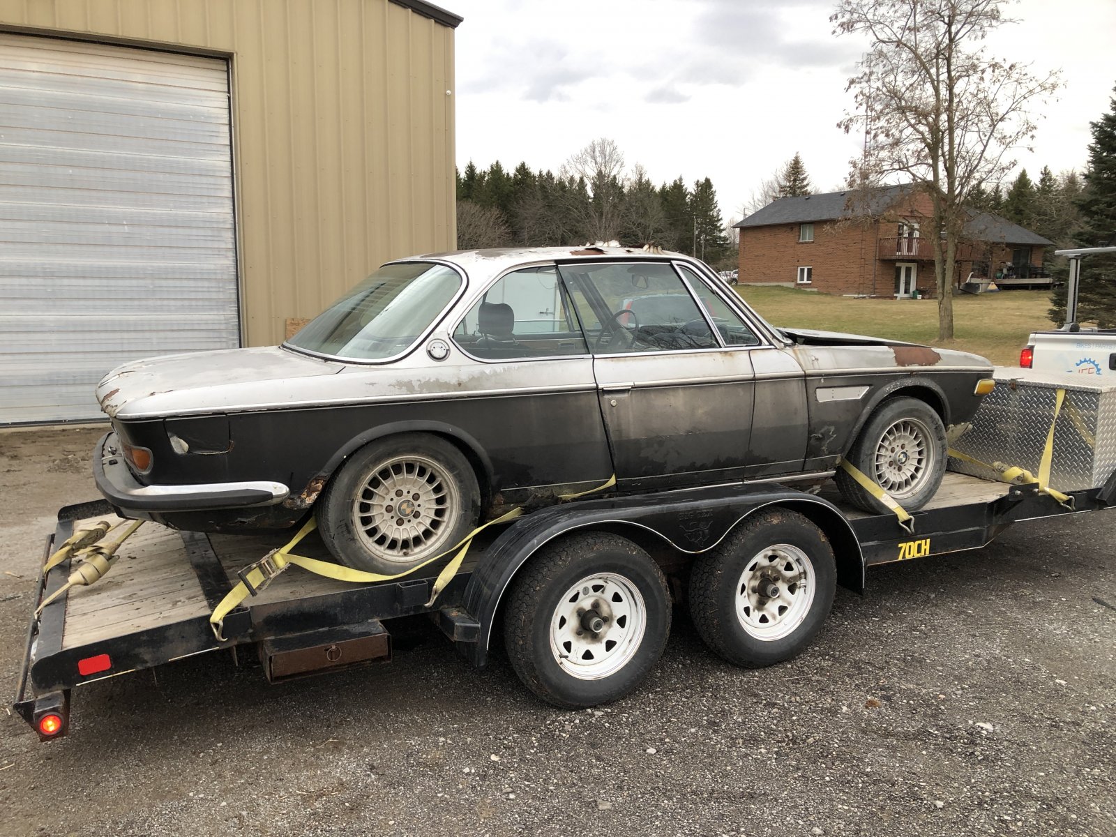

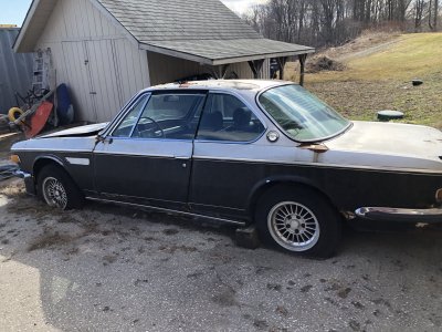

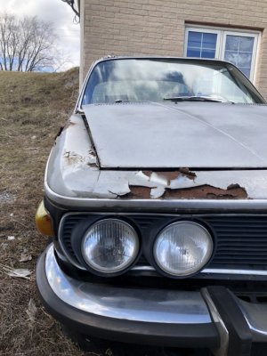

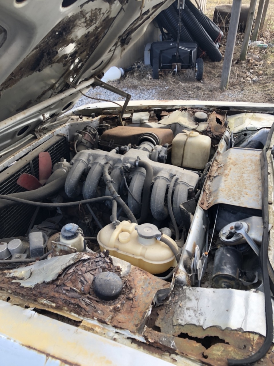

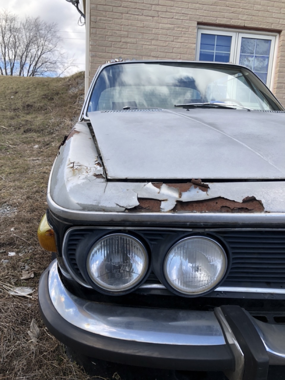

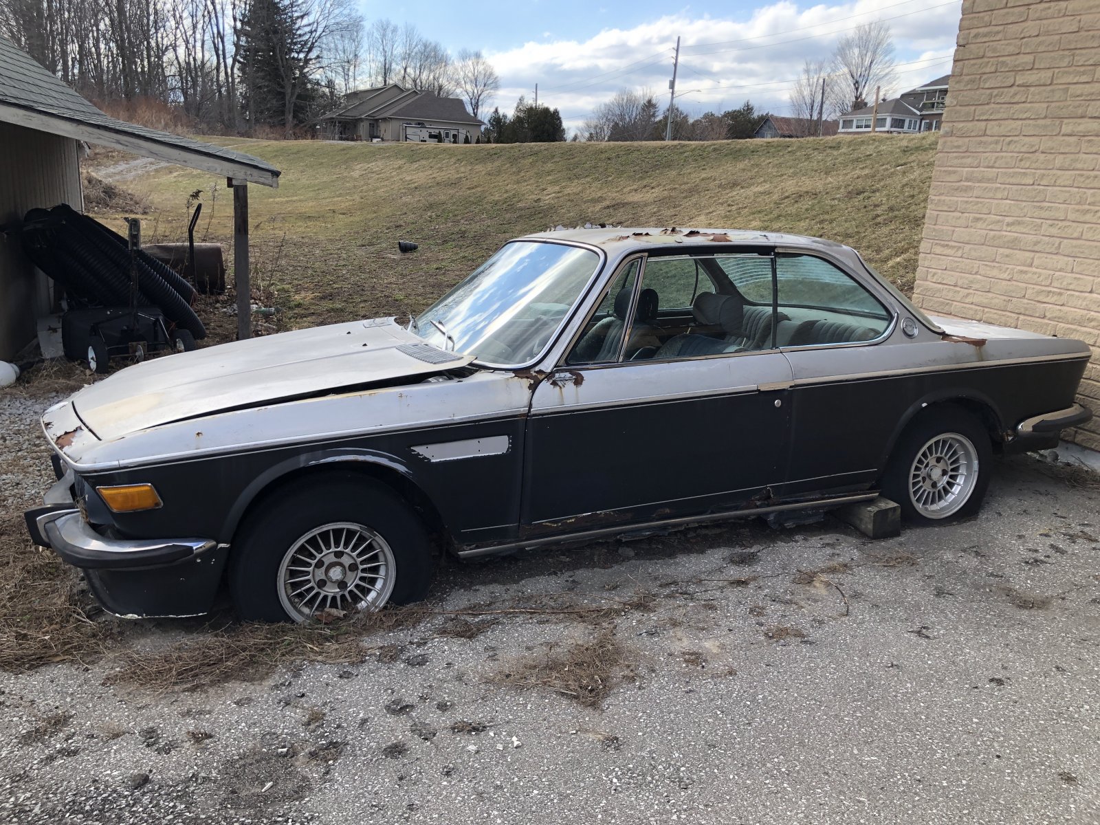

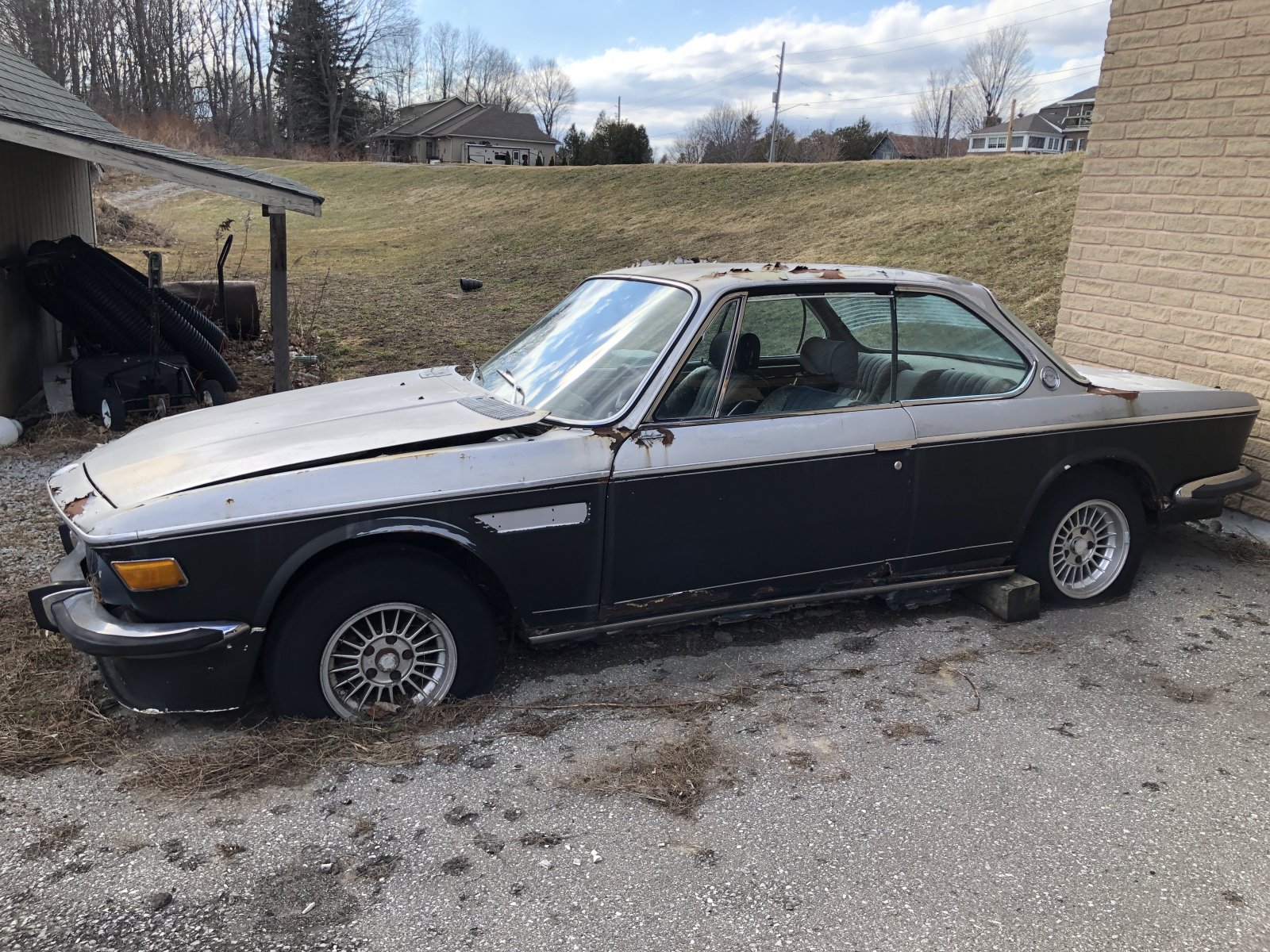

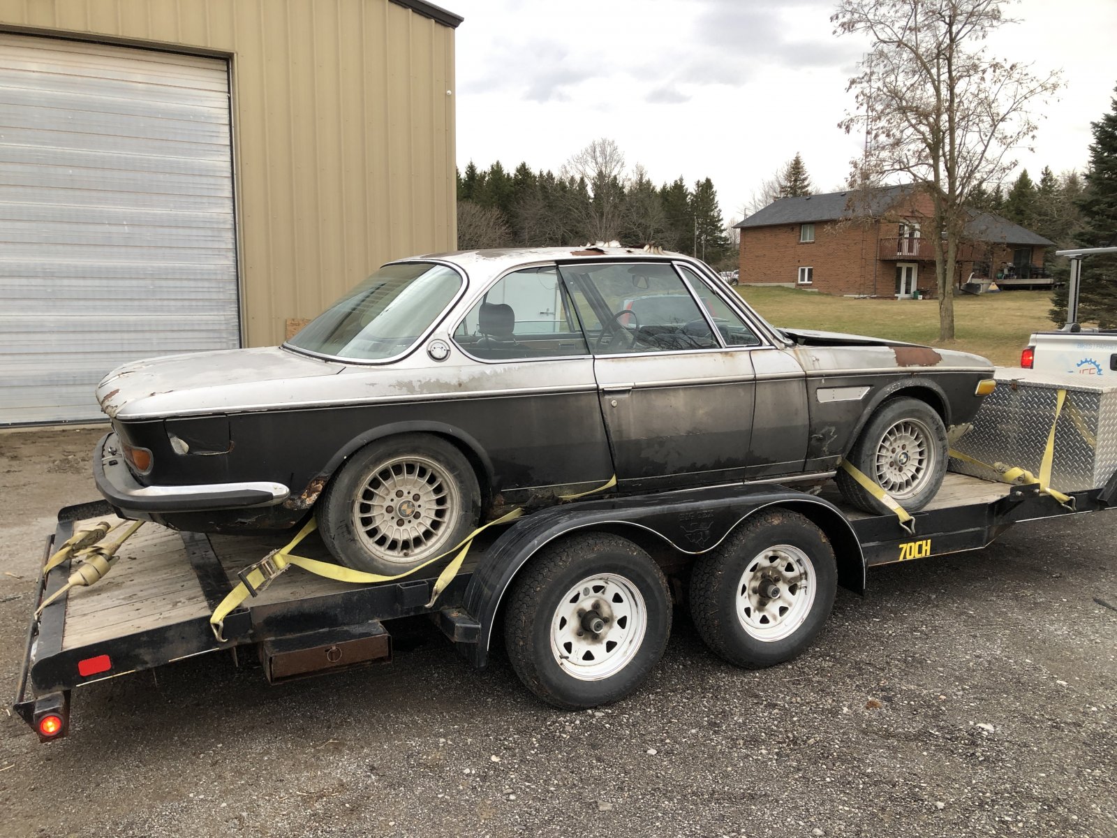

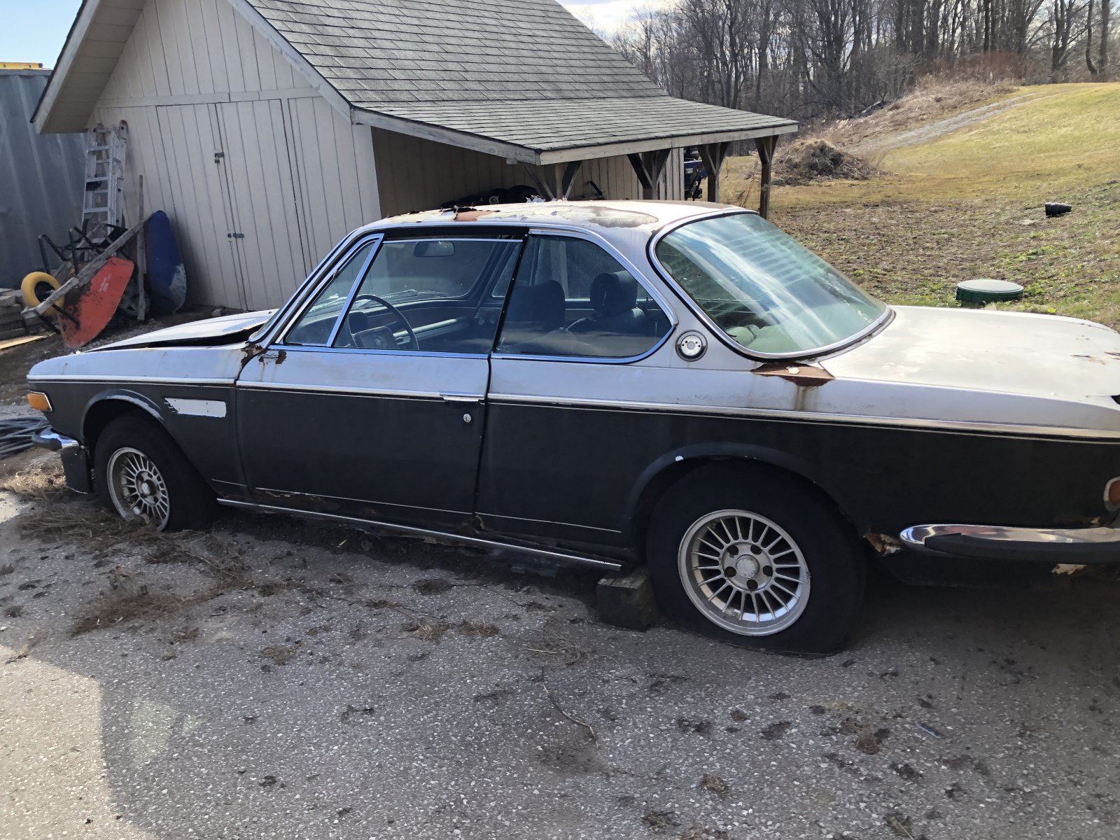

I've been sitting on my basket case 1972 3.0 CSi for a few months now trying to decide what to do with it. The car is so bad that the only 2 realistic options are sell as whole or part it out but I see there to be another possible option that may as ambitious as restoring it but with way better results and that is to RestoRod it.
I've made a few internet searches and have come up with a few hits a resorodded E9.
My idea is to transplant the skin onto another much newer BMW and use the drivetrain, suspension, and possibly the interior of the donor car.
The question I have is this, does anybody know of anybody having completed this kind project with the E9 and before I head out and acquire a BMW donor car which would be the best model to use?

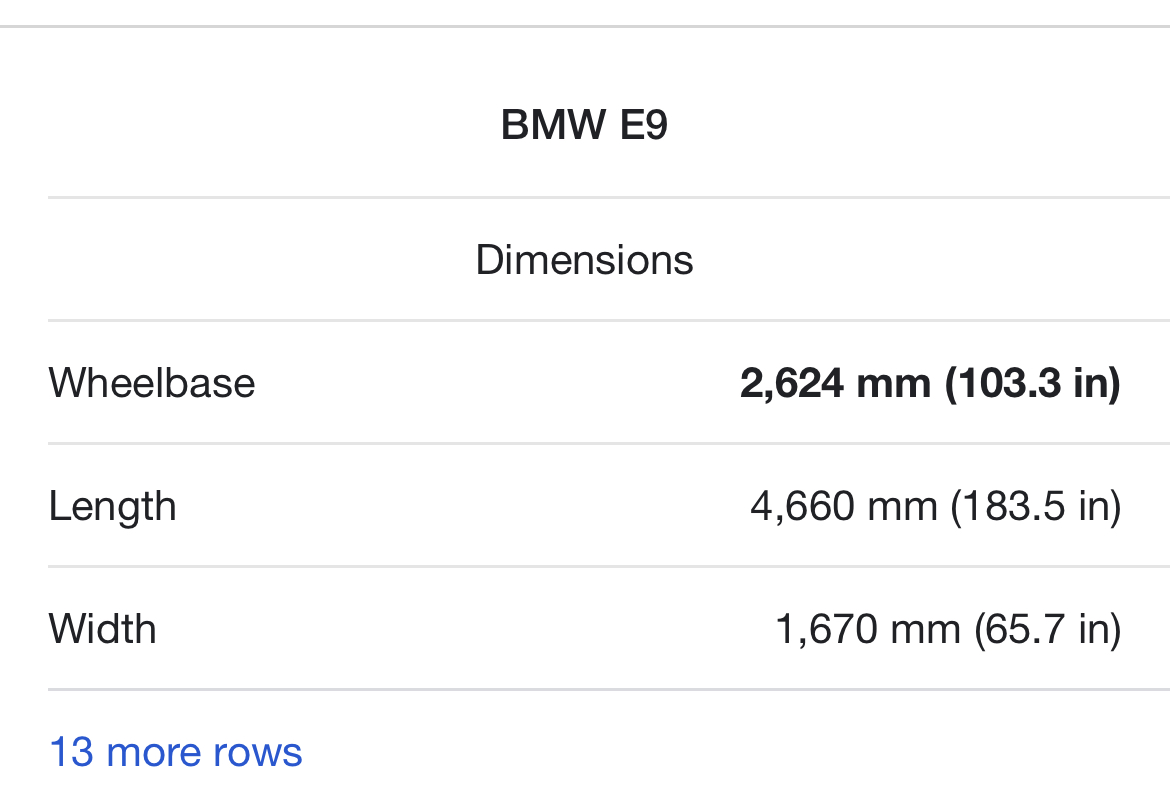

Off the top of my head I'm thinking an E36 or E46, by eyeballing the cars look to be of similar size.
IMG_9867.JPGIMG_9805.JPGIMG_9831 Large.jpegIMG_9938 Large.jpegIMG_9813 Large.jpegIMG_0209.JPGThe one E9 Restorod I came across used an E39 chassis which is a 4 door and much larger.

Hmmm, just off the top of my head, this looks like a left turn into the deep end. Just my opinion. E9 projects are difficult enough, but trying to pioneer a re-fit of some newer BMW chassis underneath a sadly rusted E9 body, umm, well, I have to think this will consume many hours, dollars, and trial and error fabrications to make this work. Even at the current price of respectable "for sale" E9s, they must be a quicker and less expensive entry to enjoying the E9 experience. But best of luck whatever route you choose, and keep us informed.

Unless you have a lot of experience with body swaps and heavy restoration work or very, very deep pockets, this would be dangerous at best. Mechanicals are the easy part, I would look at getting the best possible shell you can and go from there

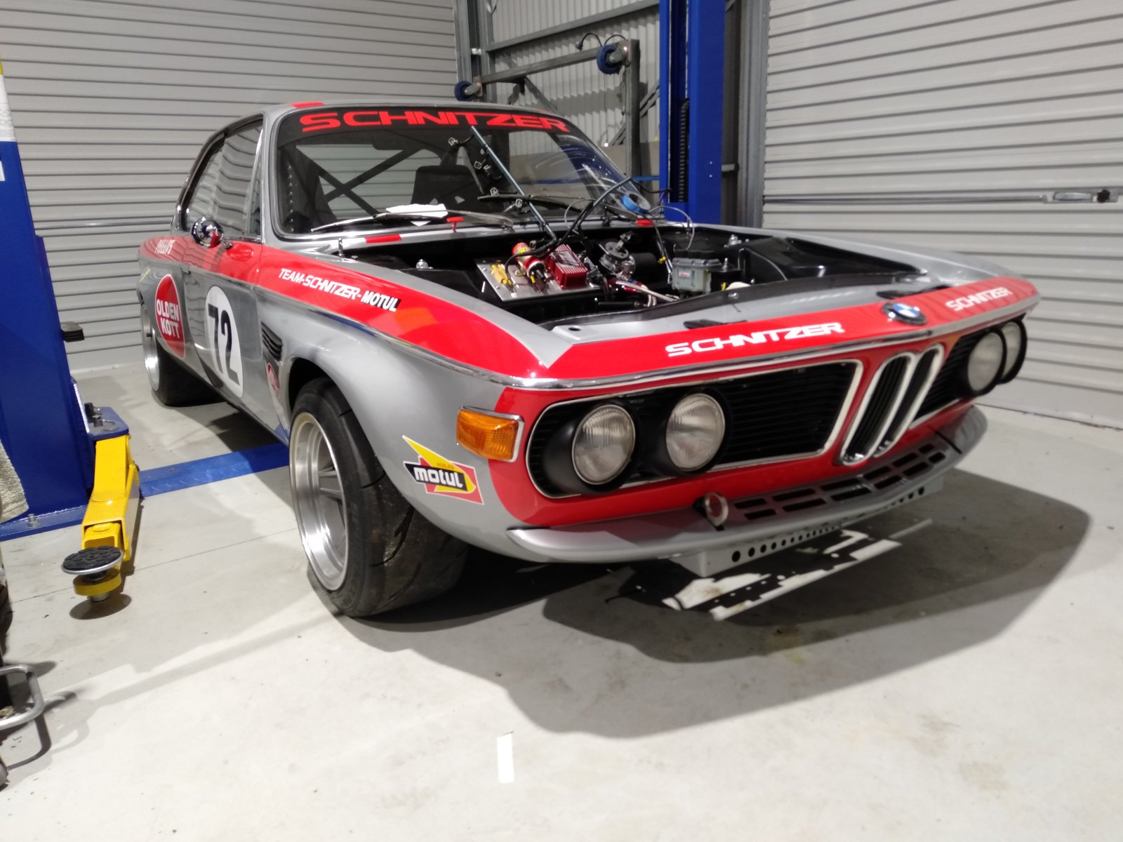

Klassic, love that race car!
(Wish my shop was that clean, Imagine the perfection to his e9!)

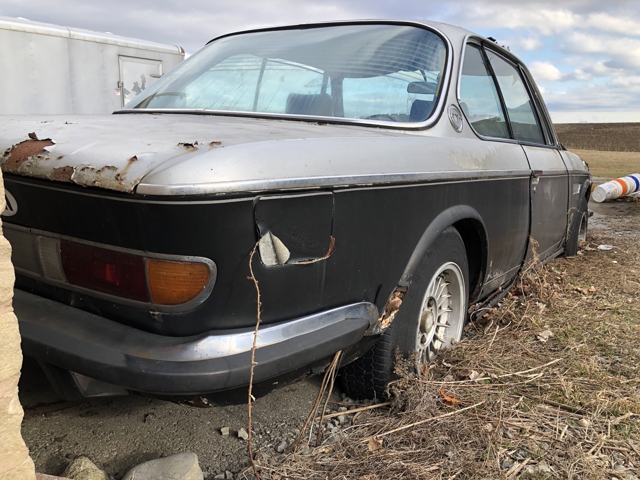

The car is beyond restoration, sorry that's not true you can restore anything if you want to throw an unlimited amount of time, energy, and money at it. This car is beyond restoring back to anything half decent, these cars have value but there are limits. It's also a shame to part it out. I just might venture out and do a Frankenstein Car, take the beauty of the E9 from the rocker panels up and transplant onto another newer BMW maintaining the shape but have a current chassis, drivetrain, suspension, and possibly interior. Late model E36s, E46s or E90 can be had for song these day. There will be a lot of metal work and fabrication involved which would be in restoring as well.

- "Similar" wouldn't be good enough; the donor car would need to have a wheelbase and track width that was within a couple mm of the e9's

You are assuming correctly, I am very early in the decision making process. First order of business is measuring the hell out of the E9 then finding a donor car with similar dimensions then if I find one and I decide to go ahead with it I will still have to convince my wife. lol Just a few hurdles ahead

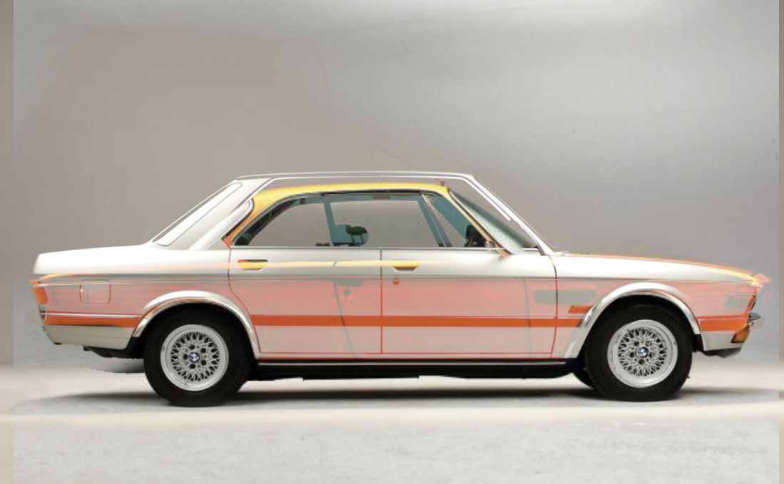

I would probably go with an e28 or e28 based e24 as a start. Probably the closest dimensionally. Unless you wanted something a lot more modern.

I think that the first order of business should actually be to check the VIN on the firewall and post it up here.
The wheels appear to be five hole CSL Alpina, worth around $2,500 in their current state. $3,500 to $4,000 restored. Looks like you have all four but pulled two to get it rolling. Post a closeup of the lug face.
Also the headliner appears to be black (a CSL specific feature). Make sure it isn’t a CSL before you start cutting it up. Not seeing much if any rust on the door skins, which were aluminum on the CSL.
FWIW - I’m just playing out my CSL barn find fantasy, but seriously check. :)
I think @Wes and @tferrer might agree on the wheels at least.

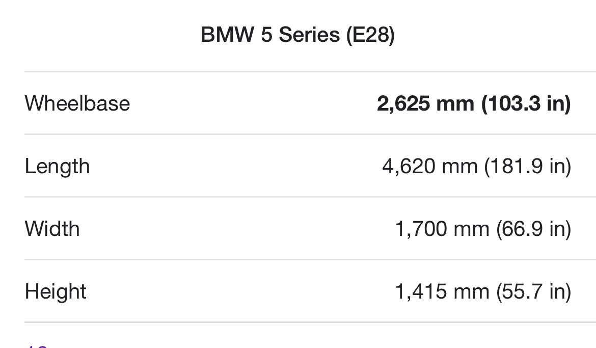

If you were to execute a “body swap” I think an e28 would be far “easier”. They both have the same wheel base. The suspension is very similar (e28 rear nearly identical to e3). They both share the M30 and Getrag 26X drivetrain.
