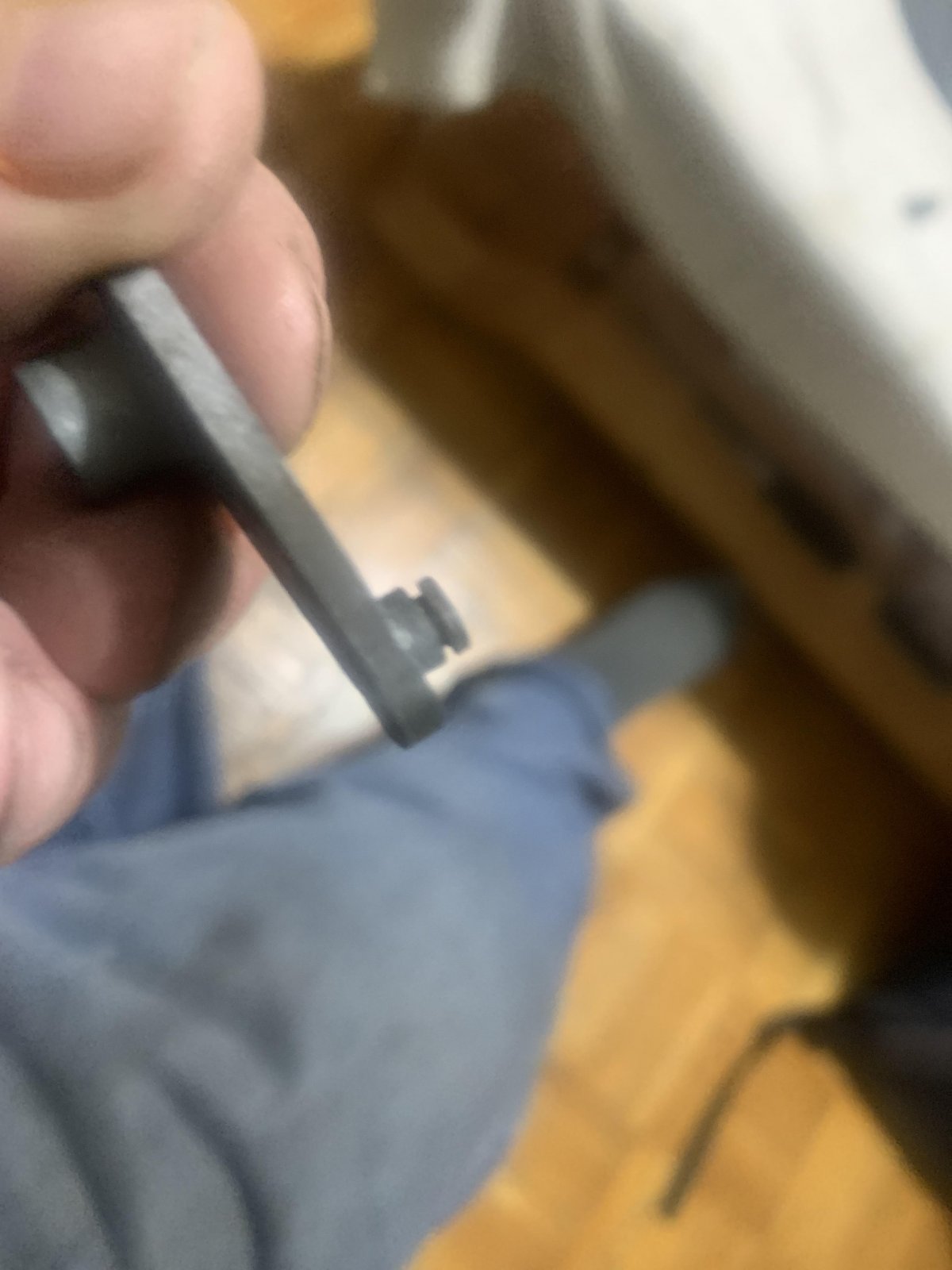

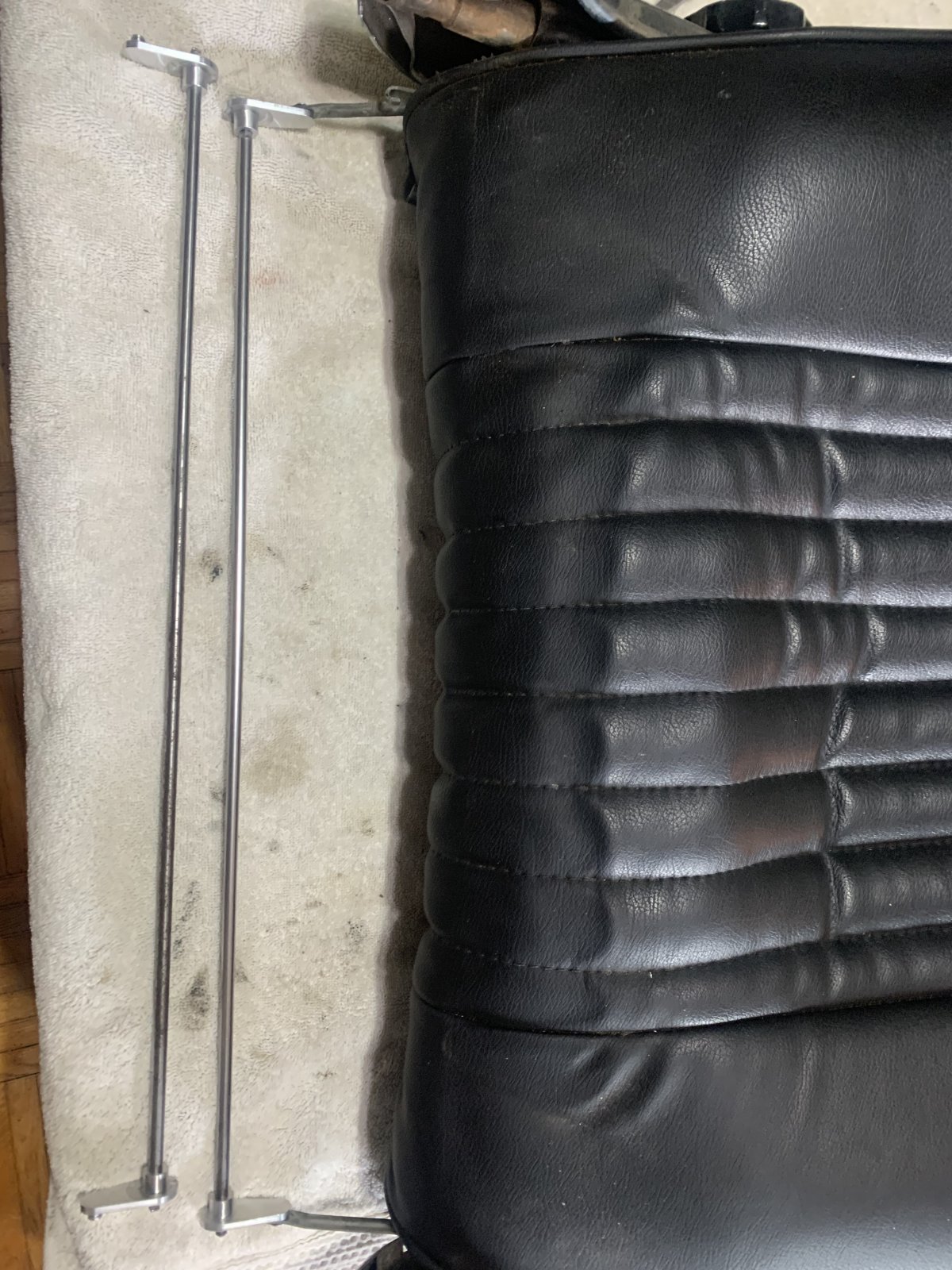

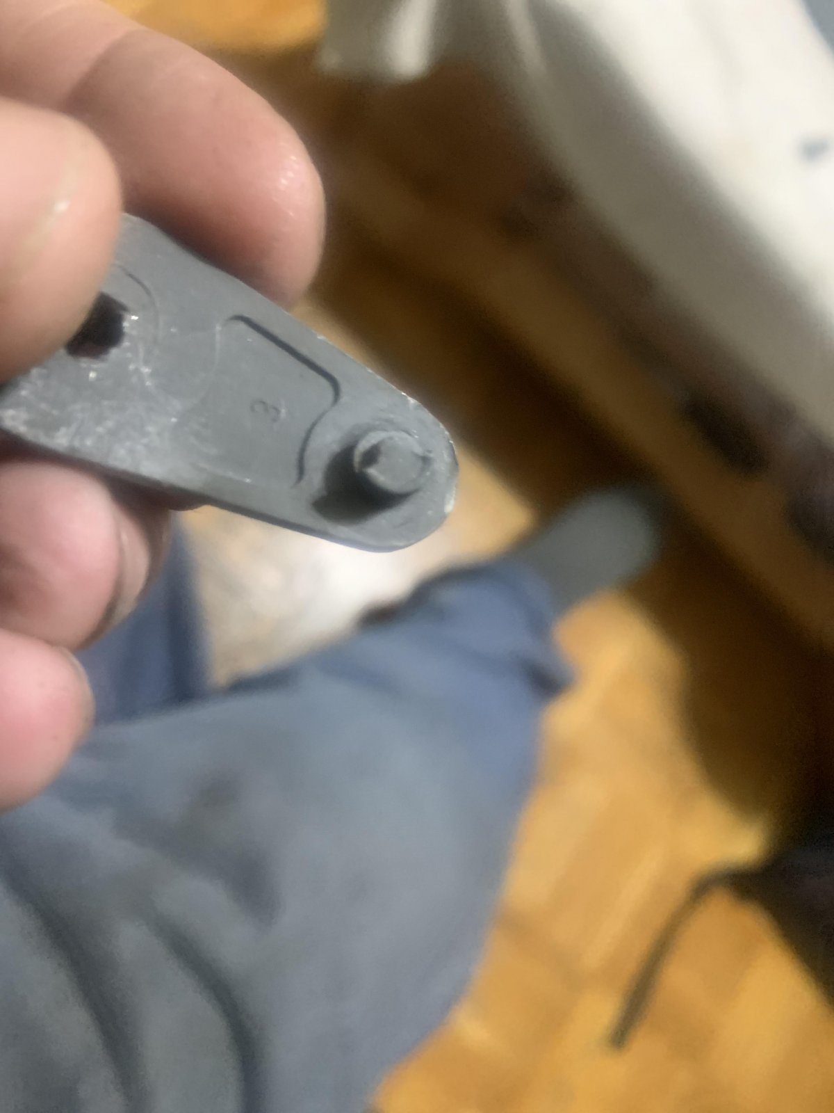

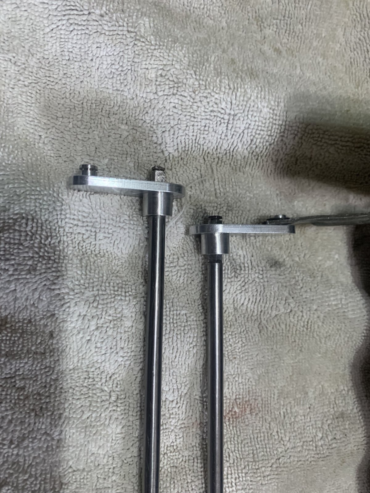

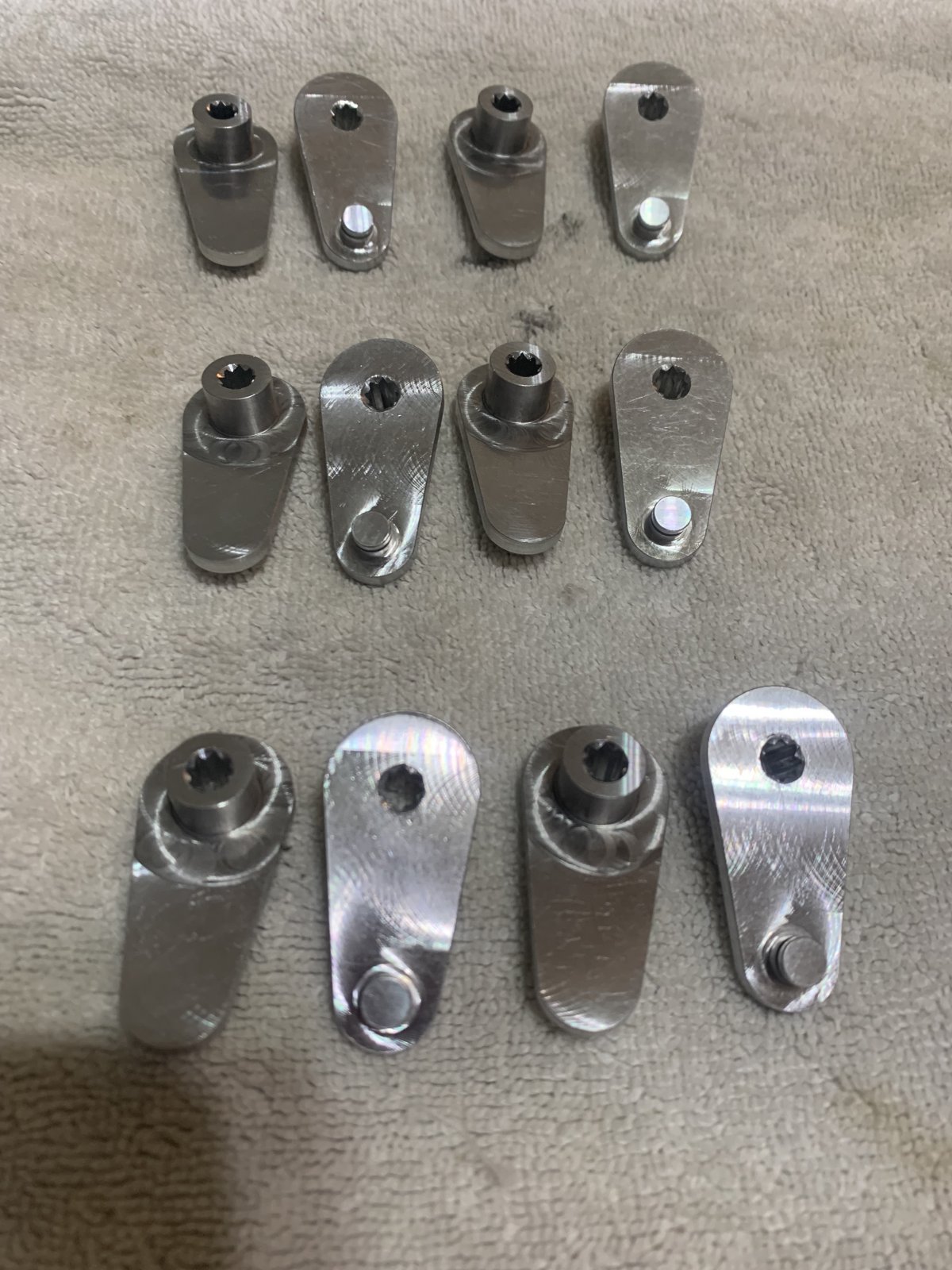

Hi
I had a coupe in the shop that would not release the seatback so you could get into the rear seats I found that the 2 actuator levers were broken and would not allow the seat to release the catches I had some new ones made up out of aluminum instead of the original pot metal I had the shop make up 3 extra sets at the same time 4 levers ( 2 per seat ) shipped for $130.00 US These will outlast the seats If you have a similar problem, these will fix it. They even have the 8 square hole for the cross shaft ( this was difficult to copy )
first 2 pictures are of the original ones
Thanks, Rick

OK but yours are probably damaged, the originals are only pot metal, not very strong Maybe order these ahead of time so you won't have to wait for overseas shipping Think about how much that you are spending on redoing your seats, this is a small price in the larger picture
