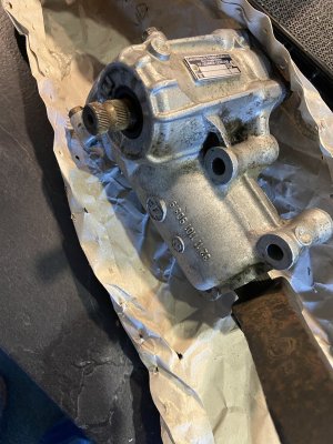

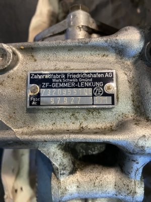

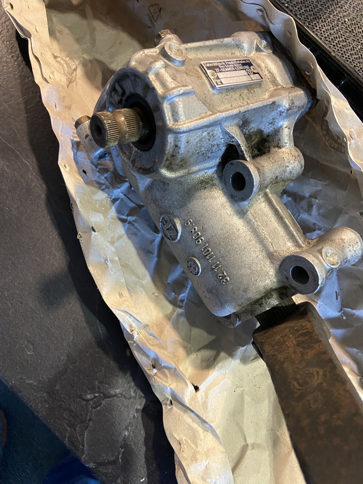

I’ve had both and can assure you that a manual box gives the far more direct feel/ response. They were designed for 185/195x14“ tires and relatively light cars, so if one stays within those sizes, no issues with parking/ city streets etc. I’ve got 205/16’s front and it feels old school as I have to tug on the wheel whilst parking ;)

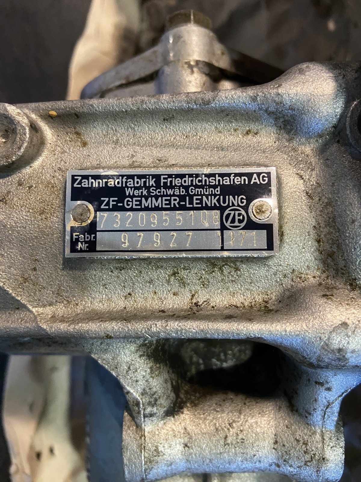

The E3 manual had the same ratio as the E9/ Csl although the later 2.5cs also had a manual box with a longer ratio. The one you’d want is the E3/E9 type as in the added pic/ part#.
There is one for race cars with an even tighter ratio but those are not to be found!
Needless to say, power steering is far more ‘comfortable’ but, IMO if you want a sportier and more responsive feel, you’d want a manual box.

Bob, I have never heard of a manual box failing nor requiring a refab, having said that I recall seeing that Walloth had some part for the manual box. The swap from PS is fairly straightforward. Only hassle is to have the steering rod adjusted to length by a maschine shop.

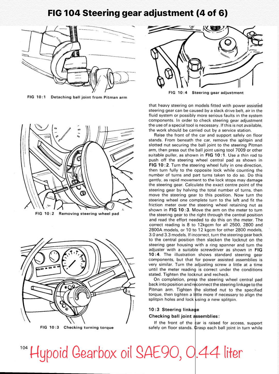

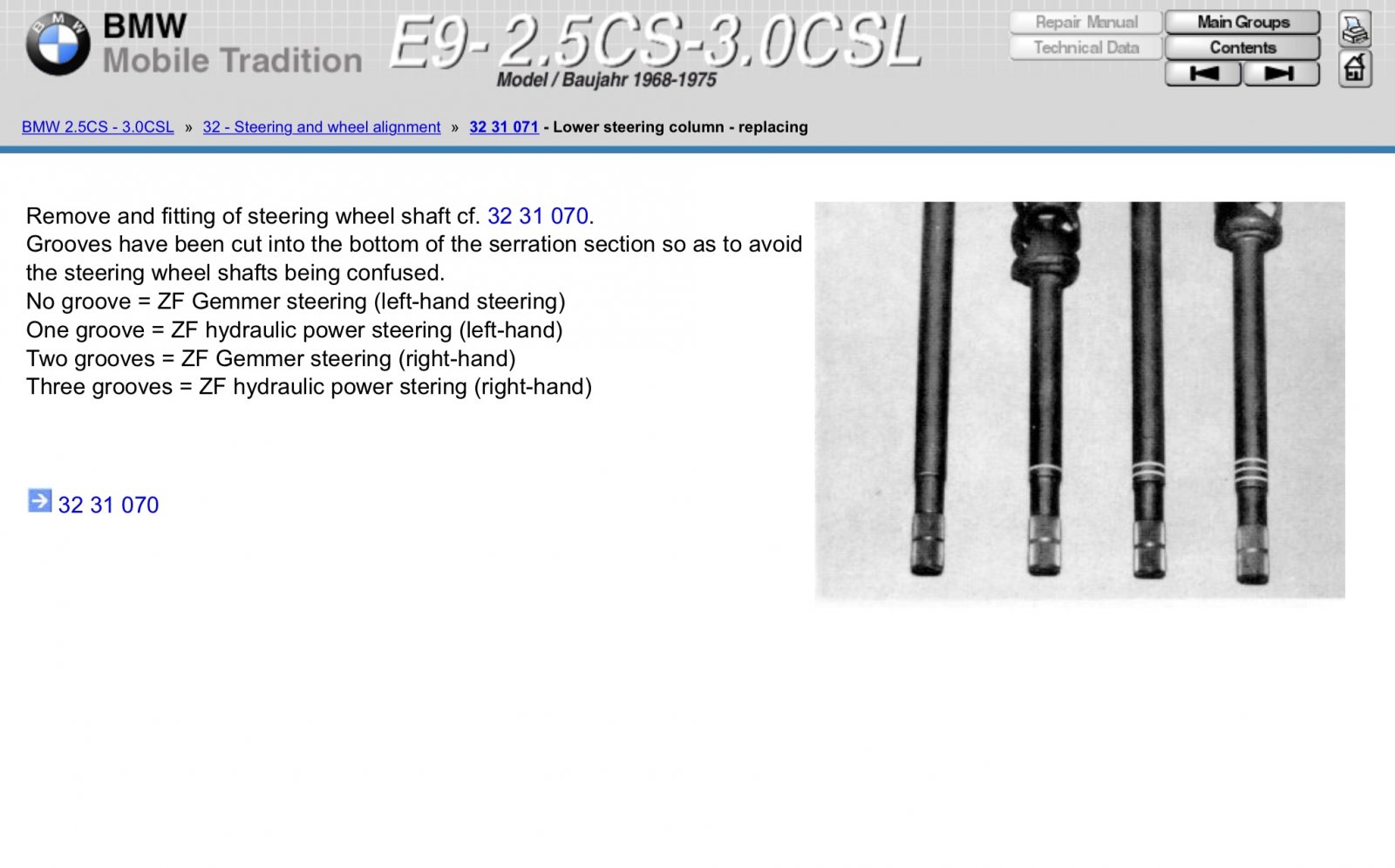

There are 4 different lengths of the steering rods, so depending on which one you find, the length would have to be adjusted accordingly.
There is an adjustment screw on top of the box to adjust play. Here’s some basic info and the 4 different rods…
I happen to have a manual box just in case you want to indulge. Pm sent!
