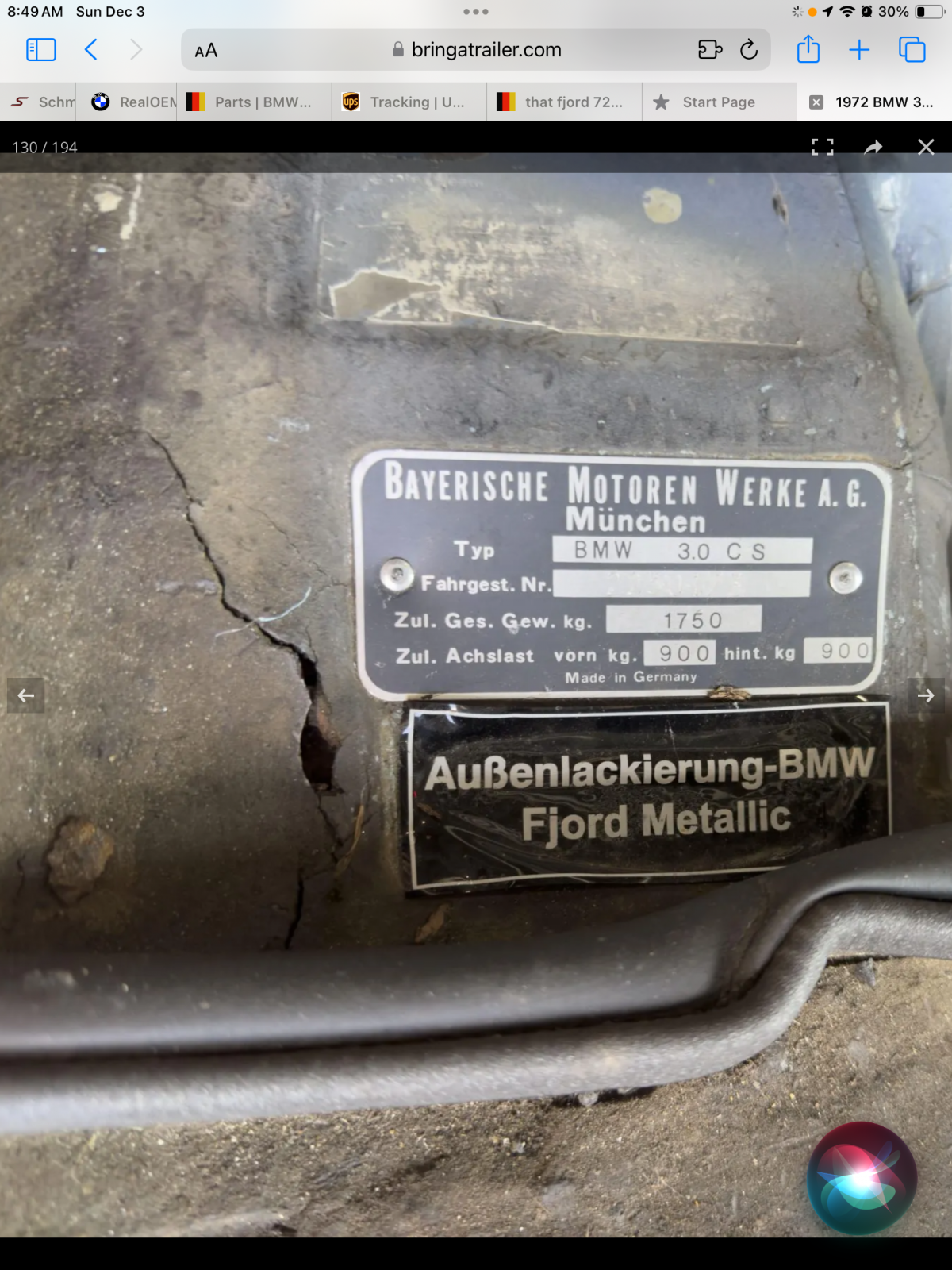

Note the plastic fender liners installed on car.
Until they come out - no one knows what is going on with this car.

I think that through the rusthole next to the VIN plate , we are looking into the glovebox?
If that is correct, then it is in need of serious surgery as the front structure needs to be chopped off and rebuild from the inner fenders up likely.
Even so, it looks to be complete. Nice project for someone with serious welding skills?

agreed- very good project if you know that hole is there and have the means to fix it.
and the time….
I had an 81 year old client ready to bid on this yesterday…
The shops are so busy here that he will be 83 years old before it would be done!
The seller says…
“ No lingering rust or rot on this example!””
If that is a hole into glove box, to fix this in USA with paint in engine bay correctly is 10,000.00 plus.
they have put plastic? splash guards in wheel wells- let’s see what is up there.

Confession: I have been all over this car as I had some vague notion of buying it at a low price and just driving it. Three coupe friends, two of them intimately familiar with the inner and outer workings of coupes had the same advice: Run Away! If someone had met the Reserve, let's say $38,000. plus BaT fees, taxes and transport they would have been looking at Around $43,000 in. Looking at the W&N prices, sale prices at that, each part would have been double or more the sale price when you add shipping. Impossible to estimate the R&R number of an experienced body shop at let's say $125. an hour(a guesstimate probably low). Quality paint and the prep: ten$ of thousand$ of Dollar$. VSR, are you listening?

i believe in @sfdon's math - at 26k plus 40k to set the car basically right ... you would have 66k in a car who's max value is 60k. if you paid 38k for it you would be 18k underwater. it simply doesn't pay for a shop like VSR, Coupeking, Don to take a car like this on. only a solo practitioner that has nothing but time (no overhead) and the skills to create beautiful metal work to make this work.

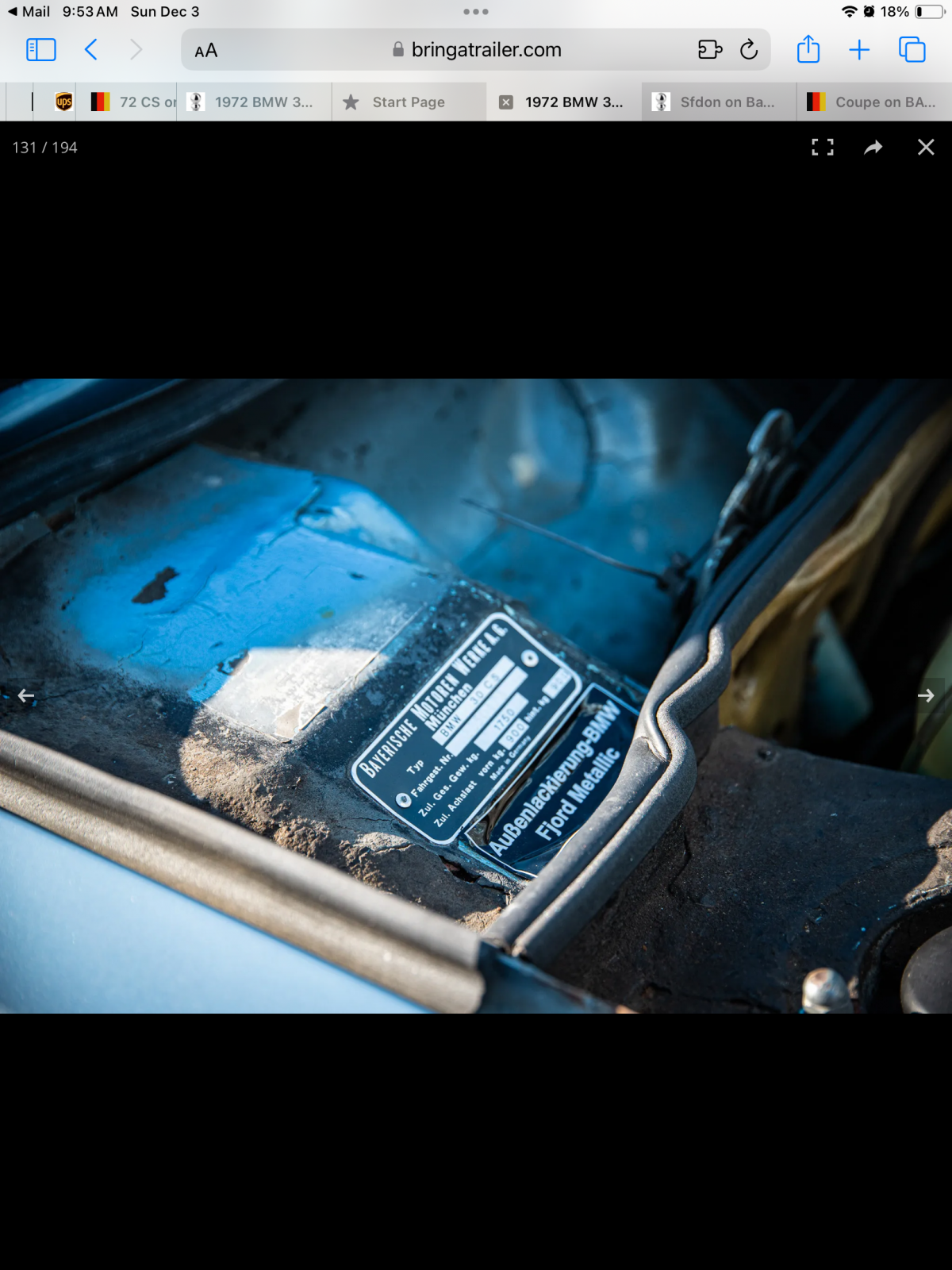

Is it just me or is VIN plate missing a VIN?
On one pic- the VIN space looks blank... because of the lighting.
One another pic, you can see the stamped VIN...
But yeah - I did a double take on that also (but saw another VIN tag pic so looked there and saw the ##)

Hmm...parts car? THat seems a bit extreme.
ya sure that isn't just a big crack on the shock tower insulation?
That's why I hate that insulation crap. Hides issues as well as a place for moisture to establish and rust the metal underneath.
