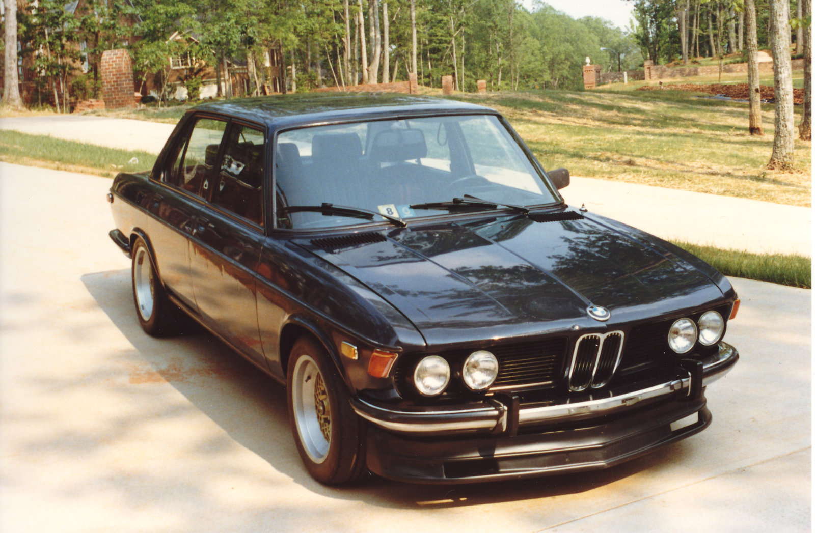

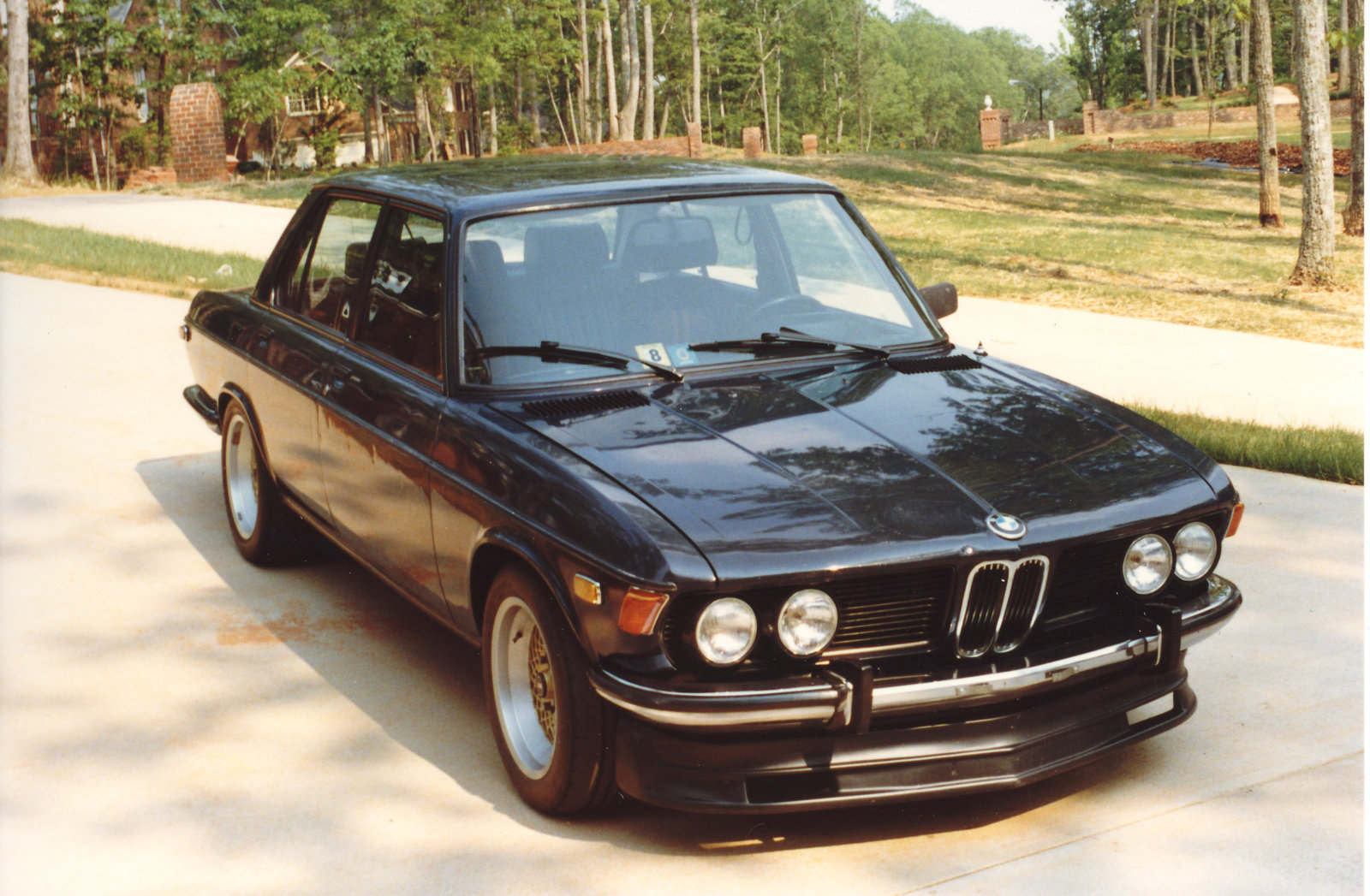

Are you referring to the Bavaria or the CS? Decades ago on my Bavaria I ran 8x18 Rial wheels all around with 225/50-16 tires, lowered, with no issues up front. I believe the Rial wheels had an 11mm offset also. From what I recall from back in the day, the CS has less fender clearance room up front than the Bavaria. I actually had plenty of fender clearance on the Bav:
