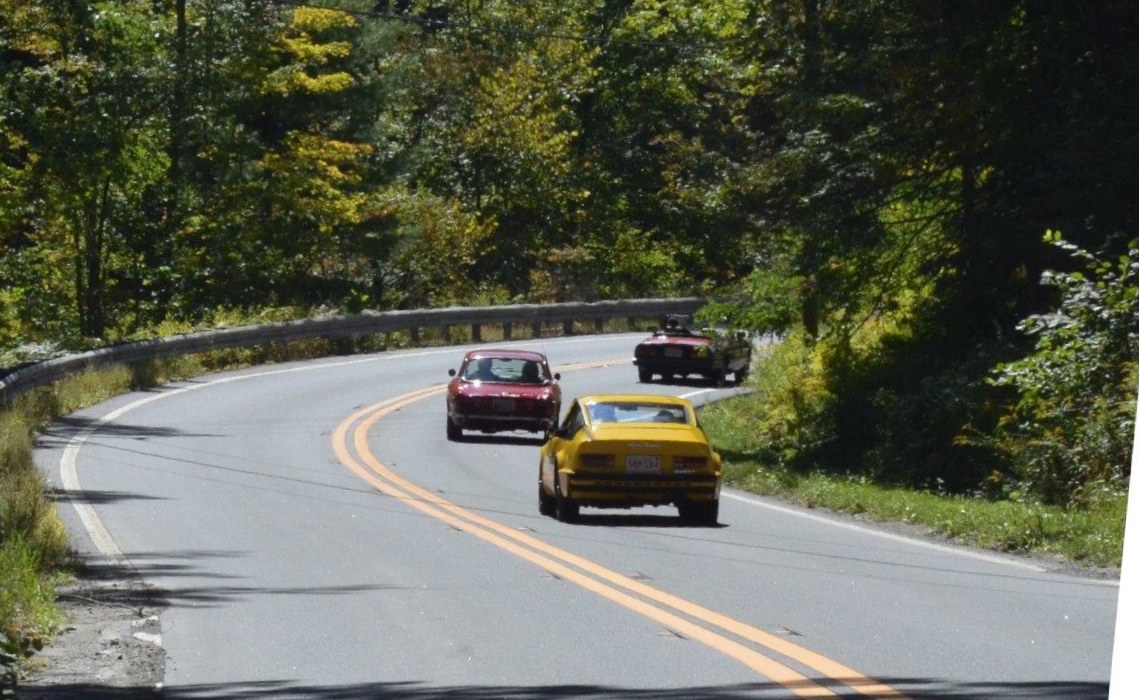

Why am I asking? I just finished a drive with our local Alfa club at speeds from 0-70mph on twisty/hilly western MA back roads (dry, cool day). Some of the roads were freshly paved, but there was also some broken pavement, leaves, dirt and gravel on some corners. These Alfa drivers are a pretty aggressive bunch, many of whom also vintage race.
Unexpectedly, I found the performance of the old 14” tires more than adequate for high spirited yet adult driving on public roads. and I was following a new Alfa Quadrifoglio without issues except on a few straights.

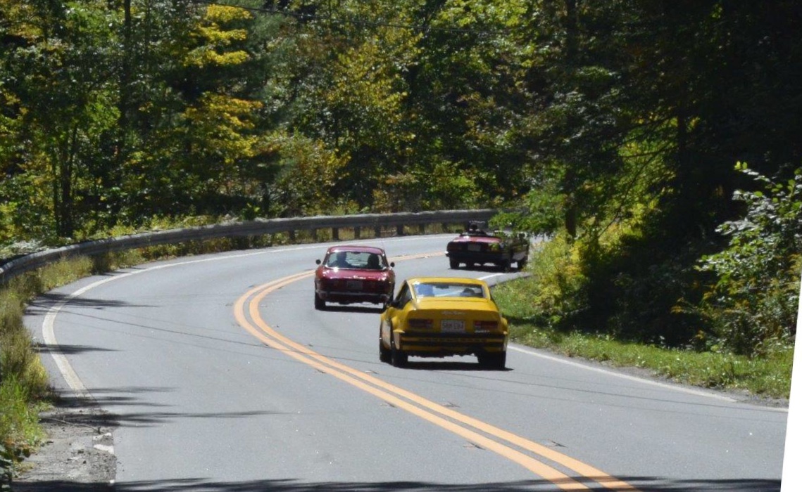

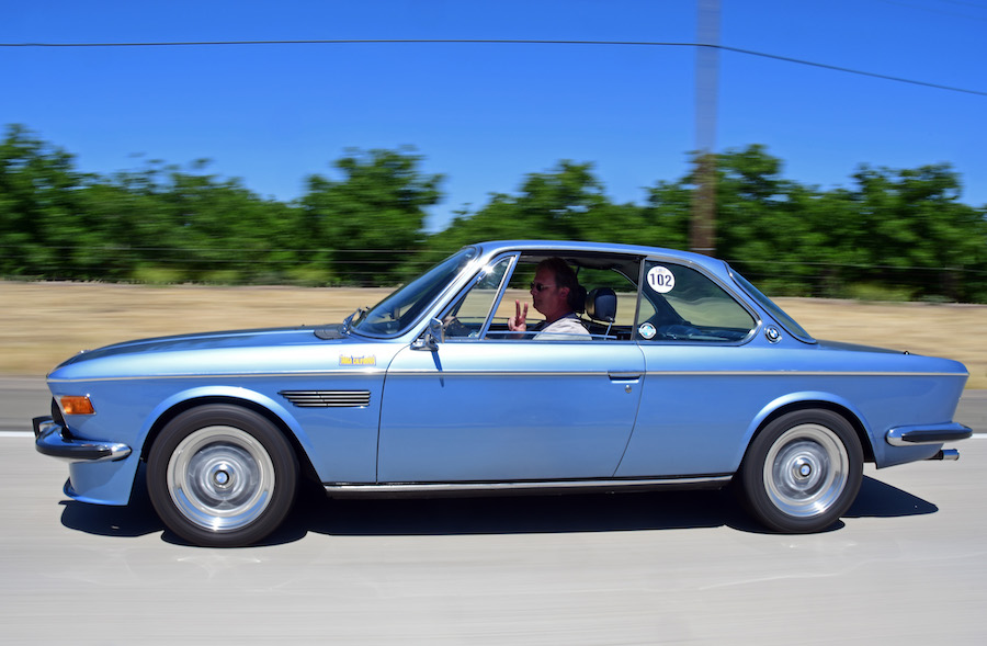

BBS RS 16s are so much better than the stock 14s with the same setup you have, John. Time to replace your tires regardless of the wheels you use. 7 years is the general rule of thumb.
