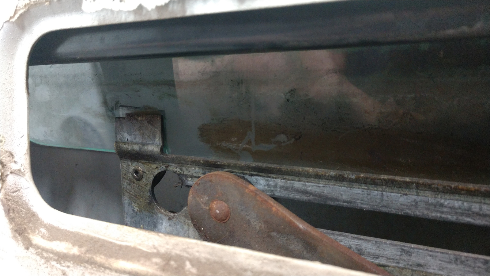

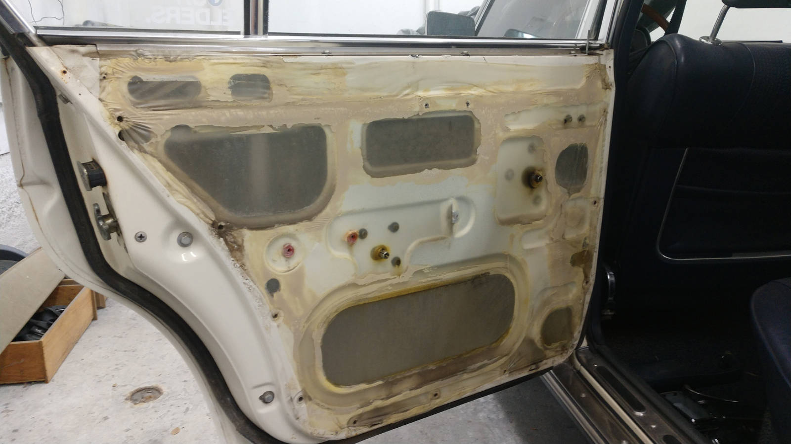

Left rear window stopped working so I took a look last night. Nice see that the plastic barrier was still intact after 52 years. :cool: The adhesive tape used to hold the glass was sitting on the bottom of the door and turned to dust when I tried to pick them up but the regulator was in very good shape. Used some glass glue on the U-clamps and good to go...
