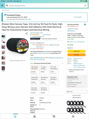

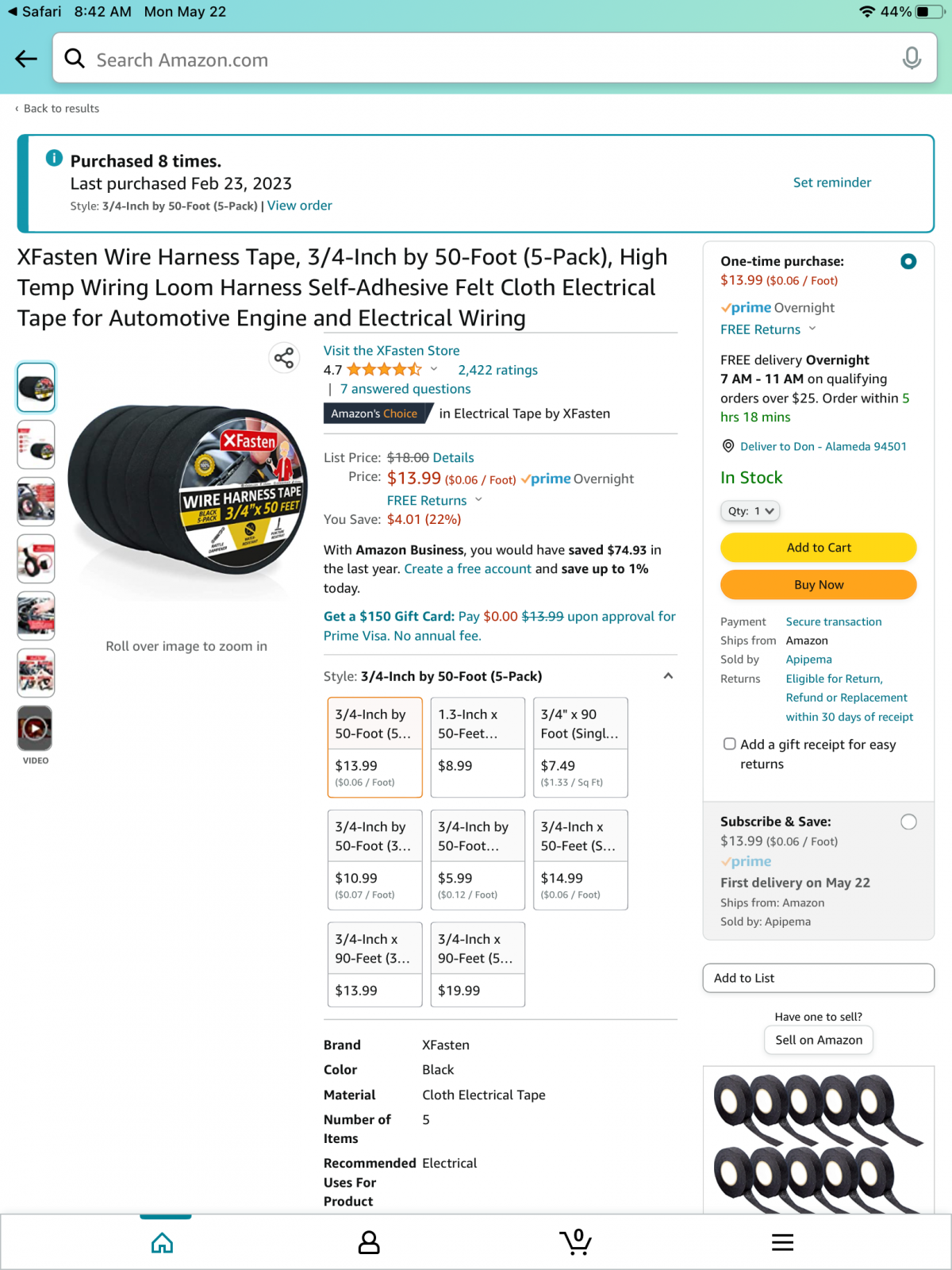

was looking under the hood of my 73 and most of my wires are not covered in tape. things look kinda unruly. what should I use to get these wire looking better. is there something I can use instead of tape?
sfdon has already answered this, but let me second his answer by saying that you definitely do not want to use regular electrician's tape. The heat and fumes of the engine compartment will melt the adhesive and turn it into a gummy mess. And the texture of the tape isn't correct for an e9. Use the material sfdon recommends.
I hate electrician's tape, and just consider it a temporary fix. Maybe it works in home wiring, but not on cars.
