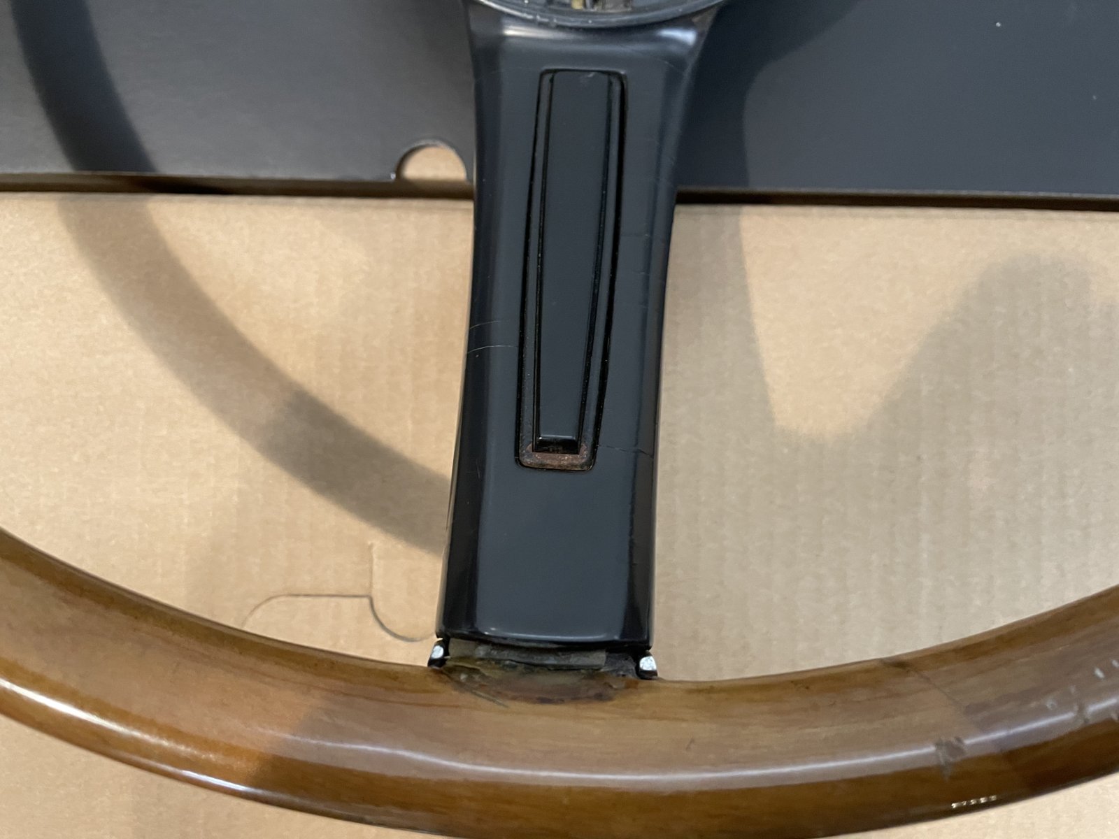

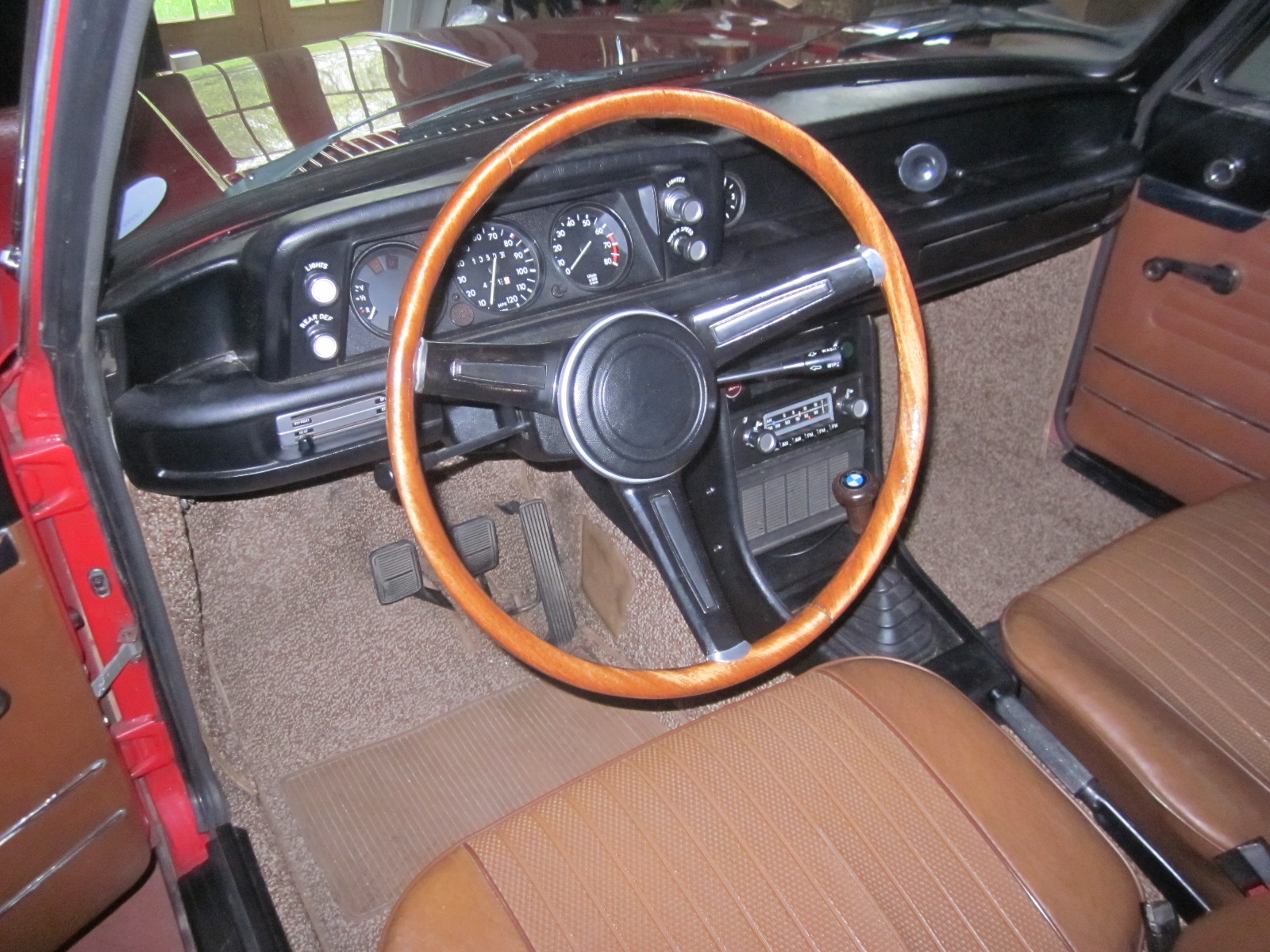

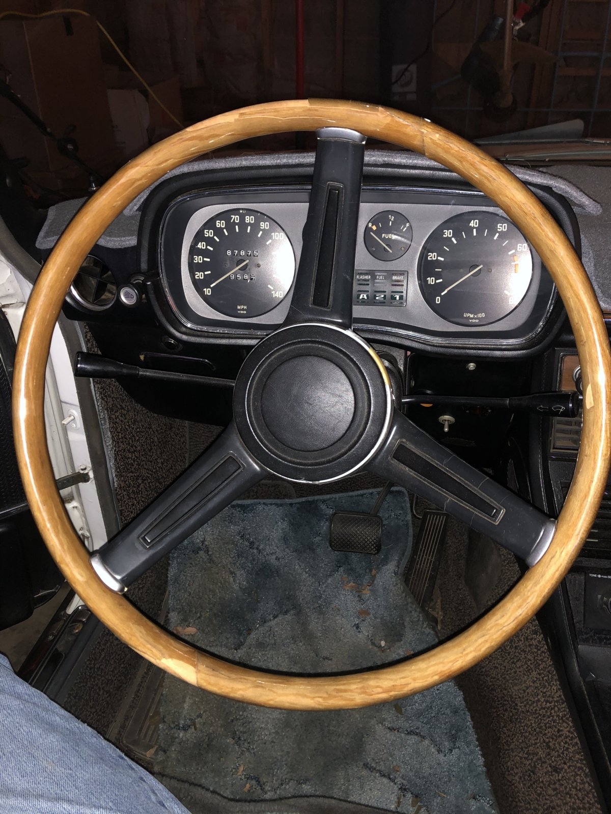

The steering wheel in my 2800 is in ok shape except for the finish is flaking off. Here it is:
I was thinking of pulling off as much of the finish as I can, then sanding the rest. Then use some UV resistant clear on it, I read where someone used marine spar varnish. Would that be a good route or is there a better way?

Hi. I would be very delicate. The steering wheel is not full wood as Nardi but there is a veneer on it. It can brake easily and peel off.
It is fine as long as only the transparent paint is peeling off.
Need a lof of care.
Isn't your black plastic cracked as well?

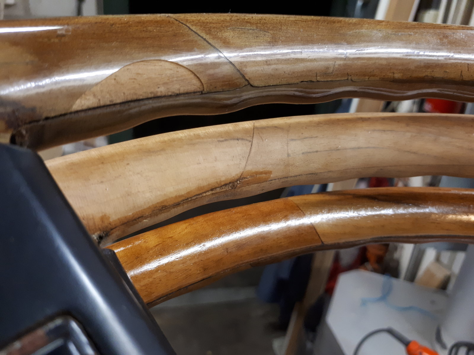

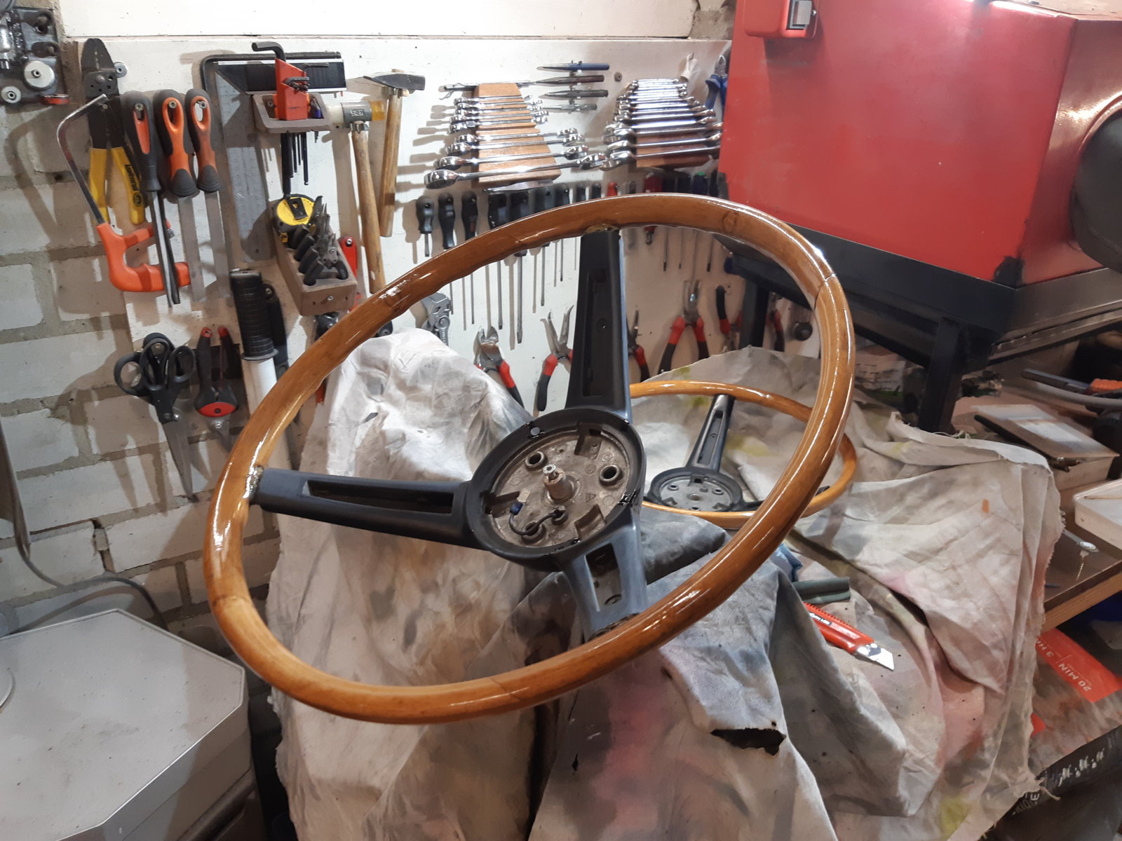

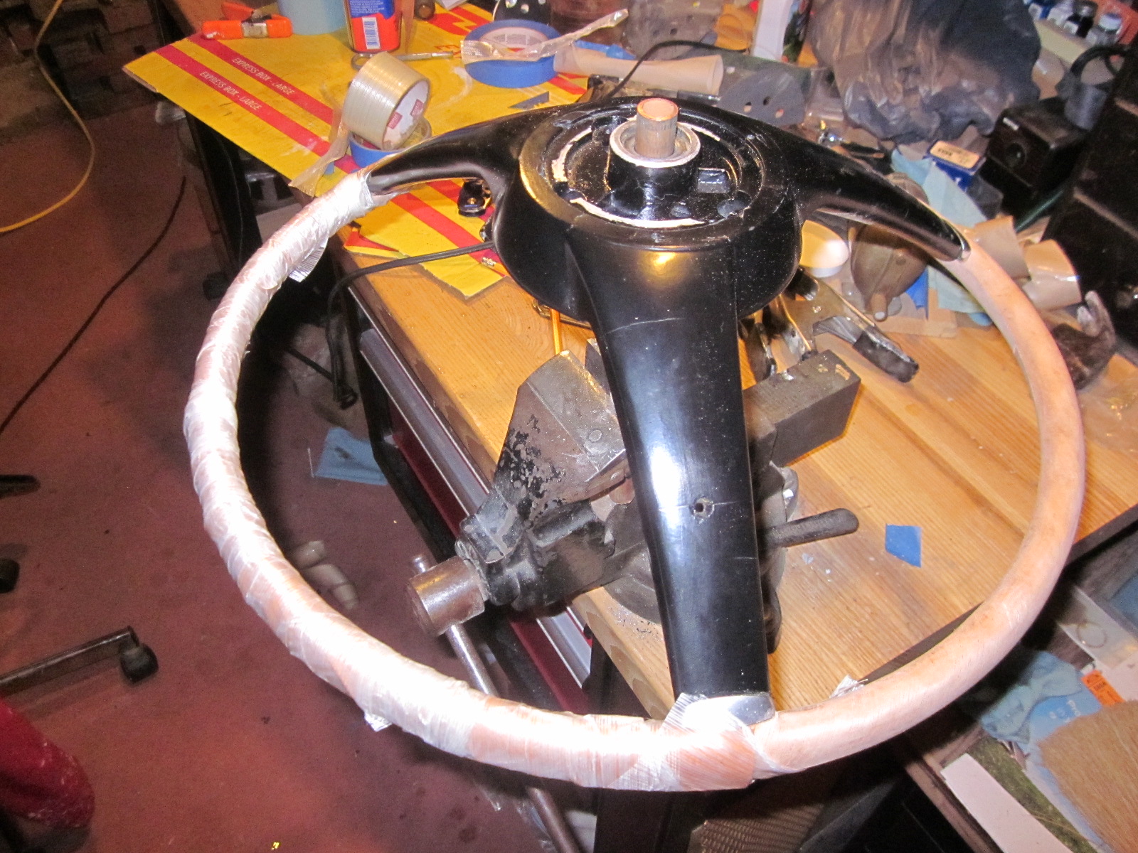

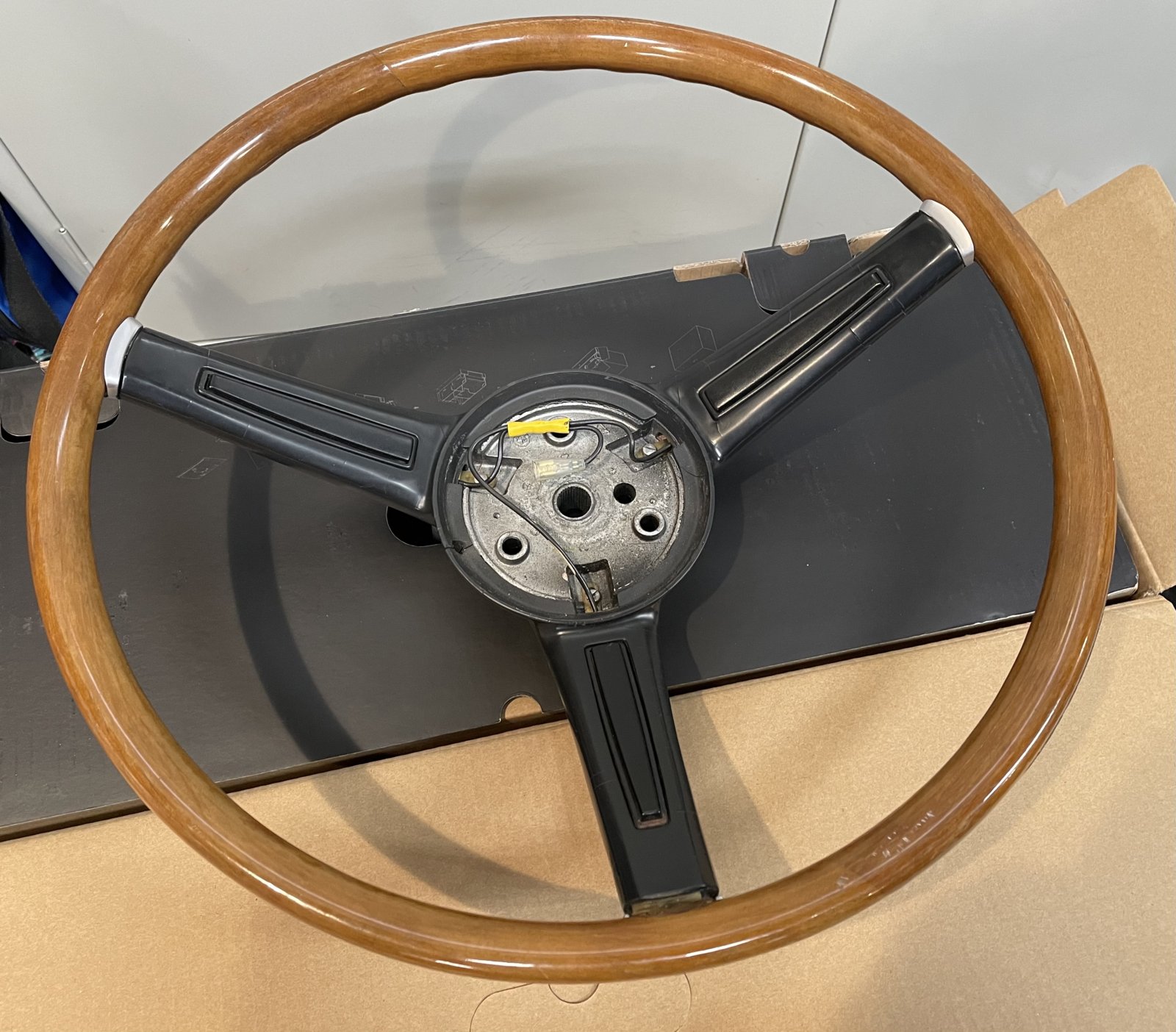

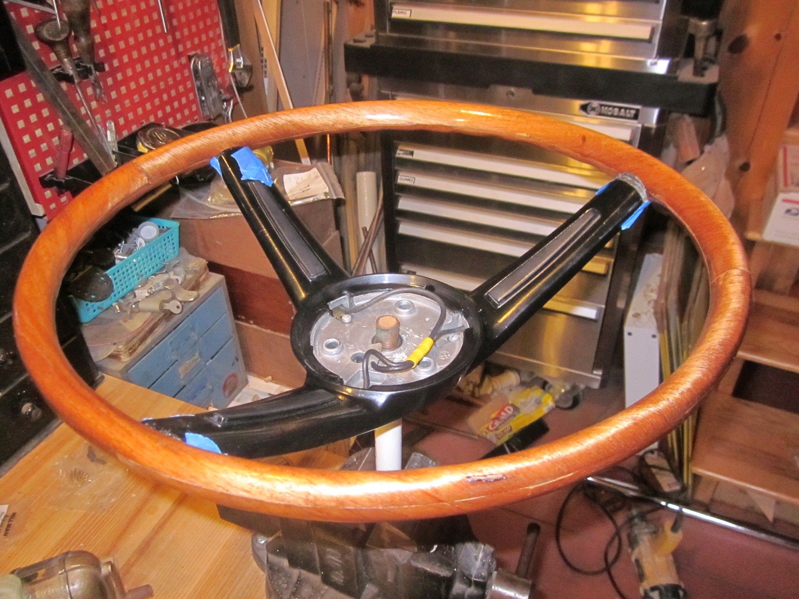

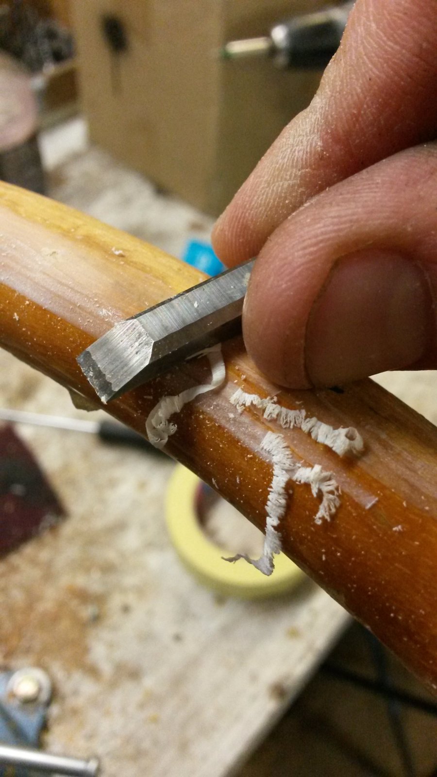

I've done 3 of these wheels myself. The wood is just 1 mm thick ,as mentioned above. Sanding is a chore, and risky to get sand through spots. (Amhik)
I've found that the best way is to use the side of a chisel (it's 90 degree, but sharp) to get the old lacquer off. Grip the chisel with two hands, and scrape towards you. If the old paint is well adhered, it just scrapes small curls as in the first pic. If the paint has delaminated, (as your wheel seems to be, and the top wheel in my last pic), it chips into small pieces. Wear safety glasses, as it chips off the lacquer are sharp and fly everywhere.
I used a wood pin in a vice to hold the wheel, with a screw in the middle to increase the diameter of the wooden pin when screwing it in, effectively jamming the wood into the internal splines of the wheel. It blocks the wheel in rotation.

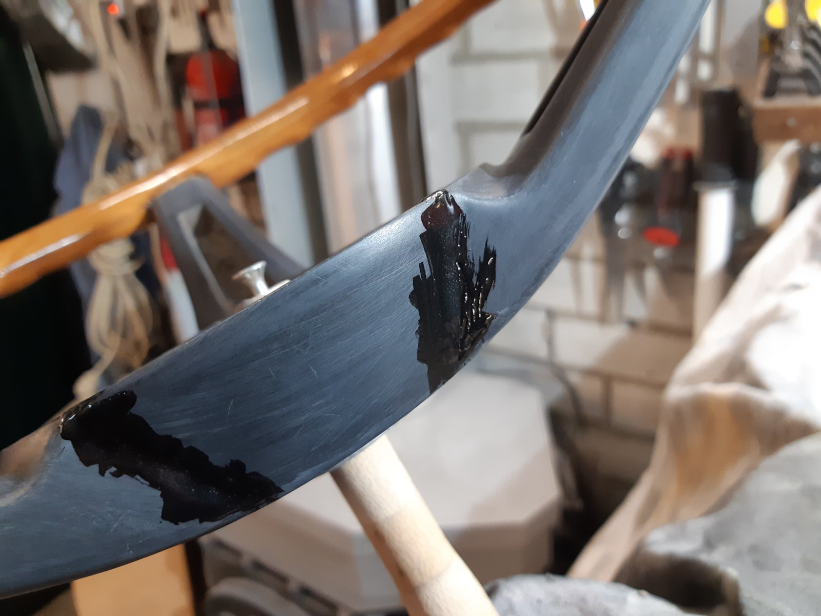

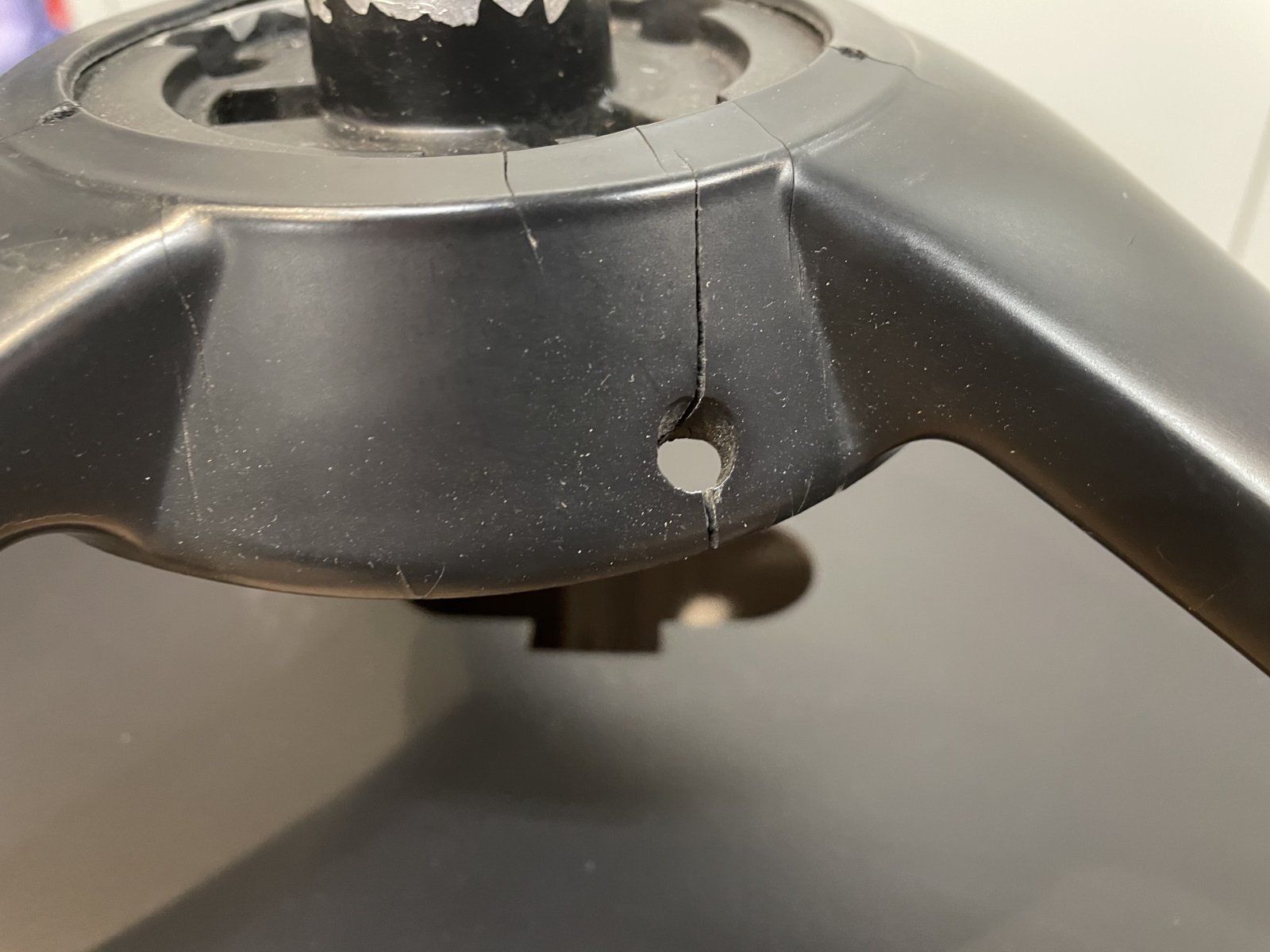

i filled any cracks int eh black plastic with 2K epoxy and sanded it smooth. then painted it black afterwards. It does loose that original bakelite colour and gets that glossy fresh paint look, but al least the cracks are gone
The wood is simply soo nice when it's freshly painted!

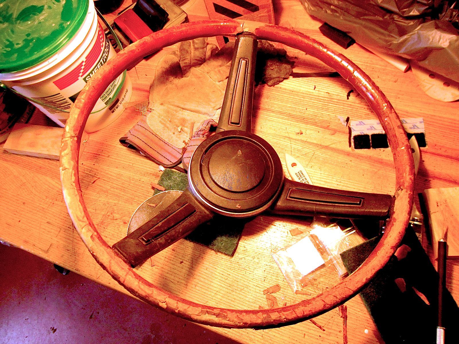

I've restored & re-veneered a few steering wheels. I use ProPrep brand scrapers to remove the finish same way @eriknetherlands does with a chisel. Need to be patient & very careful. Takes at least 3 weeks from start to refinishing with 6 coats of Spar Varnish or Polyurethane.

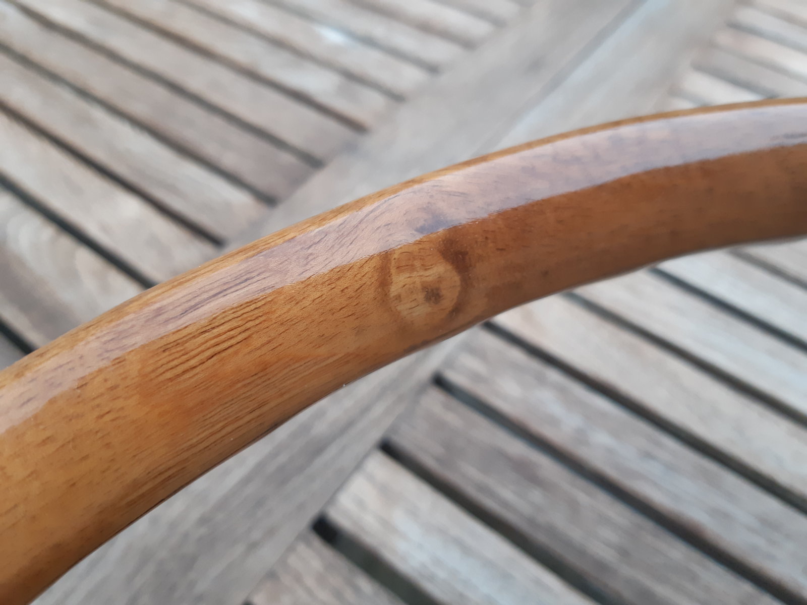

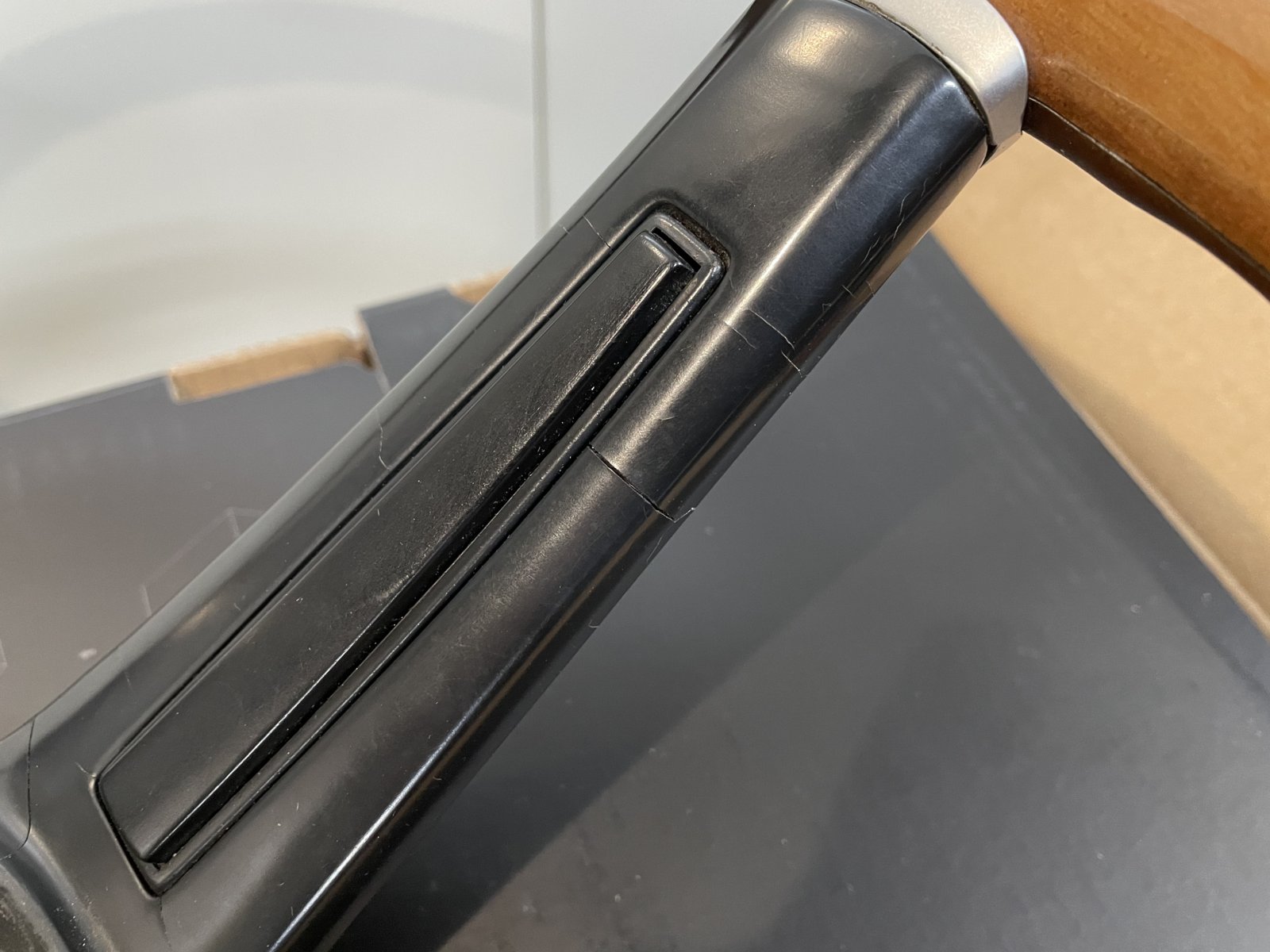

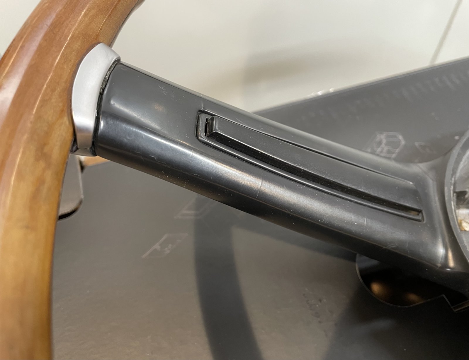

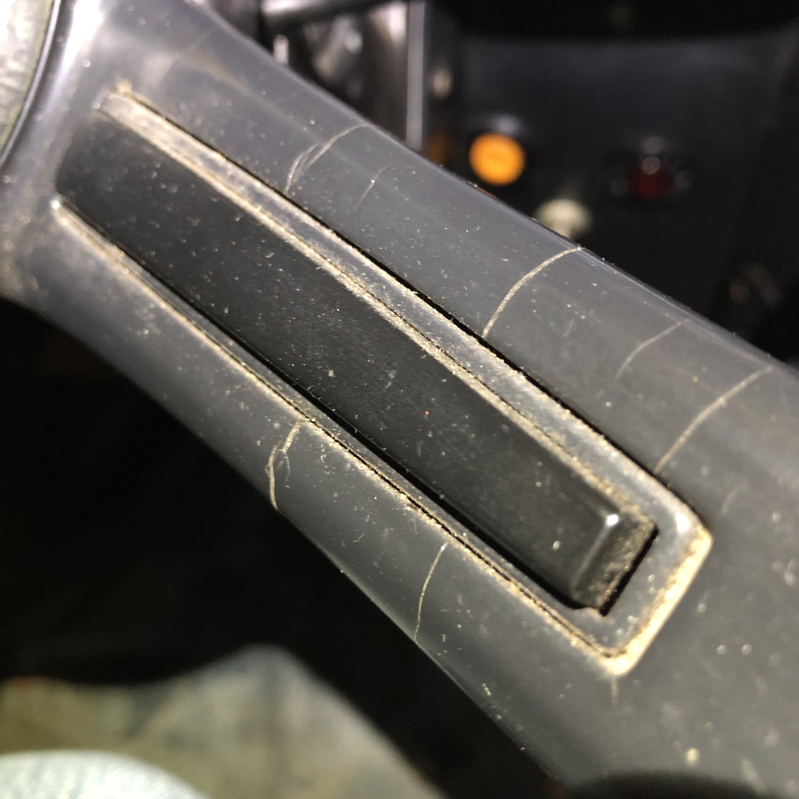

Appreciate all the info with pictures! I was looking at the SW in more detail and yes, Krzysztof, there are cracks on the spokes. I will need to take the advice and fill and sand those as well.
Here is the other blemish on it:
Also, the varnish or whatever it is called has been baked to the point where a lot of it might just pull off. After that I will see how bad it’s stuck on there and try the different approaches mentioned to see what works the best for me. I wonder if a heat gun would help with this

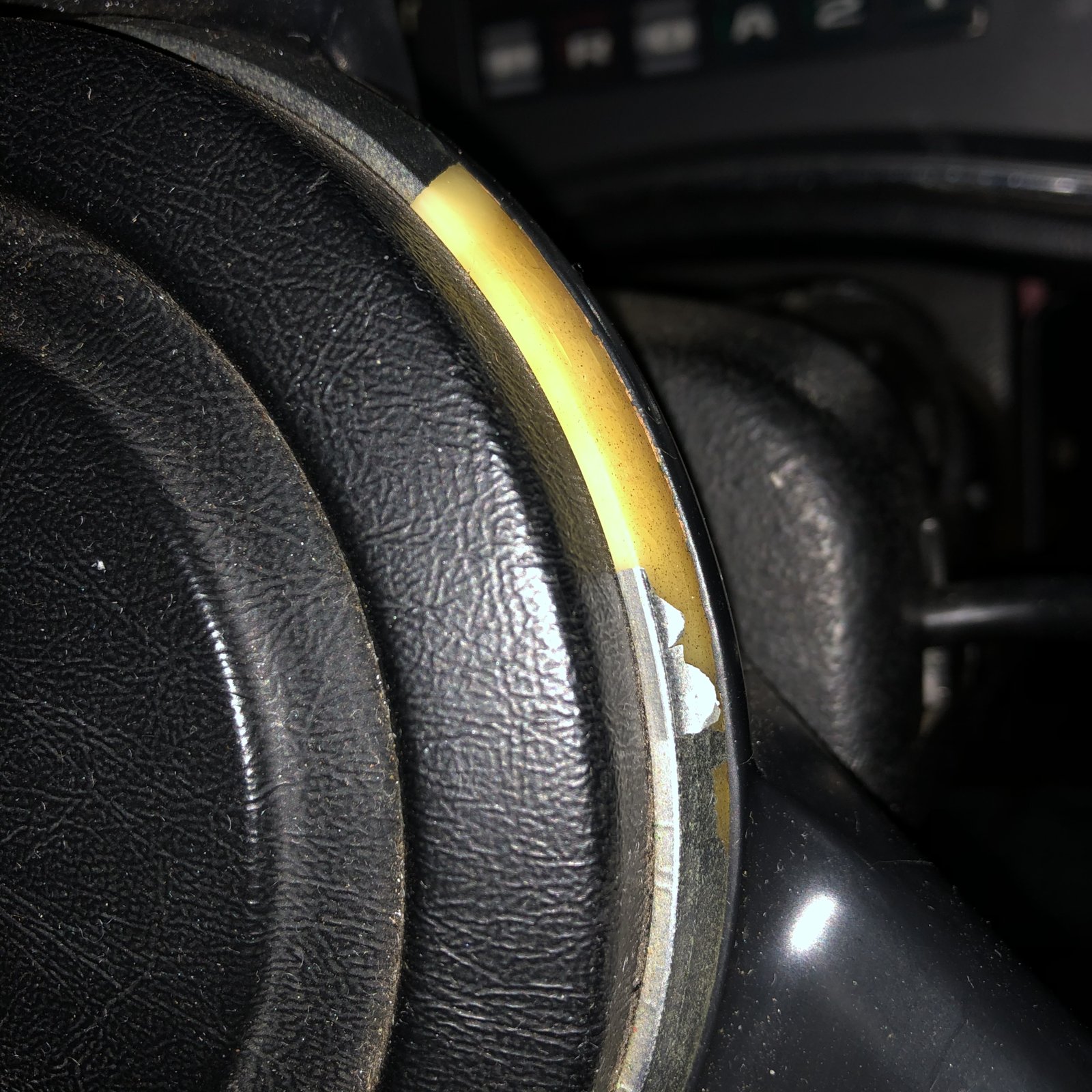

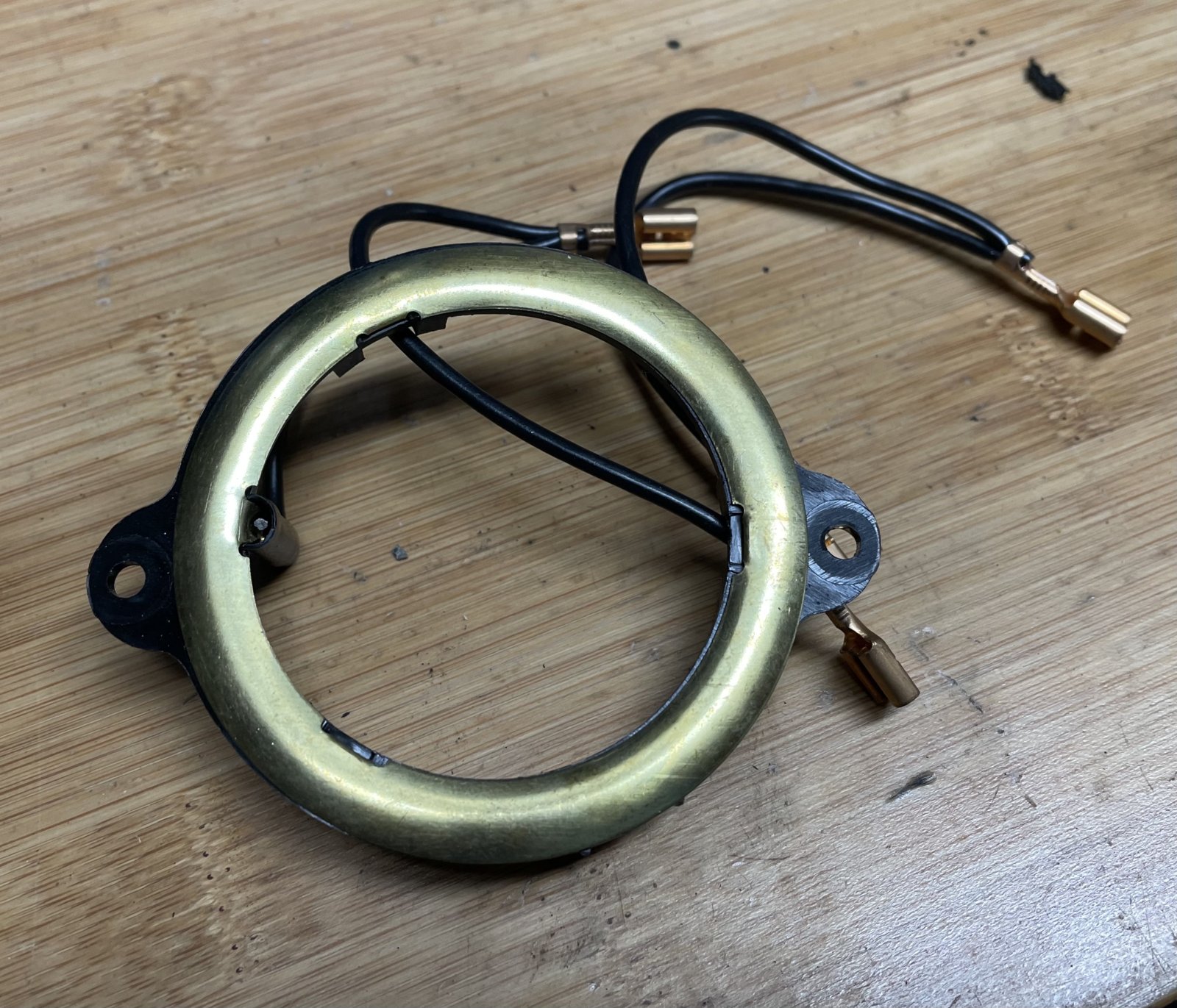

with regard to the chrome flaking of the center pad, these do come up for sale once in a while, for about 25 euro/usd. Easy to replace when you lay your hands on it. so just park it in the back of your mind, and keep an eye open in the parts section.

Pleeze don't try a heat gun. Unless you are facile, the wood will burn and you have no room for sanding it down.
