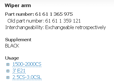

Could it be the case where RealOEM is listing the same wiper arms for both the e21 and e9, which are
(1) incorrect relative to the original E9 parts
(2) but ‘compatible’ as functional replacements

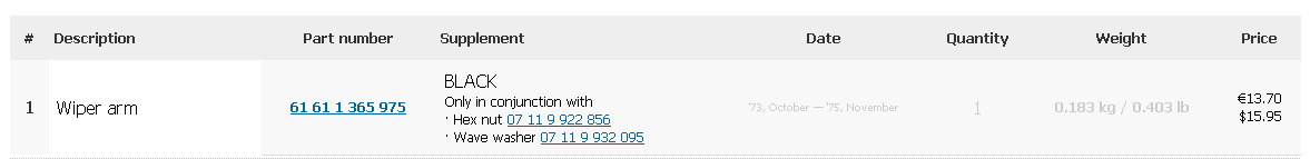

I can believe it is correct but for the bolted arms (MY1974-75).

This is a case where the 975 part shows as superseding the 121 part but to do this you would need to change spindles, that’s very misleading.

I talked to Carl Nelson today in La Jolla. He he seen hundreds of coupes and yet not one 74 with bolt on arms. There was a very late 74 customer car there with splined posts/arms. If they were used perhaps it was on coupes built in 75 which we didn’t get in the US. BTW, I looked at an e21 with coupe style hooked end arms and they do bolt on but the cap is plastic and not pot metal.

Late 1975, EU is bolt on type. I can provide pictures of the mounting axles but no arms.
Confirm, E21 has the plastic protection cap covering the nut.

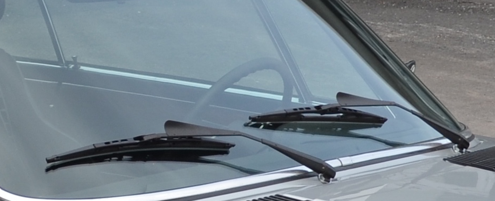

When I bought my coupe, it came with black snap on arms with hook ends, but I can't say for sure where they came from?
I used them for a while until I bought a set of chrome arms, and currently have them as spares. I could trade them for a set of chrom/satin arms though.
Both have wings, so probably two drivers arms, might be able to remove one of the wings if needed.
(They should sit lower in resting position, but had some trouble with the wiper linkage, etc.)
