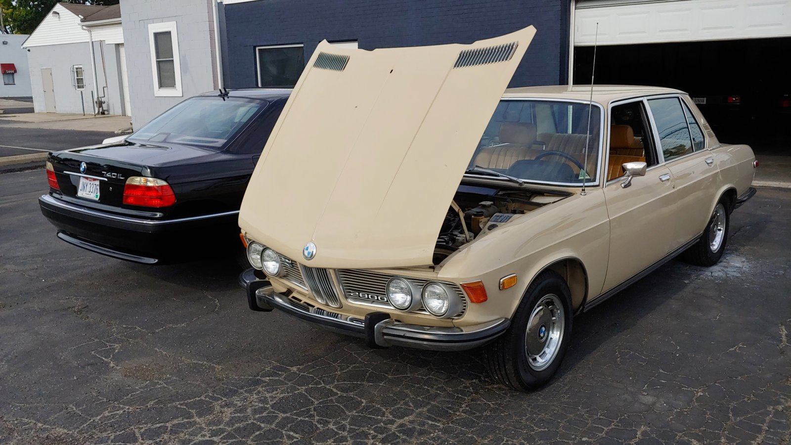

Hi all. One of my zenith carburetors on my 1970 2800 has been giving me fits. I have rebuilt it a couple times but it keeps flooding out. The plunger keeps sticking. Not sure if there is something wrong with the bore. I'm done with it and would like to see if I can just purchase a good running Zenith Carburetor from somebody. Please let me know if you had a good working unit. Thank you.

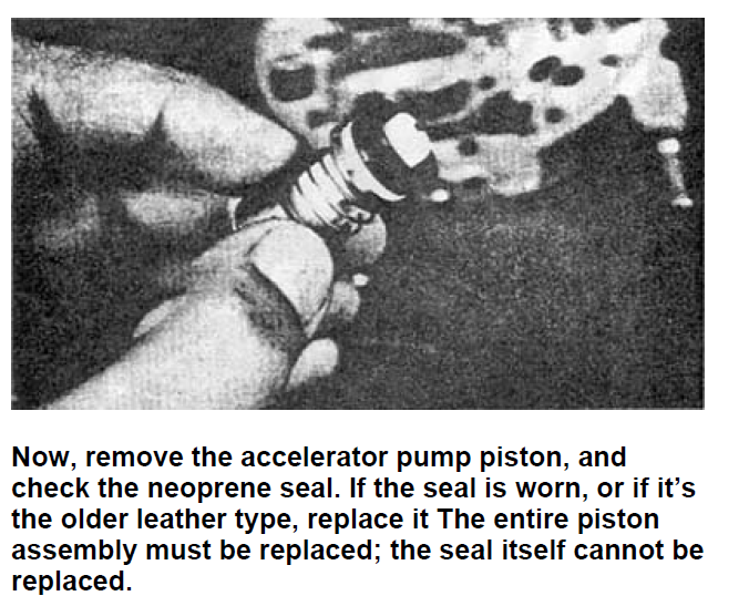

I had a flooding issue after I rebuilt my Zeniths. I had read that the needle valves in the rebuild kits aren't of the same quality as the OEM ones so I reinstalled the original ones. I'm sure they were original because these carbs still had the original leather accelerator pump seals, which I was able to replace.
Anyway, the flooding issue turned out to be that the float was hanging up on the gasket between the carb body and top. It intruded just a bit far into the float chamber and the float couldn't rise up and push the needle to close off the flow of gas, which would overflood the carb. Your problem doesn't seem quite the same, but I'd check your gaskets to be sure that can't happen.
