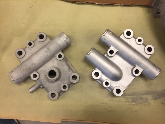

Looking for some advice re the bottom covers of intake manifolds (Zenith carb). The small spigot / pipe that leads off to choke mechanism has corroded and completely sheared off. I've borrowed these lovely pics from a Newsixcoupe thread of what I wish mine looked like(!) and you can see the small outlet pipe on the left hand housing below. Question - is this likely to be repairable (and I mean by a professional not me) or if anyone has a spare lying around with or without the rest of the manifold which theyd be willing to part with please PM me

I suspect they are cast aluminum and likely not weldable. With failure being somewhat catastrophic I would suggest sourcing a new one instead of risking repair.

Cast aluminium is possible to weld and also solder, however aluminium needs to be very clean when welding.
Also that pipe is som small I'd go with Ohmess option instead. Most likely it will turn out better.
I have a spare you can have for the shipping cost from Sweden to UK.
Let me know if you are interested.

Nice of Frogish to offer a replacement part. My idea might have worked, but it also has the potential to cause a vacuum leak once you get everything assembled, which can wreak havoc on carb tuning.

Unfortunately I had bad memory and the one I have is on the right hand side of the picture, with three large pipes. Not the broken one.
BarnE9 still needs the part!

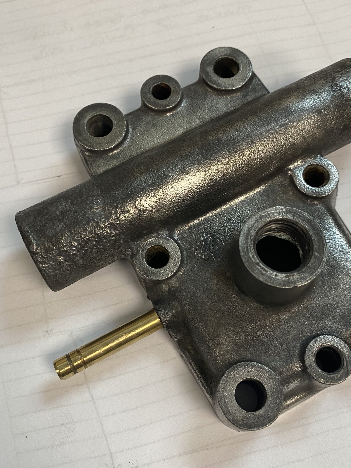

HI Edmil - I might give them a call but did they attach the tube on to the stub of the broken pipe or insert and weld from the inside? Mine has broken off flush to the casing so I'm thinking the latter is only opton
just got this back from IK classics. Drilled tapped and bonded so should be good for a few years
- thanks for the tip Edmil
