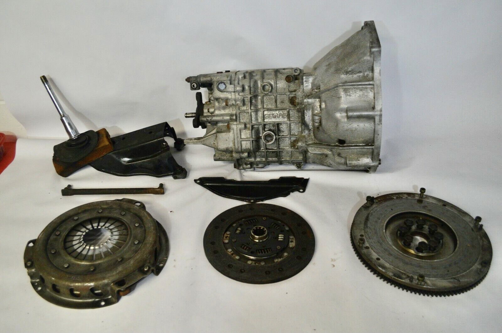

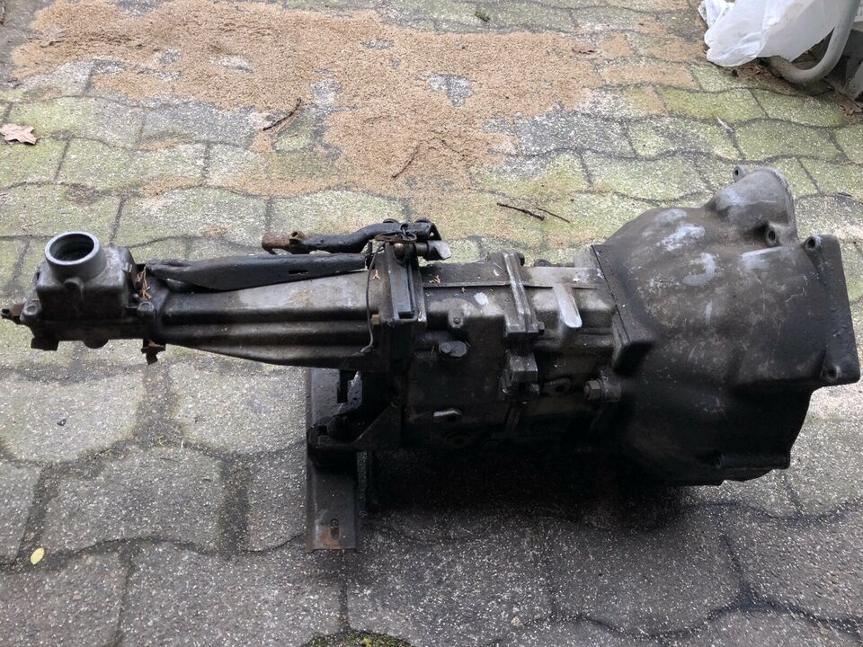

I’ve only driven my ZF manual and a 3.0 with a very sloppy Getrag shifter. As we know the Getrag can be tightened up with care and some aftermarket parts. Given how neglected my car is, I can say that I
agree with others that the ZF is a more precise engagement. Some say it is tractor like. Engagement is notchier than a getrag.
The ZF design is quite different from a Getrag. The getrag has a single selector shaft that goes in and out, and rotates - engaged by a shift rod pivoting on a ball. We’ve all seen the pic of the various Getrag shift levers, such as the short Z3 version.
The ZF has a series of long rectangular selector shafts that only slide forward and back. The shift lever picks which shaft to move forward or back. As a result, it has a gated shifter feel to it.
The ZF box has the selector shafts tightly enclosed in the aluminum housing. A shift lever and pivot bolts to the selector housing. It is all very rigid.

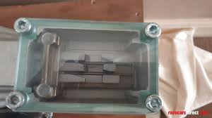

Top down look at the box that the shifter bolts to. These are the selector shafts. Note the notch that the shift lever will slide into, to pick the shaft.
The 262 has single selector rod circlipped to a rubber isolated aka “flexy” sheet metal shift platform. Funny that all of those $600 rally shifter boxes that bolt to the tunnel are attempting to replicate the ZF design, and result in a similar feel.
