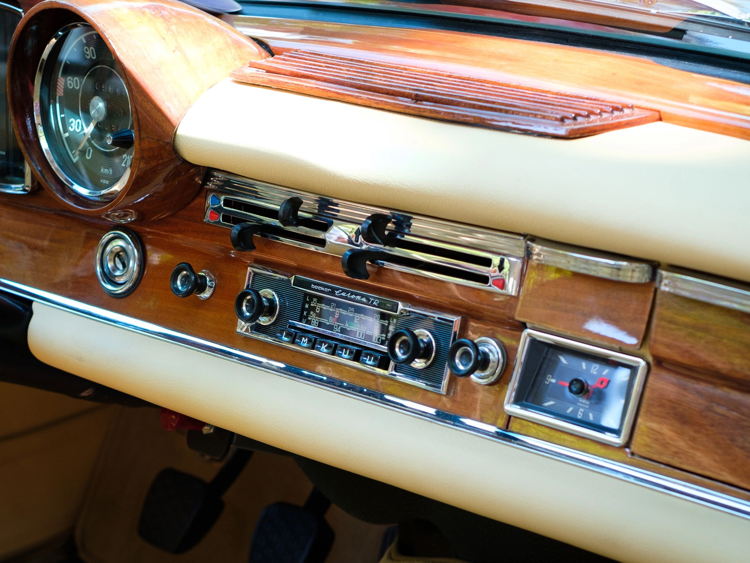

The radio is a Blaupunkt Frankfurt with a Mark II Out of Sight Module running the speakers mounted behind the radio on the back of the center console.

I don't think you'll have to cut the bezel - do your own research but this is what I found, the knobs are adjustable:

No room behind the radio the Becker amp was above glovebox i think. It is definitely a tight fit.
The great thing about the Out of Sight Audio Mark II is it can be mounted under the dash above the lower trim panel, under your front seat, under the back seat or under the parcel shelf in the trunk. As long as you run keyed Power, Ground & all your speakers to it. Everything is run from your phone, including volume. The Blaupunkt or Becker is purely for aesthetics.
I put a Becker Europa II in my car. The Europa II is stereo and the amplifier is built in. The built in amp makes a whole 5 watts per channel, unless you're cool enough (like @JMinPDX) to have the fader and 4 speakers, then it makes 7 watts per channel - somehow. Several of the Becker and Blaupunkt units have inputs that allow you to add an external bluetooth receiver. I got one from Creative Car Audio Shop and am pleased with it. Does it sound great? Nope, not at all. But for the time it does the job for me.

I have a bluetooth receiver feeding an amp, 4 speakers, and subwoofer. I also wired it so I could feed the radio stations from my Becker but haven’t once switched it. The on/off switch from the Becker turns everything on so the unit lights up for effect. The sub made a big difference, especially since it is under the driver’s seat. Sounds pretty good when you want some tuneage but usually the engine is the preferred programming for me but I love the original radio look.

Well done. I‘m not that cool. But Becker radios are. My Becker Grand Prix & fader is only connected to three speakers not four. One in the dash and two in the parcel shelf which are original to the car from best I can tell and they still sound fine. The bluetooth upgrade makes all the difference.
