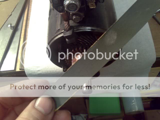

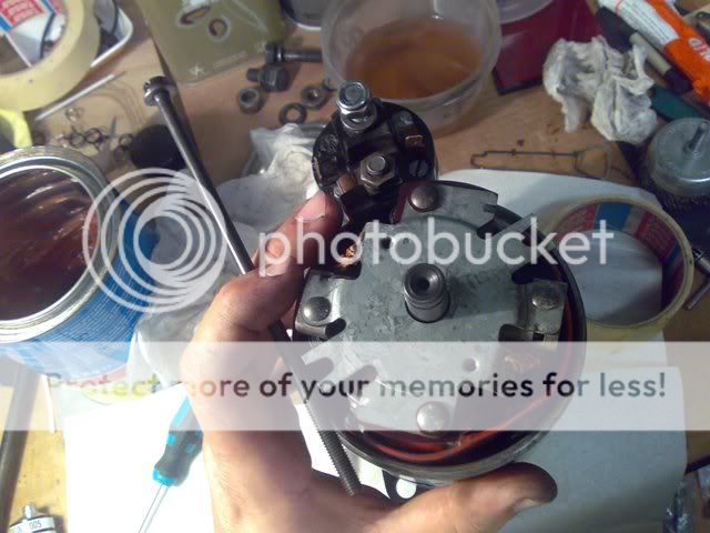

an interesting issue when you try to obtain the best possible performance in your cold starts
it inlcudes cleaning, new brushes, regrease
use these hooks to unplug the brushes:
remove the plate to clean and change the brushes
clean the contacts of the motor axis:
use sand paper, number2000
wrap around the contacts and wipe it carefully:
clean and prepare the components:
paint:
close and test with a spare battery, please be careful and use really thick cables if you test it out from the car !

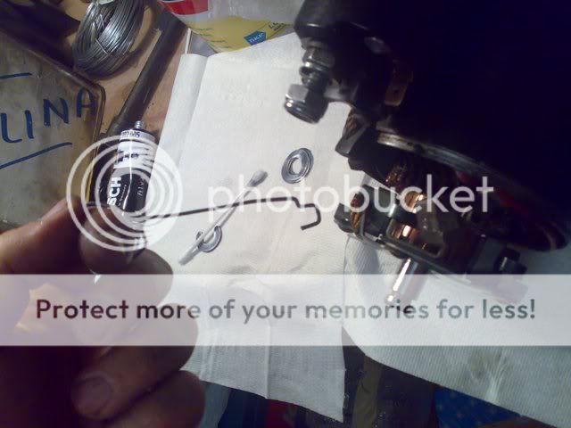

second picture: what is that bosch product I see behind your finger?
the blue cap at the top or starter axis ....was it really light blue?
