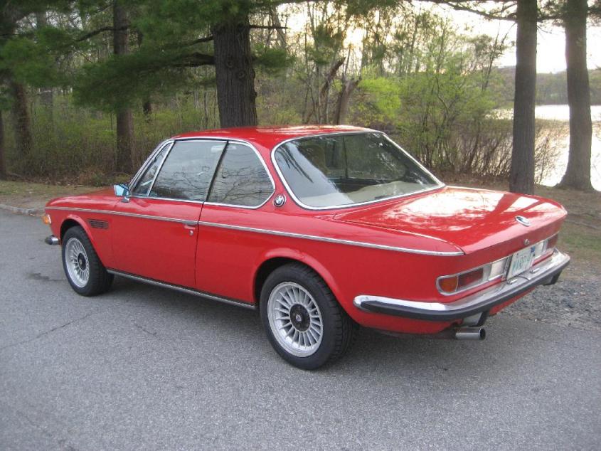

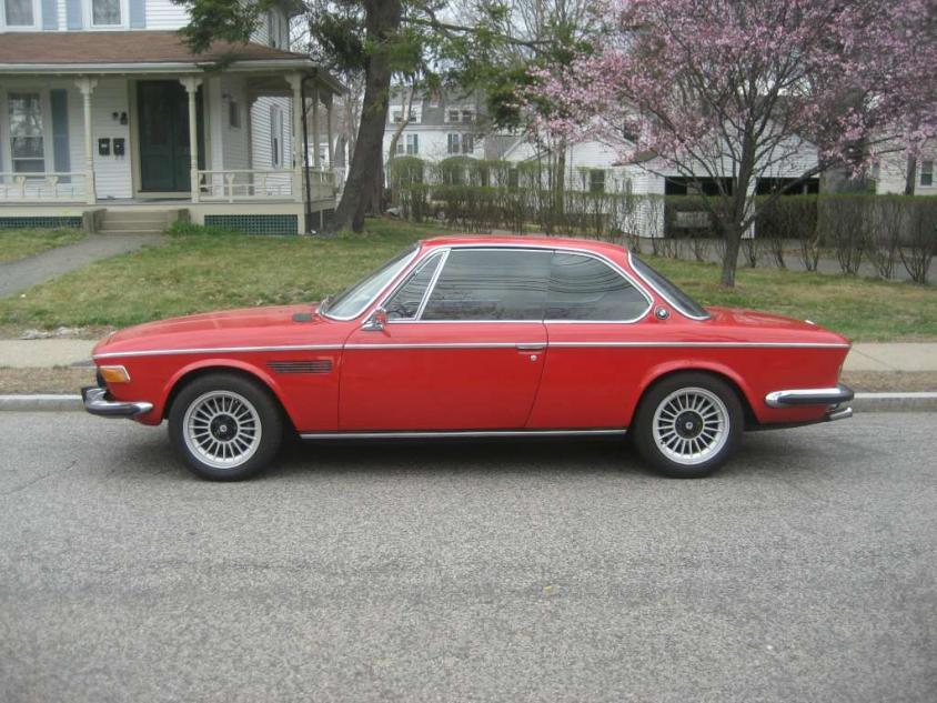

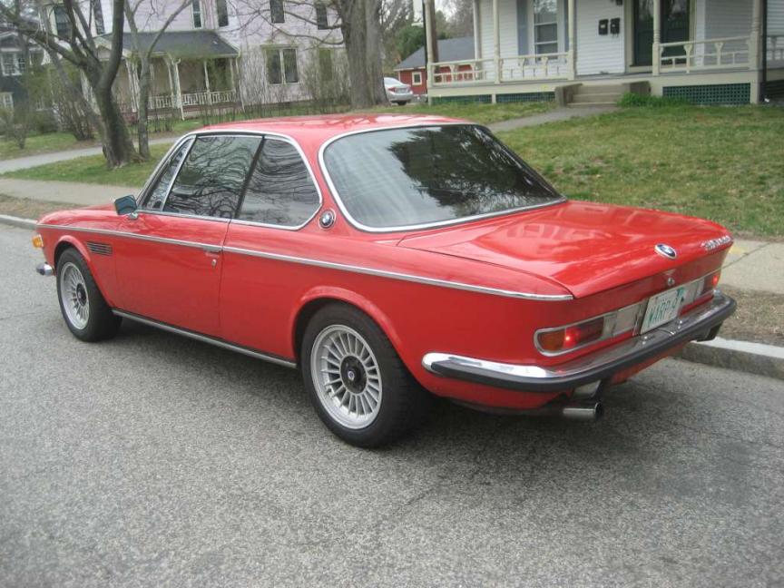

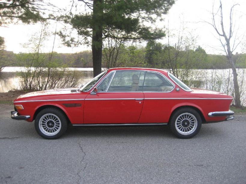

All that having been said, with time, I love the way it looks. Here are the before and afters.
